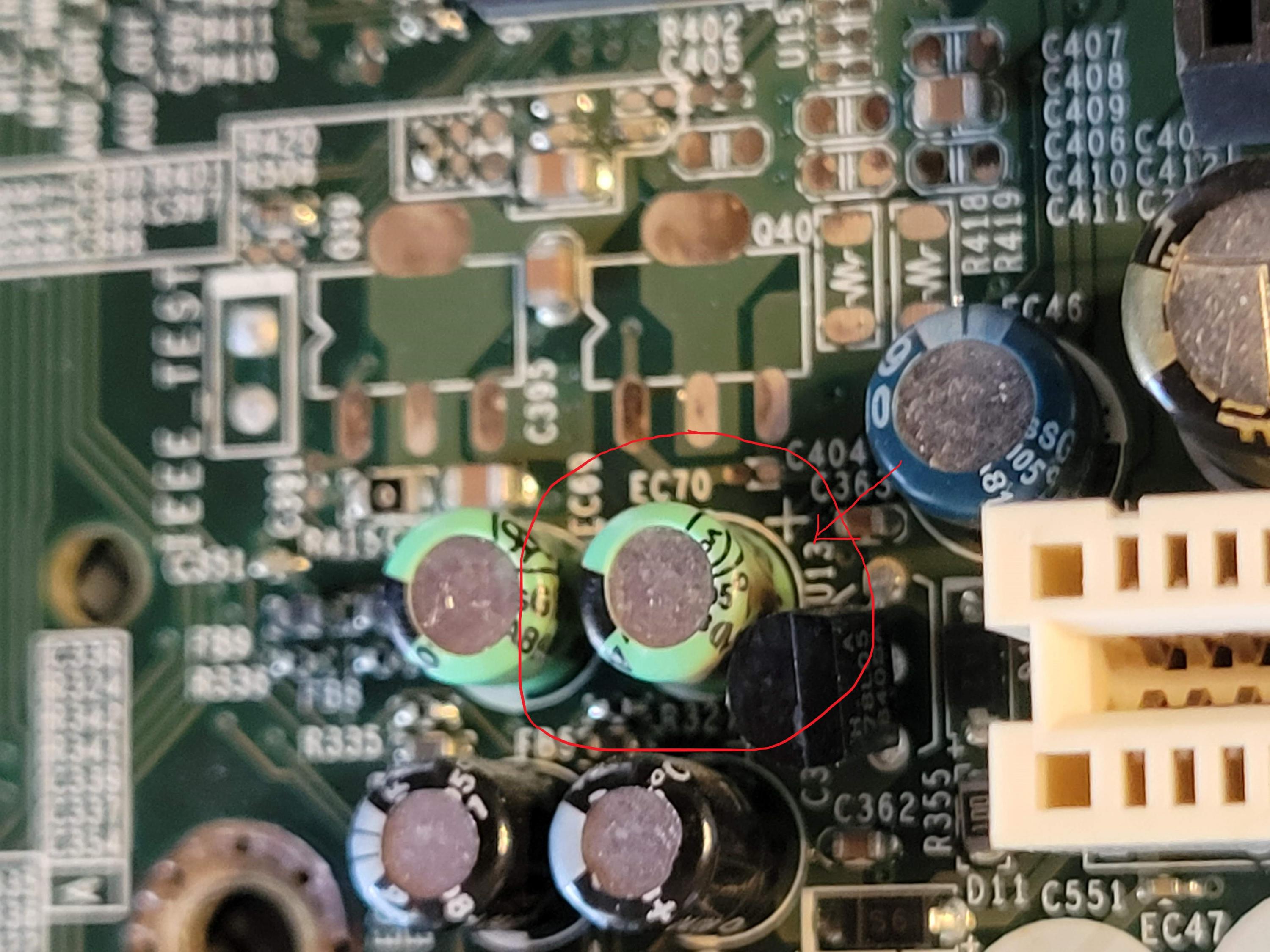

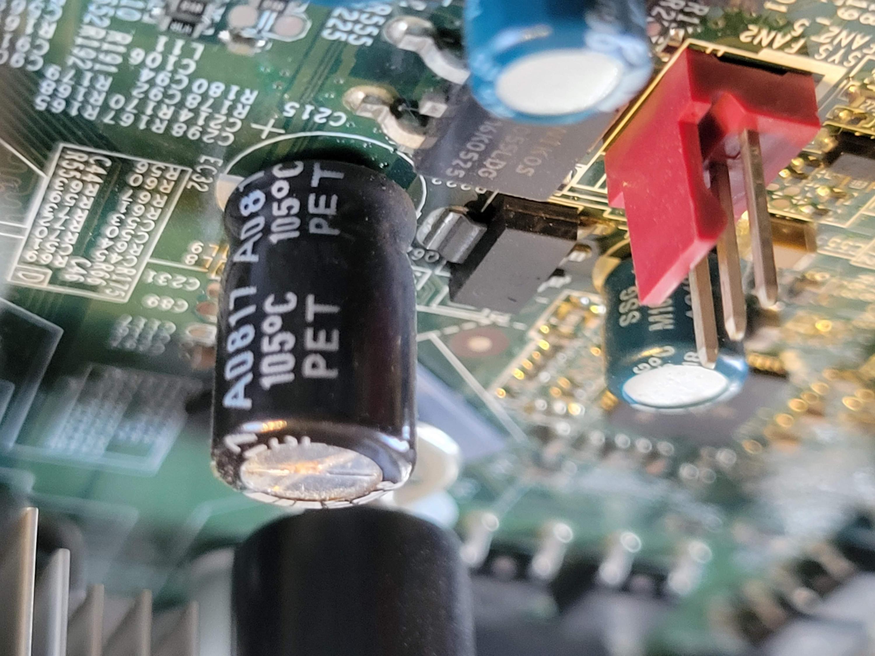

    I was hoping to get some help in identifying a replacement capacitor for a PET Rubycon A0817 6.3V 1000uF rated for 105C temp, MBZ series.
    This is to replace one bad capacitor on a DELL 530 motherboard DG33M03 (manufactured by Foxconn, DELL part # FM586).
    I'm attaching the pictures of the bad cap.
    Thank you so much!

    Just use a cheap polymer. Shipping will cost more than the capacitor itself so plan on spending $5 or so. Avoid ebay and amazon. Do not try to get a MBZ replacement, it will be either extremely old or fake.
    https://www.digikey.com/en/products/...AE013/13420154
    Also, you are fairly close to me. I can send you a Panasonic electrolytic 1000uf 6.3v for the cost of shipping (maybe $2?)

      Re: Please help find a replacement for Rubycon A0817 6.3V 1000uF 105C MBZ
      How about using this bad boy?
      https://www.arrow.com/en/products/eeufk0j102/panasonic
      If you are ok with it, send me a PM. Will have it drop shipped to you in the next 2-3 business days. We have free shipping with Arrow - for any size of order.
      The peak current of the above looks too low.

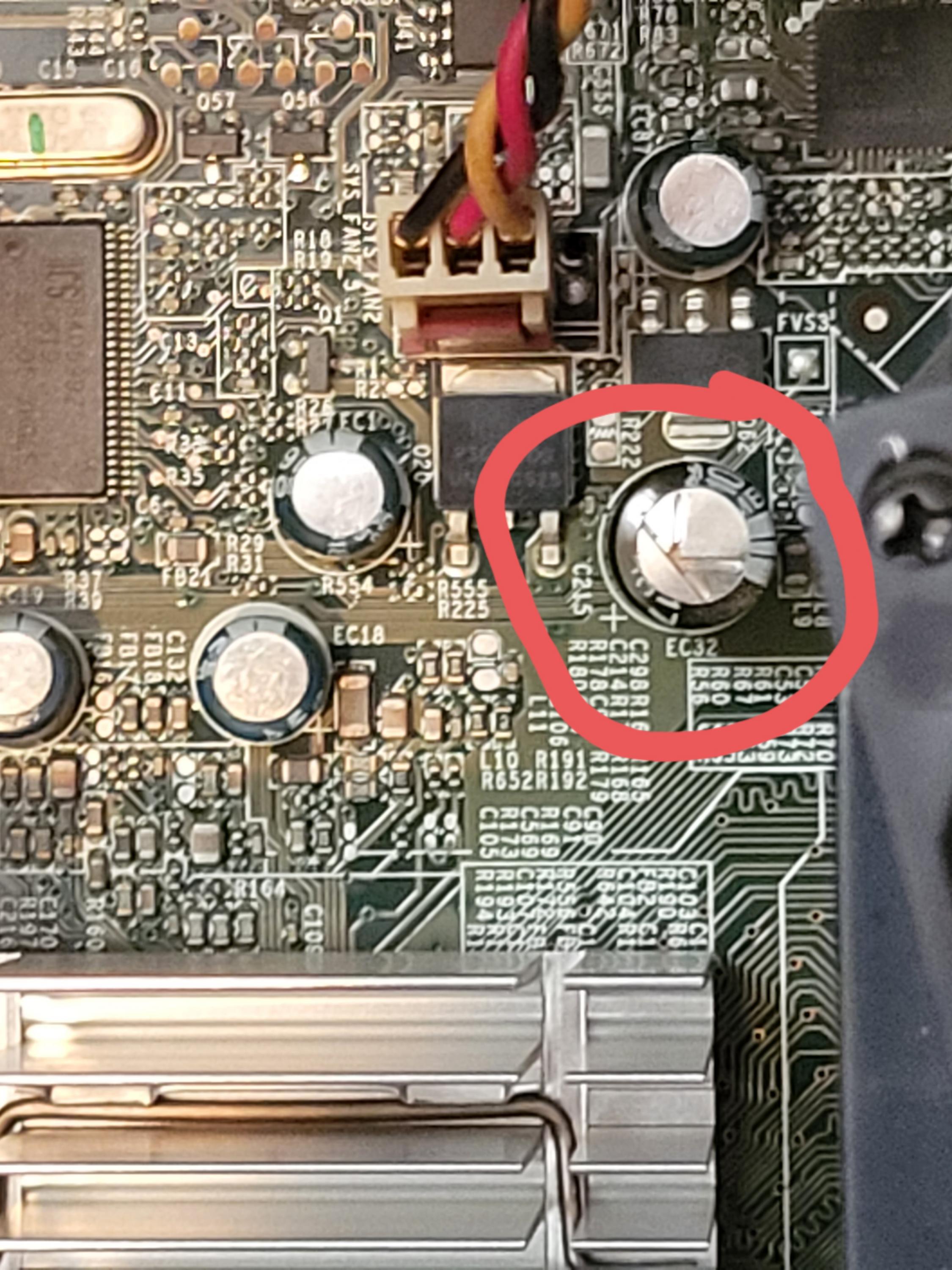

            I noticed there is one more that looks strange...
            It has burn marks on the exterior side.
            Attaching the picture...
            This one is literally along the slot where video card was plugged in.
            If it is also shot, does it even make sense to attempt to repair the motherboard?

              the part to it's right - 78l05 runs hot.

                The whole system was running super hot...
                All of the fins on heatsinks were packed with dust, so were the fans and the PSU.
                Took me a good 3-4 minutes using air gun hooked up to a 5 gal pancake compressor to clear out all of the dust.
                Doing it as a favor for a good friend of mine, but not sure if it's worth fixing.

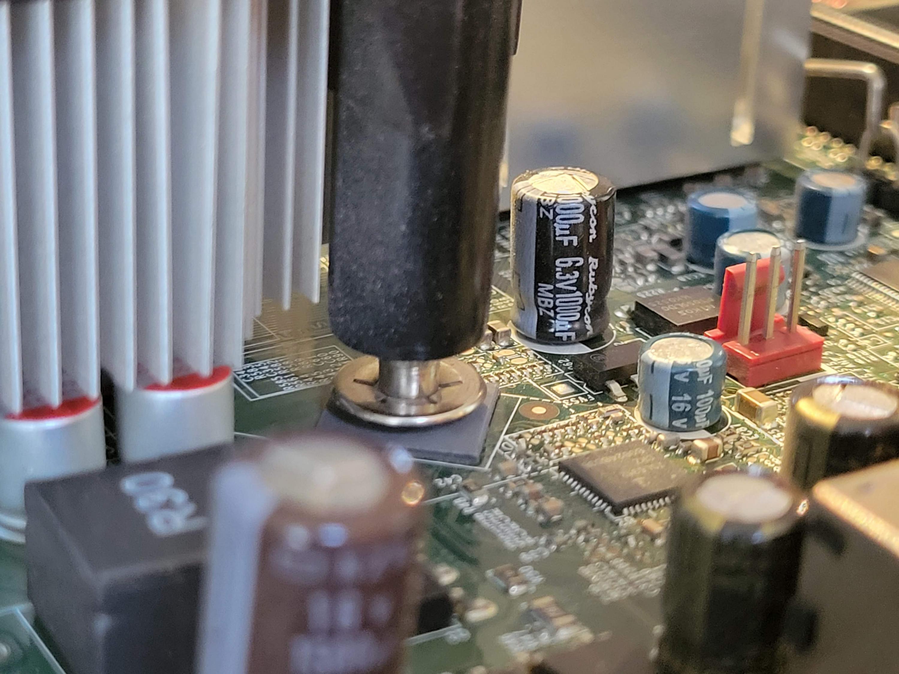

                      the zlh wont fit as it looks like its a 10x16mm part. even if its the 8x20mm part, its also too tall and may interfere with the cpu heatsink since its right next to that. the rubycon mbz is an 8x11.5mm part. if its too fat, it may collide with the adjacent smd mlcc next to the cap and not fit.
                      measure the caps and make sure they fit before sending stuff over. dont waste money and ship stuff over that wont fit!
                      it could also be just dust trapped there. i notice dust likes to get stuck between components packed closely together. that could be the zone under the video card fan where the wind from the fan blows out from. try to wipe the corner of a tissue across the area. hopefully the corner can fit through the tight space. if it doesnt wipe off, its burnt indeed! lol!

                        Heatsink won't interfere with that cap see here
                        Cap can always be bent over, doesn't have to look pretty, it just has to work. Also the polymer I have is super small. Pretty sure both of those caps will work fine. Waste money? You mean $1 to ship him two caps from 50 miles away?
                            https://i.imgur.com/OFck4x9.png

                            That cap is also filtering the CPU Vtt rail via a linear regulator, so cap specs aren't that important. Any low ESR cap will be fine. In terms of voltage, even as low as 2.5V or 4V (polymer) cap will work fine, as CPU Vtt is less than 1.5V anyways.
                            That Ruby MBZ blew up probably because it got overheated from the regulator (MOSFET) next to it, especially since the CPU heatsink was clogged with dust, which means the CPU was running hot and also making the PCB/motherboard run hot as a whole. Otherwise, MBZ is pretty reliable - or at least a lot more than MCZ and MFZ series, which are a lot more sensitive to heat (and also discontinued, so don't try buying these either.)
                            I've never seem them run that hot on a motherboard.
                            These 7805 regs usually provide 5V for the audio IC... which doesn't really draw that much current. Therefore, I'm starting to wonder if something like a surge or lightning struck that motherboard. But I guess we will find out. I still suggest to replace the blow Ruby MBZ cap and see what happens. If PC runs, clean it up a little better, check the PSU, then put it back together if all is well and be done with it.
