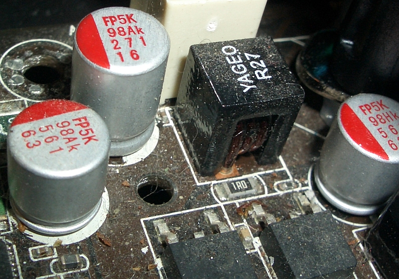

    So I find a nice asus mb on the garbage dump - had vga,dvi and hdmi and thought it might work so I took it home.

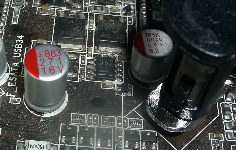

    Sure, I managed to damage a polymer cap and replaced with the closest thing I had - mb working just fine however I think the cap is a little hot.
    The cap I broke off was a Fp5K 98ak 271 16, changed it to a Fujitsu 883 271 16.
    I cant seem to find datasheet for any of these two.
    Had a look at Nichicon but cant find a 5k series or a 883 series either.
    Any idea ?

    FP series vs. markings is a bit of a mystery...
    Best I can figure, the k on the second line indicates the series, as the other series markings seem to follow that pattern. However, I can't find anything on the FP website with a "k" marking.

      I thought Fp was sold to nichicon, can't find anything there either with a 'k' marking.

        you should be ok.
        both are 270@16.

          Fp L8 series with 5000 hr. endurance ?
