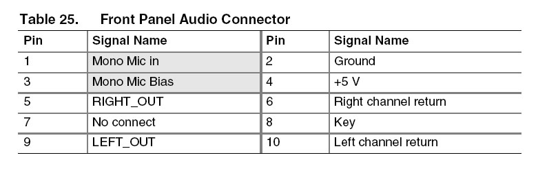

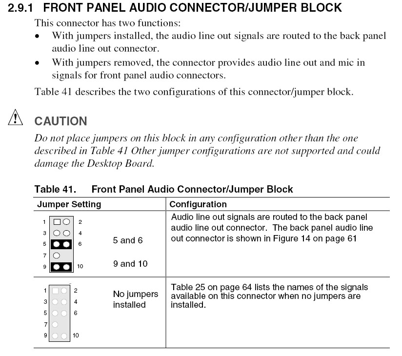

                                  • xky11
                                    • Feb 2006
                                    • 22
                                    Re: New MOBO
                                    speakers are plugged and even asked the tech at tiger he told me that on the fromt panel jumpers there should be only 2 on . there's a pin missing on one side so he told me on each side from it set a jumper looking at the diagram from mobo it says the same. also inserted the cd in board at it said that the drivers were not installed so i hit install. i remeber when i restored the HP it was the same and all i did was dowloaded the driver for the AC97 and worked fine afterwards. maybe it helps if i was to connect the mic plug and headphones. maybe thats why but am not sure where they go since the plugs are not indenticall. usb's are fine same plug's but the mic and headphone got me breaking my head. i appriciate all the help you guys are giving me. and pardon my ignorance about all this am new to this. hopefully ill get it soon thanks and if you guys think that not having the mic and headphones plugs connected to board is the issue am not sure how to set that right.
                                    • davmax
                                      • Dec 2005
                                      • 899
                                      Re: New MOBO
                                      You mention front panel connections for sound. Maybe they are not connected. Are there any sound connectors at the back panel. Green for speaker, Pink\red for Microphone. If you have rear connectors try those first.
                                      Did you get and install all the motherboard drivers for sound and video?

                                      • willawake
                                        Super Modulator
                                        • Nov 2003
                                        • 8457
                                        • Greece
                                        Re: New MOBO
                                        when you have the two jumpers on the front panel audio block (pins 5+6) and (9+10) this makes the the rear audio connectors work. If you want to use the front panel connectors you remove the jumpers and connect right channel to (5+6) and left to (9+10) on the jumper block.
                                        i would just leave the 2 jumpers on, connect your speaker or headphones to the rear green connector and try to make that work first.
