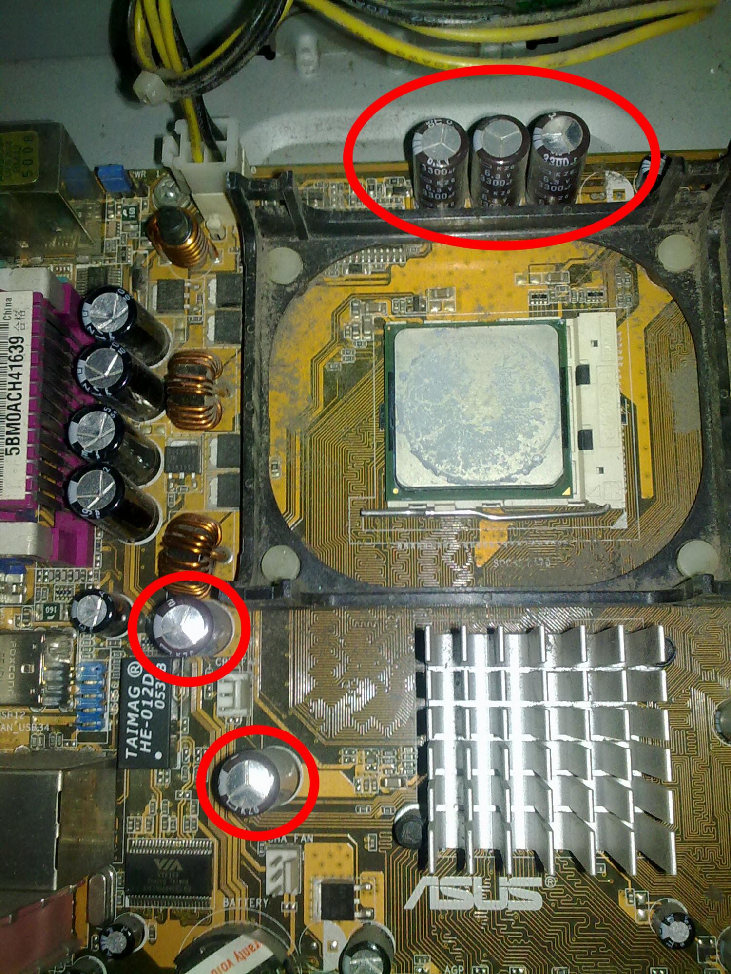

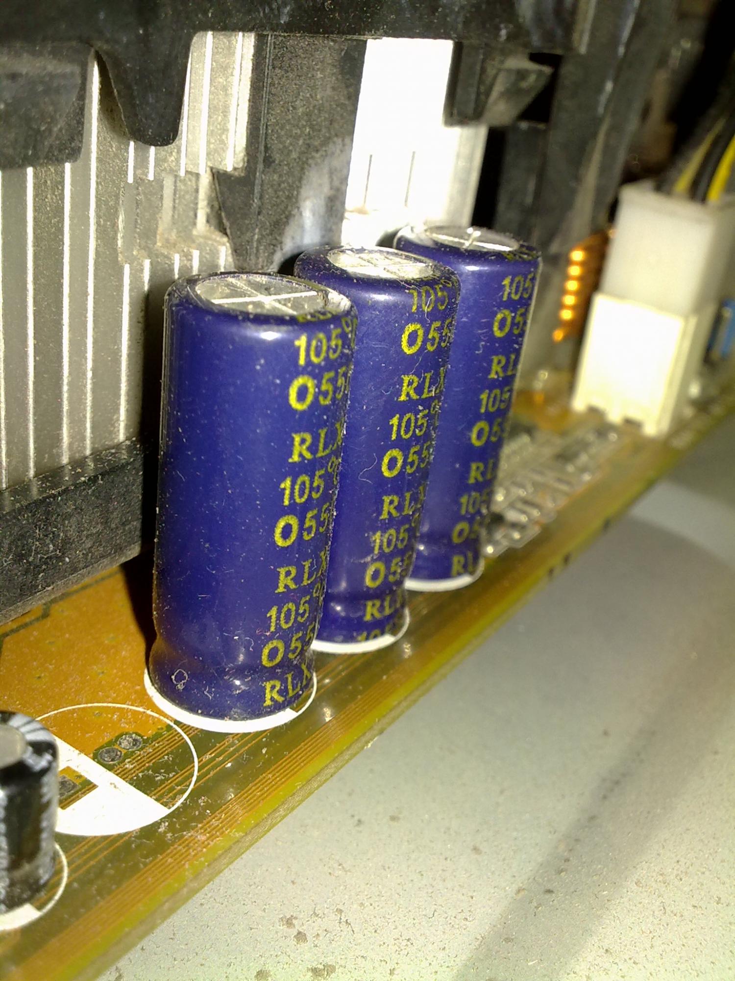

    I just got another broken ASUS board, there's 5 bulging caps on it. They're UCC KZG 6.3V 3.300uF D10mm. I see that the caps is in VRM, but i need to make sure if it's right. I also need advice what caps can be use to replace them other than 3.300uF. Those 5 caps are the only 6.3V 3.300uF D10mm caps on the board.
    Btw, i've seen more UCC caps bulging and never seen a bulging Nichicon. Is it UCC is more inferior than Nichicon?

      On some boards you simply have to use a multimeter to know for sure what caps are in a VRM.
      The group of three is obviously in VRM Vcore.
      Those other two may or may not be. By location - can't tell for sure.
      Use a DMM, if any of the two are in parallel with the three then they are in Vcore.
      My guess would be that one is and the other isn't - but that's ONLY a guess.
      Also note: It's not all that unusual for VRM caps to be mixed sizes.
      They sometimes do that in Vcore for CPU heatsink clearance.
      They also sometimes mix Lytics and Polys in either or both VRM-Vcore and VRM-High.

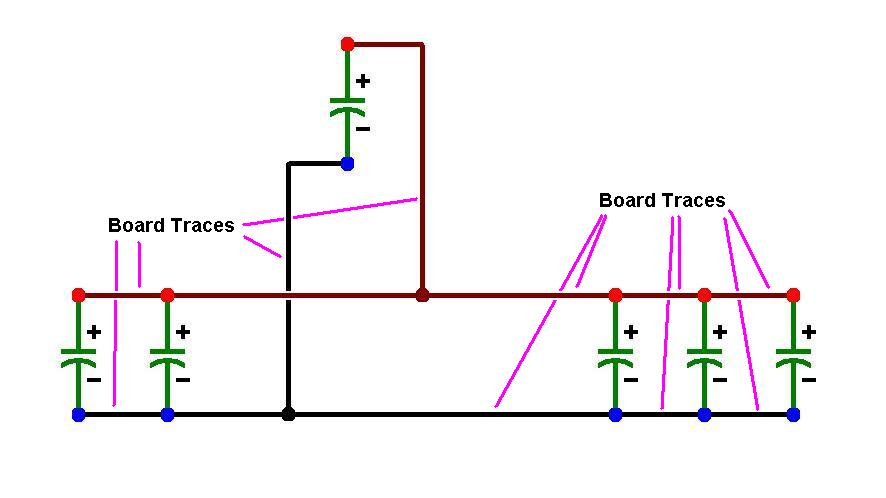

              There is no such animal as a low ESR DMM.
              It's a simply resistance check just like checking if anything else is in parallel.
              You are checking continuity [resistance checks] from one cap to another through the motherboard, not through the caps.
              If + side cap#1 has zero resistance to + side cap#2 ~ then the + sides are connected through the board.
              ~and~
              If the - side of cap#1 has zero resistance to the - side of cap#2 ~ then the - sides are connected through the board.
              When both sides are connected through the board they are in parallel.
              It's that easy.
              All the caps in pic are in parallel no matter where they are on the board.
              All the + 'solder pads' [red] are connected to all the + solder pads.
              All the - 'solder pads' [blue] are connected to all the - solder pads.

                I think you need to study VRMs a little bit.
                The VRM-high [PSU side] caps and the VRM-low [CPU side, aka Vcore] caps are completely different situations.
                They use different caps and they aren't interconnected as you seem to think.
                Mixing caps on either high or low is fine as long as there is enough combined uF, high enough Ripple for each cap, and low enough combined ESR.
                Look at the drawing here some more.

                  looks like a dual-phase vrm, the three ontop is probably the input VRM (from the PSU) and the ones on the side are the output vrm (to the CPU)
                  I can see a small cap and mosfet that are probably the vrm for the northbridge, not sure what those other two are for. but if they're KGZ, its probably best just to replace them with something similar (with simlialr values Panasonic or sanyo) and leave it at that
                    https://www.badcaps.net/forum/showpo...9&postcount=19
                    Now i begin to understand your previous diagram, so the 16V act as VRM-high filter and the 2,5V-6,3V act as Vcore filter. And combining different caps value is ok as long i use the same or higher voltage and also have a enough combined uF and low ESR, and each cap must have enough Ripple to stay flat and alive.

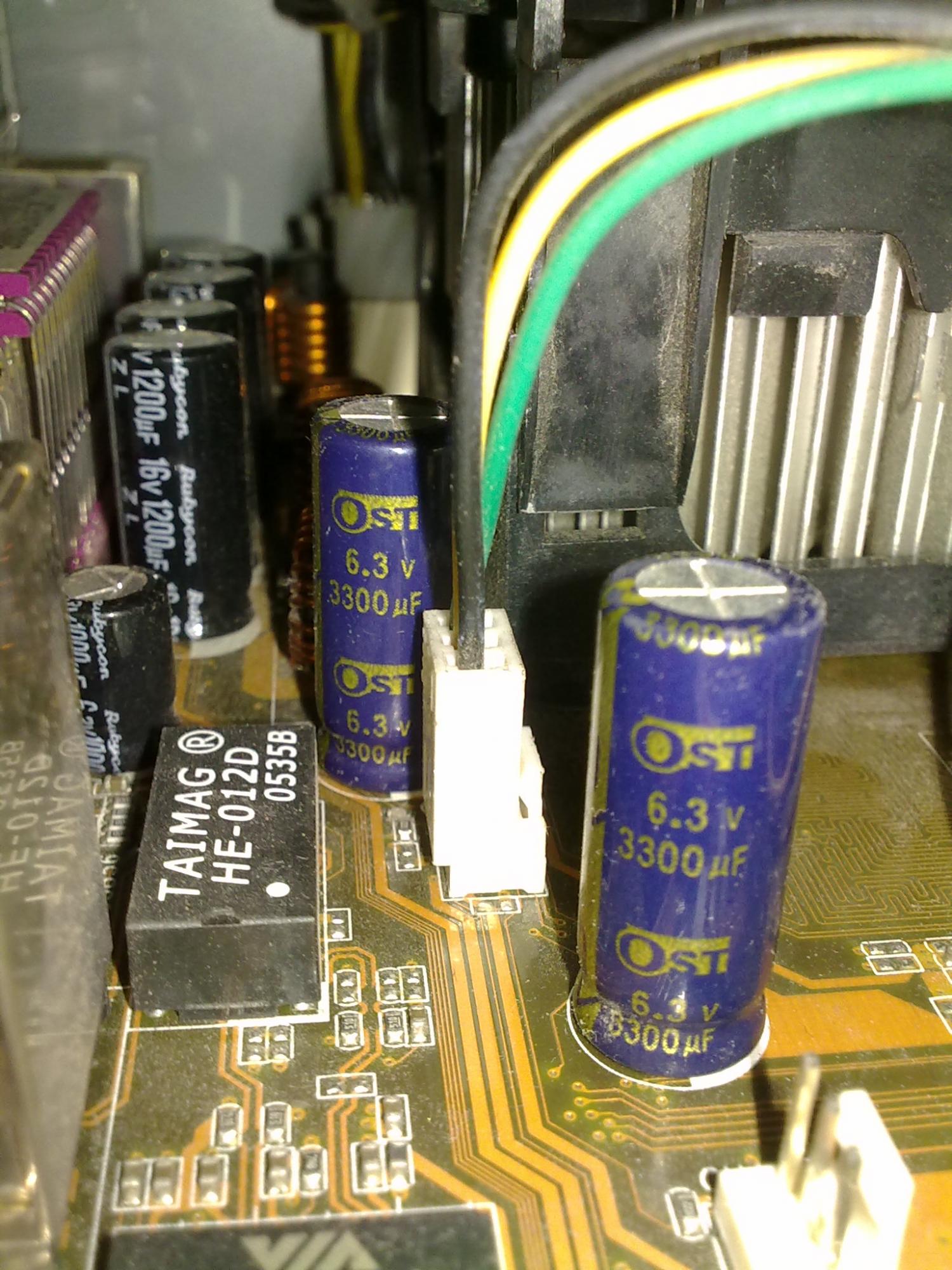

                    Anyway i've replace the badcaps with used OST caps from a dead ASRock board, i know OST is a badcap but it's emergency and my customer can't wait another week. I found out that the board has 10mm and 8mm through hole option but the only caps i've prepared are those 10mm OST. The OST caps are still fine (no sign of bulging) but i was worried those OST wont work though, but now they work well with the ASUS board and it has stop restarting by itself. But there's a new problem, the PC runs very slow. I ran SpeedFan 4.42 and i think there something wrong with the PSU voltage. I've attached the picture too, what do you think BONEZ?
                      Customers are always having an emergency and if you use cheap caps they will have another one.
                      In their mind the second emergency will be your fault.
                      [They think like that even if you tell them it's coming.]

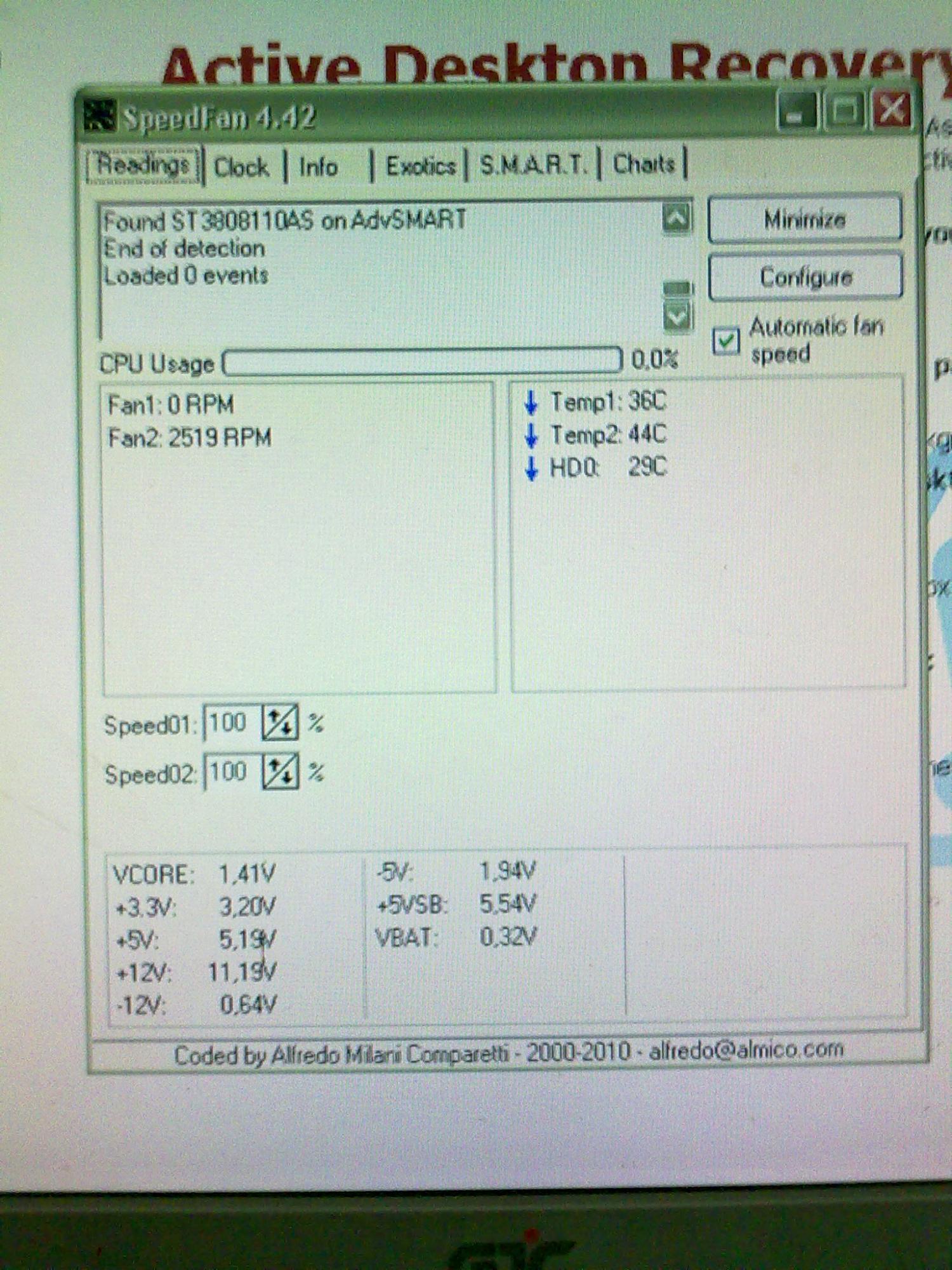

                      Don't use SpeedFan fan for that. It relies on sensors that cost like 5 cents.
                      Check the PSU voltages [with the mobo at the BIOS screen and with at least one drive attached to PSU for some more load] by sticking probes from your DC Volt-meter where the wires go into the PSU-to-Mobo connectors. [Some PSUs don't regulate well without enough load. It's easier to attach a drive to start for any PSU than to figure out if the PSU needs one.]
                      - If the PSU is bad just change it for now because repairing PSUs can eat up some time and doesn't always work. You can look at the PSU later.
                      Also check the CMOS battery. [Should be 3 volts or so.]
                      SpeedFan says it's flat so you should at least check.

                        I'll replace it when my Samxon's arrived this week, i think those OST would last alot longer than just a week.
                        Ok, i'll try that tomorrow. Do you have any diagram for 24-pin ATX2 pin out? Incomplete info = disaster, right :P
