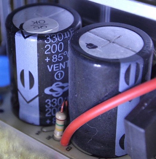

Unknown brand, "SC" logo
    I can't seem to identity these caps, I've never seen this logo before. I'm a long time viewer of the forum. Thank you.
  • yyonline
    • Jul 2009
    • 692
    Re: Unknown brand, "SC" logo
    According to:
    http://capacitor.web.fc2.com/c.html#cs
    they are "Chun Shing" capacitors.
    The company's website doesn't seem to work very well:
    http://www.12kj.com/docc/product.htm
    I see them from time to time, mostly in cheap power supplies. The ones you have pictured appear to be input filter caps. Primary input filter caps rarely fail, but the ones here can likely be replaced with any reliable brand of general purpose capacitor.
      Thank you.
        They are alright. I've only seen them fail in crap power supplies when put next to those minimum load resistors that run very very hot. My old Spire power supply also has them (apart from the cheap caps the build is quite nice) and it still runs fine.
          Where other than crap PSUs have you seen them?
          I've only seen them in crap PSUs.
          And they failed.
            I've seen that logo a couple of times too, in cheap stuff.
            If you were doing a recap job in a PSU with those you might as well replace them too and save yourself potential future headaches.
              Saw ones with that brand bulging and leaking in 2 CoolMax PSUs.
              Appears to be common in CoolMax PSUs.
