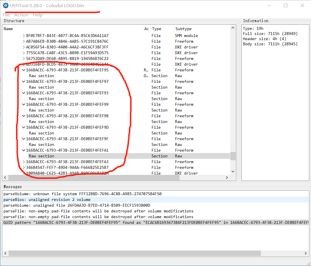

    CLEVO PCB:6-71-V2500-D02
    Hi! I encountered a Clevo brand laptop that needed its boot LOGO modified. I found the LOGO address, but after the modification, the machine stopped displaying it. I'm puzzled. It worked normally before the 11th generation of CPUs, but it stopped working from the 12th generation onwards! The LOGO addresses are:
    166BACEC-6793-4F38-213F-DE0BEF4FEF95
    166BACEC-6793-4F38-213F-DE0BEF4FEF97
    166BACEC-6793-4F38-213F-DE0BEF4FEF99
    I have provided the BIOS and LOGO files that require LOGO modification, and I hope someone can help me.

    Sorry, I'm replying through Baidu Translation. I don't know where to post a new thread for help. I hope you can forgive me. Also, could you please help me move my request thread so that I can seek help? Thank you very much!!

      post S/N, full name and model, motherboard model, etc.
      post the contents of the bios chip even if it is corrupted..

        Computer model: Colorful Hidden Star P16 23
        PCB:6-71-V2500-D02
        The original backup is no longer available, and the only thing we have is the BIOS file with the Clevo boot LOGO. We need to modify the LOGO in it.
