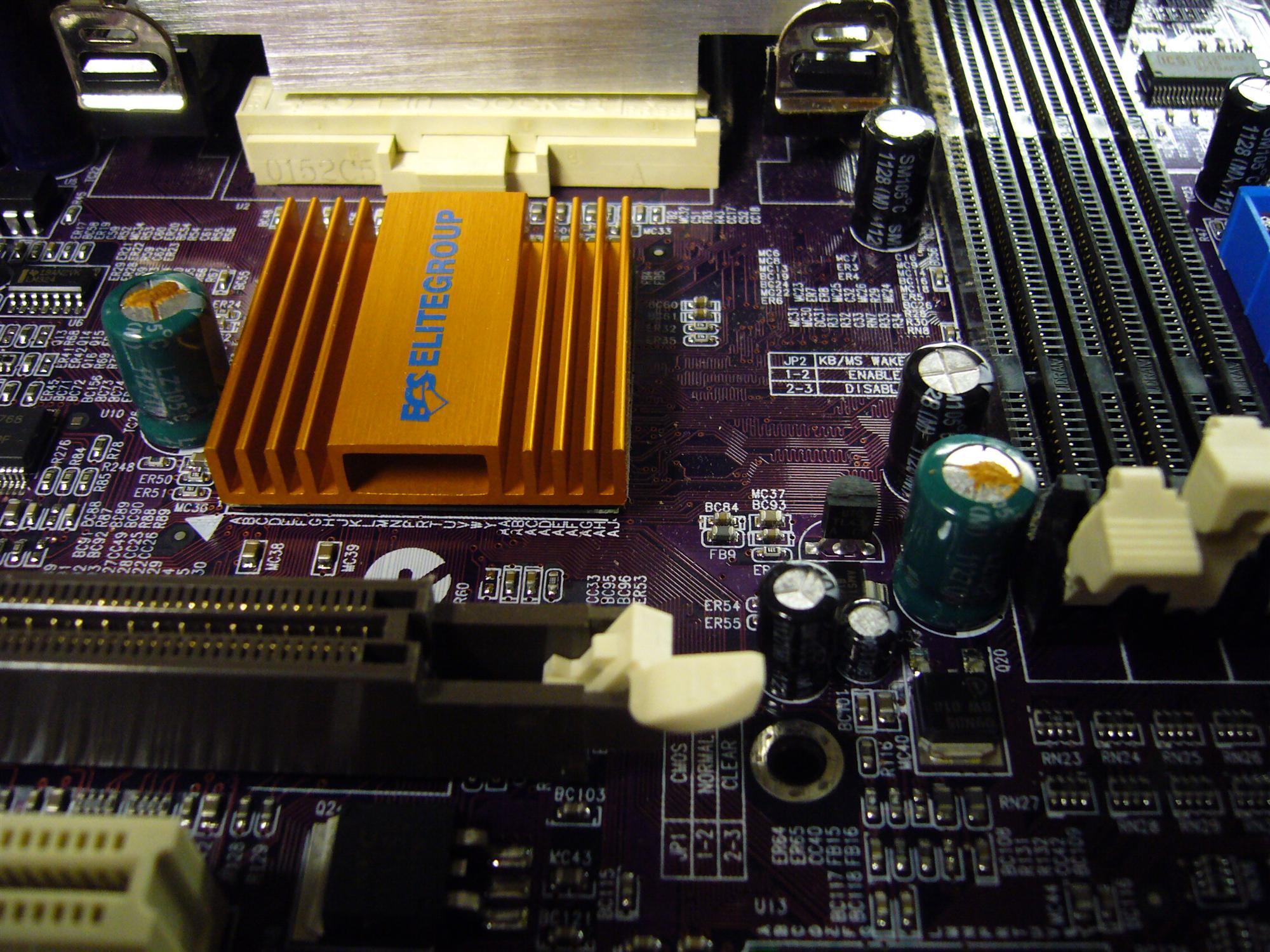

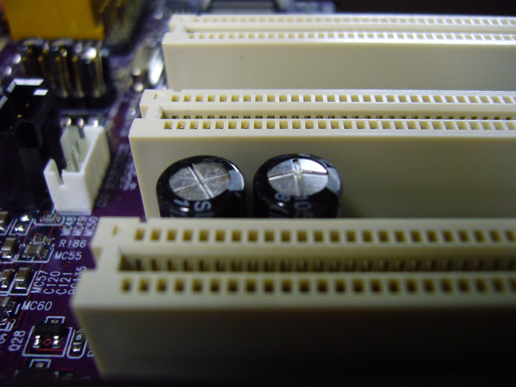

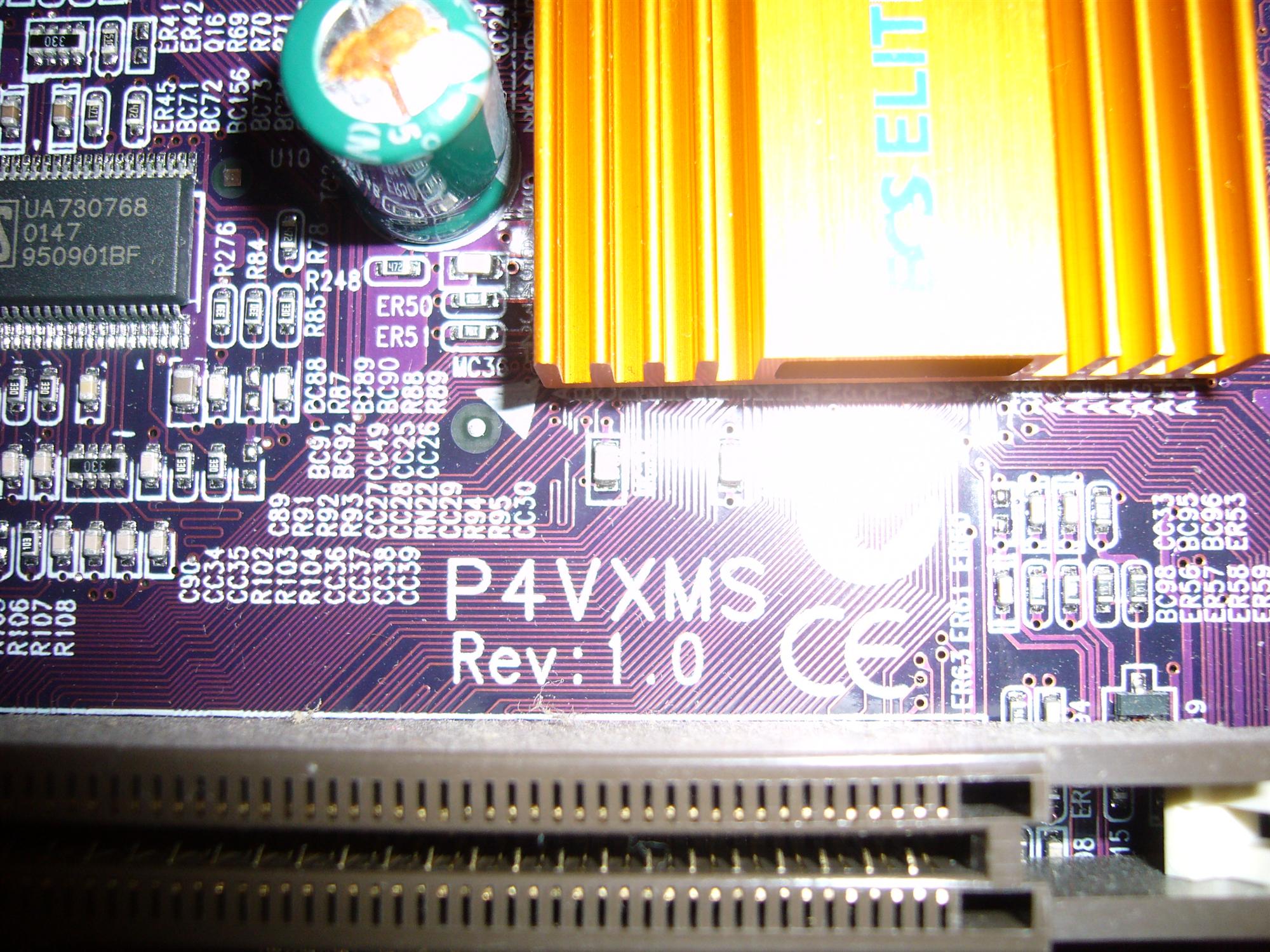

                  You make it sound as though I'm too lazy to look at the specs myself, but the truth is that I've looked up specs, but I don't know how lenient I can be, especially for the different parts/circuits I run into. Without asking those who know, there isn't a lot of option, unless you're going to order exact replacements for every cap you pull.
                  I've provided some pics below to help you get a better idea. Obviously, some specific help for this particular board would be appreciated, but I don't feel like I'm getting a very newcomer welcome here.
                  I'm not new to electronics at all, but I'm new to working directly with capacitors, and again, any helpful information is appreciated. Specifically, I'd like to know more about replacement compatibility for different circuits. A good example would be that you can use a higher voltage cap of the same capacitance, but not lower. Seems very common sense to me, but on the other hand I wouldn't have been surprised to learn that you *couldn't* do this.
                  The caps pictured are the 1500uf/6.3v and the 1000uf/10v, respectively.
                  Thank you.

                      G-Luxon LZ series: 6.3V 1500uF 10x16 mm has the following specs:
                      Ripple: 1070 mA @ 100 @ 100 Khz
                      ESR: 0.055 ohms
                      For your replacements you have:
                      Rubycon MCZ 6.3V 1500uF 10x12.5 mm
                      Ripple: 1960mA @ 100Khz
                      ESR: 0.016 ohms
                      Samxon GC 6.3V 1500uF 8x20 mm
                      Ripple: 2220 mA @ 100Khz
                      ESR: 0.012 ohms
                      You want to have the same or more ripple.
                      You want to have the same or less ESR.
                      Of course, this is within reason. Drastically more ripple, or drastically less ESR may cause issues. It probably won't, but it has the potential to.
                      MCZ nearly doubles the ripple, and has 70% less ESR. This differs greatly from the specifications of the original. Will MCZ work? Probably. But the specs are very different, so there are no guarantees. If you don't want to spend the few dollars needed to get replacements closer to the originals - replace them and see what happens. Odds are it will work just fine - It looks the two LZ that are pictured are on the memory and chipset power circuits. Lowering ESR there shouldn't cause issues, I don't think. (Someone more knowlegeable feel free to correct me.) If it doesn't work after replacing them, get replacements that more closely match the original specs.
                      You mention there are 3 bloated 1500uF LZs, but I only see two in the photos...so I can only comment on the two I can see.
                      The GC are even further away form the original specs...use MCZ here if those are your only options.
                      SM are general purpose capacitors, they are not low ESR. When I run into GP caps on a motherboard, I will usually replace with an "entry level" low ESR cap like Panasonic FC. Will replacing with an ultra low ESR cap like MCZ or GC work? Again...probably, but no guarantees.
                      You're more than welcome on the boards. It's not a hostile reception at all, it's just that we just get the same questions on here a lot. It seems like the answers of some of our more knowledgeable members are on repeat answering the same questions again and again. You can learn the answers to a lot of your general questions by searching old posts. Sure, it takes awhile, but we all had to do that at first. Once you've done that, and have a basic understanding of the concepts, if you want information about your specific case, we need all the information we can get - that includes measuring the sizes, getting series info, taking detailed photos, etc. If we don't have enough info, we have to guess...give you some options...and you have to fill in the blanks.
