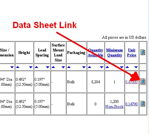

      Digikey ads have links to the data sheets. [So does Mouser.]
