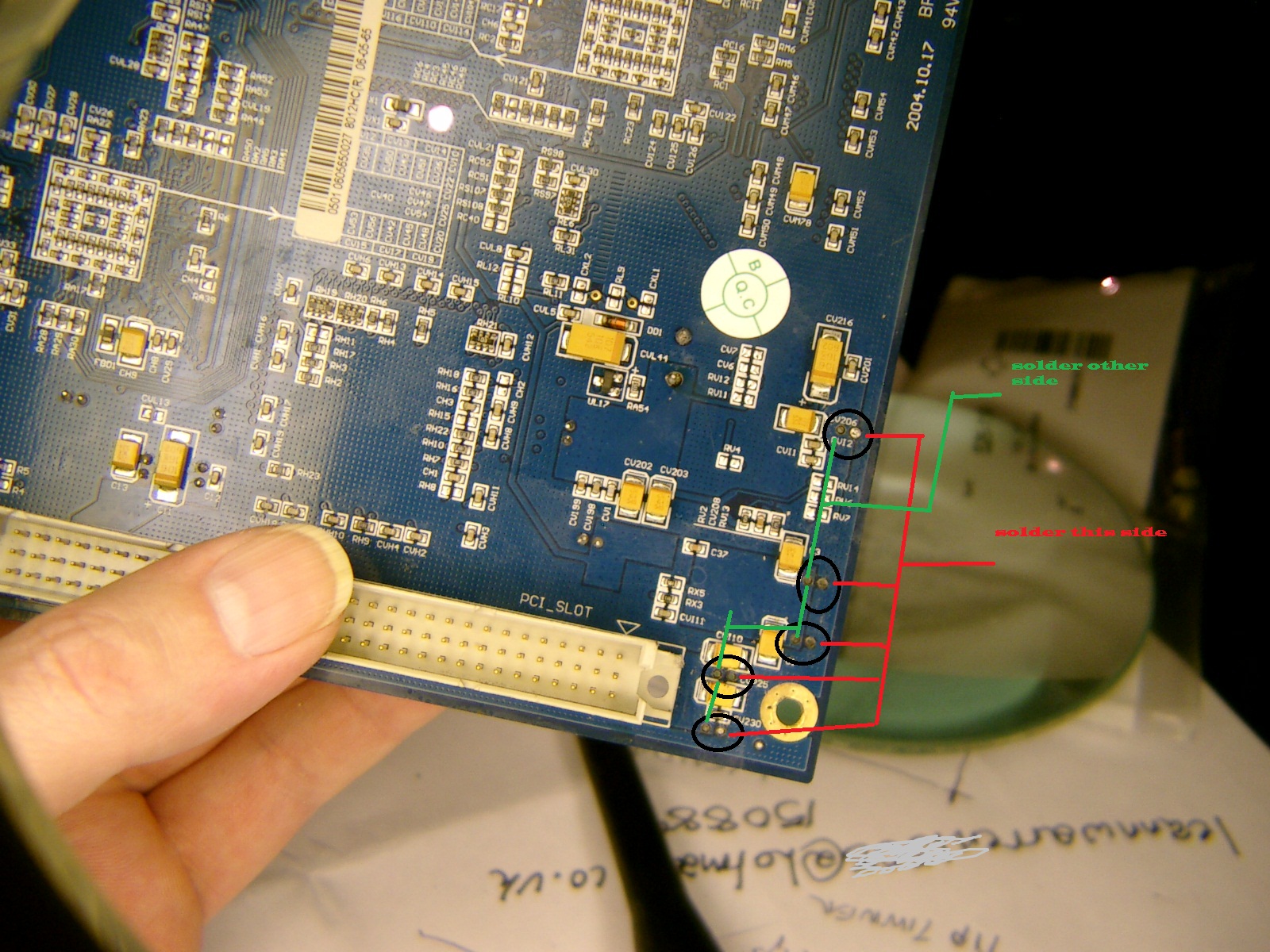

                        • lee123
                          • Mar 2011
                          • 14
                          Re: CCTV capacitors
                          with 5 caps removed
                          • seanc
                            • Nov 2008
                            • 1319
                            Re: CCTV capacitors

                            • lee123
                              • Mar 2011
                              • 14
                              Re: CCTV capacitors
                              dam, now replaced 5 caps and still keep rebooting every 5mins, when its cold and on boot up they are 5 chips come up on the monitor display, the 3nd one has a X on it and cams 10, 11, 12, and 13 dont work, also the front panal cam leds 10,11 and 12, are off.
                              when it get warm thats after about 20mins and 5ish reboots later it seem to be OK and all cams work, no X, and all leds light up,
                              seanc :- you seem to have come across this board before, have you or anyone got any information that may be helpfull,

                              • Agent24
                                I see dead caps
                                • Oct 2007
                                • 5027
                                • New Zealand
                                Re: CCTV capacitors
                                So are you saying that you can't solder the new capacitors because the solder is on the component side?
                                This would not normally be a problem, the holes should be plated through-holes and solder will flow from one side through to the other, you don't need to solder on the component side.
                                If the solder isn't going through it may be that your iron is not powerful enough and can't heat the board properly.
                                This is just a guess based on your photo and notations on it.
                                Can we get some more photos, showing everything on the board? If the issues seem heat related it could be some other faulty part or bad soldering... can't say much with only looking at a small corner of the board...
                                -David VanHorn
                                • PCBONEZ

                                  • PCBONEZ
                                    Grumpy Old Fart
                                    • Aug 2005
                                    • 10661
                                    Re: CCTV capacitors
                                    I think no.
                                    My take is the asker tried to remove and re-install the old caps and the legs were too short.

                                    • lee123
                                      • Mar 2011
                                      • 14
                                      Re: CCTV capacitors
                                      as its an old pcb and the caps were lose then the plateing in the holes had come away with the solder when removing, so i put new cap in and have left the sitting high so i can solder from other side, will post more photos as soon as i can. thanks lee
