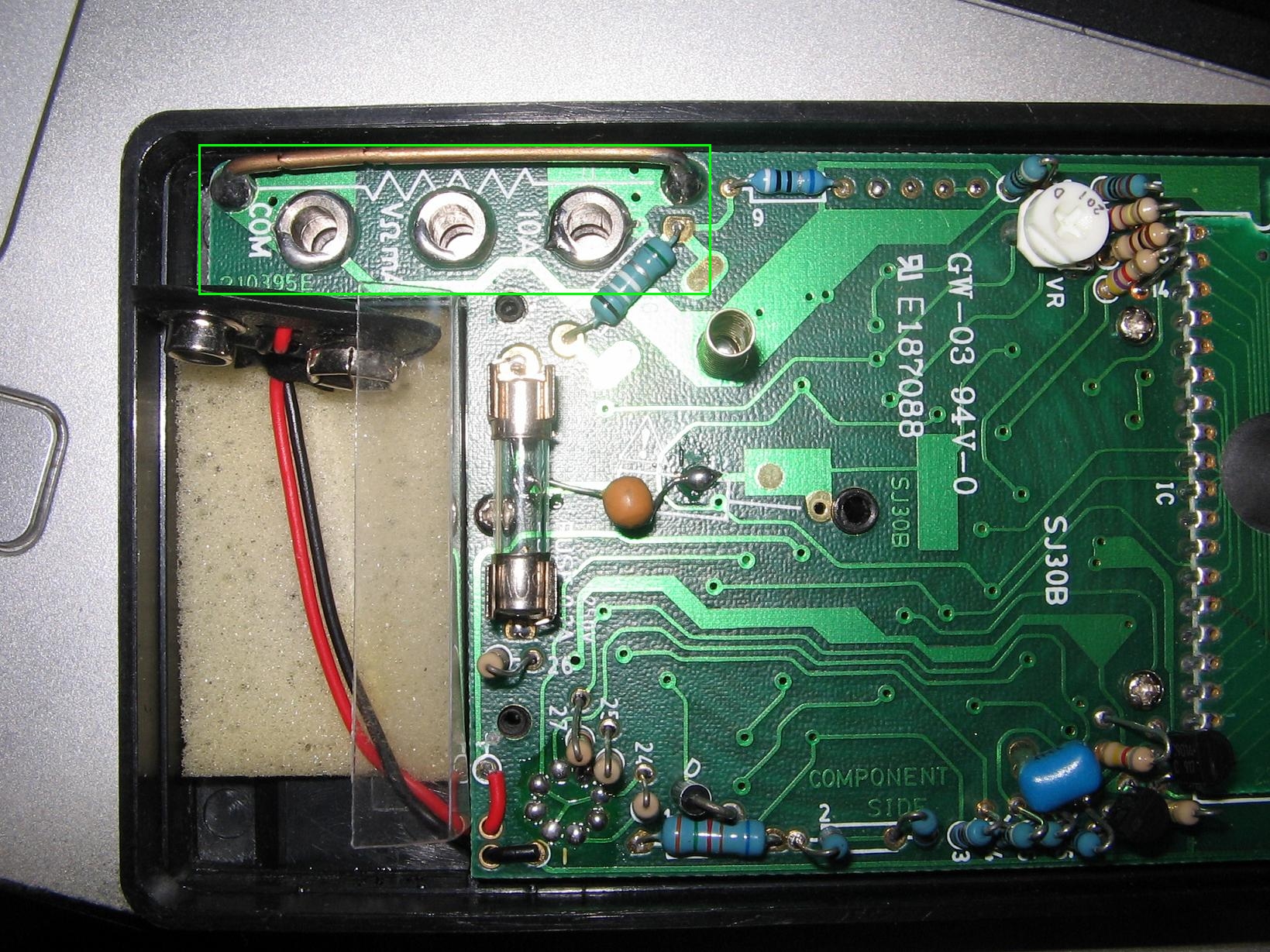

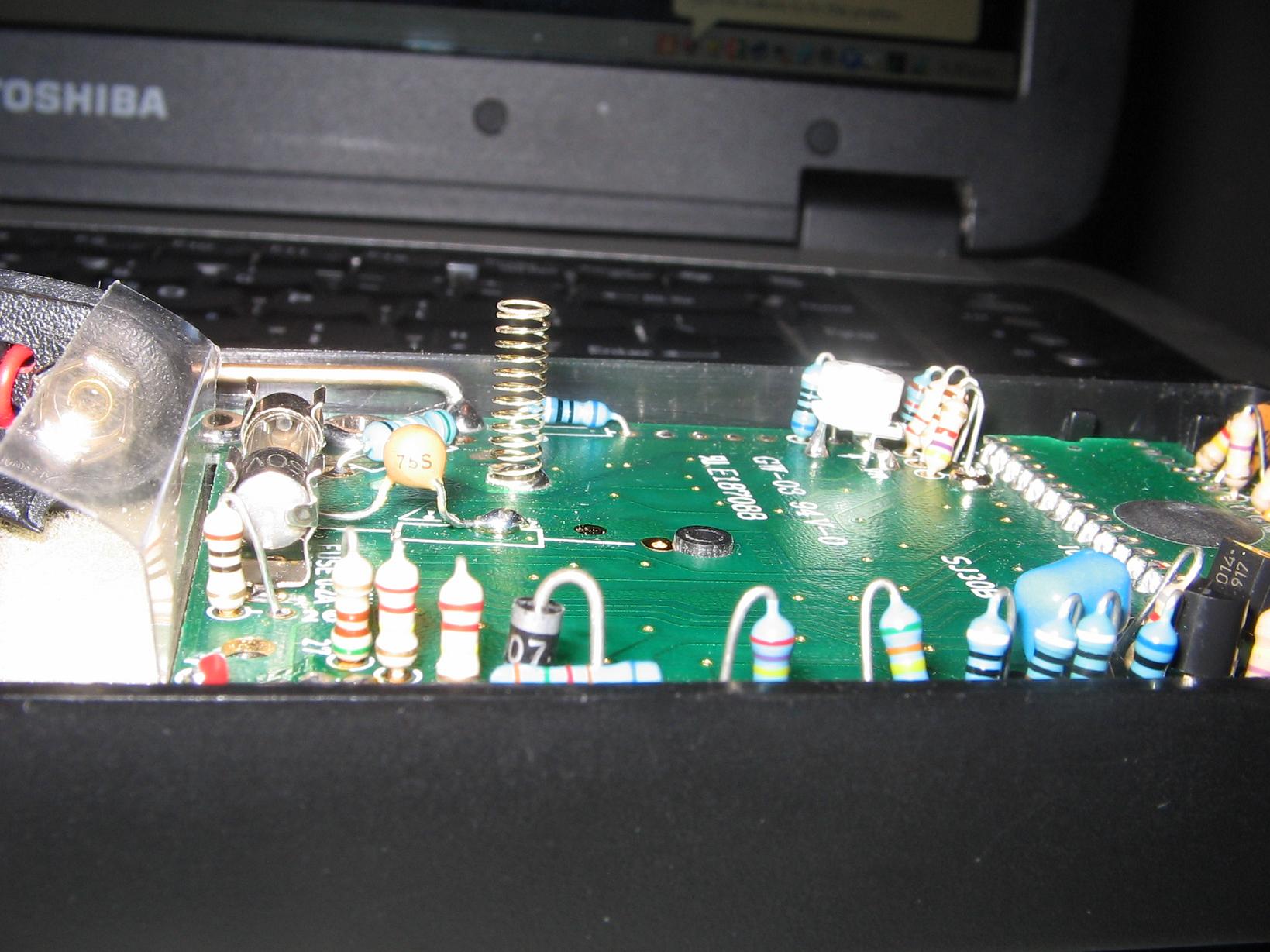

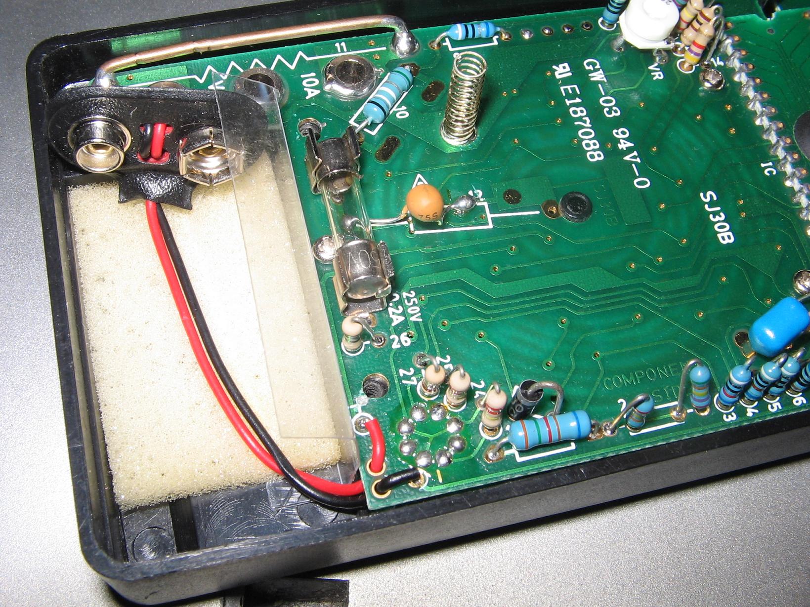

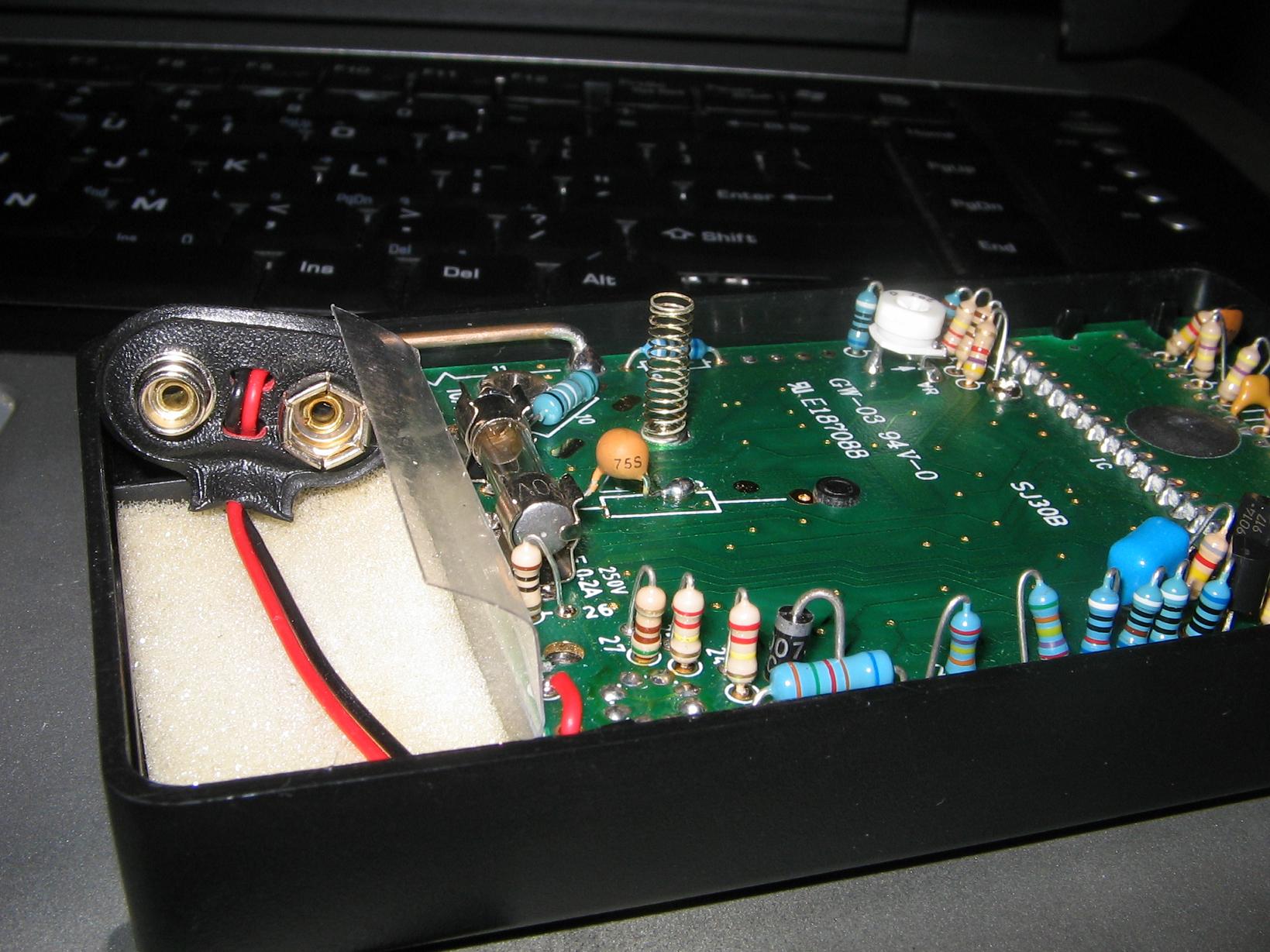

        I would love to see pictures of the insides of this multimeter. I'm studying multimeters and like to learn more.
        Sure, here they are.
        -David VanHorn

          One of the nicest 830's I've seen.
          An insulator between the battery and board.
          Board is one piece!
          I've outlined the board in your pic, showing where that stupid 'jack board' would normally be. It would only be held by solder!
          Did you trim and resolder the leads for the transistor socket? The bad 830s would have those leads left as long as a quarter inch!
          You may continue to use that, *carefully* of course

            No I didn't do any modifications to it, the photos show how it came from the shop.
            Sounds like the cheaper versions are pretty bad though!
            Only bad thing with mine was that the test leads broke in months, can't remember details but I got much better ones from DSE which have been perfect ever since.
            -David VanHorn
