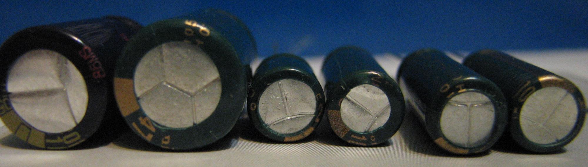

    So I was at the electronics shop today, and instinctively I beelined toward the capacitors section. they got quite a lot of new stuff and for some reason got rid of a lot of their old stock GP caps.
    What I discovered was astonishing.

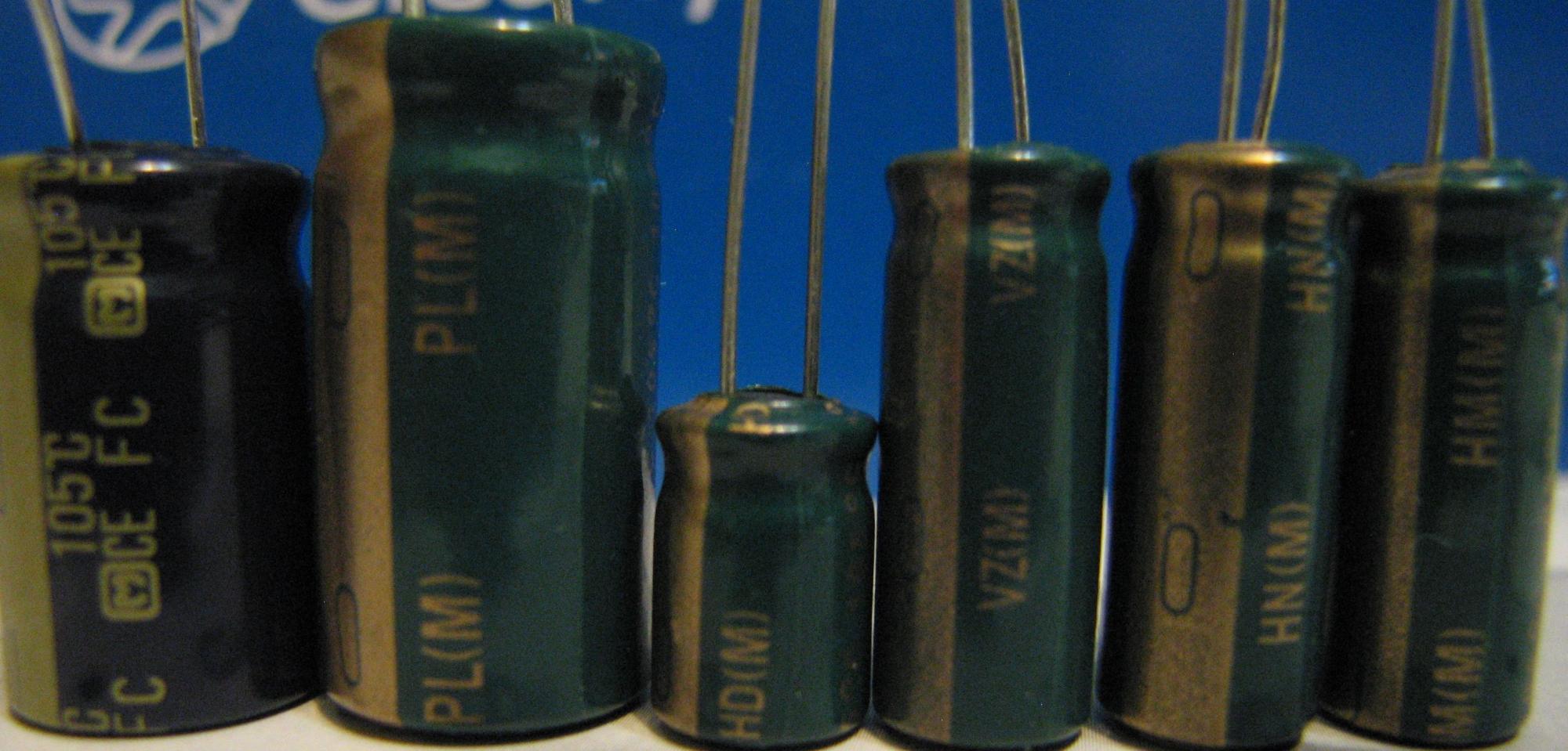

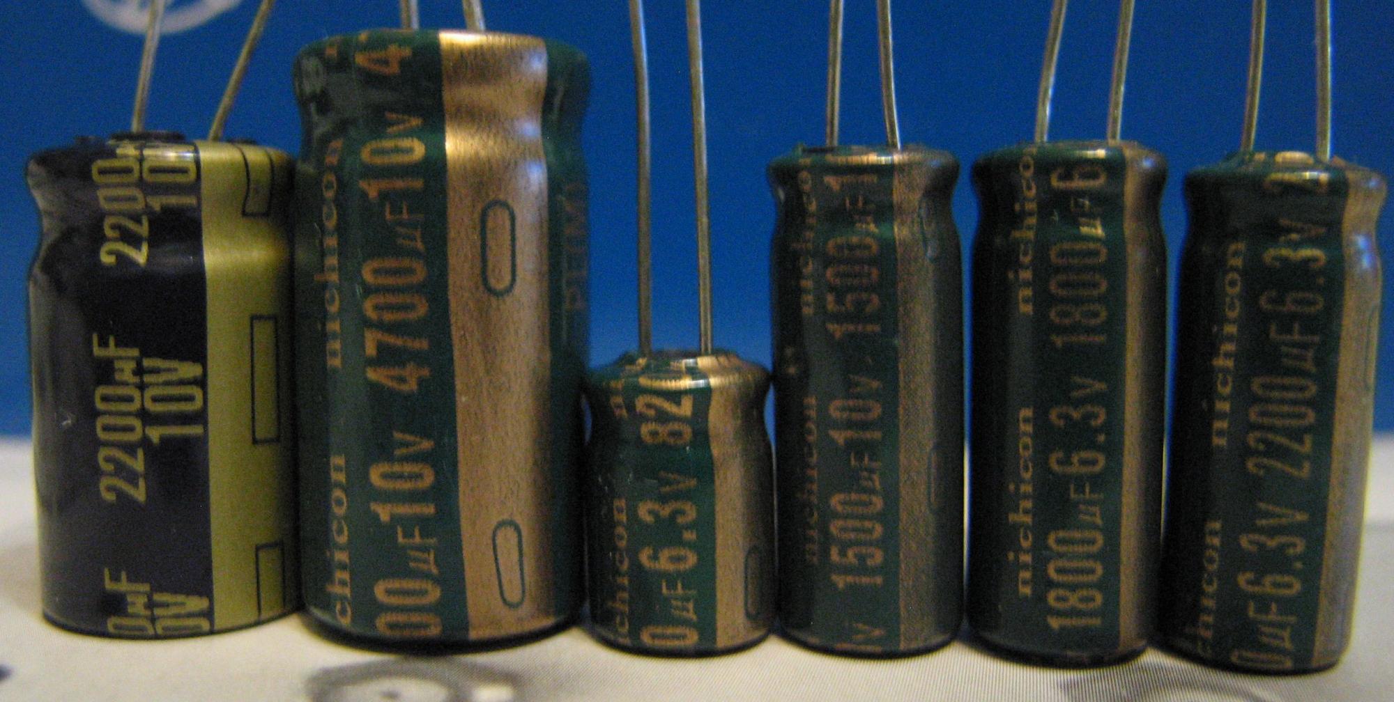

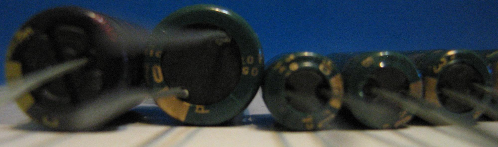

    Notice the Panasonic T vents are being used on these obviously fake green Nichicon HD, HN, and HM. These guys are learning. Gone are the days when all you had to do was look at the bunge. The bunge on the last capacitor on the left, a Panasonic FC 10V 2200uF, looks impeccable but this is NOT a real Panasonic FC, it is also a fake. A very good fake. It is rubber and not synthetic like a real FC. It's also flimsy, if I put a little pressure on it, it recedes into the can. Sorry about the image quality on the bunge shot.
    Sorry, no inline pics, files are too big. Also, for some reason PHPBB is further compressing my JPGs.

    Oh they are getting really good. On the last photo, the one on the right looks a lot like a real one (no stamping marks and a completely flat top).
    Just waiting when they are going to be the same, even in quality specs

      Even the rubber seals look like panny. Maybe they are really made by panny?

        I'd be more than willing to send these to someone with an ESR tester. The FC is most definitely a fake, eventhough it looks almost completely real.

          and since nichicon does not use that shade of green....
          the print looks poor too.
          i have already found some of the green vz in a board sent in to be recapped.blown up.fake.

                          The Nichicon PL series unit looks like a resleeved Jamicon or Hermei through its hexagonal vent.

                            A year or so ago, when I knew nothing of fake caps, I ordered a bunch of those fake green Nichicons. I remember I needed some 10v 1500uv 8mm caps, and these were all I could find on the web. I took one look at them and decided they were fake. The ESR was acceptable, but the capacitance was way low - about 1050 vs the 1500 specified. Needless to say, I didn't use them. Later I found FJ/FL OEMs on the web and these turned out to be the real deal.
                            So whenever I see green Nichicons I see fake. The Panny FC would have fooled me. I would not be buying these anyway as FMs are readily available in North America.
