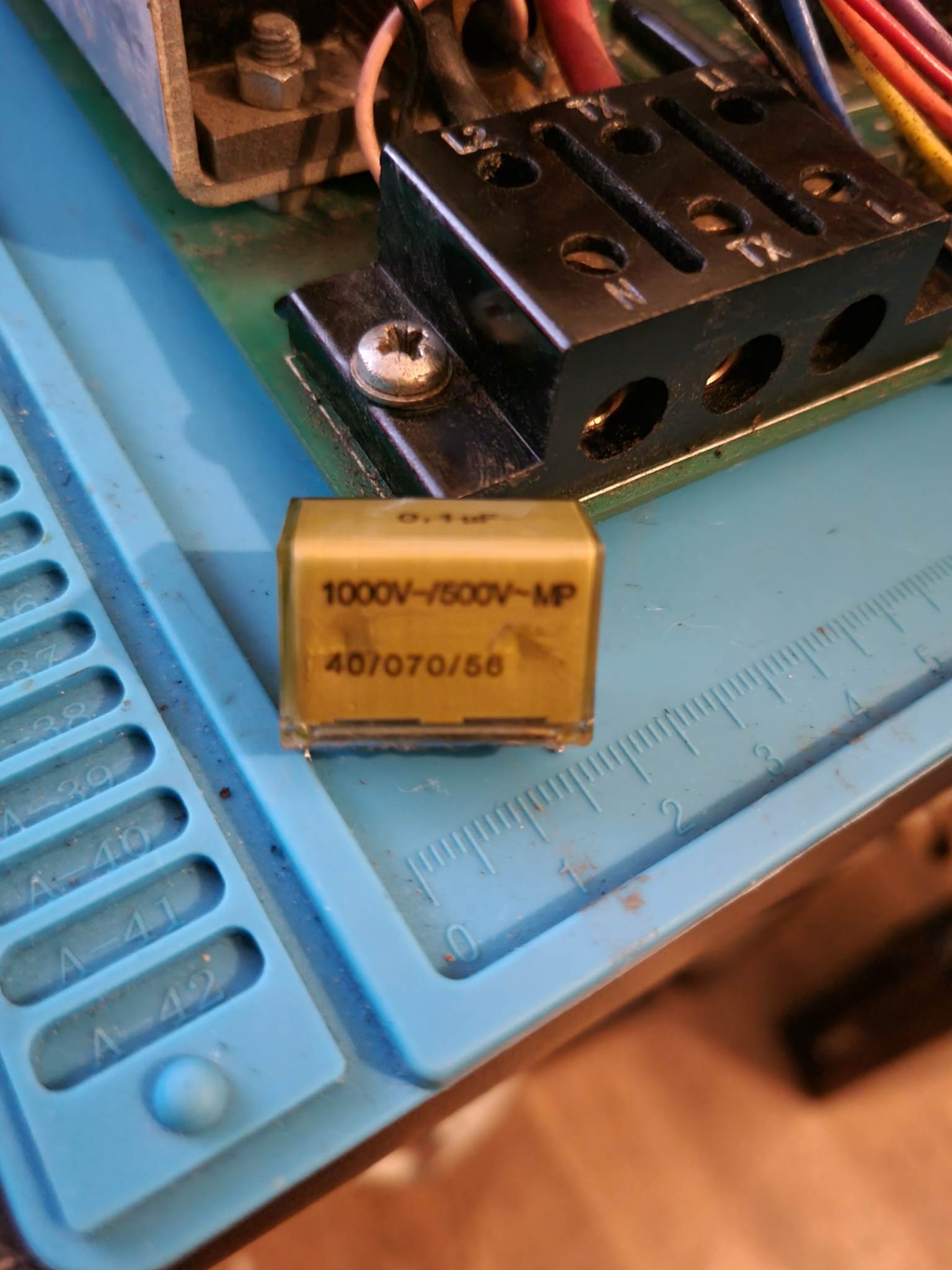

    Spot welder capacitor blew up should just replacing them fix it? The board is very dirty gonna remove it and clean it an see if I notice anything wrong that could cause this issue.

    no, dont risk it.
    clean the board up and post pictures.
    if a diode went short-circuit and hit the cap with AC that would do it - and do it to the replacement too!

      It kinda looks like a Rifa

        Yea that is a Rifa capacitor, just replace all of them with the same values.
        Just look for the safety rating of it and replace with the same or better Y or X class capacitor.

          yes its a RIFA a quick google they seem to be famous lol
          best way to clean this board? im using iso alcohol and a brush but it seems to be just moving it from one place to another

            this is the same as mine is it ok to use these? or is there a better equivalent?

              what is on the side of the old one?

                  Re: Spot welder capacitor blew up
                  same as the above link above

                    There is more info written on the side of the Rifa capacitors, the top just says 0.1uF. They're X caps I guess 300VAC or more.
                    You would need the lead spacing mm and voltage rating to find replacements.
                    For cleaning the board, I use a gentle toothbrush and a little compressed air- not too much which makes static electricity and damages things.

                        The only way to get this board clean would be with soap and water.
                        I would not submerge things like the buzzer or relay though.
                        So best to use maybe a toothbrush and be quite liberal with it, but not submerge it fully...
                        You can then wash that off with the IPA and after drying it should look much better

                          I would not use Rifa/Kemet PME261's as replacements, the one you picked is ordinary PME261 "General Purpose AC/DC, Metallized Paper" and has no ratings for across the line use. Those are another part number PME271M or PME271E.
                          Rifa oddball sizes are the only LS=20.3mm parts, but I would stuff in a standard 22.5mm part which would fit.
                          The reason to worry about it is there is no fuse for these and they would totally destruct the board in fire.

                            i used a tin of electrical component cleaner had lots of pressure worked rather well

                              i just got the ones in the link as i have no clue of a suitable replacement lol
                              they look the same have the same part number pme 261 jc and they seem to work. have you got a link to what you would you use? might change them in the future
