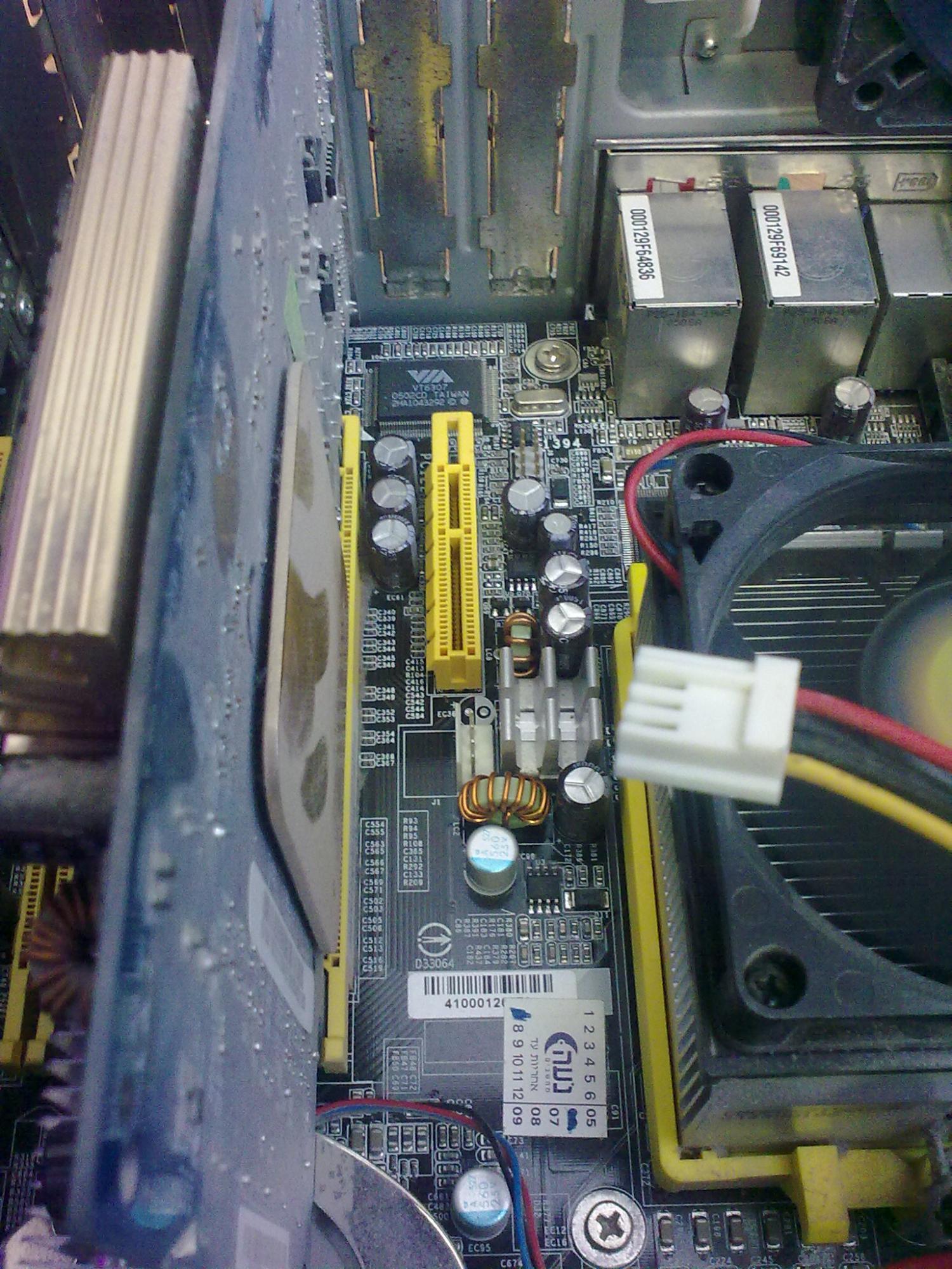

    I have a DFI Lanparty board, with NF4 chipset socket 939.
    It have a problem of random crashes with no matter the work i'm doing.
    It can be stable for hours or crash after half an hour.
    I disconnected all components and tesed it again, still crashes.
    I looked over the whole board and psu for signs of bad caps and found only one issue:
    The PSU looks ok except tons of dust, The mobo has all capacitors flat and looks good except two caps near the cpu socket that aren't realy bulging, just different from the other caps in the whole board.

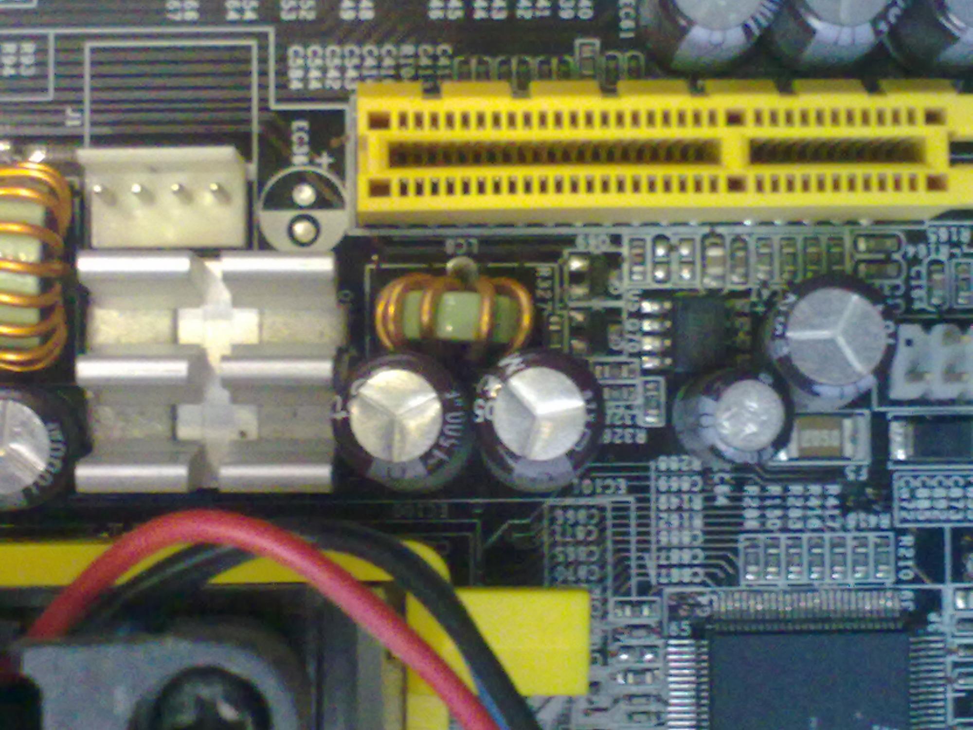

    These are the Caps in question:
    Please help me solve if these are messing me up or i need to check for other problem.

      They look like they are starting to bloat to me.
      Are they KZG?

        All caps have KZG written on them, are KZG not good?
        All with straight heads, only these two are little bloating.
        I think these are the only one of it's kind on this board spec'wise.

          Chemicon is generally a good brand but their KZG [and KZJ] fail due to heat.
          Good replacements are Rubycon MBZ, MCZ - Sanyo WG - Panasonic FL, FJ.

              Yes and Yes.
              KZG don't always bloat when they go bad.
              Replace all of them.
              [OST [any series] does the same thing. - Fail w/o bloating.]

                  With KZG bloating doesn't matter. - Just replace them.
                  - All the KZG [from 6mm diameter and up anyway] need to go bye bye.

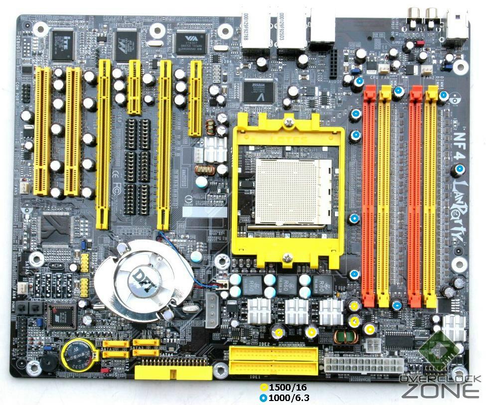

                                Those caps in the pictures are in PCIe optional voltage regulator circuit, they are not problem I guess.
                                firstly, try to change all 1000uF/6.3V caps around DIMM slot and 1500uF/16V in CPU voltage regulator circuit.
                                see attached pictures, colored circles.
                                I also have three set of DFI Lanparty NF4-D/Ultra-D and they're still working fine.

                                      Yes, I agreed.
                                      I suspected all KZG's 1000/6.3V around DIMM slots.
