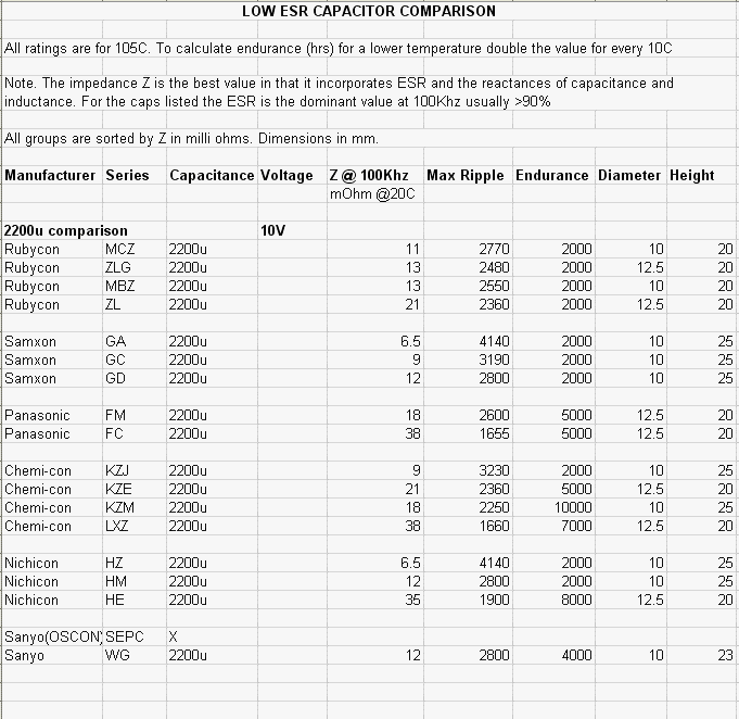

 3.3 Reference of Good Capacitor Series for Motherboard Applications
 Aluminium Electrolytic Radial Capacitors (Liquid Electrolyte)
 Good manufacturers, with their caps in order of highest to lowest ESR (lower is better, but usually higher cost):
 Nichicon : PM , PW , HE , HD , HV , HM* , HN* , HZ
 http://www.nichicon.co.jp
 * HM and HN with manufacturing years 2000 to 2005 are NOT good caps! All other Nichicon series are good. *
 United Chemicon : KMG , LXZ , KY , KZE , KZH , KZG* , KZJ*
 * KZG and KZJ are NOT good caps! They will even go bad on the shelf! All other UCC series are good.
 Note: possibly this series is ok with 2008 and later manufacturing years*
 http://www.chemi-con.com/
 Rubycon : YXG , YXH , ZT , ZL , ZLH , ZLG , MCZ
 http://www.rubycon.com/
 Series Chart, List of Substitutes for Old Series
 ZL is probably the easiest to find and our badcaps.net can supply top Rubycon caps or similar, please PM Topcat
 Sanyo : WX , WG
 http://www.sanyo.com/components/
 Panasonic : FC , FM
 FM is sometimes cheaper than FC and better. Both are great though.
 NIC Components - NRSZ , NRSJ , NRSG , NRSX , NRSK
 http://www.low-esr.com
