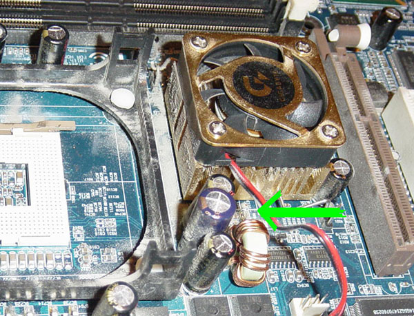

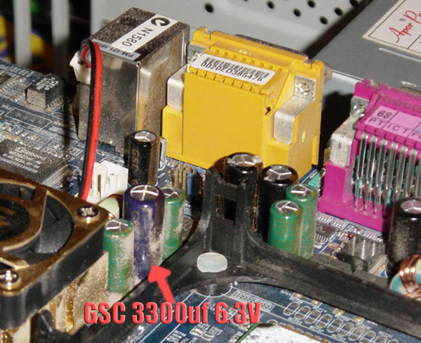

    Re: Only old boards have badcaps....Right?
    Gigabyte GA-8IHXP
    1 GSC 6.3 volts 3300 uF
    image contributed by GeorgeGPN
    image contributed by cods69
