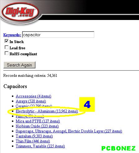

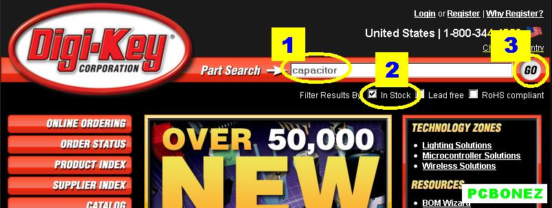

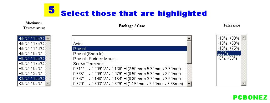

    I've seen this come up now and then [how to search Digi-key] and so I figured a guide might help the newbies some.
    If you are looking for Low ESR caps at Digi-key this will quickly filter out 95% of the caps you DON'T want to look at without losing any that you DO want to look at.
    Home Page - First Search Input
    Result and Next Search Input
    Note:The way Digikey currently works both Electrolytic and Polymer are included in this category.

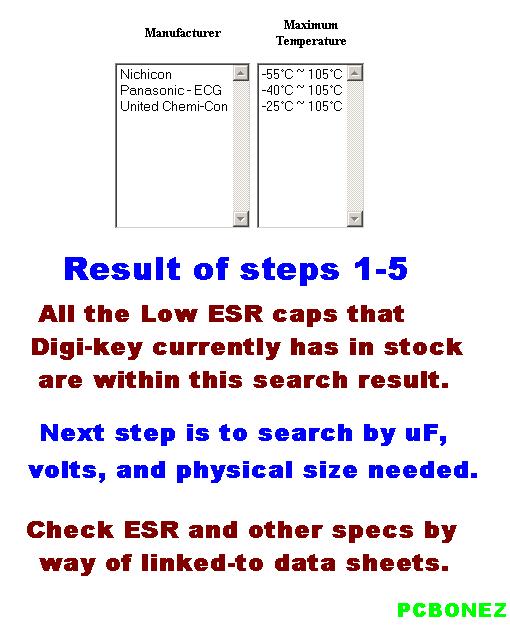

    Detailed Search Screen - First Inputs
    Then click "Apply Filters" at the bottom.
    Overall Result of Search Sequence

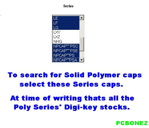

    Finding Polymers
    That's a quick path to what you'll -usually- be needing from Digi-key within the context of things pertinent to BCN topics.

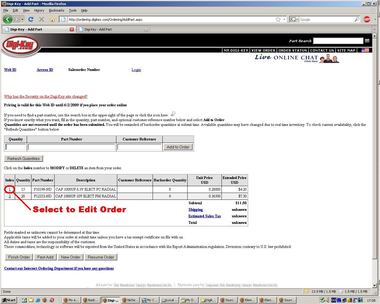

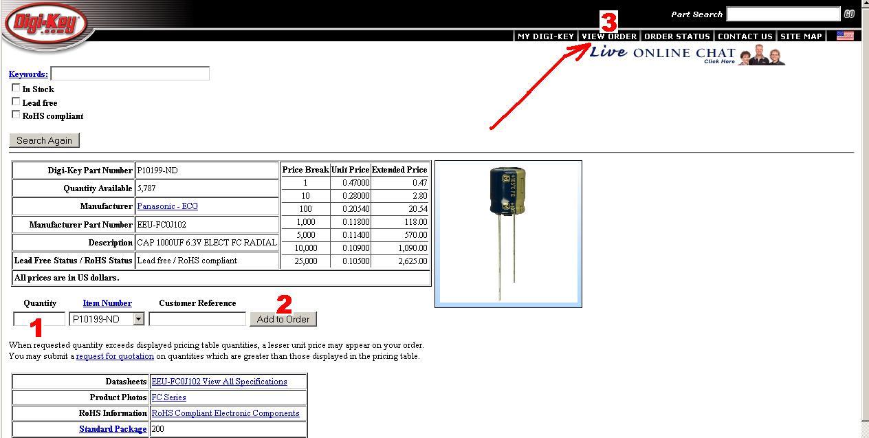

    A little on the ordering process.
    - The process in kind'a goofy and goes in circles but it gets it done eventually.
    It uses 3 pages.
    - Add a part via Part's description Page. [Catalog Page.]
    - Overall Order Summary Screen.
    - Item Index Page [There is one for each part in the Order.]

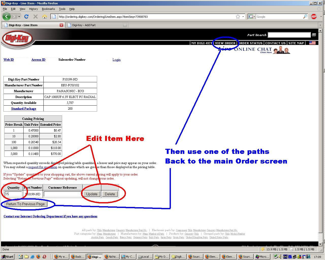

    To edit the quantity or remove a part you go to the "Index" Number in the Order Summary Screen and click on it.
    That brings up a screen just for that part in the Order.
    This is where you edit the item, then go back to the Order Summary and verify it did the edit.
    Catalog Page [Where to add a part.]
    Main Order Summary Page [Where to view current order selections.]
    Part Index Page [Where to change or remove an item in the order.]
