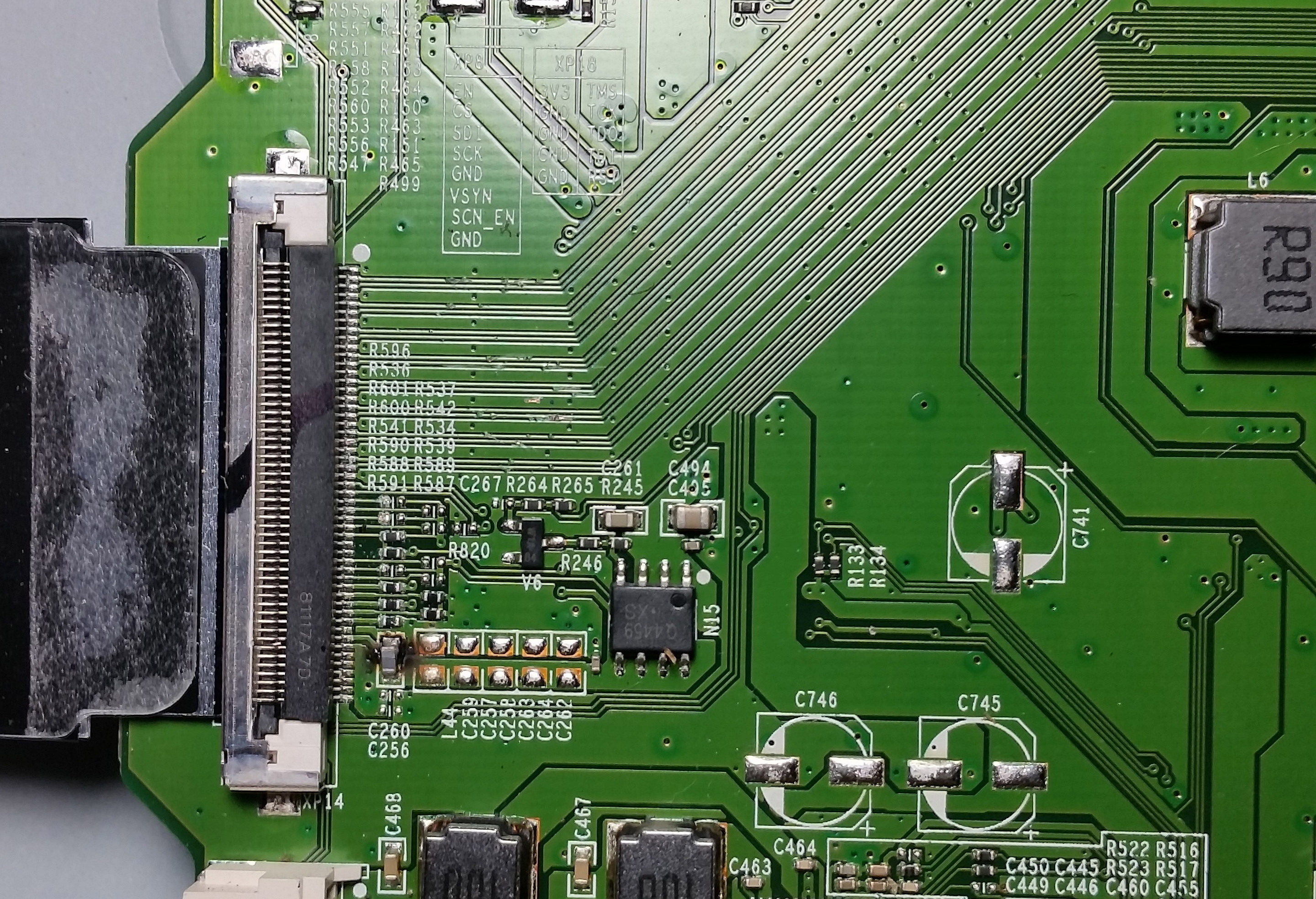

    im trying to understand how mainboards send data to tcons and tcons send data to panel boards and how panel boards control the panel itself.
    but starting at the beginning: if i have a tv with symptom: blank backlit screen, i want to verify if the mainboard is functioning properly first. its easy to see if its sending 12v to the tcon...but im pretty foggy on what the other lines of the LVDS connector should have on them.
    and also should they have the same voltages on them regardless of if the t-con is connected?
    and also how do you probe these pins easily? they are so close together it is
    quite risky even with a fine needle point.
    i tried scratching away some of the solder mask to get at the copper traces to probe them but when i did, i didnt see any voltages there.
    i had the TV running and displaying a moving picture so i thought
    i would see something on those "data lines"
    but admittedly i dont know much about what these lines are.
    i know it probably varies from brand to brand but im assuming theres some commonalities as well.
    is there a good guide to this somewhere?
    these pictures are from a vizio i have that has a damaged panel but still shows some image so i figured its good for learning on.

    You can use a oscilloscope to check the lines for signalling.

          Hmm. Yeah… I guess you got to do some reading on how LVDS a works. I use a 100MHz Oscilloscope and that works just fine for that. Basically you want to change something on the screen, like turning the OSD of and on all the time and probe the differential pairs and look for a change on the oscilloscope screen. That trick works A1.
          As for LVDS voltages, they would be very low. Something like 350mV. Problem with it is, that you can’t 100% identify a problem let’s say a main board that doesn’t send anything to the tcon. It’s much easier to probe the LVDS with an oscilloscope.

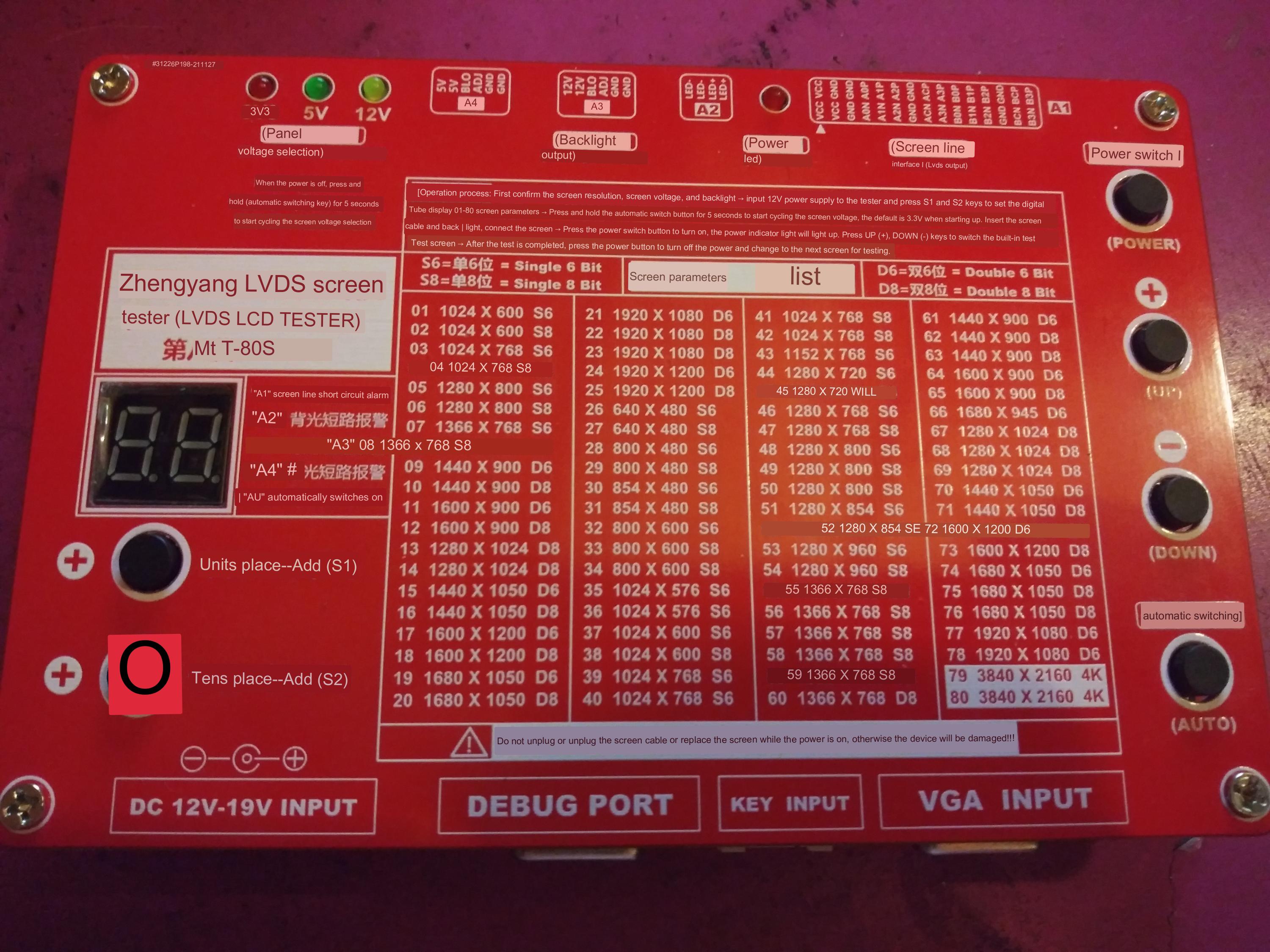

                            interesting. if i read this right, some TCON have a self test ability, if you give them no signal from the mainboard but just provide them with 12v from the psu directly...like to the fuse on the TCON? and have it connected to the panel then it may show a test pattern?
                            definitely have to try this on some junker TVs i got lying around.

                              so i ended up buying this thing...and it comes with no manual! there seems to be instructions printed on the device itself but its all in chinese!
                              i tried to google up a manual but so far havent found anything. oh boy!
                              it looks awesome...just have no idea how to use it!
                              after powering it on it displays the number 23 which according to the chart is 1920 x 1080 which makes sense but up in the top left it shows panel voltage and the red led is lit indicating 3.3v but i cant figure out how to change it to 5 or 12. the buttons on the left change the number in the 2 digit LCD but the buttons on the right dont seem to do anything. there is a power button which turns on a red power LED. there are cables that hook up to various T-CON connections, but in the instance of a tv im thinking to hook it up to, there are 3 different connectors that all fit but have different pinouts..so i need to know something about these panels before plugging anything in, im thinking?
                              quite confusing. maybe i can use some app to translate these instructions.
                              edit: google translate works really well and i think i understand how to use this device now. you long press the auto button to switch panel voltages, and once you connect and press power button to send power to t-con, then pressing the buttons on the right side change the test pattern.
                              but i still dont quite know how to tell which connector to use to connect to the tcon.
