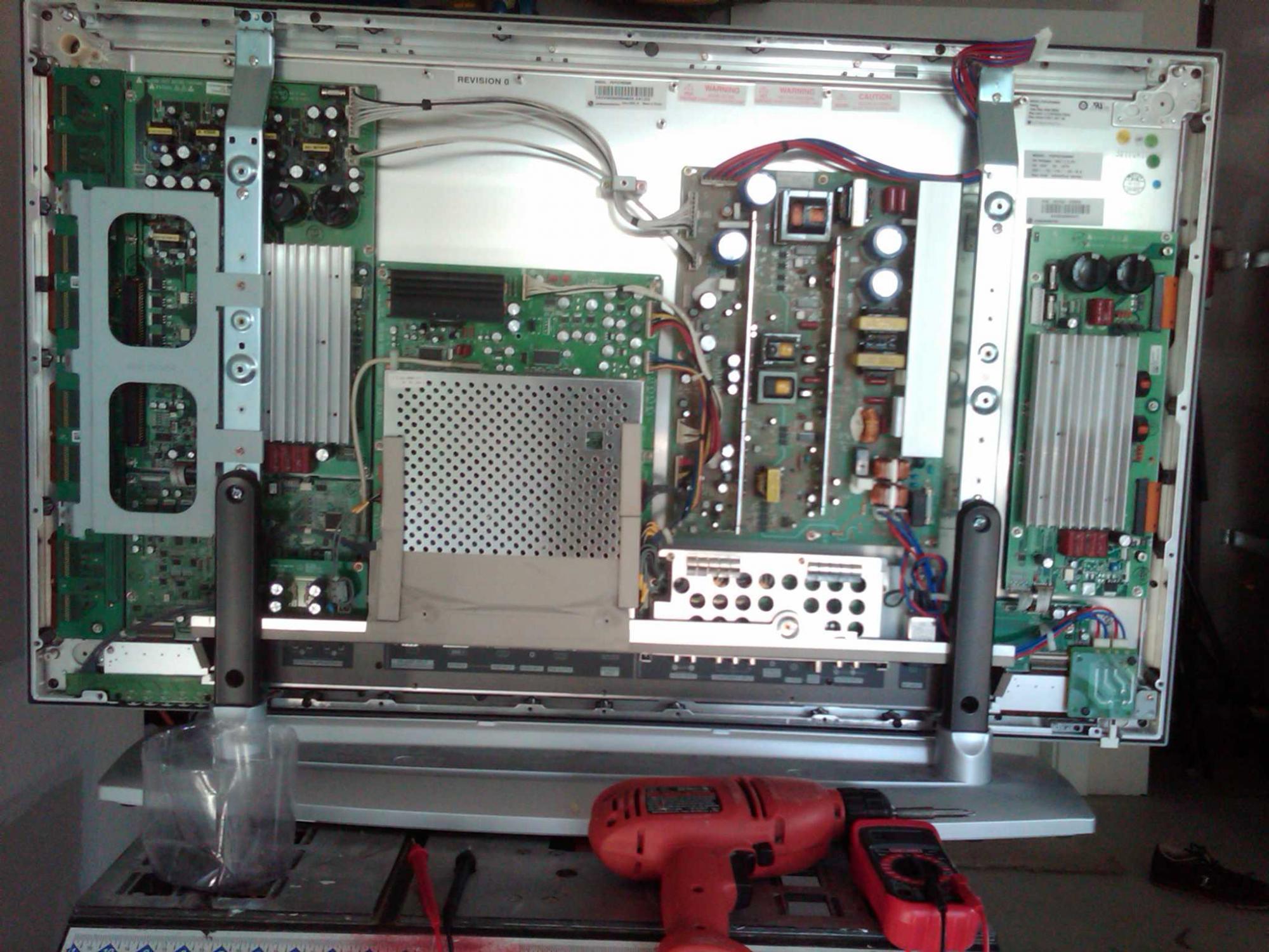

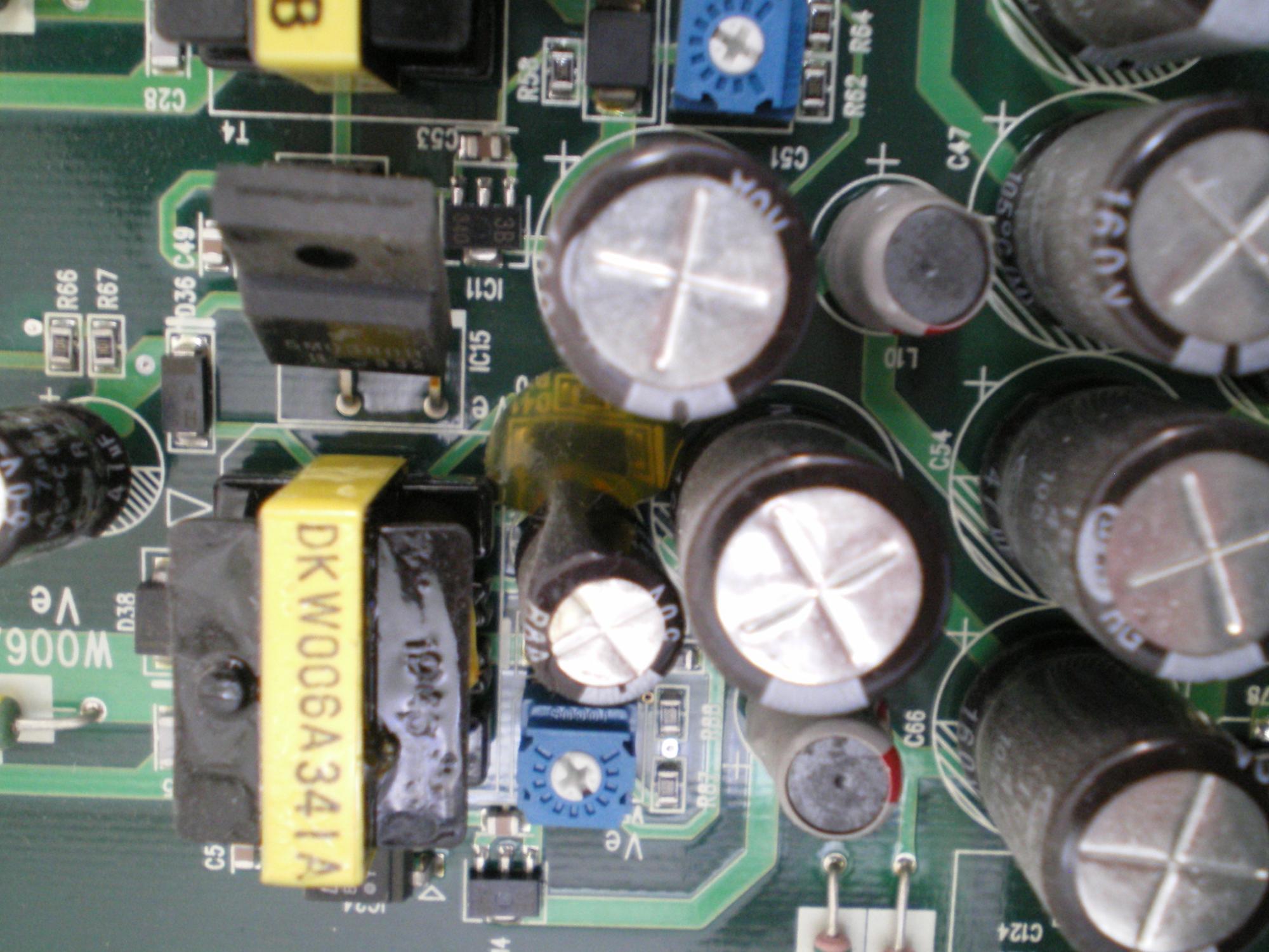

    Zenith plasma p42w34 front light powers on but no pic

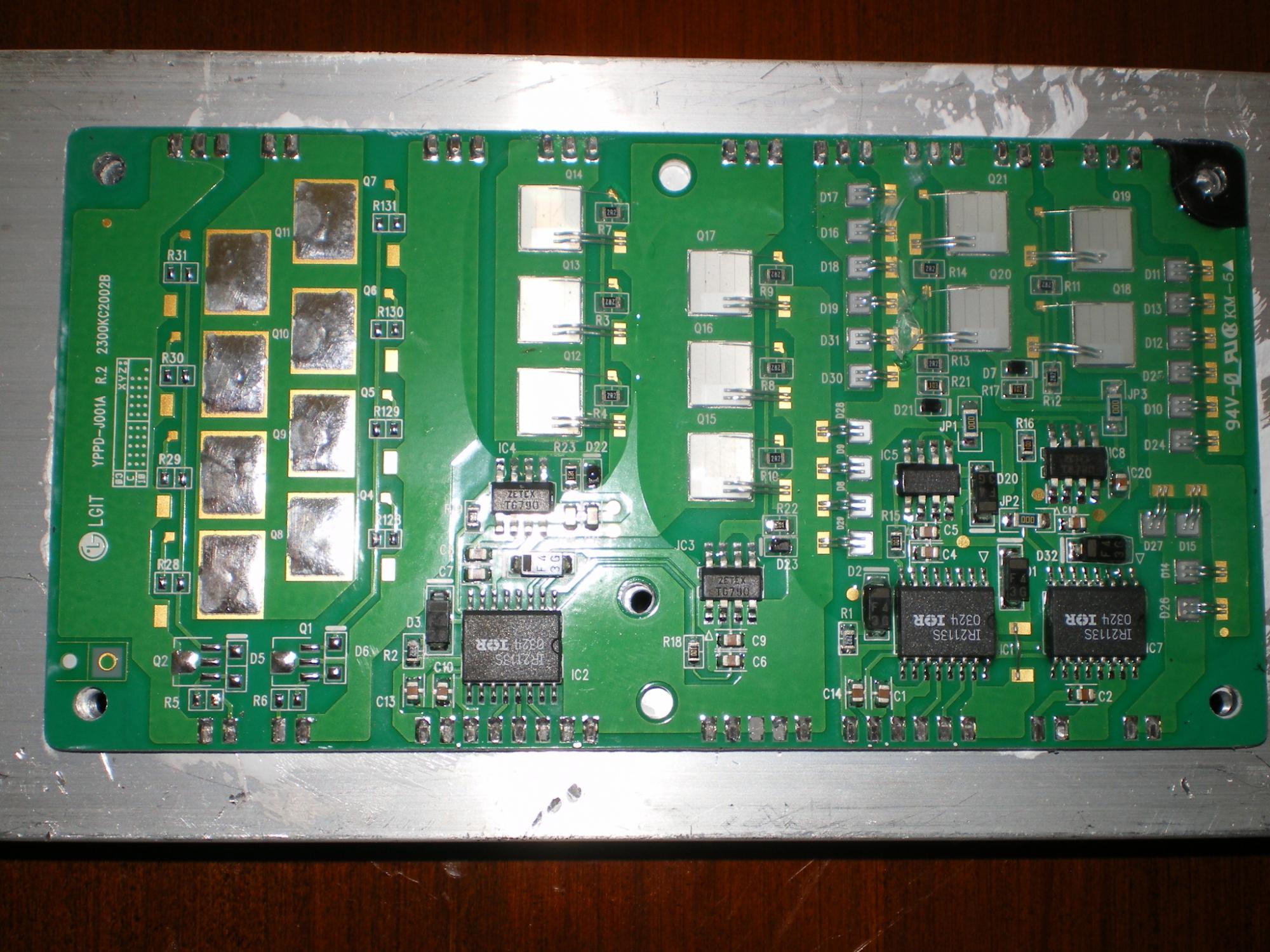

    name is hector. I am new to bad caps and have done two succuessful repair on my privious monitors. So heres the deal i have a zenith p42 w34 plasma that i got for free on cl . So i figured what the heck. When you turn it on the front led powers on and then you hear this noise from the part that i took a pic of. I dont know what its called. I also took pics of some caps to see if these looked blown or if it is glue on them the substance felt rubbery so im not sure. Then in one pic there is white on a cap and on the other thing as well. Any how here are some pics of the whole back and then three of the ones where the noise is comming from.
    Pic two and three are of the noisy piece pic two is the lower part and pic three is the upper part. Pic one is the whole thing. The noisy part is on the right side of pic one.

    Re: Zenith plasma p42w34 front light powers on but no pic
    It's the Z-sus. Google the part number.

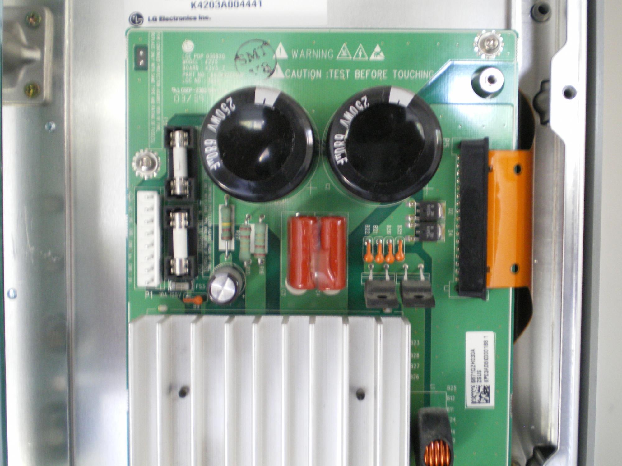

                    hello everyone,
                    I have gotten my new z sus board that is was able to trade for a surround sound. i would really like to get this tv going. I put it in and no pic. What should i look for next or am i just wasting my time with this.

                              In this context, look at the Y-Sus and Z-Sus cards. Each of them has a large heat sink perhaps 3" x 6". If you look at the bottom side of the card you will see two rows of pins in that area. Each row is perhaps 2" long, and the rows are 2" apart. If you look between the heat sink and the card you will see something looking vaguely like a very large DIP IC. That is the hybrid. They are notorious for failing.
                              Replacing is is NOT a trivial task. The replacement hybrid costs about $40, and it is very easy to damage the board while trying to remove the old hybrid.
                              Samsung used a similar design on some of their sustain cards, but their design allowed removing the heat sink, which meant the pins of the old hybrid could be cut and extracted one at a time.

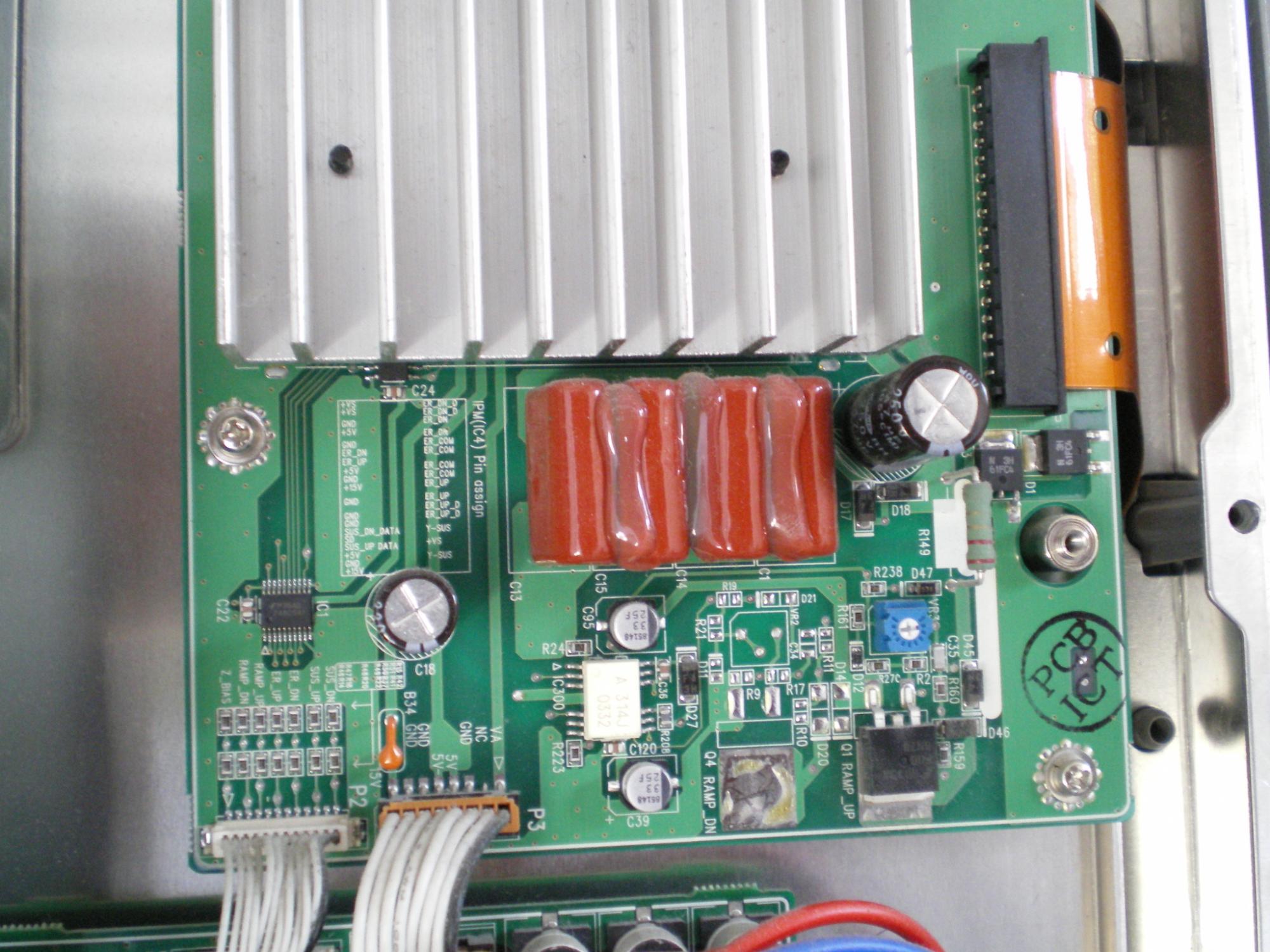

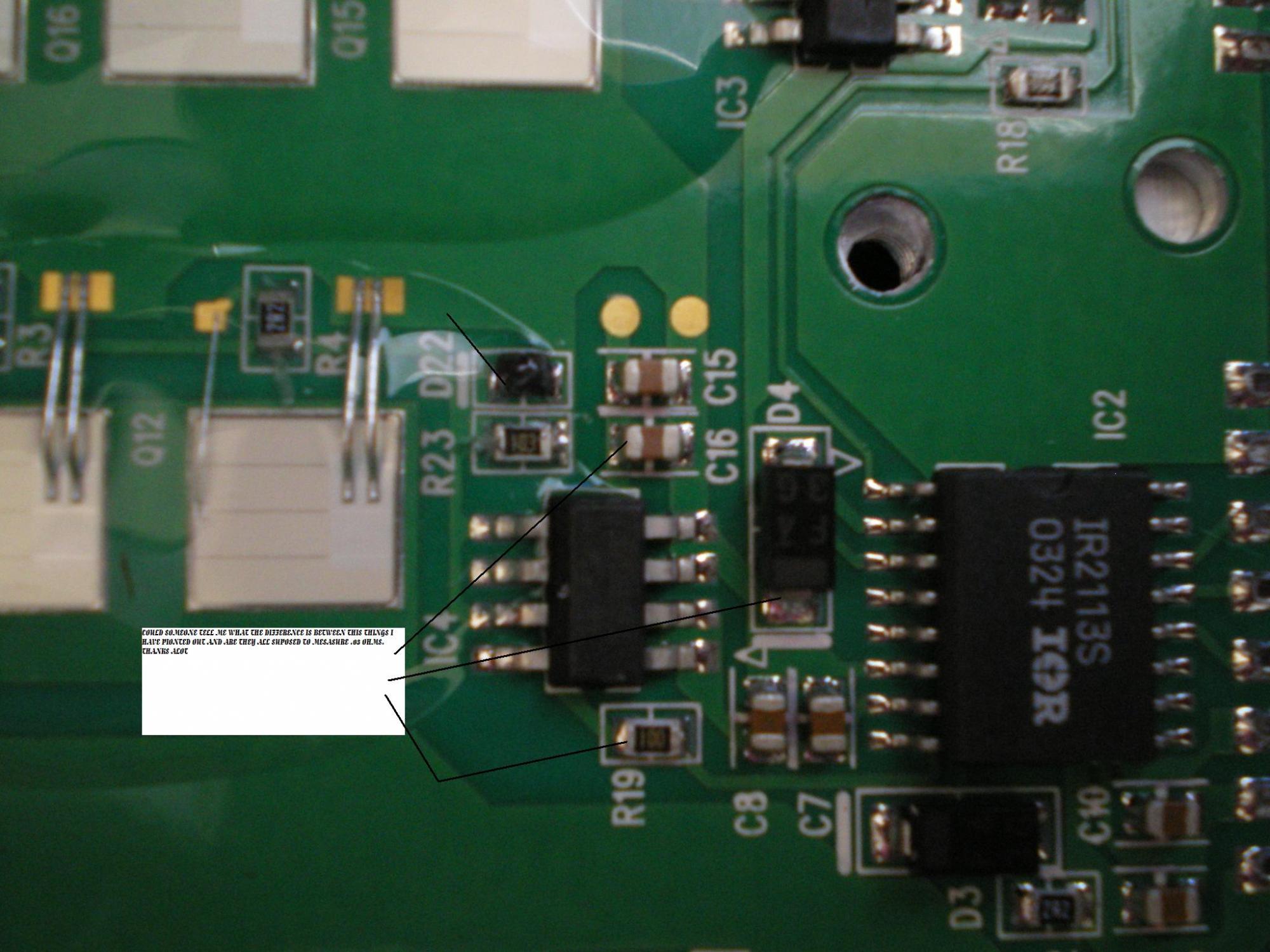

                                here is the pic of the card from the z sustain board under the heat sink.
                                • hpaca509
                                  • Aug 2010
                                  • 76
                                  Is this the piece that need replace? If so is there anything i can do to replace certain part in it. I know that when i did the hp pavillon monitor one of tiny fuses(i think thats what its called was not reading .3 ohms i replaced it and then it worked. I did the fuses in this hybrid deal and some did not read .3 ohms should i replace them.
                                  • hpaca509
                                    • Aug 2010
                                    • 76
                                    The things with the pointed out are things i would like to know the proper names of.
                                    • PlainBill
                                      • Feb 2009
                                      • 7034
                                      The label next to each component identifies the type of component.
                                      C = Capacitor
                                      D = Diode
                                      R = Resistor
                                      D22 looks suspicious. Is that something dabbed on the top, or is it burnt?
                                      PlainBill
                                      • hpaca509
                                        • Aug 2010
                                        • 76
                                        its just dabbed with the coating of rubber cement stuff there are others that look like that on the board. Are the resistor the one that measure .3 ohms? if so not all are doing that some read 10.4
