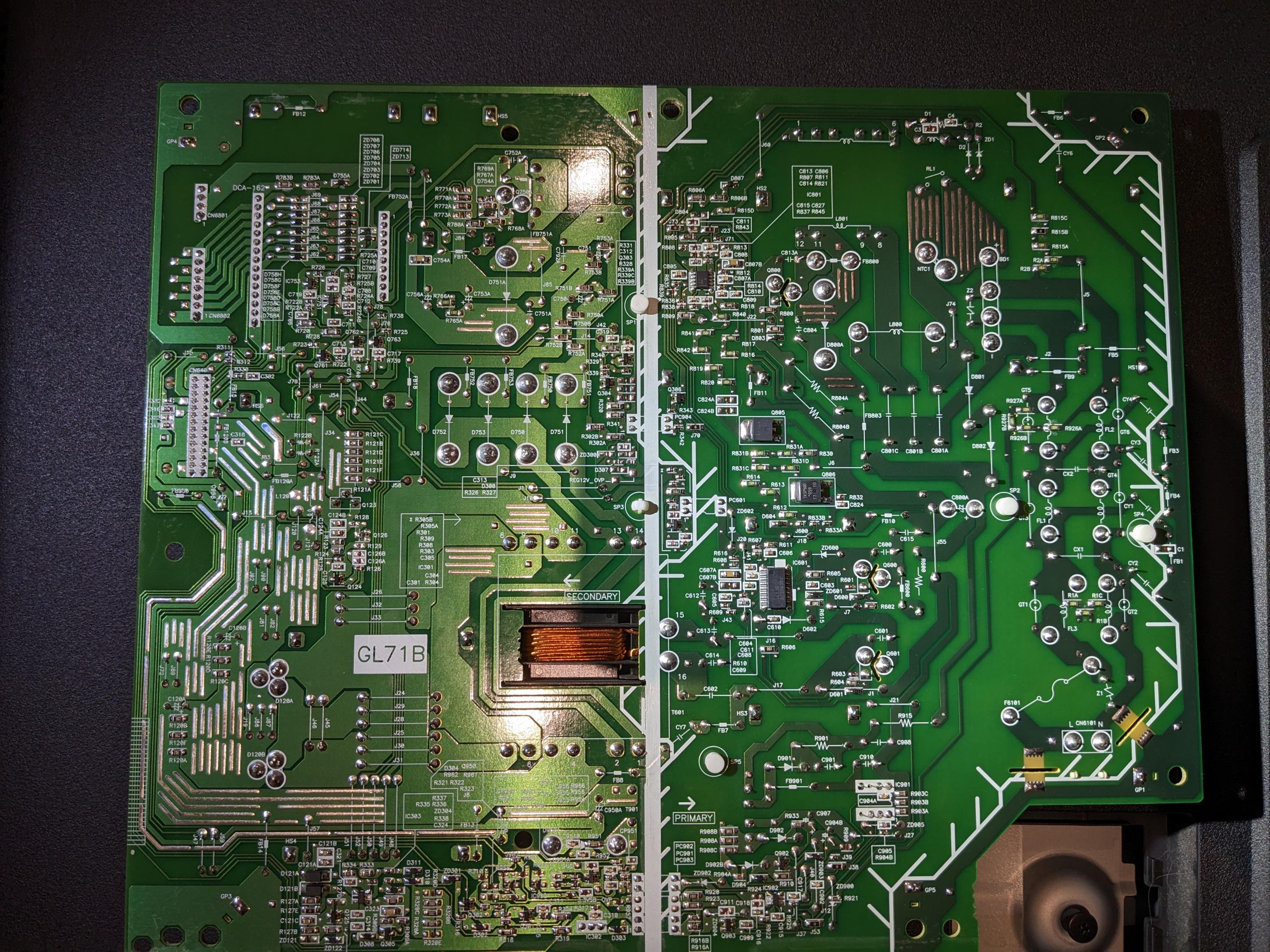

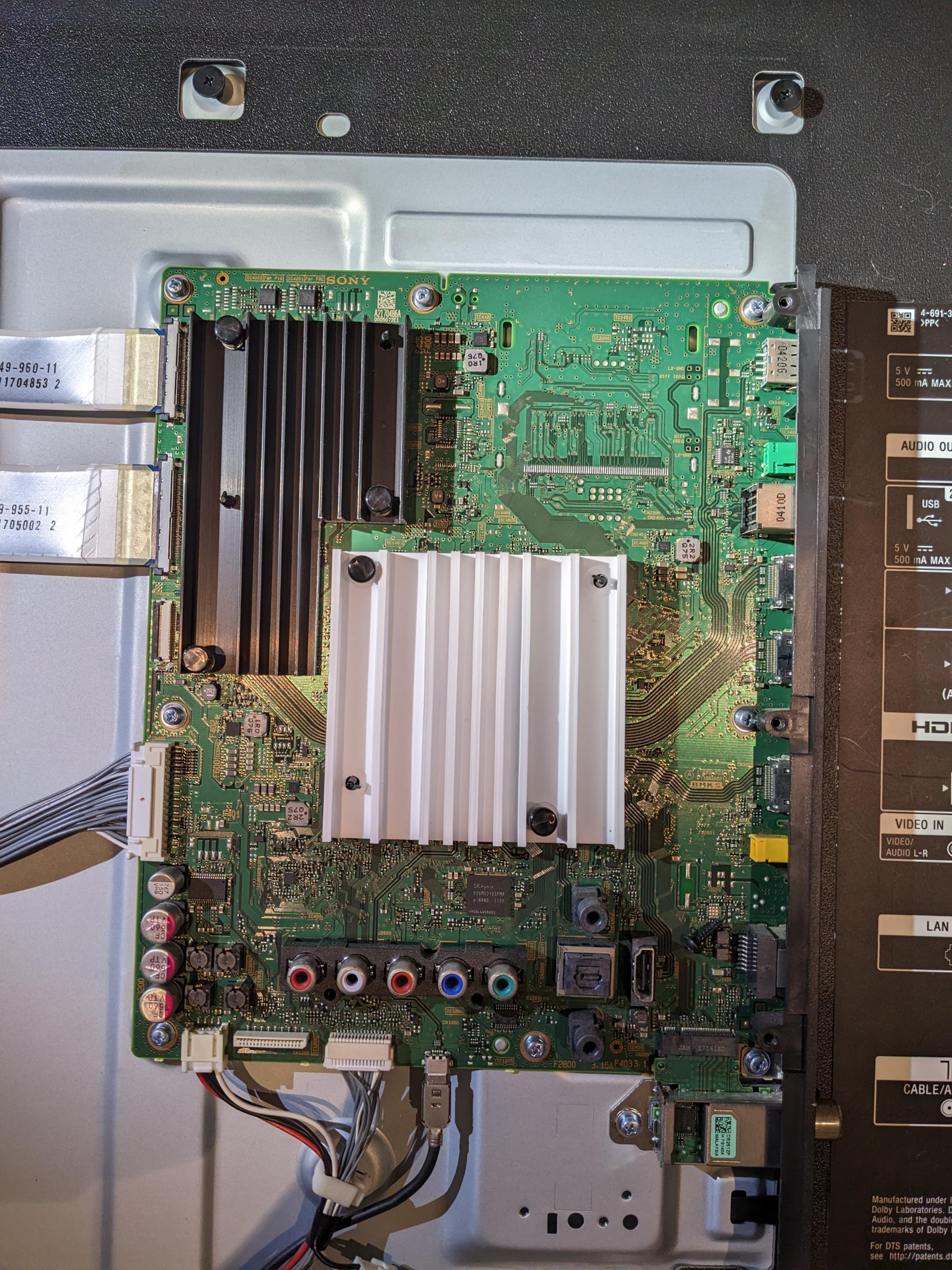

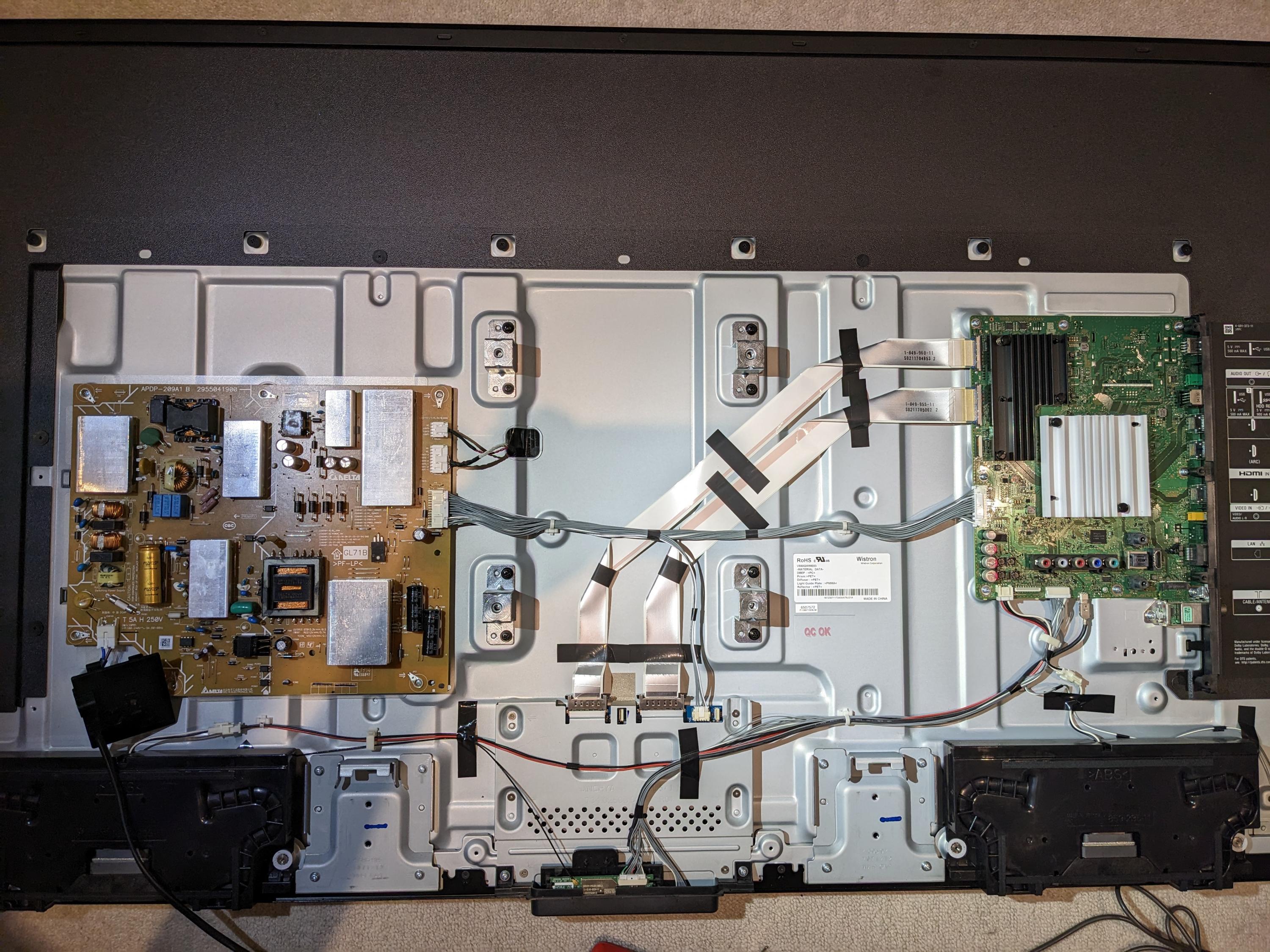

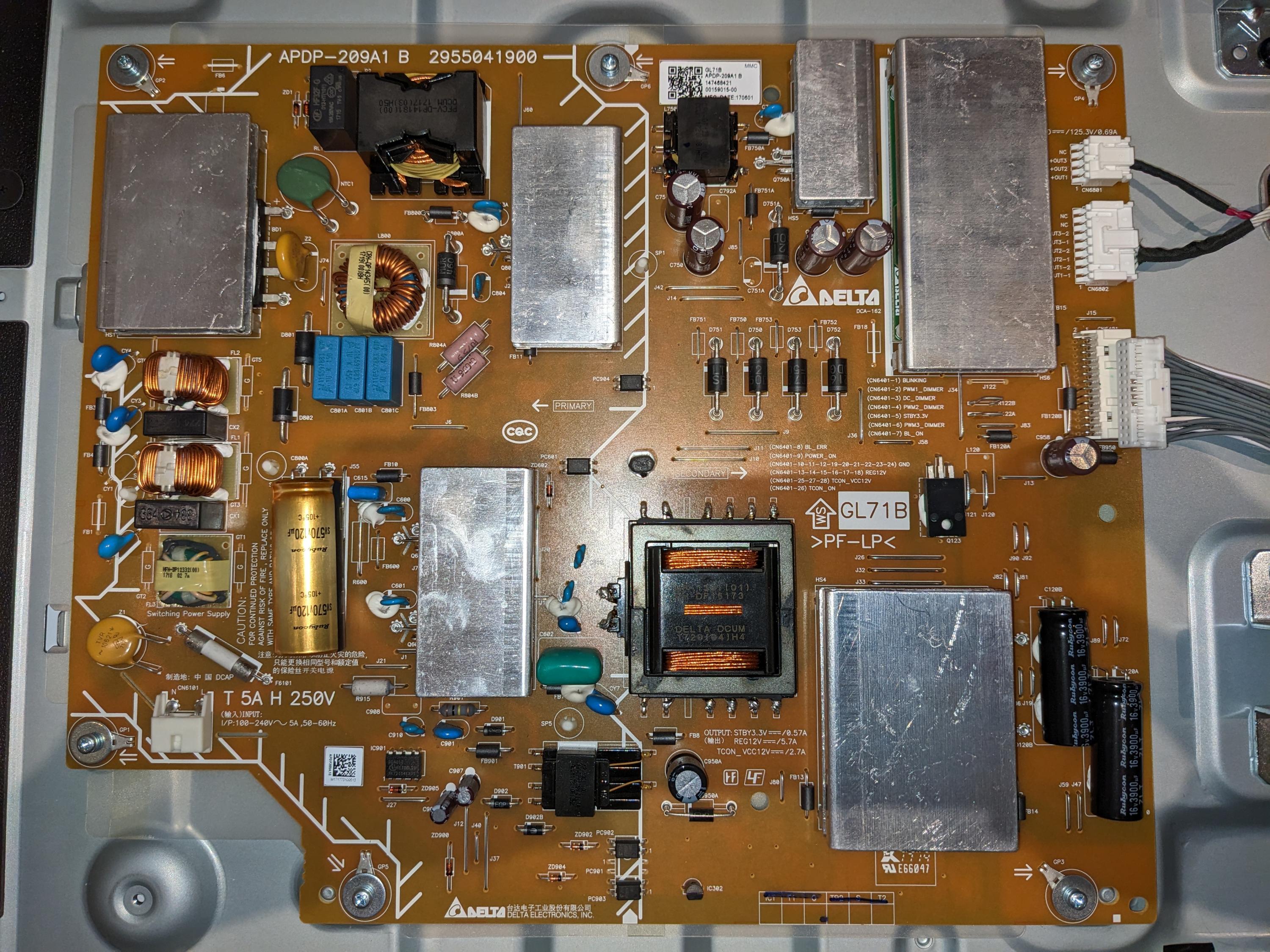

        can you post some good straight on pictures of each board and one of the whole back, as to see how everything is connected.

              Here you go.

                  some of those solder joints look a little suspect, examples of bad joints there: https://www.google.com/search?q=bad+...ih=607&dpr=1.5

                    Re: Sony 55X8500E no power
                    Had a detailed look, can't find any bad solder joints.
                    Would you mind to point out the component number which looks suspicious?
                    On the other hand, tested all 6 black light strips light up without any problem? Is it possible the 2.8V I get from BL_ERR is indicating something else?
                      after confirming solder joints are ok, do this test:
                      Check STBY 3.3V
                      C518
                      near CN400
                      on B* board which is also known as the mainboard.

                        look closely at the joints, see how some look cracked, a good joint does not look cracked or sparse or a big round glob.
                            ok, looks like that points to a problem with the B board/mainboard.
                              the solder might be ok, hard to tell from the picture, it looked like maybe some of the diode D75x might be a little cracked but not sure.
                                  Resolder those Schottky diodes but nothing changed

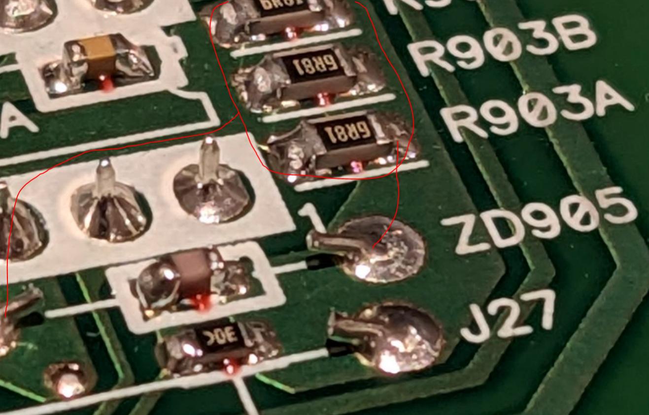

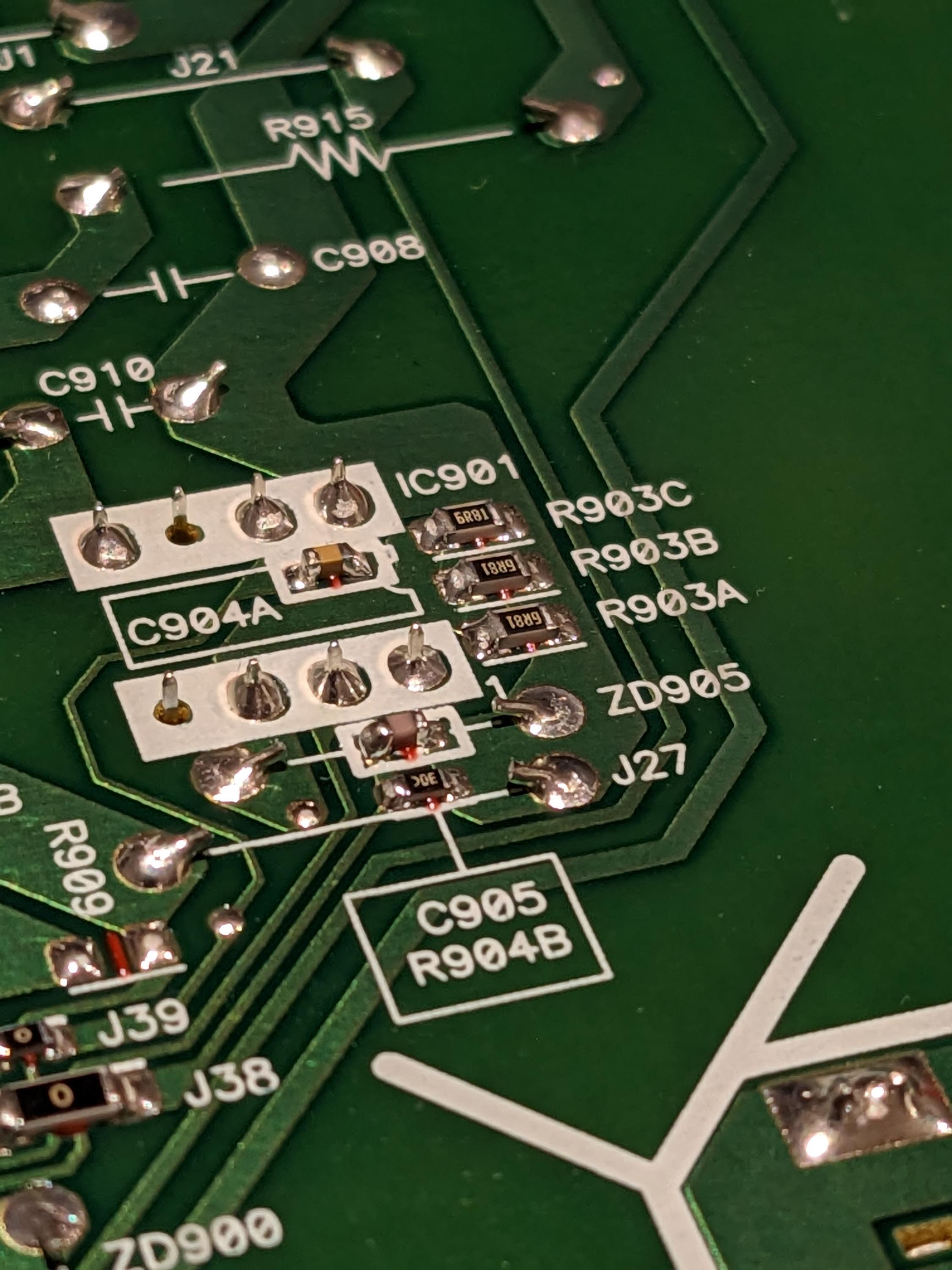

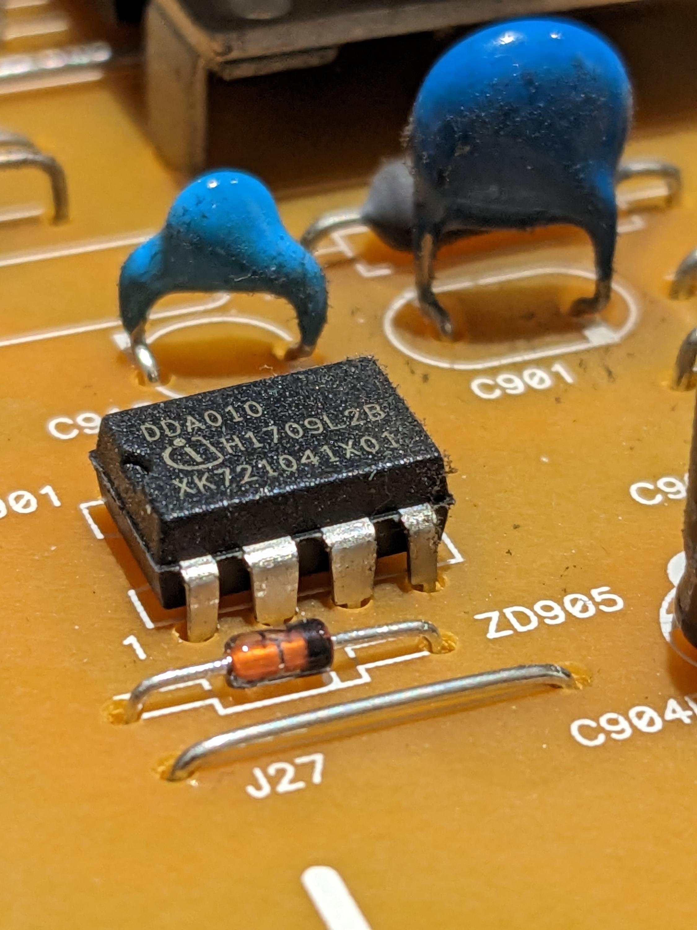

                                    Just found a short on ZD905 near IC901. Not sure is this related to the VCC 12V missing.
                                    • lotas
                                      • Jan 2016
                                      • 4582
                                      • Russia
                                      The zener diode is in parallel with low-resistance resistors, so it seems to you that it is short.
