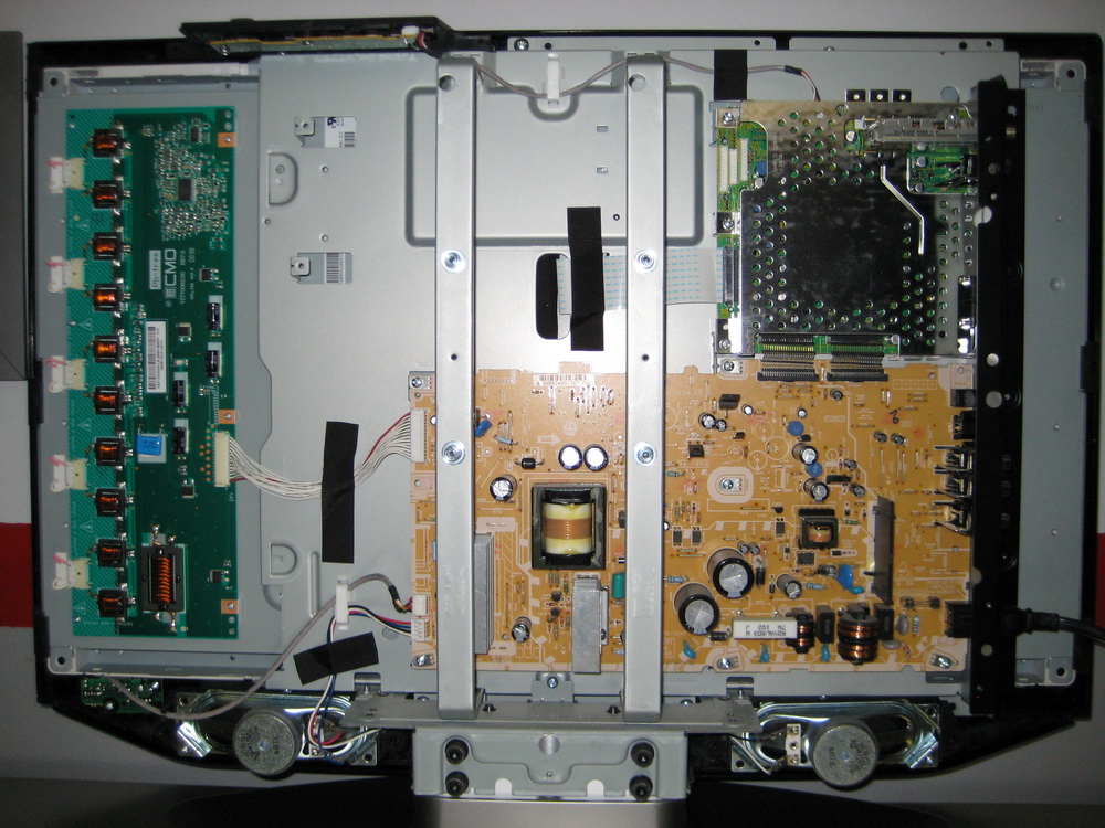

    I have here in front of me a friend's Sharp LC-26SB14U that does nothing but power up to a white screen.
    I cracked it open and the PSU doesn't have any obvious bloaters.
    Changing the input does nothing, channel does nothing. Raising the volume does raise the no signal noise a little bit.
    I am guessing the PSU is not powering the logic board, or the logic board is just dead. There seems to be power reaching everywhere else on the tv.
    Anyone have any suggestions or typical fixes for this?
    I attached some pics so you get an idea of what's going on inside.

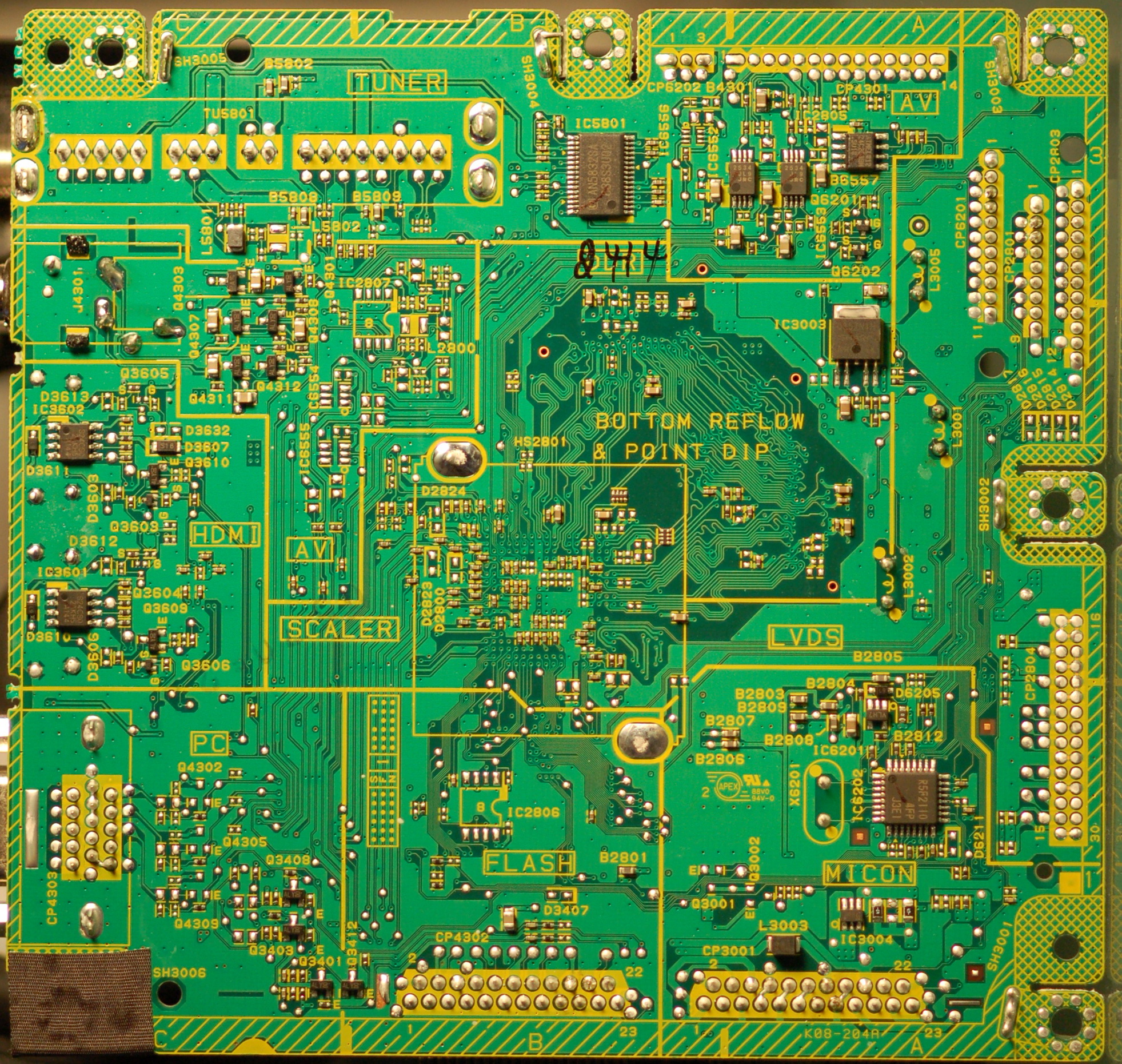

    Re: Sharp LC-26SB14U White Screen

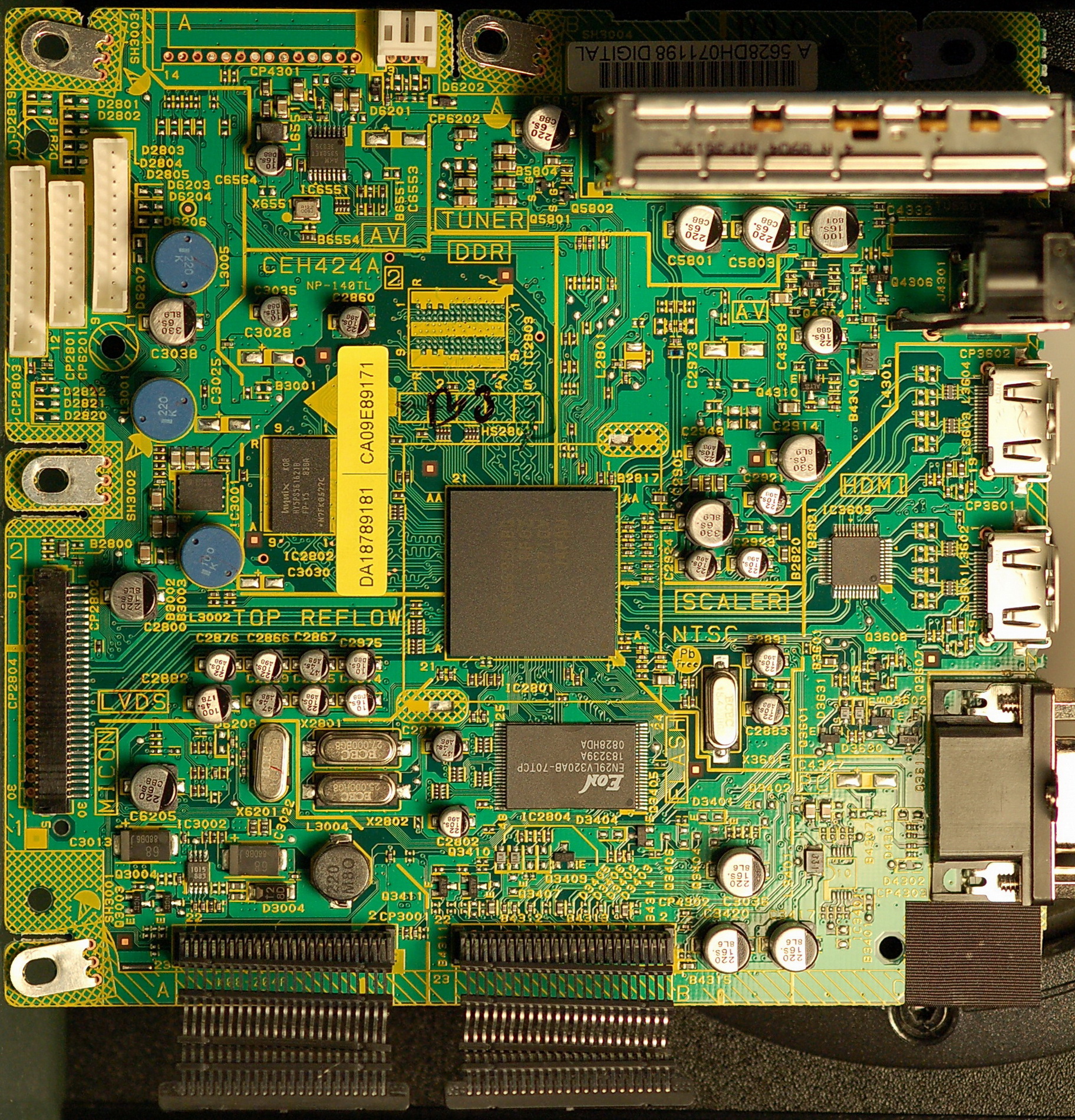

    Post a picture of the logic board. I'm pretty sure it is hidden underneath that aluminum shield. Try to get in as close as possible with the highest resolution.

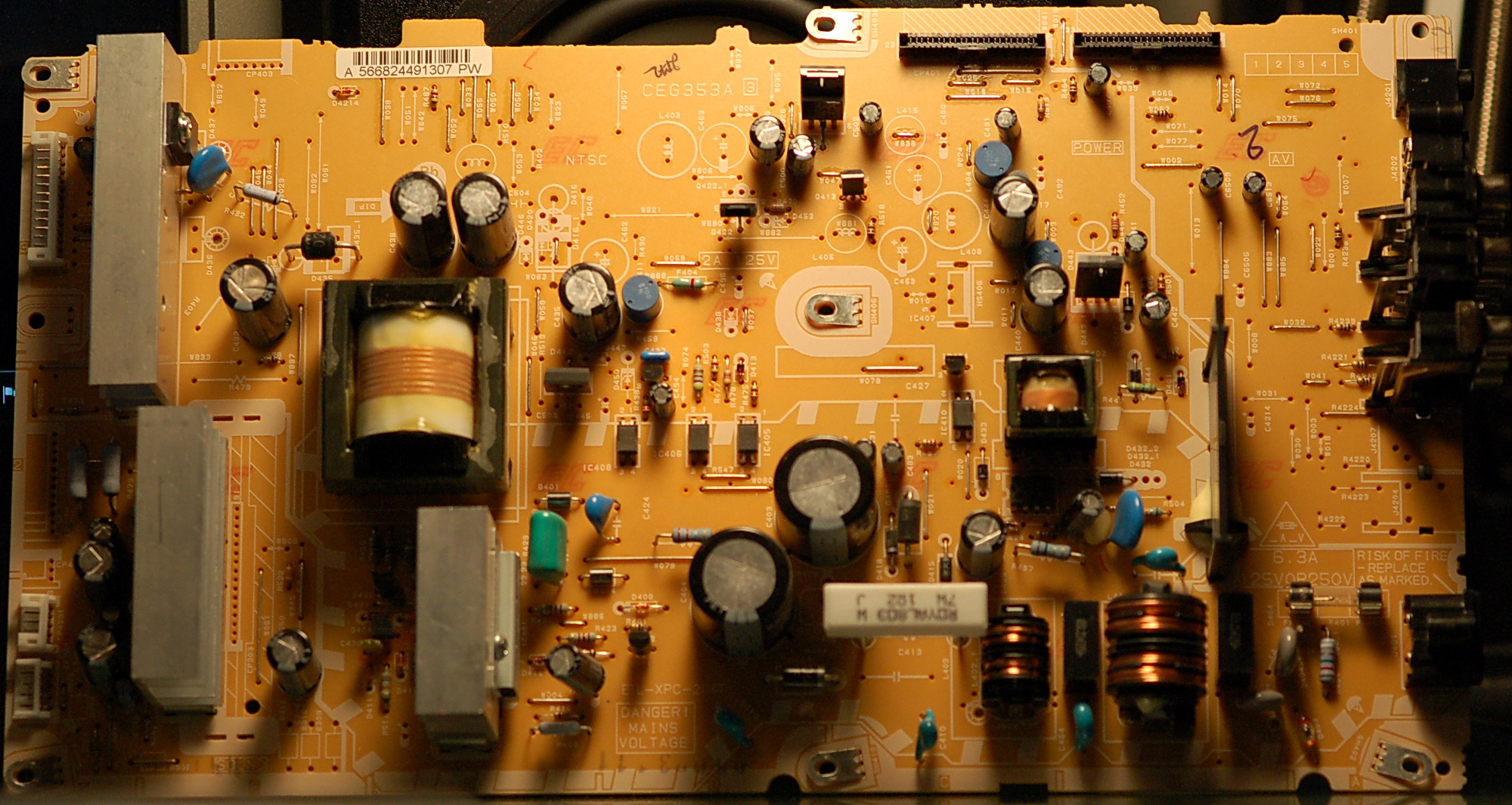

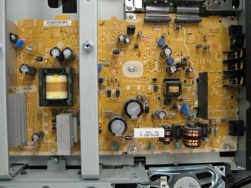

            Below are the requested pics. I hope they are good enough.
            Judge, yes, I have tried to reseat all the cables, and still the same result. No black screen, always white. No sound, except for the faint hiss of the amplifier being on, but with no signal input.
            Let me know what you all think.

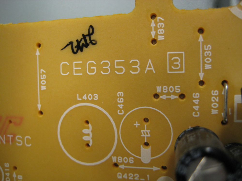

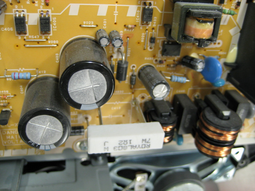

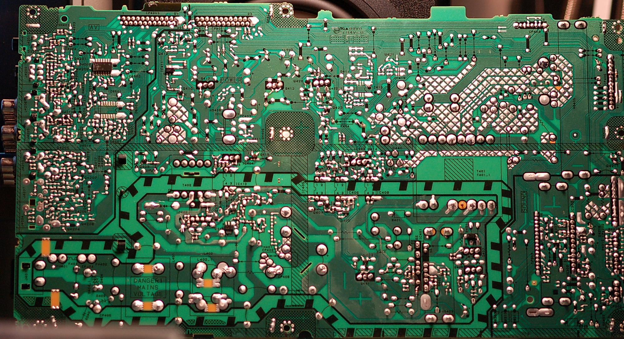

                  Here's some shots of the PSU. I'd love to know what the pinouts are of connector CP401 so I could check if the logic board is getting proper power.
                  Any clues on this?
                  I can take any close ups of any particular areas on request.
                  Thanks, fellas!

                              I have confirmed (I think, hah) the logic board is getting all the voltages it should need to work. The 30v and 5v lines are all reading their respective values.
                              As far as I can tell, the logic board has no fuses on it. I'm pretty sure I have confirmed this using the diagrams.
                              So, in my very inexperienced opinion, the logic board is fried.
                              Being that this may very well be the case, where do you all usually source these boards? Just googling the part numbers?
                              Thanks, fellas!
