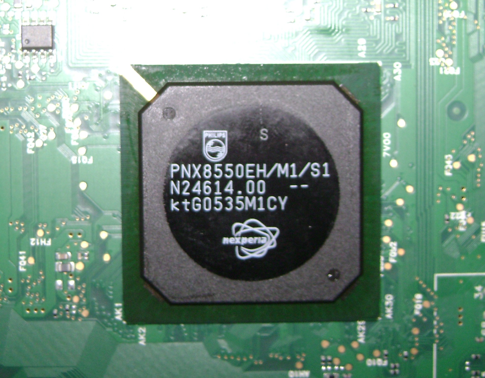

      With my finger on the PNX8550 chip (that Dmitt explained earlier), very hot right before TV shutdown. They must have these chips in a lot of their sets. Sucks that this chip doesnt seem to be replacable. I'll have to try to find a replacement board or try to find a heatsink that will fit.

        Originally posted by dmitt25
        So I immediately took the stupid blue jelly-foam crap off the viper chip and the other large chip on the back of the SSB. I applied a thin layer of Artic Silver 5 thermal paste on the chips and then installed a couple aluminum heat sinks I got off Ebay that I had to mill down because they were about 1/16" too tall to fit in the cage.
        Pictures are soon to come. The blue jelly - foam is actually a form of heat transfering pad that should have been connected to the heatsink (the backplane "cage"). Adding a heatsink may or may not fix this problem permanantly due to the difference in size of the heatsink you can fit in that area versus the backplane itself acting as a heatsink - being more open for air flow.
        I am going to modify (correct) what is there already. I'll try to use thermal paste on the pad - maybe both sides (between pad to heasink and pad to chip).
        It's a good thing I didnt buy a replacement board before doing more investigation.

          I didn't know for sure dgtech, but I assumed that's how the blue pads worked. They're a pretty sad excuse for a cooling system. The heatsinks I installed actually rest against the backplate even after I milled them down. I wish I would have taken off maybe a few more thousanths because there is an ever so slight bow to the board when the screws are installed. I may have jumped the gun on the new board but the way I see it, I've got a backup now in case my heatsink theory doesn't work.

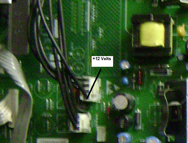

          My next step is to figure out how much amperage I can pull from an unused 4 pin socket on the power supply that is currently supplying 12v x 2 pins and GND x 2 pins. If it can handle it, I'd like to hook up 2 120mm fans to this socket and blow some air over the back of the Tv.

            Funny you mentioned about the fan cause I had a thought about that too. The only thing though, there is so much over voltage and over current protection in there, I'd be afraid to even try without creating a new problem. If you do this, then I'd fuse it carefully. If anything add a localized laptop style fan right near the chip somehow.
            About the heatsink, if it is pressed up against the backplane, I'd probably leave it as such. At least you know it's making solid contact with the paste and chip.

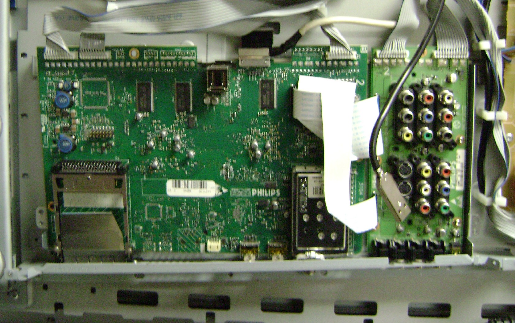

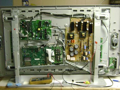

                          Re: Philips 42" Plasma 42PF7320
                          I have to put this aside just for this weekend as I am removing carpet and installing laminate flooring in my second bedroom.
                          Here are the pictures of the set that I have. I may have to try a larger heatsink as I just tried one that was longer in length but 1/4 inch thinner than the chip. I used a heatsink off from a MOSFET from a scrapped board. I'll have to pick up the right sized one tomorrow from my electronics store, that and more thermal paste. The spacing that I've noticed is about 1/4inch for max height of the heatsink needed.

                                  Ran some wires from my HTPC's power supply to a couple 120mm fans at the back of the TV. Doesn't seem to do much. There's just SO MUCH HEAT in this TV. It's almost like I need a 3 foot long squirrel fan at the top just to suck some of it out. It was sooo much cooler with the back off, wish there was a safe way to run it that way.

                                      A slight variation of dmitt's fix is what I have now tried and seems to work. Taking powerampfreak's suggestion of a fan - I got a low profile heatsink and fan from an old motherboard chipset. I placed the heatsink (about 1/8 thick) on the top of the chip but the fan had to go on top of the cage facing downward. I know I know, it should blow the heat up but there was no room. It has now been running for about an hour now with no problems.
                                      It should be noted that the other processor on this board is still using that blue foam. This chip does not get as hot but unit WILL shut down without any heatsink for this chip.
