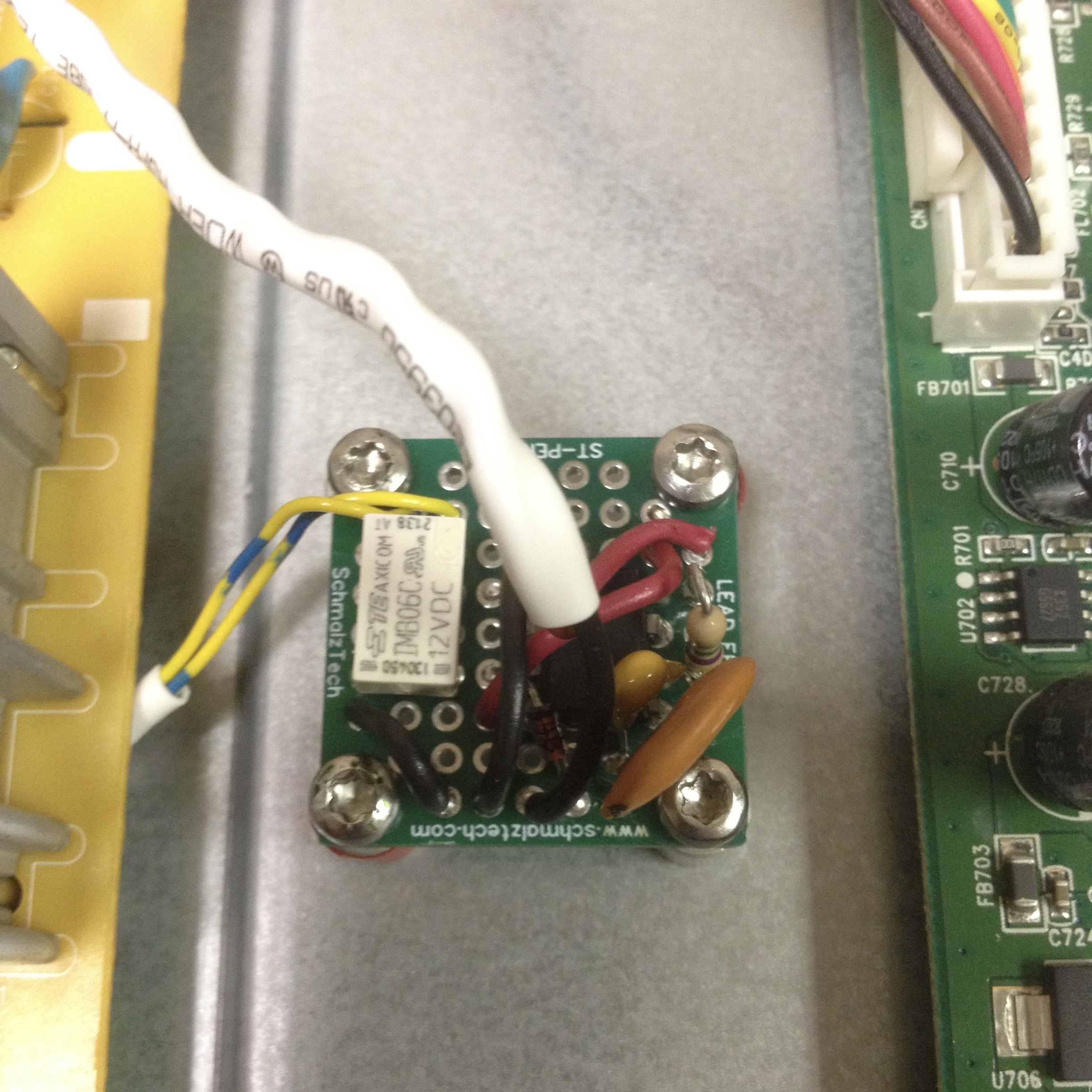

    So what's the problem? The TV's in my monitoring wall all need to come on with the flip of the wall switch. This one is one of those energy saver TV's that requires a button push to turn it back on after a power outage. Found a circuit over at Circuit Lab that uses a relay and an R/C circuit to hold the relay closed at power on to fake the button push, then releases. However, this fake button push occurs when the LED is blinking red and doesn't turn the TV on. I could play with the RC values to hold the relay closed for maybe the two seconds that the LED flashes and then the TV would turn on at power up but I thought that it might be easier to fix the TV and eliminate the blinking LED on power up. Blinking LED problem was evident before I added the circuit but I didn't think anything of it.

              I was able to modify the R-C time constant in the 555 timer/relay circuit that I found on Circuit Lab to get the job done. The R-C component values originally gave a relay held closed time of 680 mS which wasn't long enough for this particular device. I used my phone timer and got a rough estimate of 3 seconds for the blinks and then tried a 3.3 meg ohm resistor in the R-C circuit but that was just short of what I needed so I went to the next value I had, 4.7 meg ohm giving a relay held closed time of 4.7 seconds which is long enough to allow the TV to "see" the held closed relay (across the power button) after the blinking stops and turn itself on.
              Does anybody see a market for a circuit like this, with custom values of the R-C circuit to produce the necessary relay held shut time?
              Surely I can't be the only person who wants their TV or whatever to turn back on after a power outage.
              Val

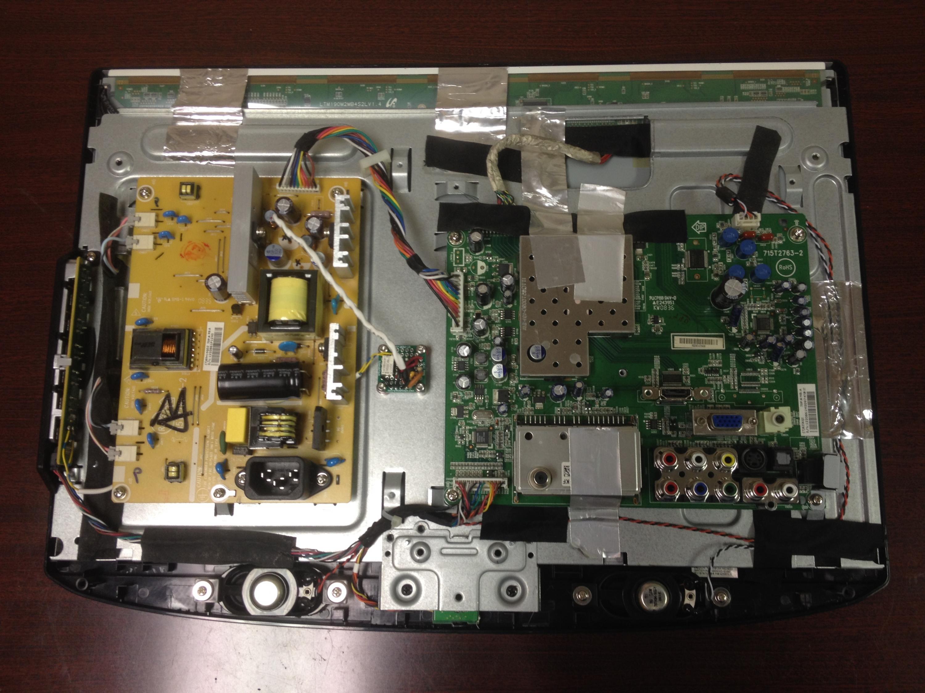

                                In the end, I resigned myself to the fact that the blinking upon power up was just the normal operation of this TV. I built a delay circuit that I was able to find on CircuitLab, and set the R-C delay for the 555 timer to hold the relay for approximately 4.5 seconds. The relay is in parallel with the momentary switch on the side panel controls, and the 4.5 second hold in is long enough to turn the set on as the blinking upon power on is approximately 4.2 seconds.
                                The red and black wires are power; 12 volts from the power board, tapped in where there is another capacitor (right across the 12 v out) in a different configuration of the board. The blue and yellow wires are across the relay output and are run right to the switch on the small circuit board on the side panel.
                                It's not perfect- if this was a mission critical device I would have had to extend the delay as the circuit won't turn the TV back on if the power is off for less than 10 seconds. In other words, a momentary power bump will take the set down and it will stay down.
                                For my purposes this will work fine as the TV will be off overnight before it gets turned back on with a wall switch. The circuit was easy to build with parts from DigiKey and a small bread board from SchmaltzTech (though DigiKey marketplace).
                                If anybody wants the circuit I would be happy to send it to you.
