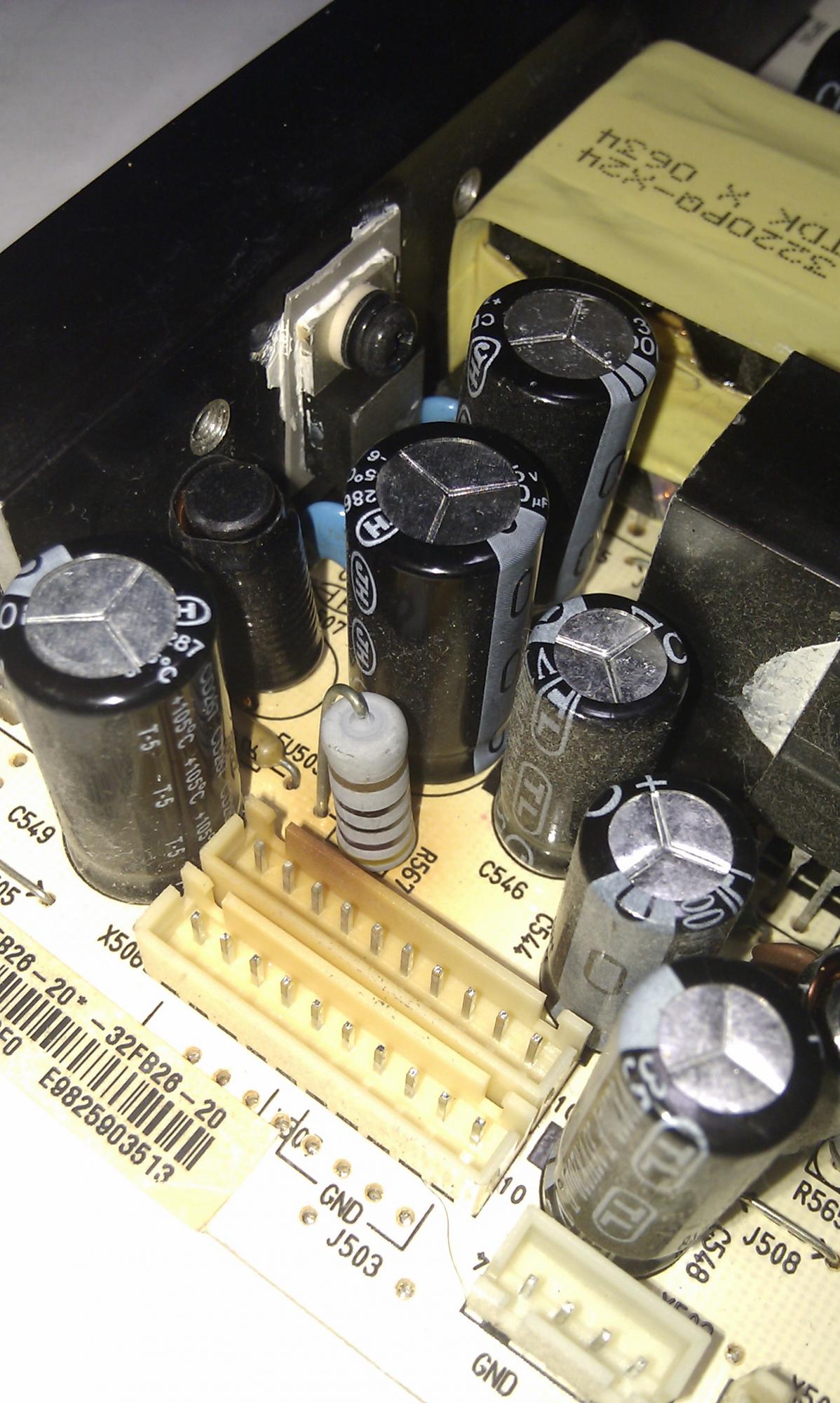

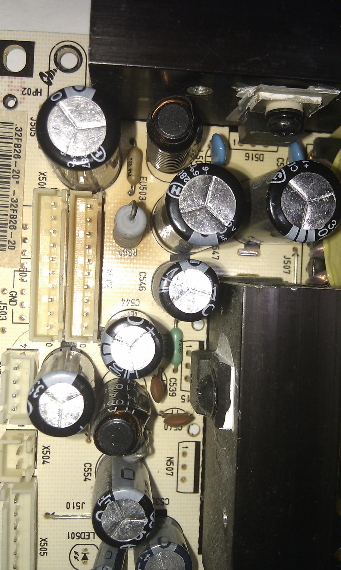

            #65
            Re: Insignia 32" LCD TV Model# NS-32LCD
            Hey there guys, Im new to this forum but have been reading alot on here. This place is amazing! I'm happy a place like this exists.
            But down to the chase. I have the NS-32LCD, and I have pretty much the same symptoms as ajsemtb, except my red standby light would go from red -> nothing (for a few seconds) -> blue and stay blue, but I would have nothing on the screen or anything, a few days ago it would turn on after a few tries with the power button, or it would only turn on after I unplugged it and plugged it back in. but now it doesn't do anything anymore except "try" to turn on. but now it occasionally makes a ticking noise from the speakers when its turning on. It didn't do this before, and it doesn't do it all the time when I try to turn it on, only maybe 50% of the time. But anyways, I took it apart, tested all the outputs and from what I can see the outputs are perfectly fine, (just like ajsemtbs') (i.e 5v +-.1 at 5v, 23.9-24.1 at 24v)
            I checked the FU503 and FU502 fuses and they seem to be ok.
            But what is interesting about my power supply is that is has 2 burned spots on the board, you can see them on the pictures i attached, and i took closeups of them. I tested the 3 watt resistor from the picture, and its at ~442 Ohms (I'm actually not sure what its supposed to be, from the colors I can only fathom that its a 470ohm or something but i have a hard time figuring out the colors since they all look the same lol) I tested the diode that is at the center of other burned area and anode to cathode it showed 22.22kOhm and the other way around it showed 12.60kOhm. (I actually just recently started learning how to test components so let me know if I missed something about the diode or the resistor.) But I think the problem might be related to those two areas on my power supply, and even on the power supplies that others have.

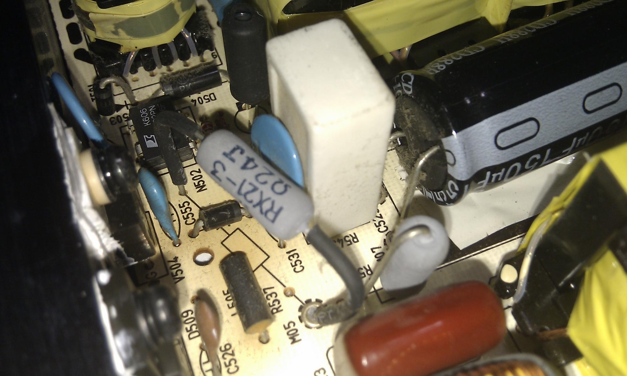

              #66
              Sorry forgot the attachments, But i noticed that there is another component next to the diode in the burned area, maybe its the reason its burned? I dont even know what it is, it only says L505 next to it, it has no writing on itself. Im not sure, what do you guys think?

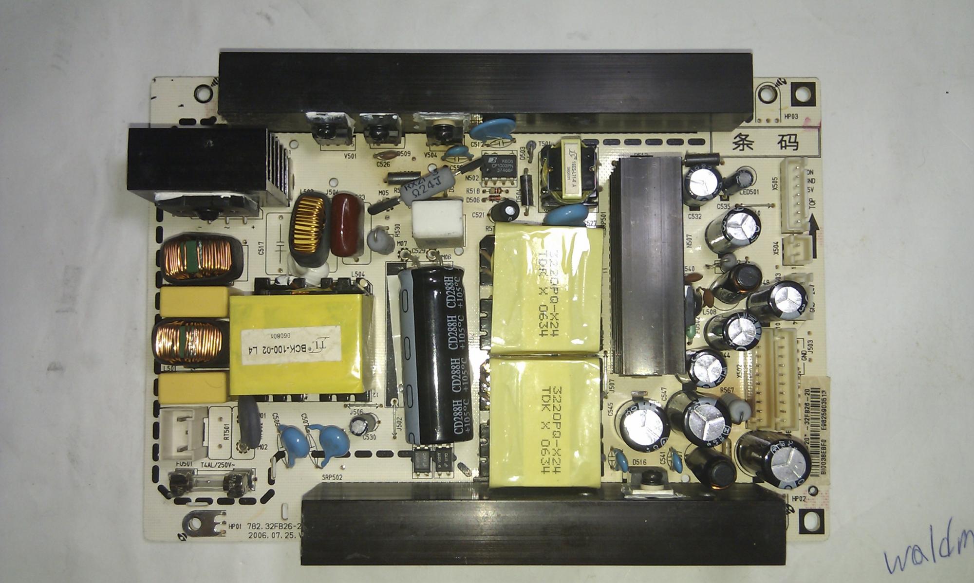

                      #70
                      OPTIONAL READING: Hi all, this is my first post to this board. I had a NS-32LCD given to me today in no certain condition. It feels like good karma since my 42" Toshiba, tools and all my possessions were recently stolen from my storage unit during some travels.
                      Figuring if it didn't work it'd probably be the power board or a fuse and an easy fix, I gladly took it. After doing tons of reading and research on this website and others, I decided to tackle the job.
                      MANDATORY READING:
                      Immediately after opening the TV, I saw a blown barrel fuse (FUSE501) coming right off the AC line. Completely exhausted and VERY arrogantly, decided to jump the fuse. As soon as the AC prongs hit the outlet, the power supply POPPED and scared the crap out of me. This is what happens when you're used to working on low voltage DC electronics.
                      Does anybody know what I could have damaged, or what may have been wrong to cause that POP and CRACKLE? Any idea what I may have damaged?
                      Very intimidated now
                      Thanks!

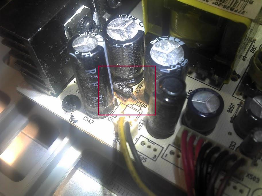

                        I just wanted to post a link to a solution that worked for me:
                        http://community.insigniaproducts.co...lem/td-p/30472
                        This fix was EXACTLY what was wrong with my unit, except that there
                        was a 1000uF, 35V capacitor right next to the pico fuse whose top was
                        bulging, which I replaced with a 50Volt version.
                        The fuse labeled F503 is a pico fuse, but I just used a leaded glass
                        barrel fuse of the same ampage, 7A, 125V, slow blow. Also,
                        I soldered this fuse to the OTHER SIDE OF THE BOARD, so that
                        the 470 Ohm resistor will not overheat it!
                        Additionally, I swapped the original 470 Ohm, 2 Watt resistor, for
                        a 3 Watt version. It was a bit bigger, but it fit fine, and will
                        dissipate the heat a lot better.
                        Now the set works PERFECTLY!!!! The 24 Volts is there!
                        Thanks to this guy for posting the solution....and I hope this
                        helps some of you out there!!!
                        • ajsemtb
                          • Jul 2010
                          • 79
                          #72
                          MANDATORY READING:
                          Thanks!
                          Yeah, so, a pop and crackle could have been a capacitor popping. But if the fuse was popped to begin with, there was probably a short somewhere and when you reconnected electricity to it, it probably popped another fuse. The little pico fuses marked FU502 and FU503 I think are surface mounted fuses. I did pop one of those when trouble shooting my board. BTW I still haven't fixed mine. I fixed another monitor, and this took a back seat. However, I'm getting ready to start working on it again. I'm suprised at the amount of traffic on this thread since I was on here last! I hope people are getting useful information from this thread! It was very helpful to me.
                          • ajsemtb
                            • Jul 2010
                            • 79
                            #73
                            Originally posted by clutch.exe
                            So I've been looking for this part but I can't seem to identify it in order to get a replacement. Anyone have any ideas? I know it says FU502 but I really don't think that its a fuse.
                            Clutch, that's one of the pico fuses that keeps coming up in these threads. I replaced mine as well, and the replacement was green or something. color doesn't seem to matter as much as its a 7amp 125v slow blow pico fuse. I popped mine while trying to diagnose my problem and accidently shorted a couple points.
                            • ajsemtb
                              • Jul 2010
                              • 79
                              #74
                              Robbie, this looks like the pico fuse and resistor that thread was referring to about 3 posts up. If not, here's the link: http://community.insigniaproducts.co...lem/td-p/30472
                              I'm going to try this fix on mine. If you haven't already trashed you power supply, you could try repairing it, then selling it as refurbished! LOL

                                #75
                                OPTIONAL READING:
                                Thanks!
                                Hi -We need pictures of the top and bottom of the power board initially.
                                These should be jpg files no bigger than 2mb and no larger than 2000x2000.
                                We should be able to read the part numbers on the board with ease.
                                Close ups of any bits you think you have burnt and close ups of the board number and any connectors also help.
                                Post the pictures using Manage attachments which can be found by
                                clicking on go advanced under the quick post section.
