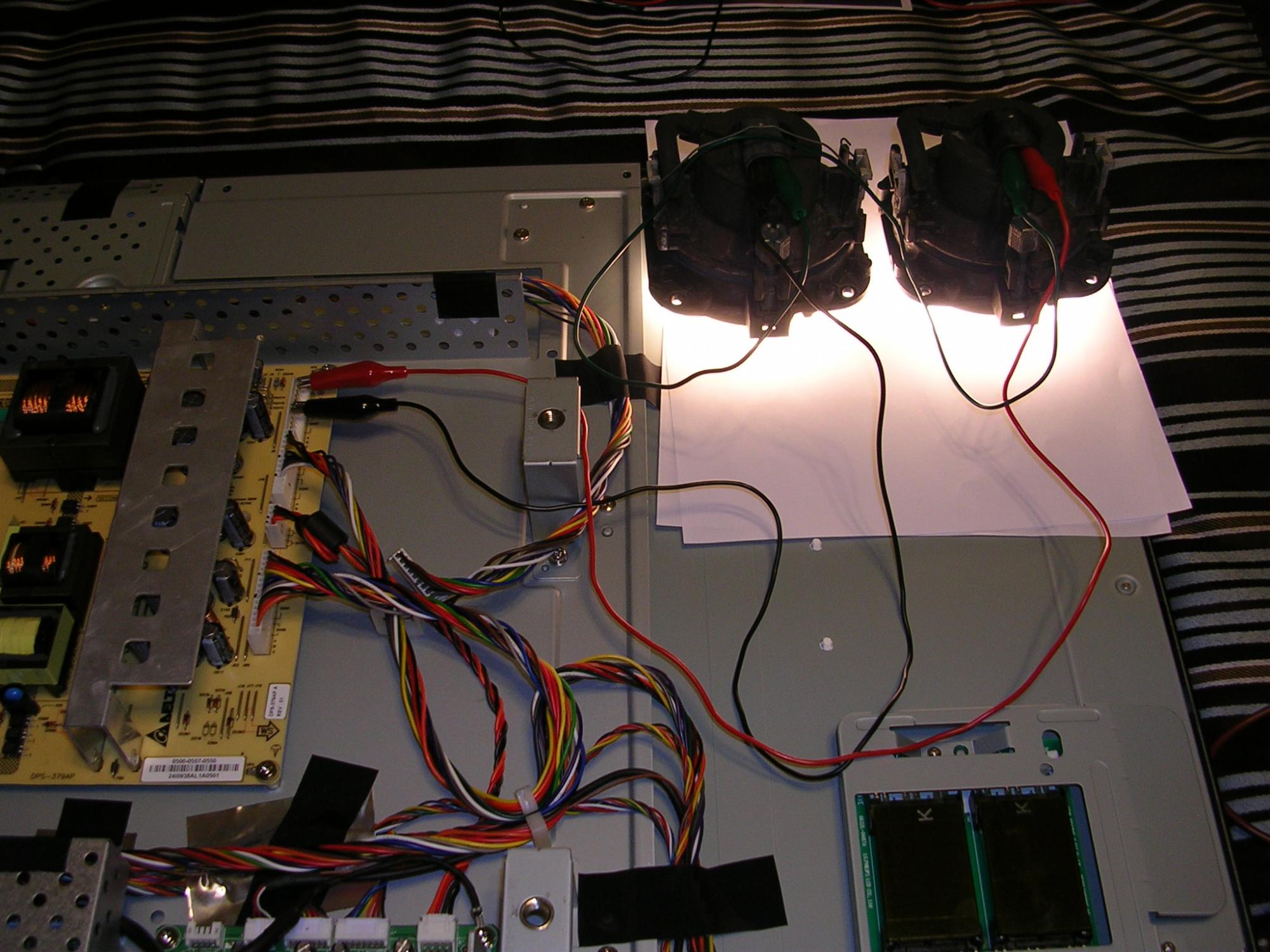

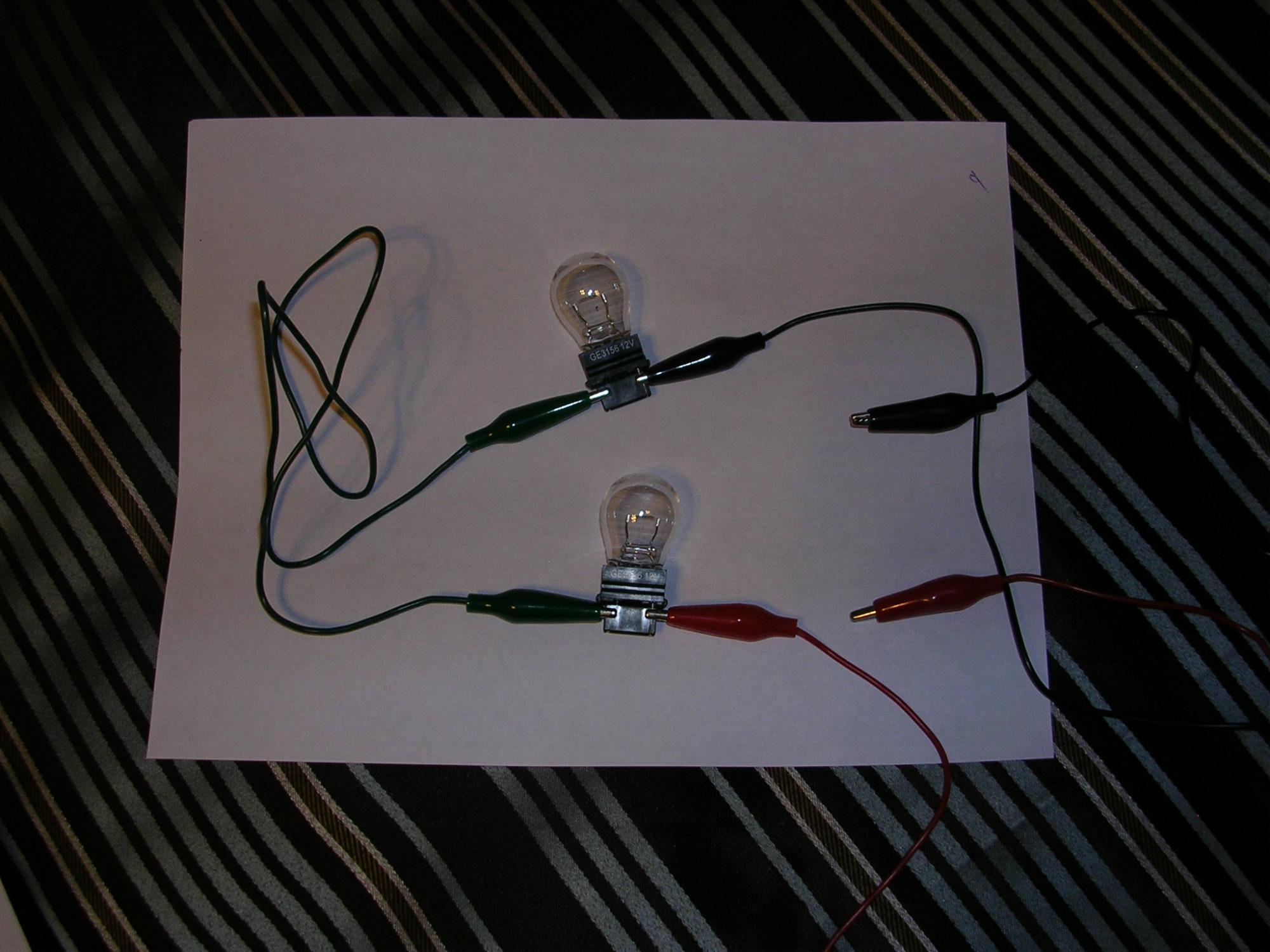

No picture. I was looking for a "no signal", or menu, as
I was pressing the menu button, but nothing. Just a dim
flashing.
Are you certain the faint ticking from the power supply is
normal? It's faint, but audible, and I've never heard a
SMPS make this kind of noise. It's the first thing I noticed
when I turned it on. I checked the back of the ps, and
it looks normal. No bulging caps or nothing.
If it's the main, they are going for about $50 on Ebay.....I'll
have to think about this one, because I sold the last
NS-32LCD I fixed for only $180.
