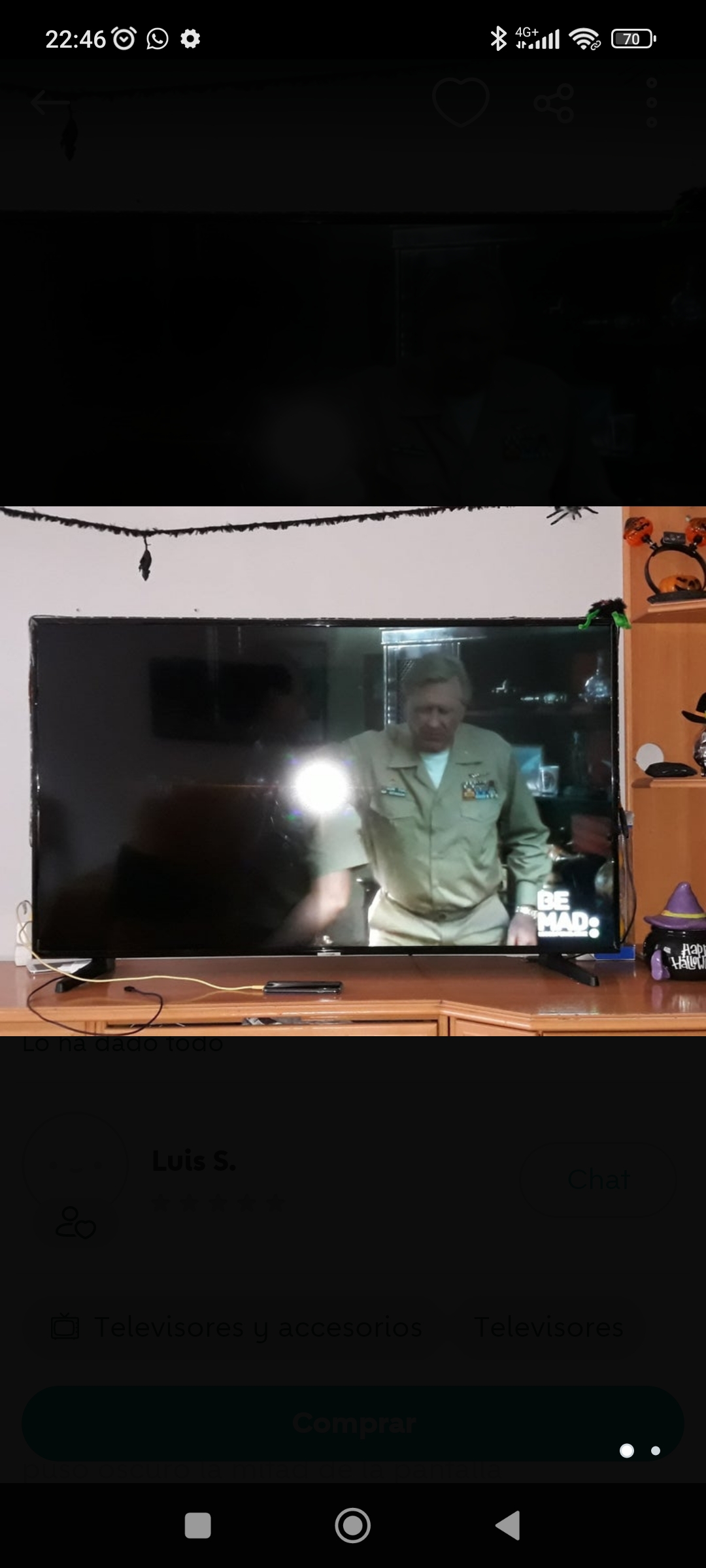

    Hi there
    I've seen a posting for a cheap broken Samsung TV series 7 50 "
    The posting states that suddenly the left half of the screen went dark
    Is this a broken LCD or is this a set of backlight led?
    Thanks in advance

    Re: Samsung tv half LCD black
    bad led strip
      Originally posted by Davi.p
      bad led strip
      Ok are you 100% positive on this?
      I would purchase if the issue is the led strips but I don't want to buy it if the LCD is broken
      Arent the led strips usually arranged horizontally?
      Thanks!
        The backlight is rather end and one bar (on the left, at the bottom) does not work.
          yes i'm sure, evidently 1 of 2 edge bars is broken
            Ok I was just asking cause all the tv sets where I've changed led strips they were arranged horizontally
              yes horizontal, one on the left one on th right
                Ok I will probably purchase it and see if I can source the led strips.
