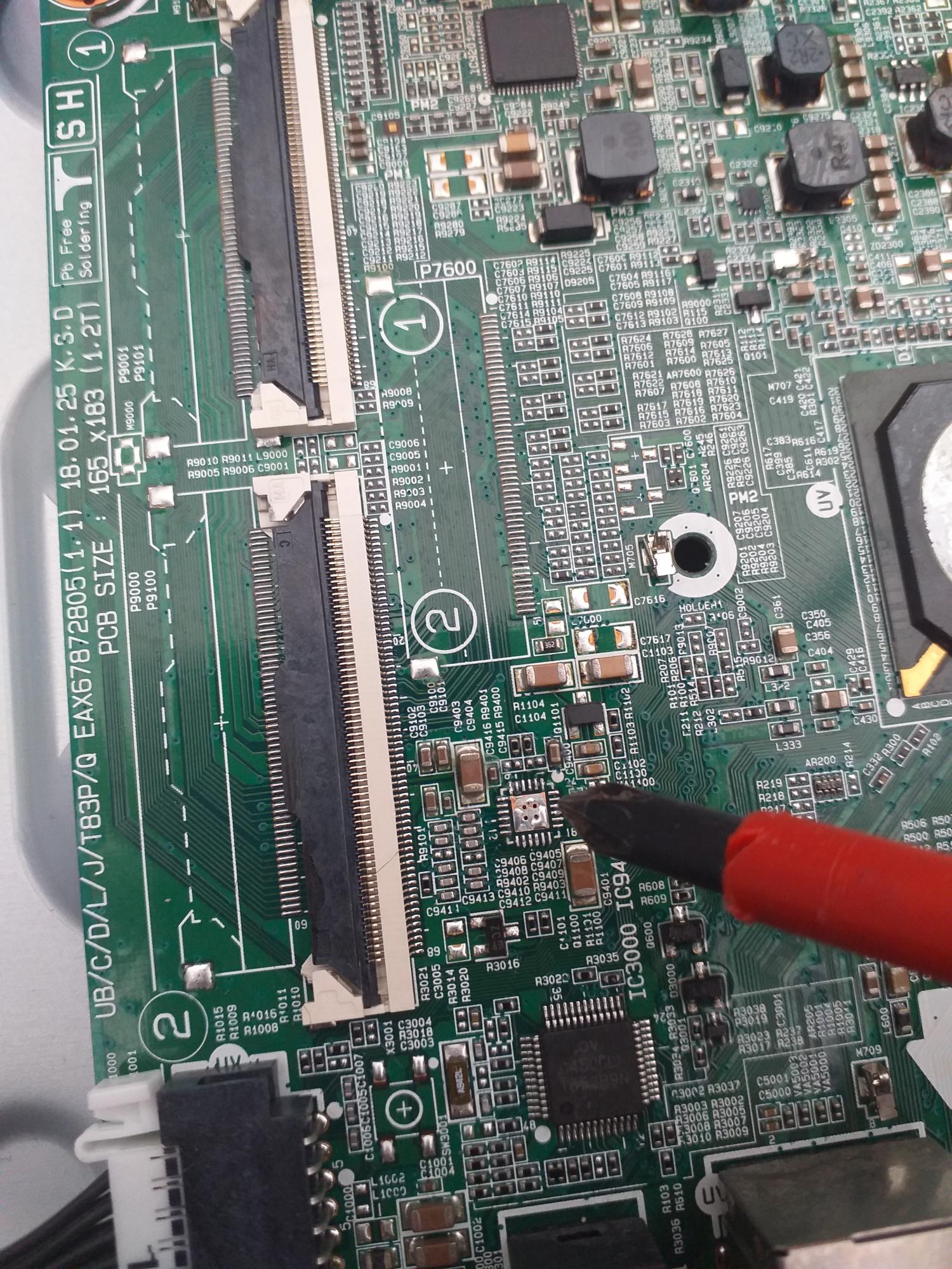

    Hi everyone, I have an LG 55UK6950PLB, it started off with the LG logo then top top left hand corner HDMI2 comes up then fades away then just sound. Onboard t-con board not separate.

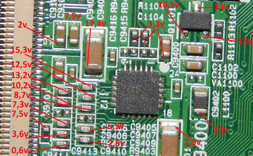

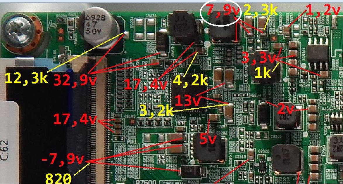

    I found a metal can capacitor at the top of the board in line with the LVDS sockets I measured 32 volts and it dropped off, I removed the ic below it and no picture so I assume it's needed lol, but the 32v still dropped off.

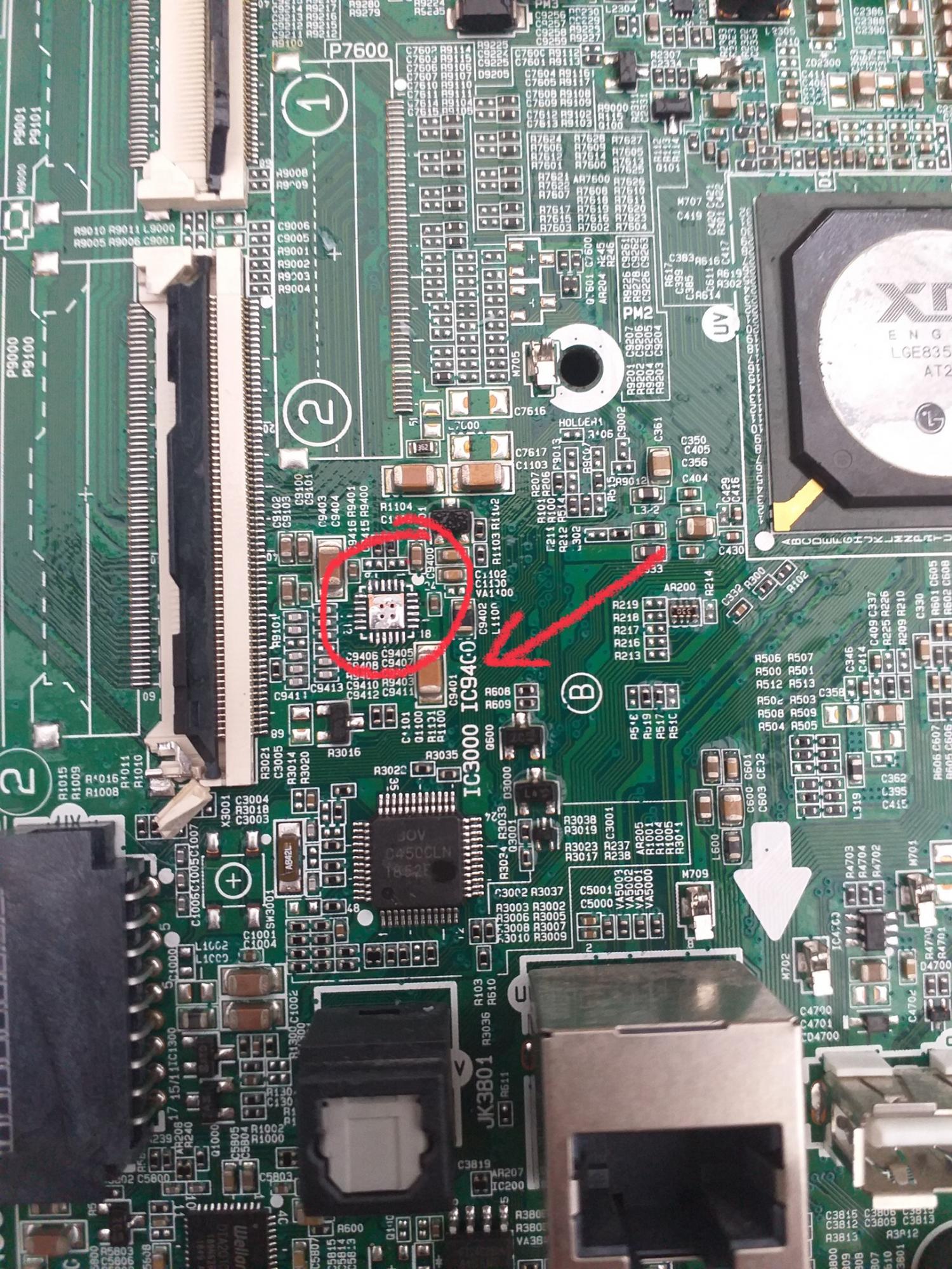

    I then removed IC9400 a 24 pin package and all the voltages stayed up and the screen works it's watchable besides some feint lines on the right hand side that seem to flicker depending on what's displayed like a red background or light blue for example..

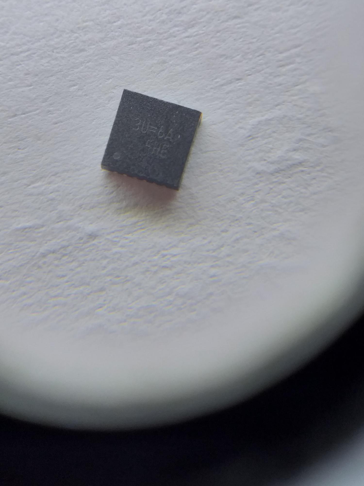

    I have been trying to find out what the ic is or does from what I can see the ic is
    3U=6AFHE or the F could be a warn out five I'm thinking it's a voltage regulator?
    Any help would be appreciated thank you

    Not she?
    3U=xxxx - RT9553A
    (RICHTEK)

      Hi Lotus definitely looks like a “F” looking at it again ��
      Thanks Lotas

          What I posted on the marking matches, but it doesn't match the pinout and the number of pins, I only found a voltage map for it.

              By your voltages it looks like a gamma chip.

                Hi dskall
                The tv is working without the IC9400 in place I was just wondering what the purpose of IC9400 is just that it has flickering feint lines down one side, it's kind of watchable
                Thanks Gary

                    Hi Dskall, I'm well aware you suggested that it could be the Gamma ic, but would it cause horizontal lines on the right hand side of the screen, I always thought gamma ic's that have gone faulty cause a white screen….
                    My question was what does the ic in postion IC 9400 do what is it's job?
                    It seems to be labelled 3U=6AFHE (see photo)
                    Kind regards
                    Gary
