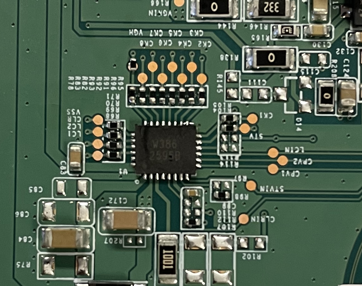

    Had a V585-H11come in with no picture today. Similar problem to the Samsungs i figured out a few months ago
    https://www.badcaps.net/forum/showthread.php?t=107445
    Same solution. I replaced a single 0 ohm resistor on the TCON with 10K ohm. It turned on, has picture, no distortions or artifacts. Looks like R78.
    I dont know why this works, but it works.

    Re: Vizio V585-H11 T-con Mod
    That's impressive, good job!
    Can you post full picture of your t-con with readable label?
    This model is using different t-con types.
      I try your fix, and it make the panel work again but the image glitch for a few millisecond every 2-3 sec or so.
      So it have a short somewhere and I only bypass some safety measure with that resistance.
      It can probably mean its trash time unless you have more idea. Im about at the max of my capabilities here.
        Post a picture of your work.
