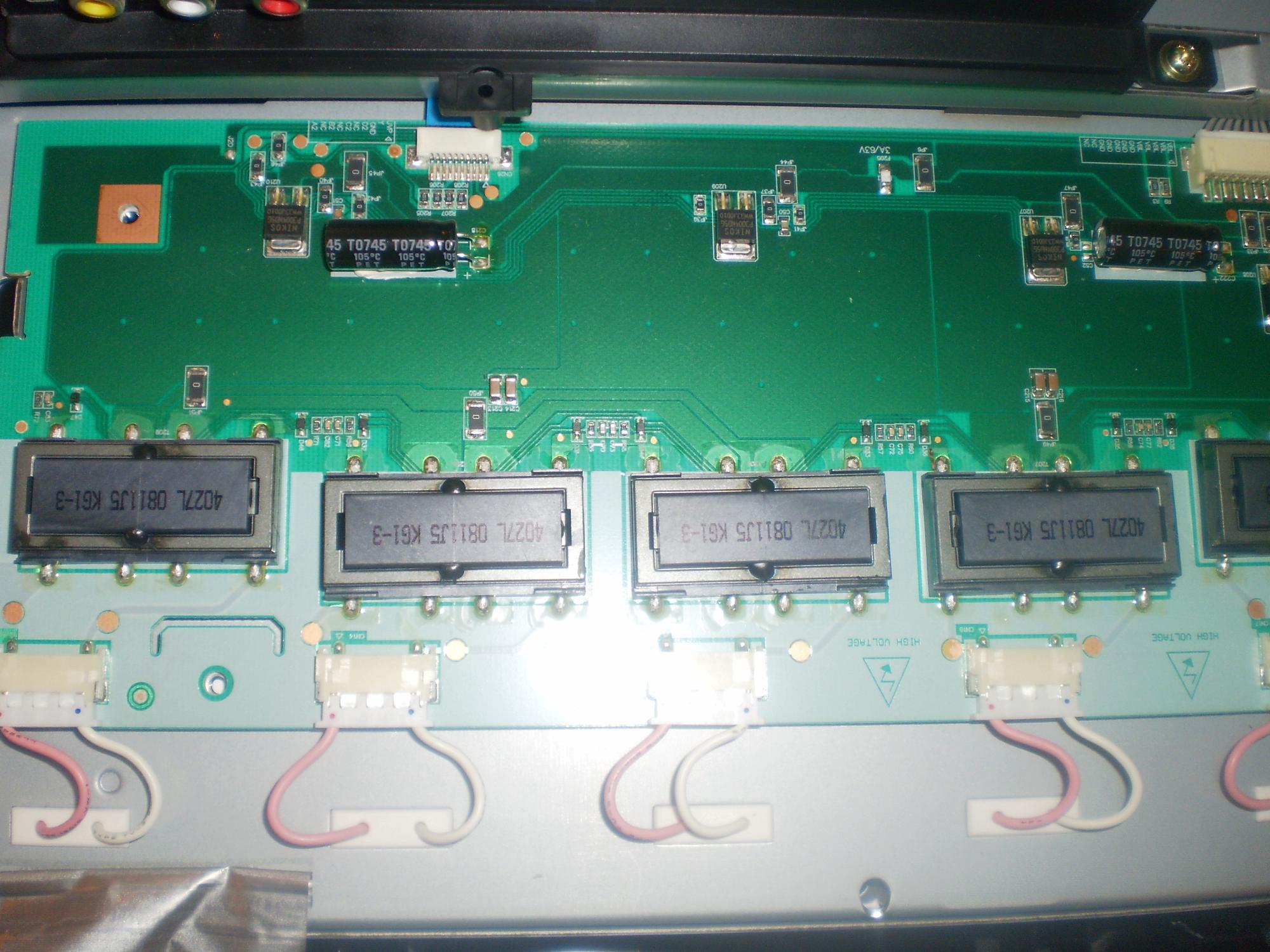

                      This looks like the same setup as the magnovox inverters I have worked on. in my experience, they either produce no backlight, or maybe a flicker of a backlight before going out.
                      its almost ALWAYS due to a faulty transformer. you MUST pull all transformers, one at a time, and do a resistance check on all windings. keep a chart. youll find a bad one.

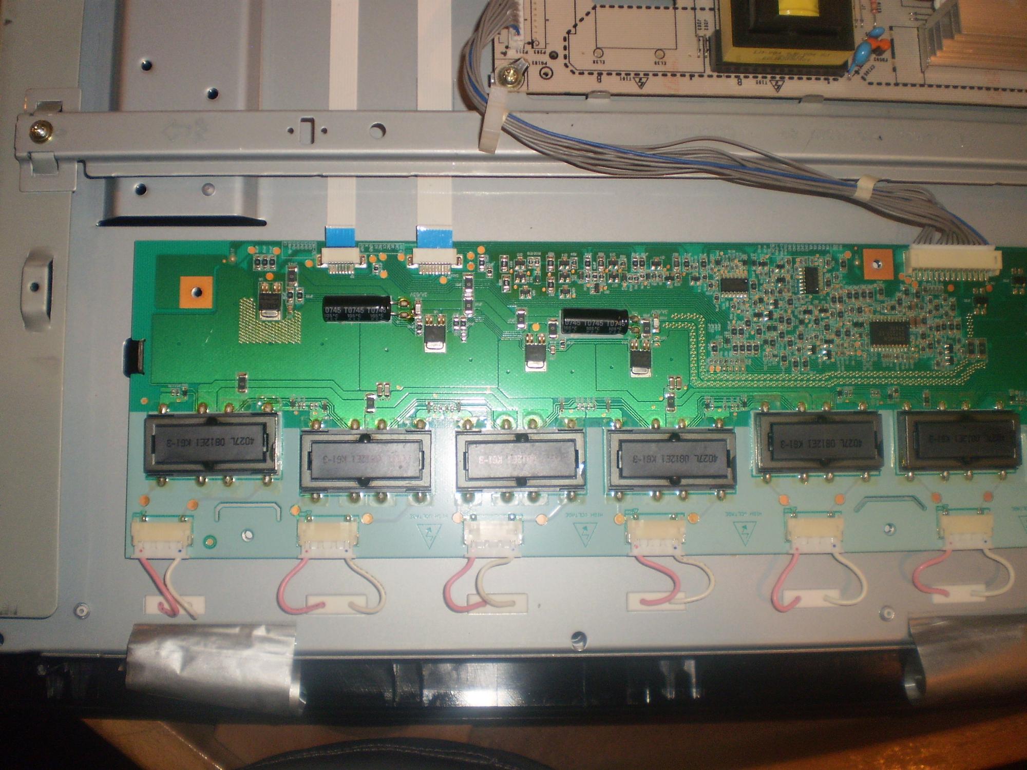

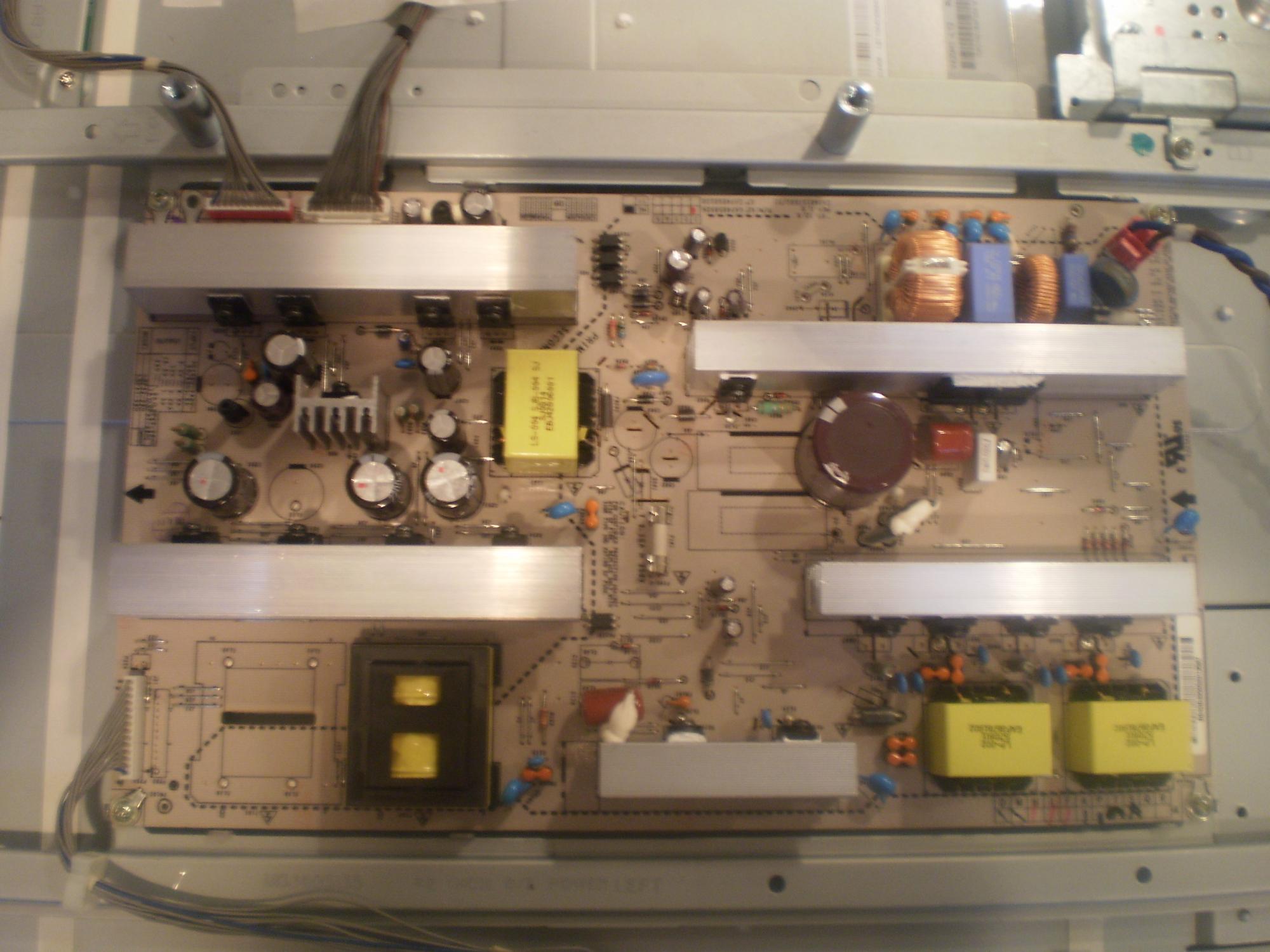

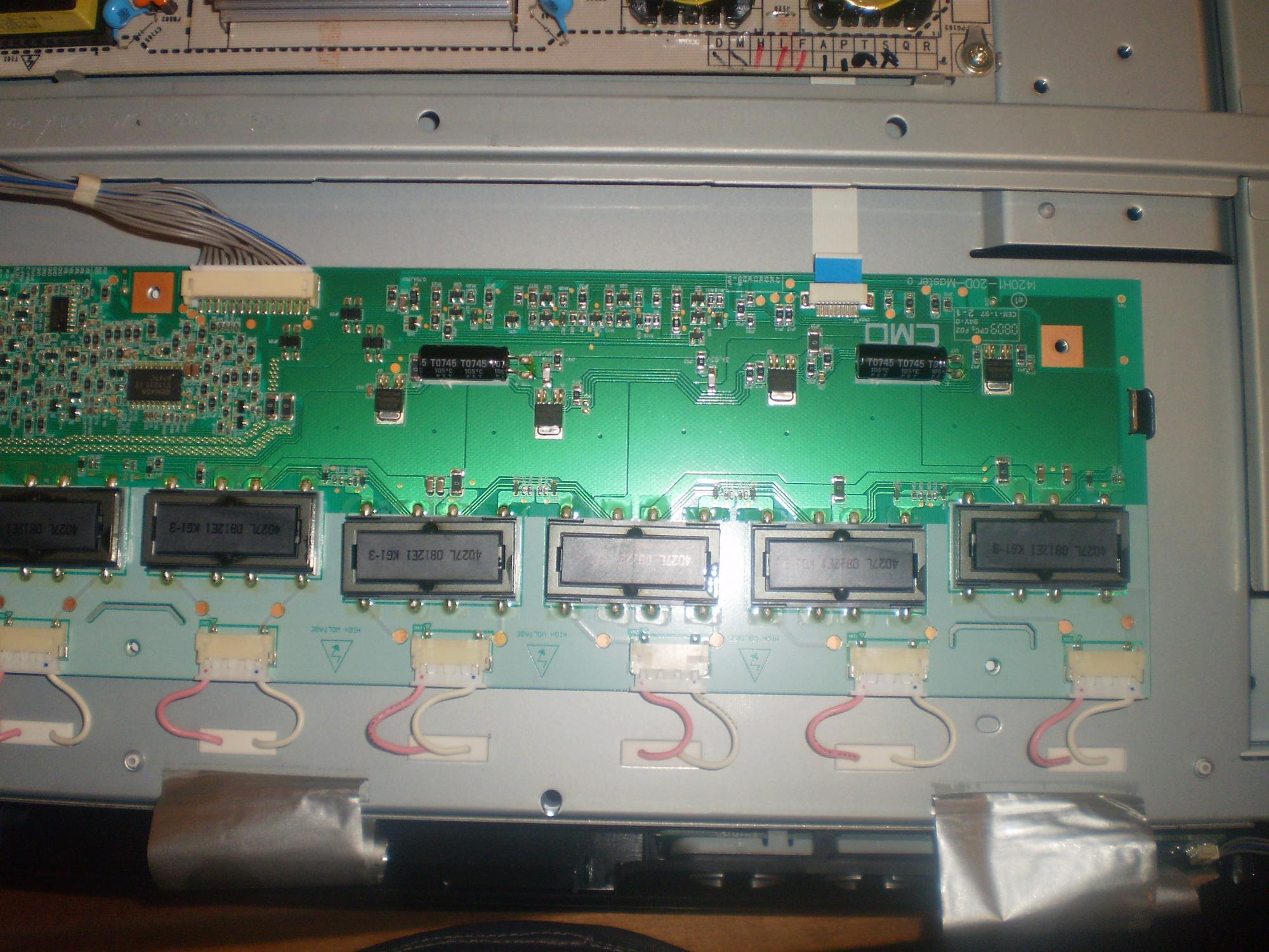

                            #53
                            Re: 42LG50 no backlight
                            here are the pics

                                Okay, so I talked with my LG guy in Virginia and he says that the red flashing lights means that the unit is going directly to "Standby" and not even making an effort to power up the inverters.
                                THis is confirmed since I unplugged both inverters in my initial testing.
                                He said that capacitors are usually the cause on these power supply boards (from what they have serviced). I do not see any that are bulging or leaking but that may not always be the case with bad capcitors.
                                I will take each one out and test with my multimeter.
                                Worst case I can just replace them all (9 of them) and see what happens.
                                He definitely thinks it is the power supply though.

                                  the caps look like they're Sam Young -> replace on sight (all of them, except the big 400+V one)

                                      the manufacturer of those crappy capacitors on that PSU board..

                                          Well, I ended up just buying an entire power supply card from ebay for $30. When I get it and install, I will post results here.
