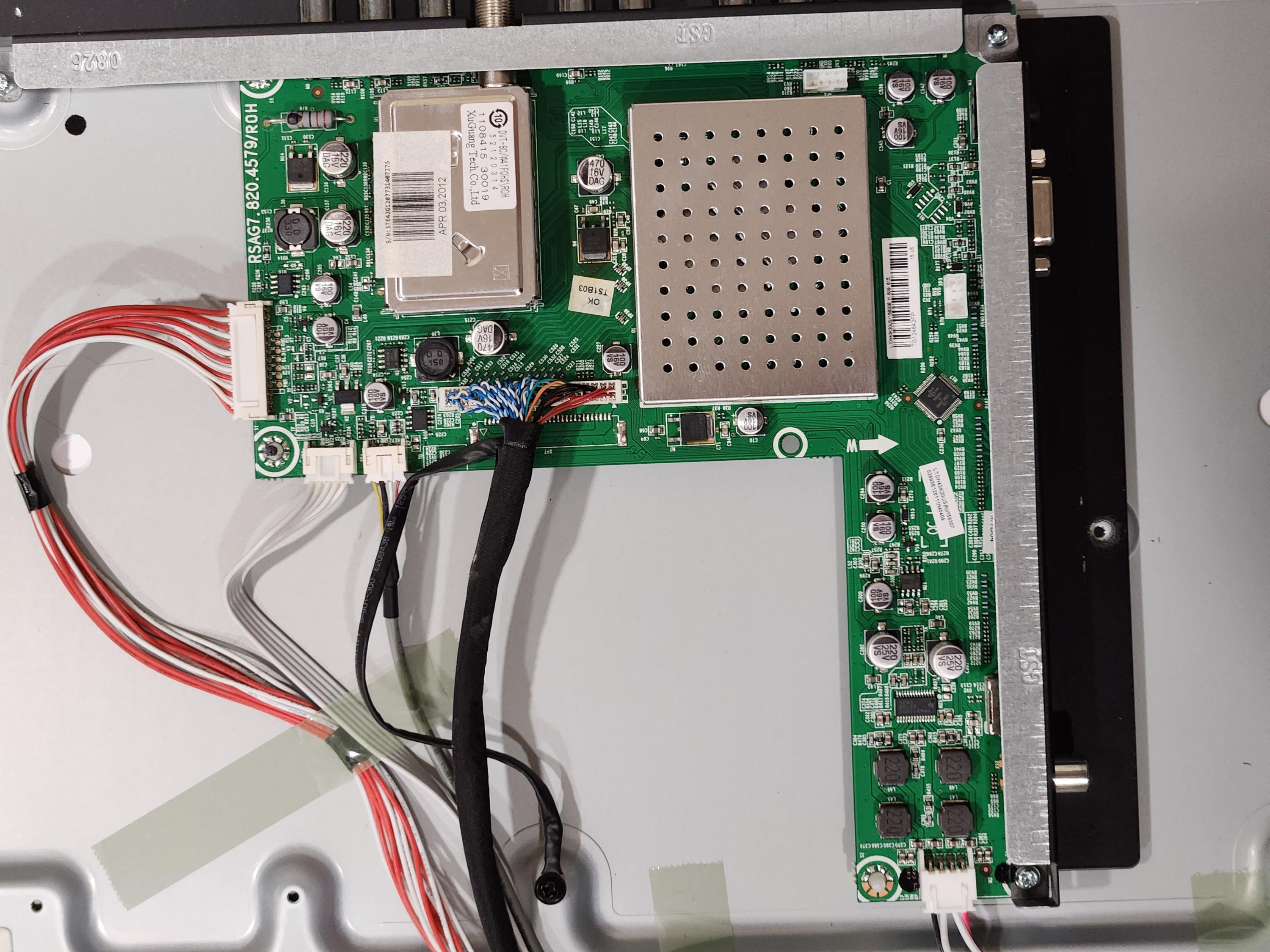

    Hisense F42K20E Hum
    With the TV on and not connected to any inputs, I get a hum. Increasing, decreasing, or muting the volume does not change it. It hums through the headphones as well.
    The hum slowly and slightly goes up in pitch, then comes back down. On the blue screen, a click is heard every time the words "no signal" moves.
    If I connect a device to the HDMI port, the hum gets much louder. The video's audio still plays and if turned up enough, it drowns out the hum.
    I read the thread about this model and a static noise. I listened to the audio and it is different than the hum I'm getting. I tried that solution of making sure the boards were clean and I did not help.
  • revenerd
    • Sep 2022
    • 11
    Re: Hisense F42K20E Hum
    I have a little more time to look at this issue. The sound IS more static-like than I remembered.
    When powering on with no devices connected, I get the blue screen with the words "no input" jumping around. The words are motionless, then jump to a new location. On each jump, I hear the static.
    Any change on the screen results in the static sound. I.e. When the numbers change while adjusting the volume, pressing mute, changing the channel, moving around in the menu.
    I muted the TV and the static sound is still there in the same way.
    When I power off the TV, I hear the static for a few seconds after the screen turns off.
    Using an HDMI source with a video, the static becomes constant. Audio is heard, but the static is loud.
    I have reset the TV (static is there throughout the initial setup), increased the brightness to max, removed the power board and cleaned with alcohol and toothbrush (worked for another post about this model), and listened through the headphone jack (static is the same).

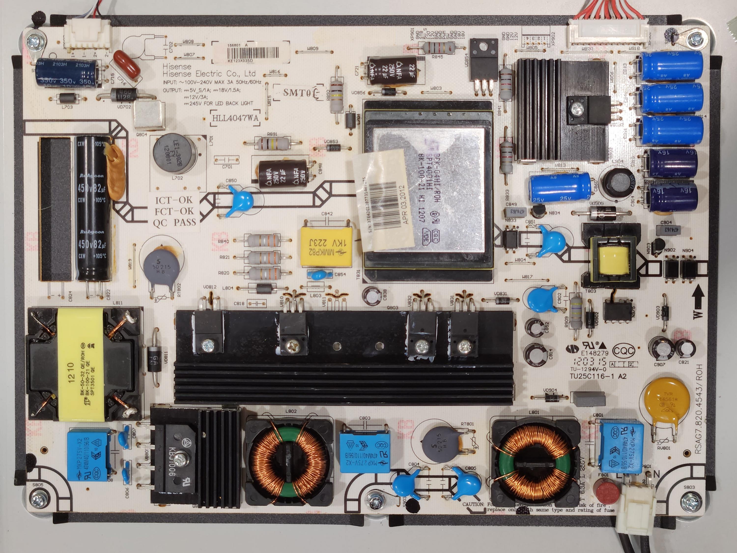

          There is an inductor on the power board I can hear buzzing. It is located to the right of the long cap on the power board and is labeled LEI-302B.
          Could that be the issue?
          • Diah
            • Feb 2013
            • 6363
            Originally posted by revenerd
            There is an inductor on the power board I can hear buzzing. It is located to the right of the long cap on the power board and is labeled LEI-302B.Could that be the issue?

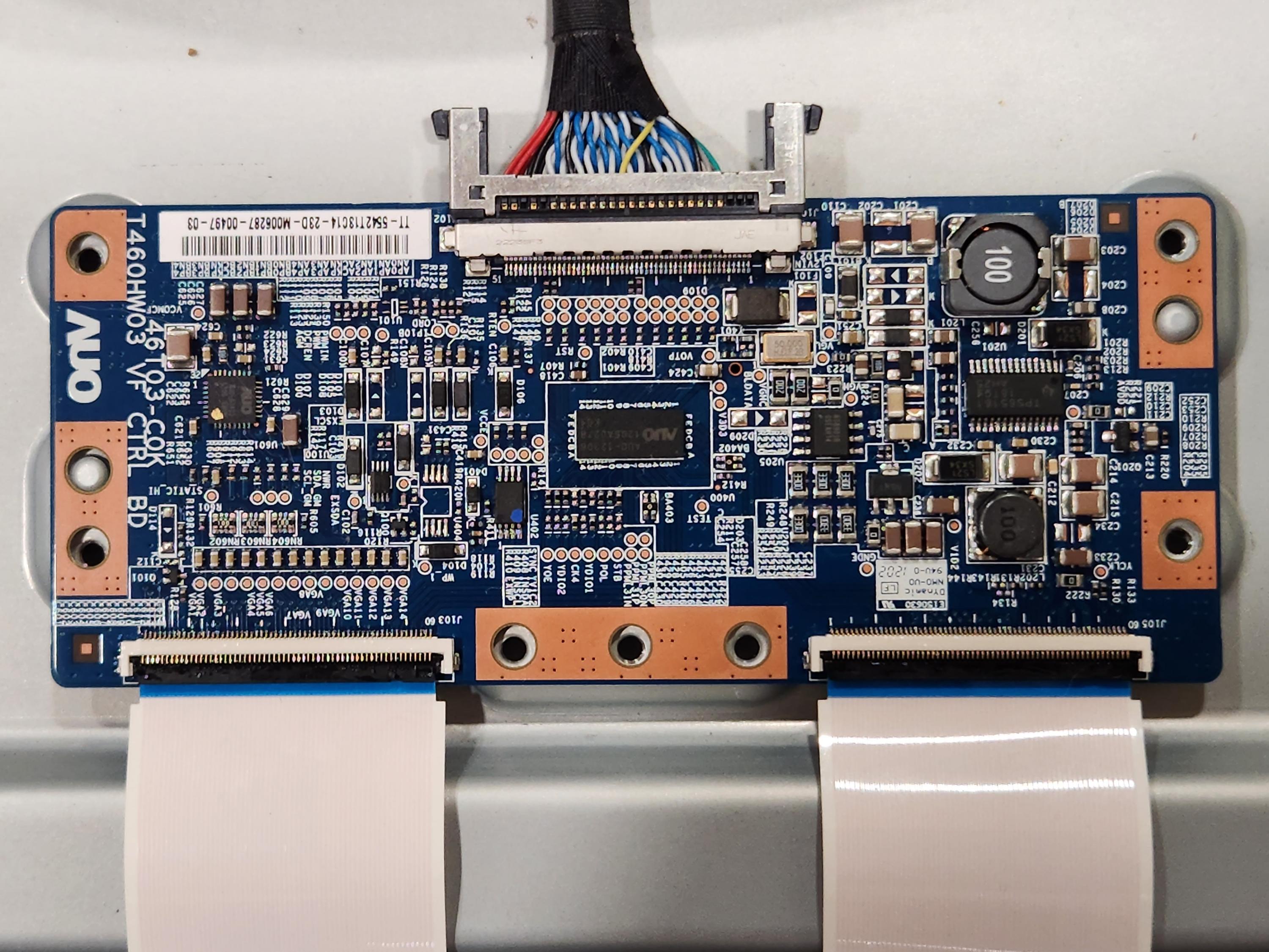

            buzzing at PSU caused when there are load.. the most i found its at ribbon cable between T-CON and panel or LVDS . as yours LVDS are wires.. i would say start to clean pins and check after soldering... also if you have T-CON just disconnect the panel from it and turn on see the sound / buzzing if there any change.
            • revenerd
              • Sep 2022
              • 11
              Buzz is still there after disconnecting TCON. Also attaching TCON board picture.

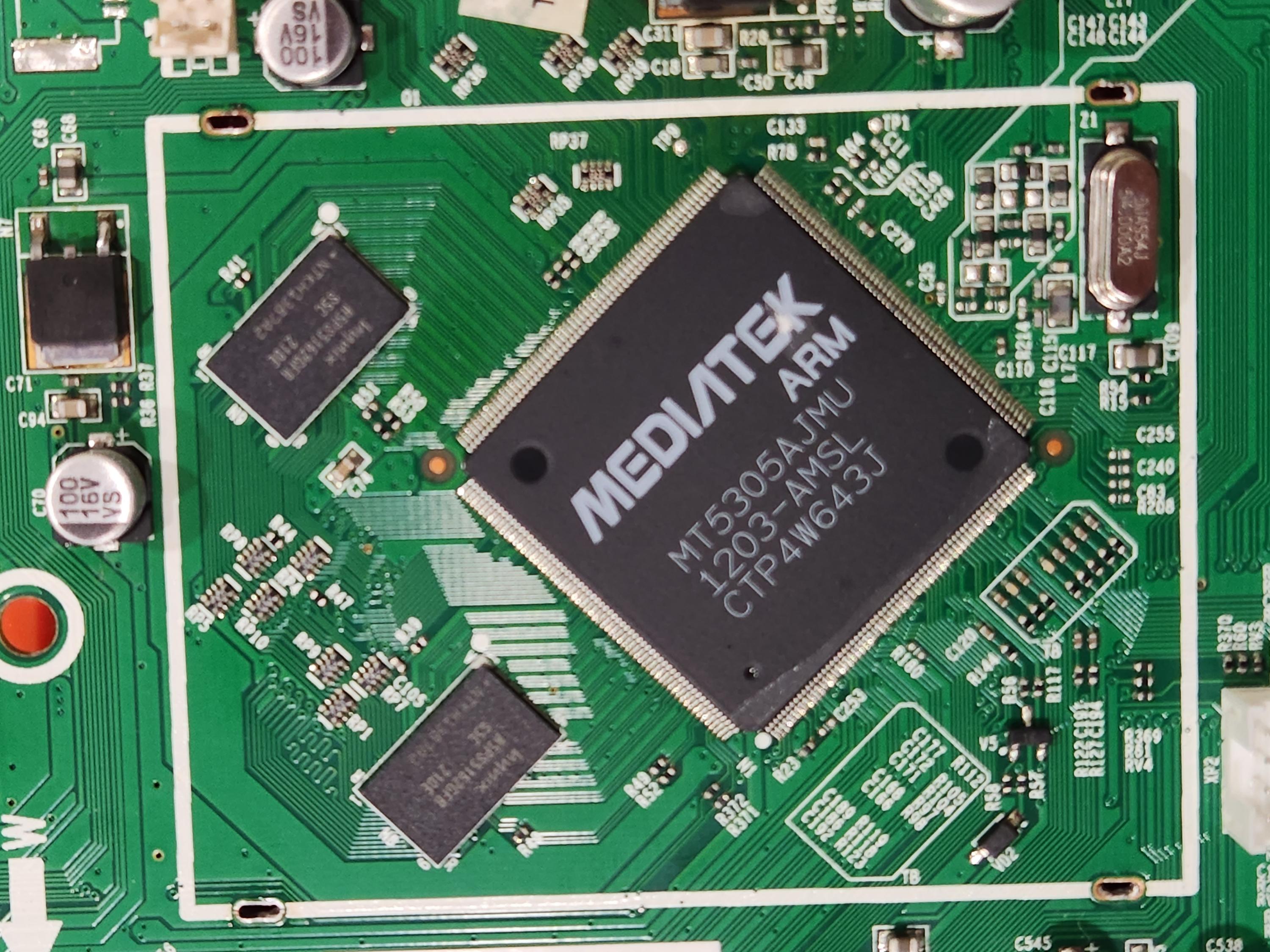

                              is there a silicon pad on the cpu?
                              • revenerd
                                • Sep 2022
                                • 11
                                Yes, there is a pad on the underside of the CPU heatsink.
                                I removed the soldered on metal cage around the CPU chip and removed the heatsink. I cleaned around the CPU with alcohol and a toothbrush, saturating the area well. I allowed it to dry then reconnected. The hum and click was still present but drastically reduced. I connected a video source and when audio was playing, the noise was imperceptible. I reassembled everything.
                                After reassembly, I conned a source and started playing video. It was normal, however, after a few minutes of playback, the buzz returned. It is there, distraxtively, through all of the audio.
                                Also, on a white screen, the left half of the screen is slightly darker. It's not noticeable during normal playback.
                                I've attached a picture of the CPU.

                                  Are you able to reflow the cpu with soldering iron stick?
                                  • revenerd
                                    • Sep 2022
                                    • 11
                                    I've never tried that on pins that small and close together. Is it just running the tip across them to heat them up?
                                    • Davi.p
                                      Hobbist Tech
                                      • Sep 2009
                                      • 4318
                                      • Italy - Milan
                                      apply much flux, use a salami flat round tip, or a common conical 1mm tip, ad a bit of solder tin, run over the pins slowly, but there are plenty YouTube videos about..
