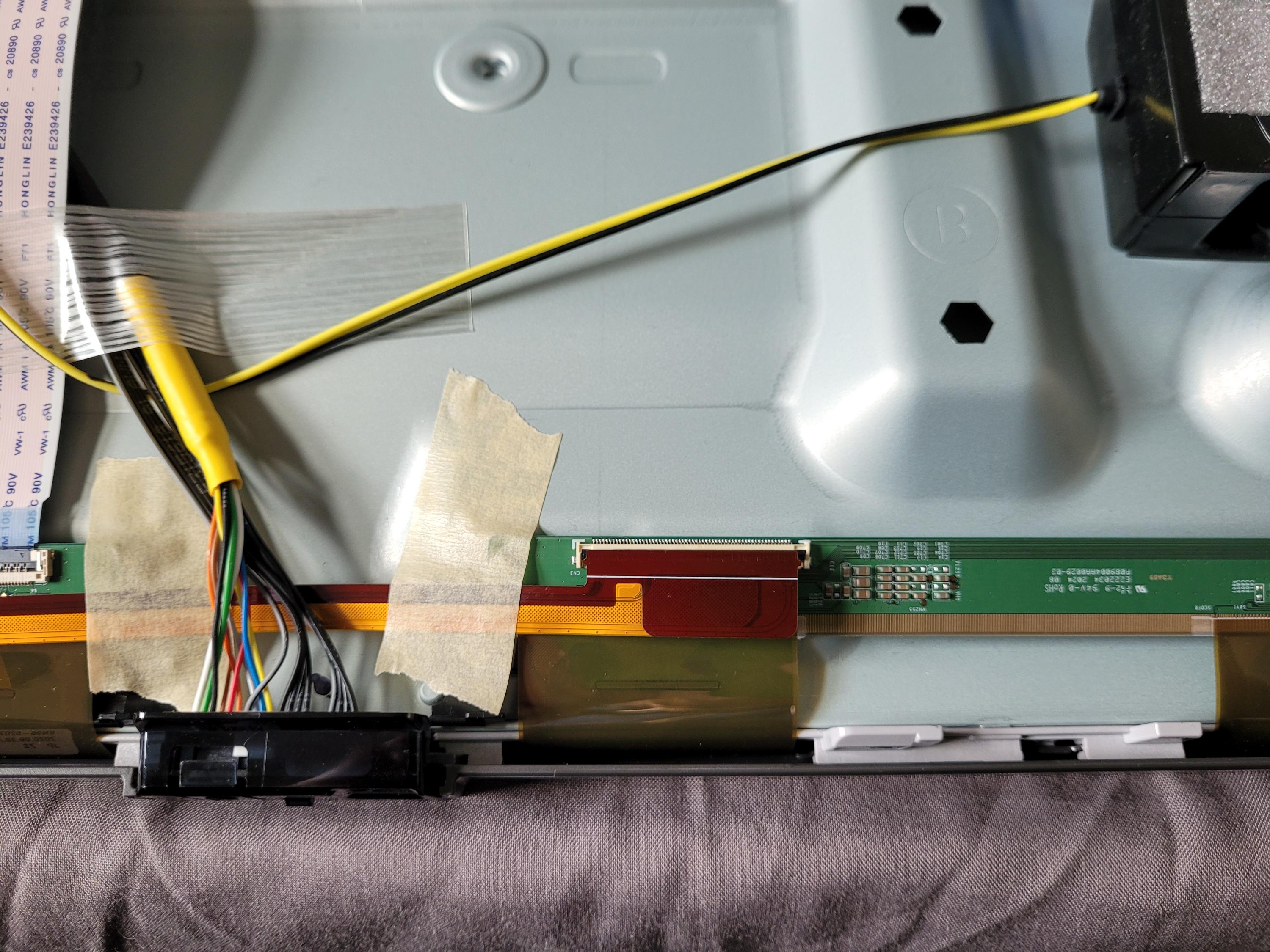

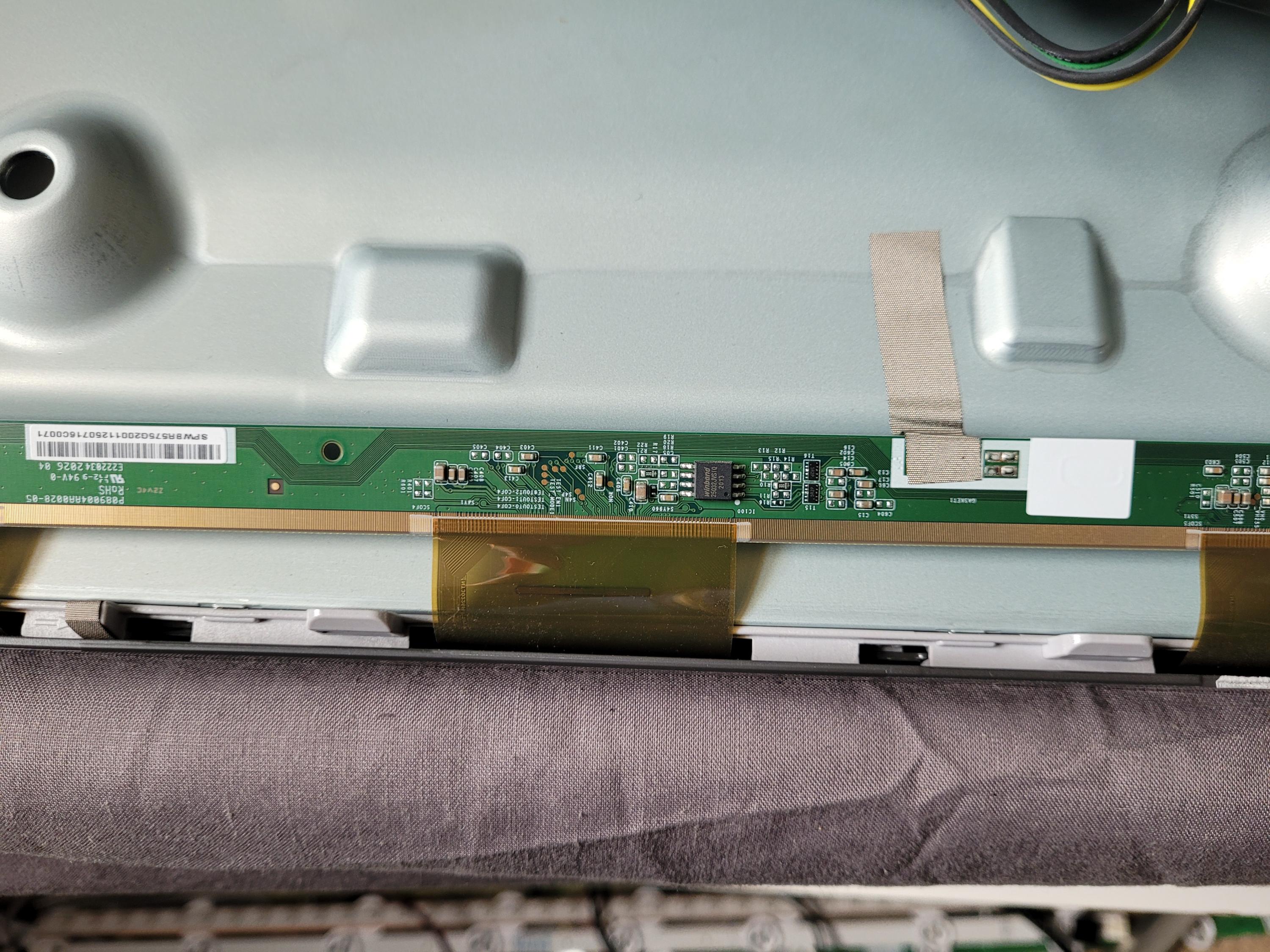

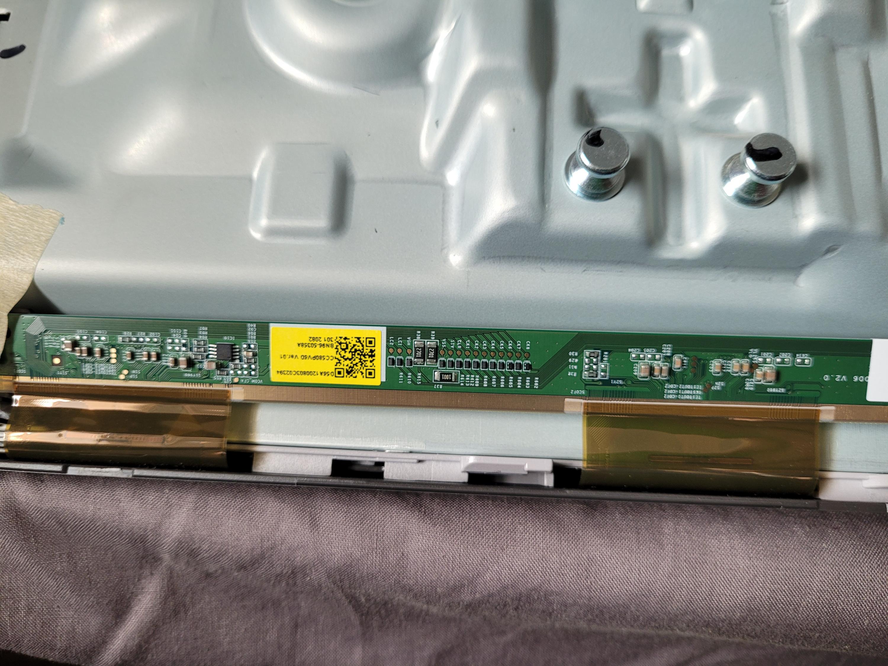

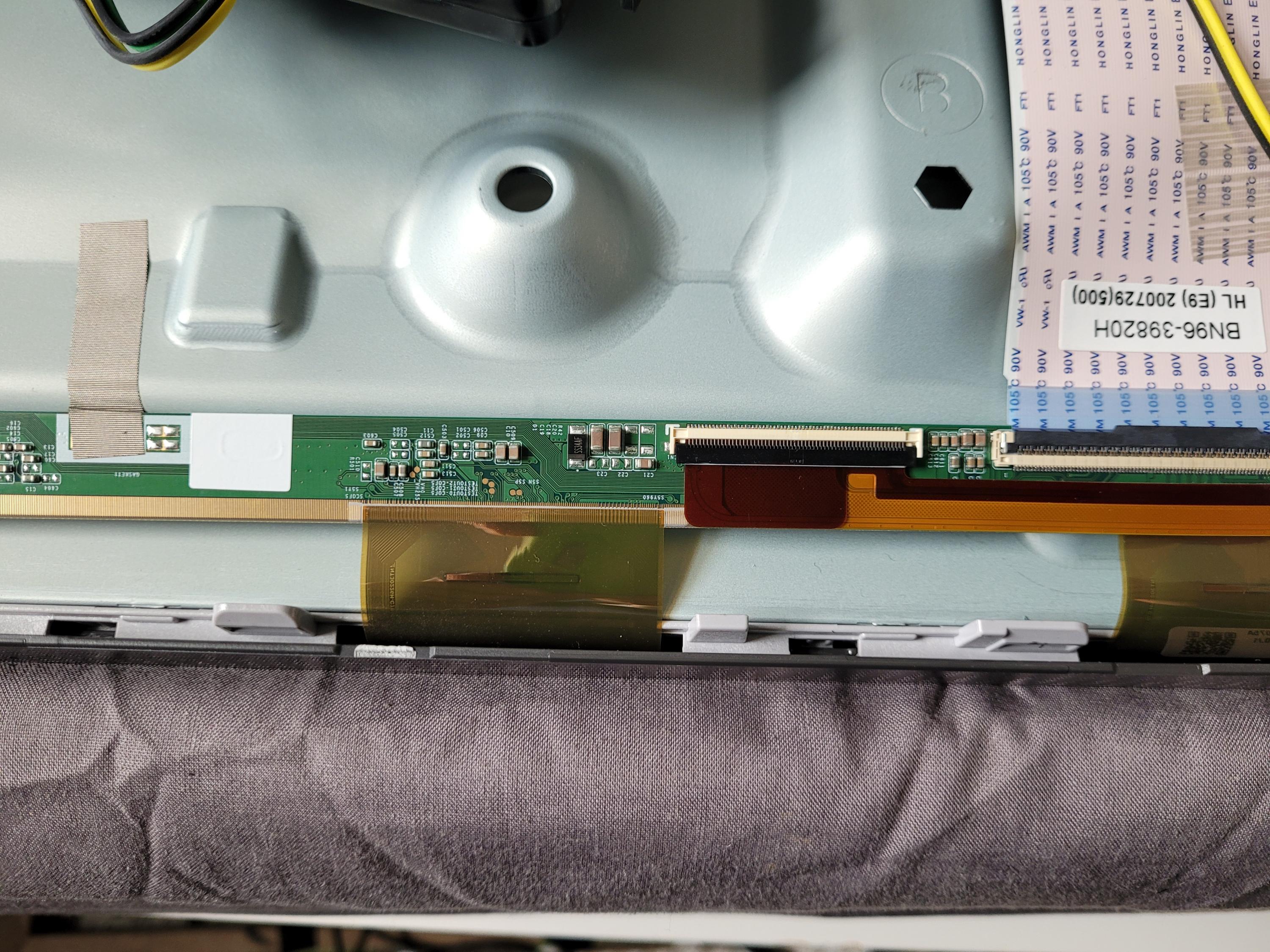

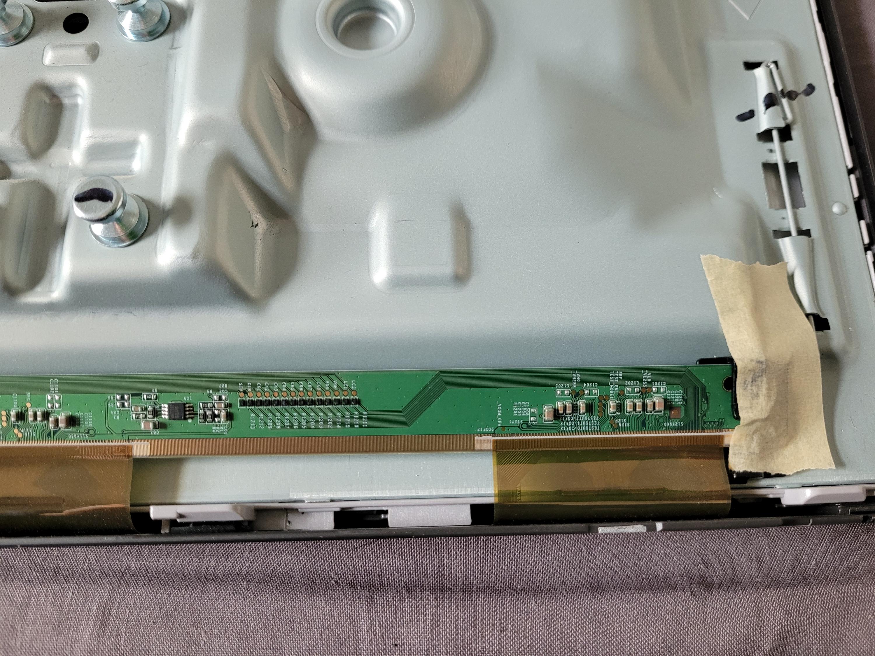

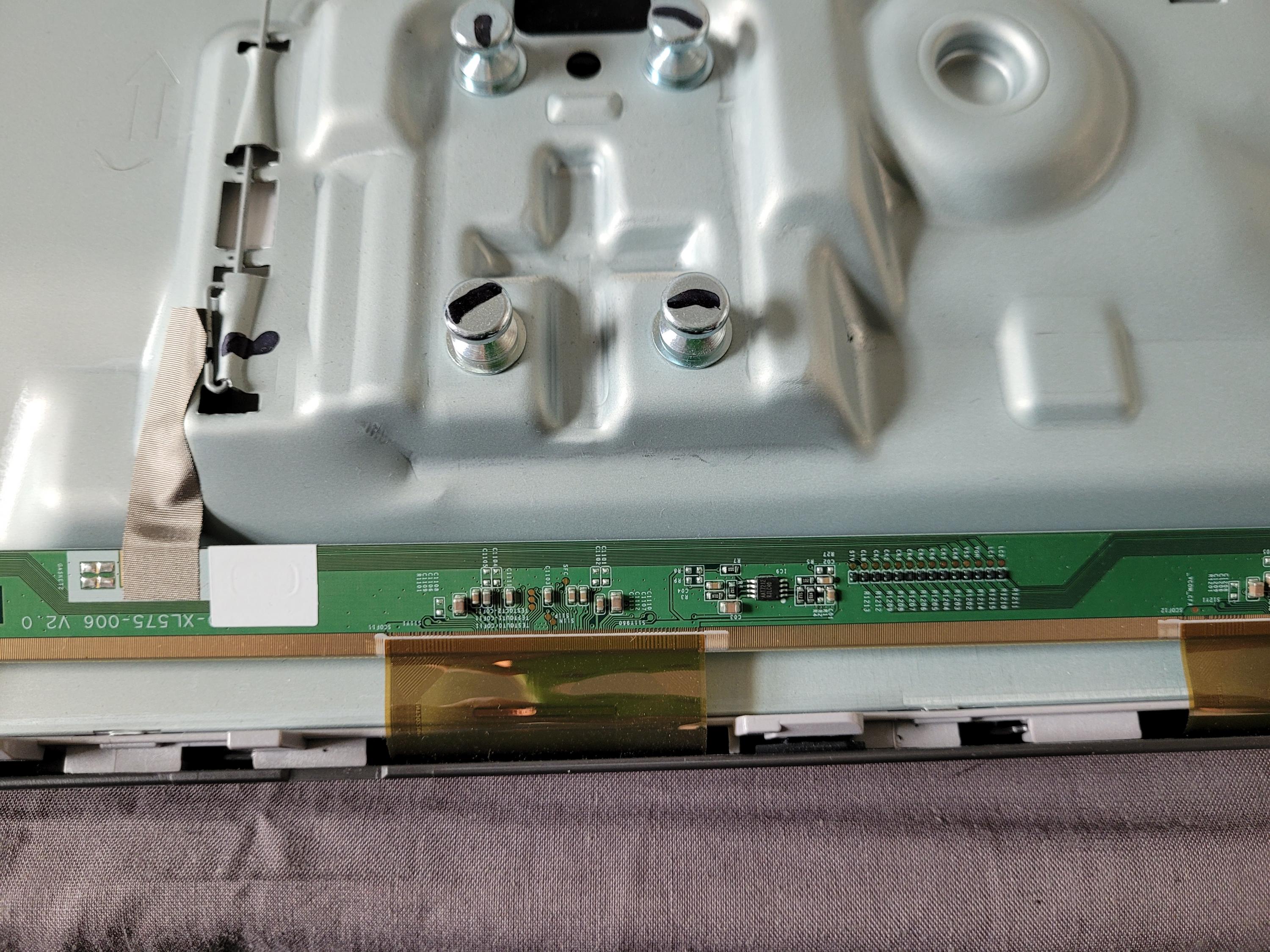

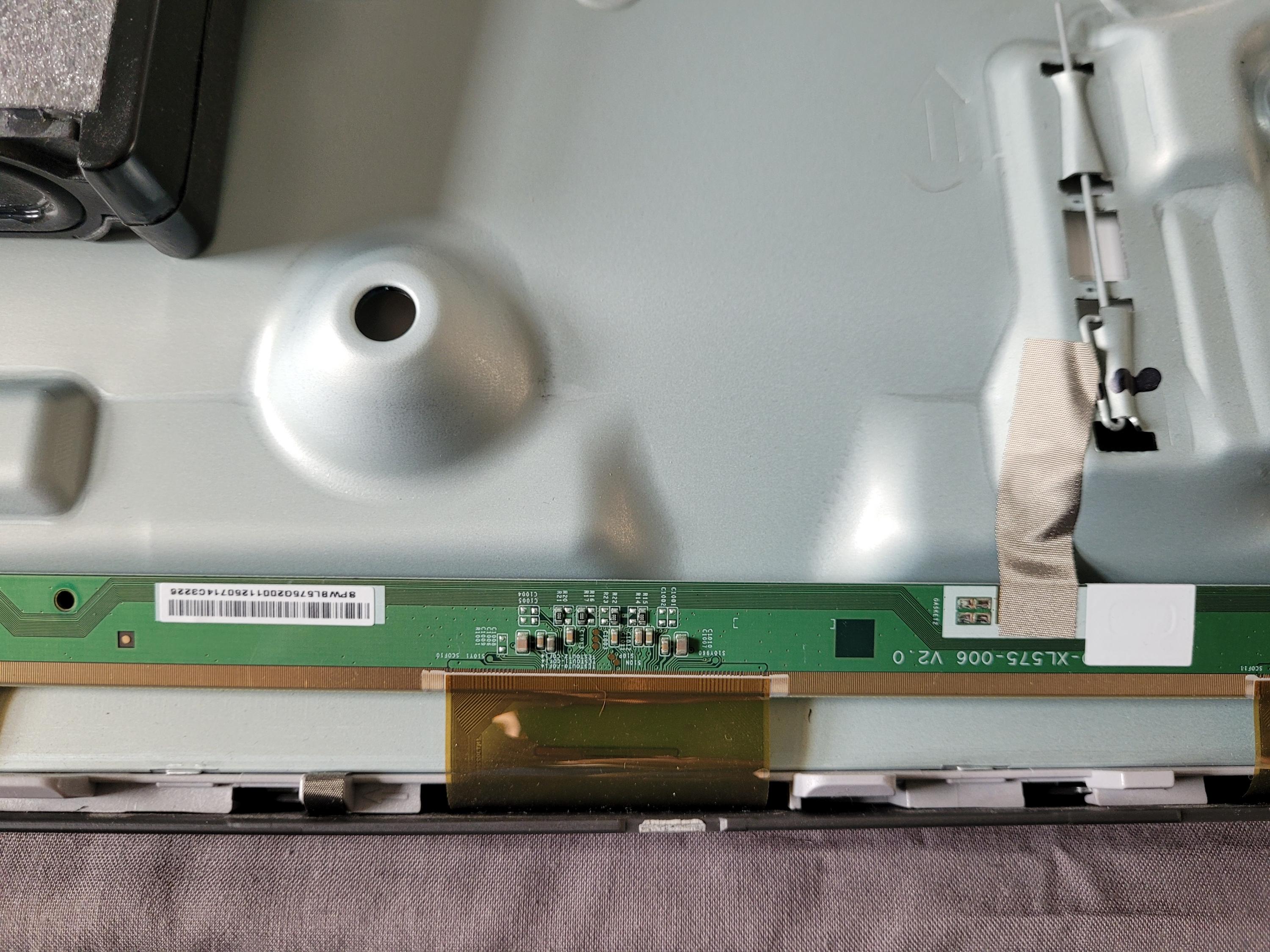

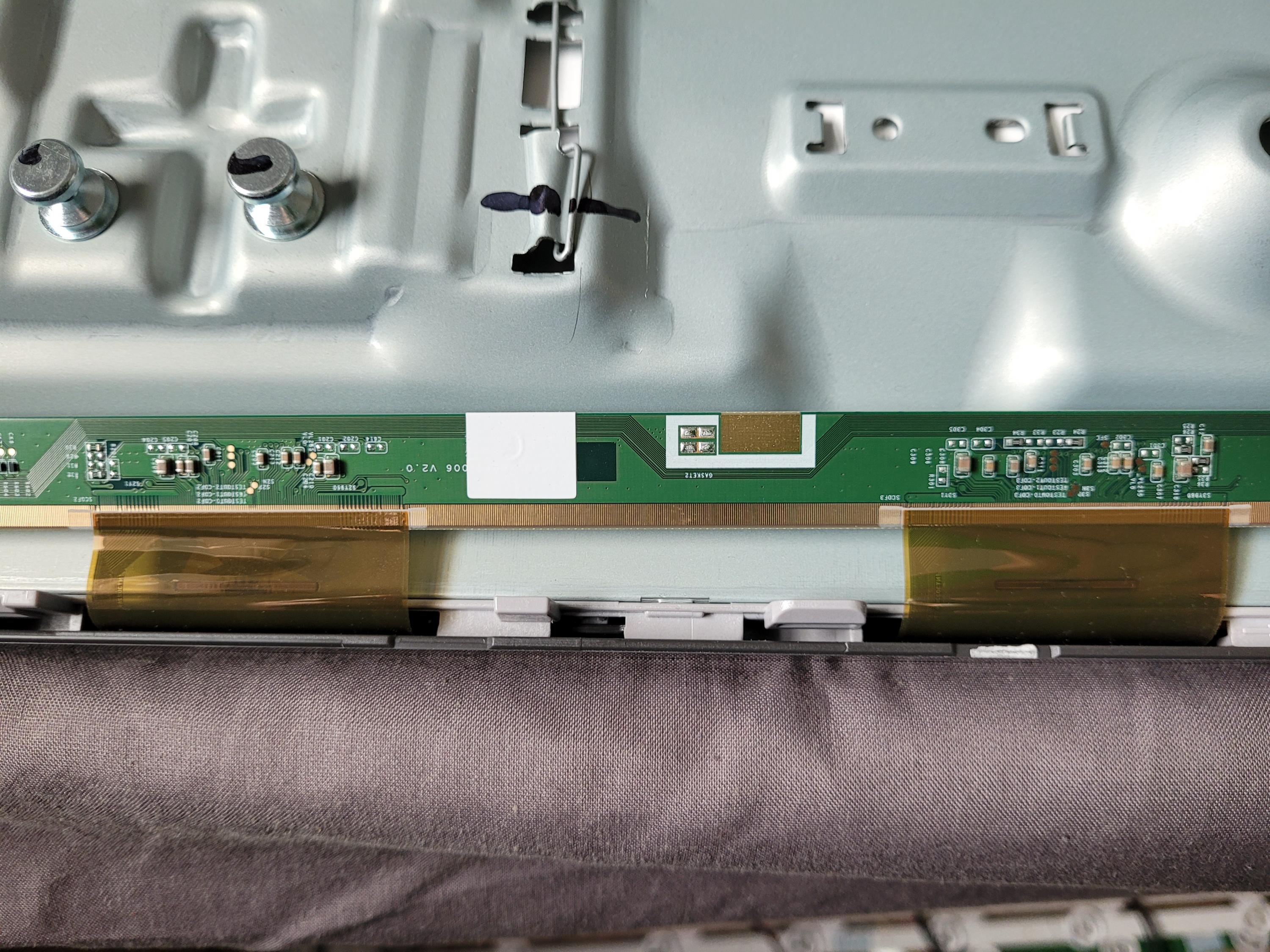

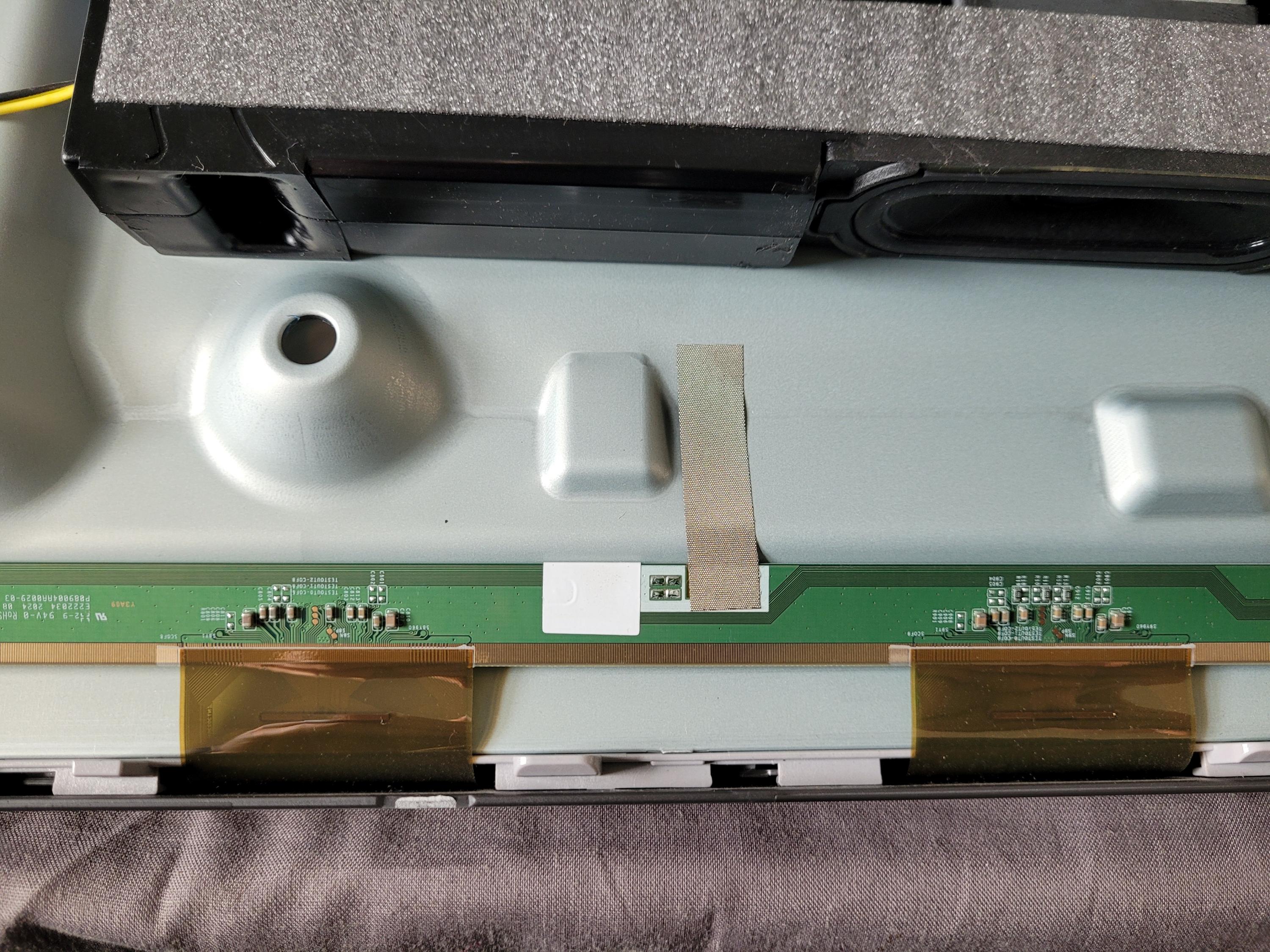

      so when you did U riboon test TV start with out blink.. and you can put it in STB via RC... !! please confirm,, if this was YES then you have issue an Panel VCC because no picture,, take out the speaker and upload high Res photo on both sides of the panel buffer boards,,, it could be there ceramic caps short or ESD diode short on the boards.
            Yes, when did ribbon test, it starts up but with no image, amd I am able to put it in standby with RC

                Re: Samsung UE58TU7100K Wont Turn On
                first check the SPI Flash pin 1 which it connected to ESD diode if there >=3.3V
                • Diah
                  • Feb 2013
                  • 6438
                  and on this area check all caps.. when you check caps panel should be disconnected from MB
                      Non in this area are showing resistance with panel disconnected from MB
                        do the same way to check all caps..
                        spi pin 1 are remarked with circle
                        • Bloopeta
                          • Jun 2018
                          • 526
                          • United Kingdom
                          #32
                          All caps checked, no resistance on any
                          Im sorry to be a pain, but I cannot see a circle anywhere? Lol
