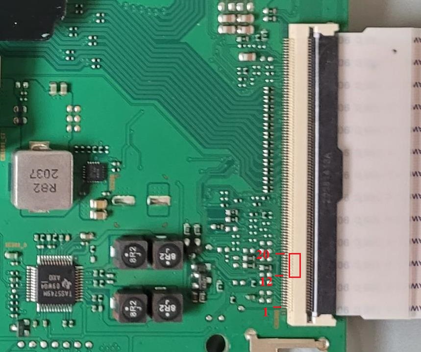

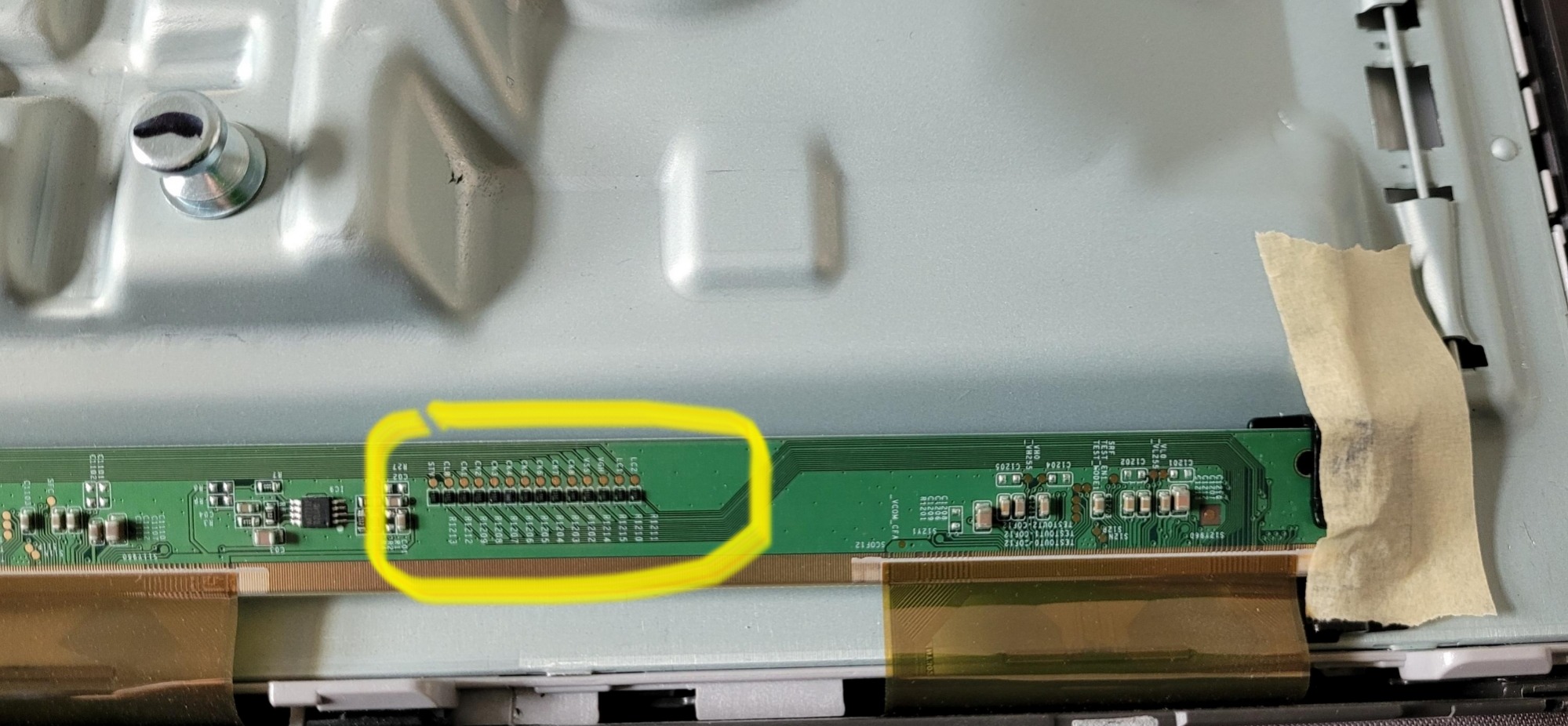

    No, probably main board is not the culprit, check in ohm these resistors in both sides:

                in case they refused .. try to give it another chance, put every things as original.. just mask pin 12 to 20. i am not sure 100% of the marking pin count.. but they are CKV which cut signal and turn off the set when panel had issue
                    Atm I need to wait, but if they refuse, I will try what you say, thankyou very much for your help so far
