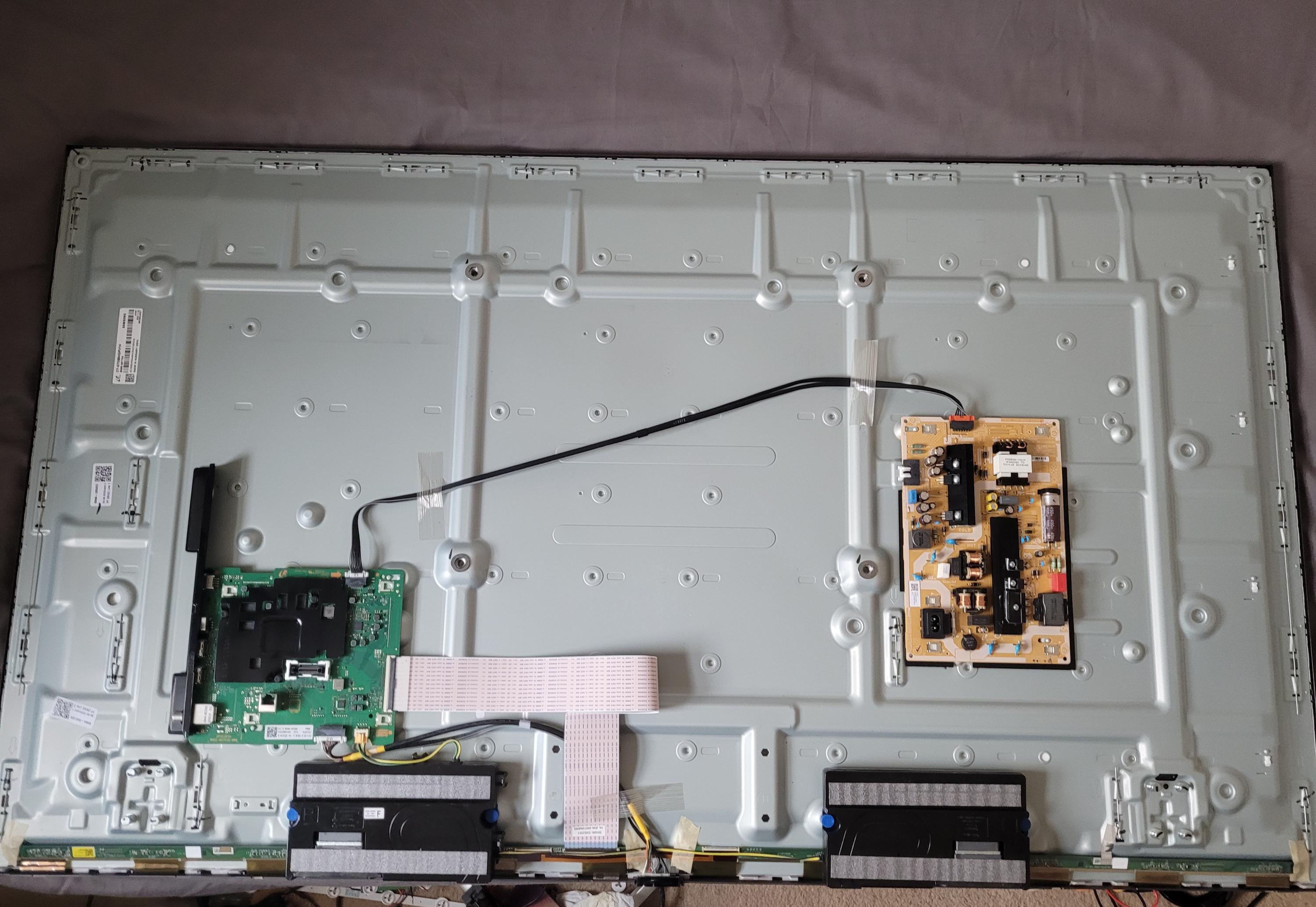

    Re: Samsung UE58TU7100K Wont Turn On
    Pics with back removed

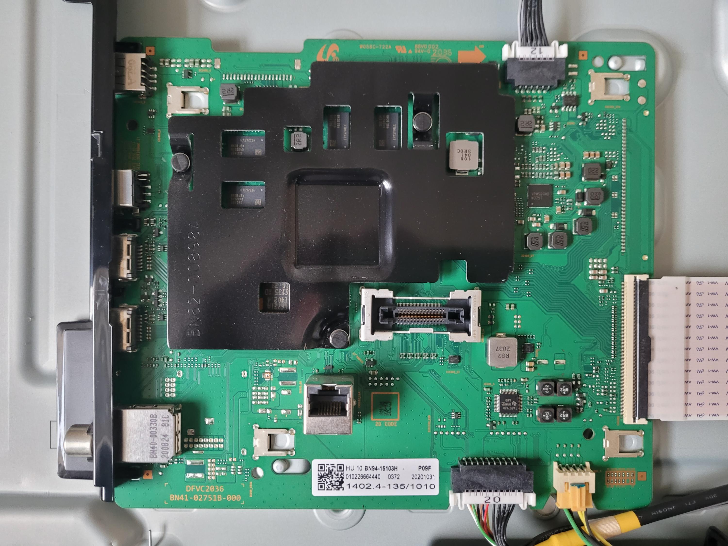

      If I unplug the main board, and plug the TV in, the screen illuminates and stays on, so would seem the backlights are ok.
      If I leave the mainboard plugged in, but inplug Tcon ribbon, the screen illuminates and stays on also
        unplug the U ribbon on the screen buffer boards from one side and turn on... it should u have half picture
          Unfortunately not, if I unplug either side one at a time, I get illumination from backlights, but nothing else

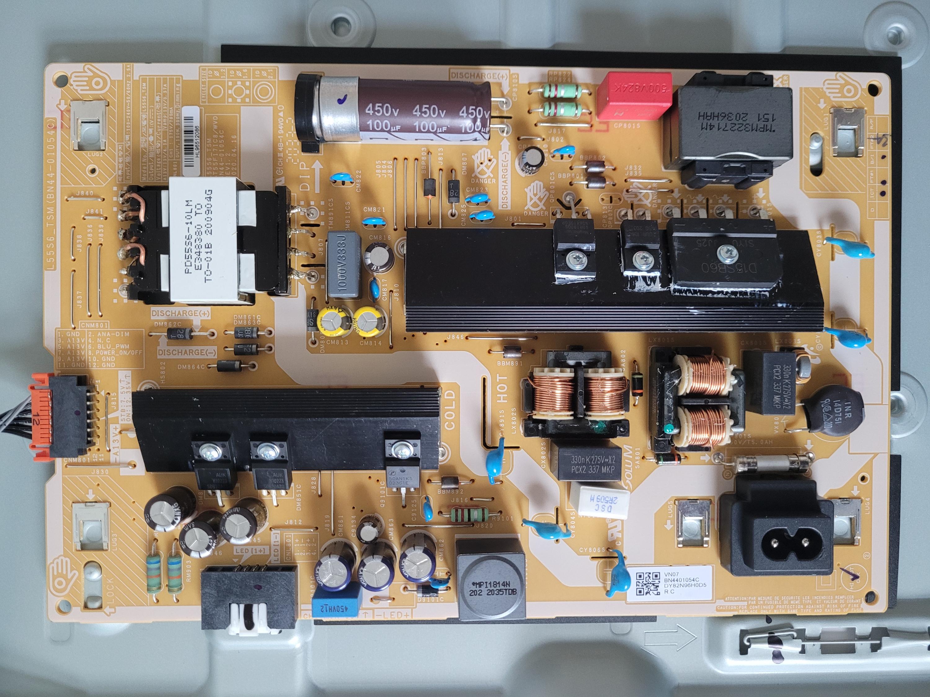

                    Hi, if i'm right 2 blinks is Power supply, try to test psb 13v output with board alone and dummy load like resistors or lamp, it could be a tension that seats under load..

                          test also the tension in standby, m.b. attached..

                            Hi, tested the 13v outputs with board alone and all are reading ok. Not sure how to dummy load?
                              Put a car lamp on 13v or another house lamp like halogen, about 30-50w
                                Still all test 13.4 with MB attached
                                  but is it in standby? because in standby must be 7,5v
                                  do the lamp test
                                    do the lamp test
                                    It wont go into standby. As soon as it is plugged in, it goes into the cycle of turning on and off. Pressing power button both on set, and remote control does nothing.
