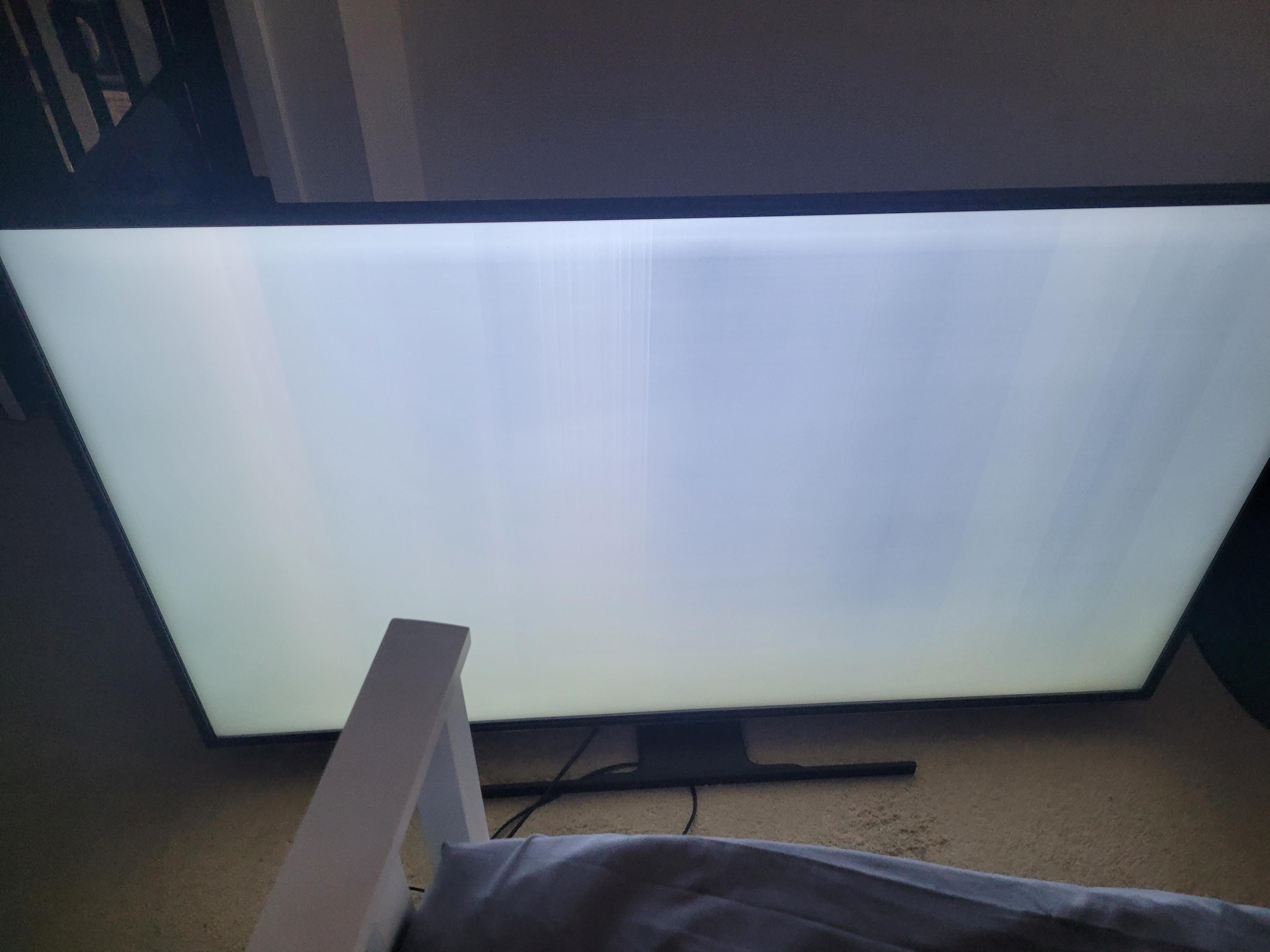

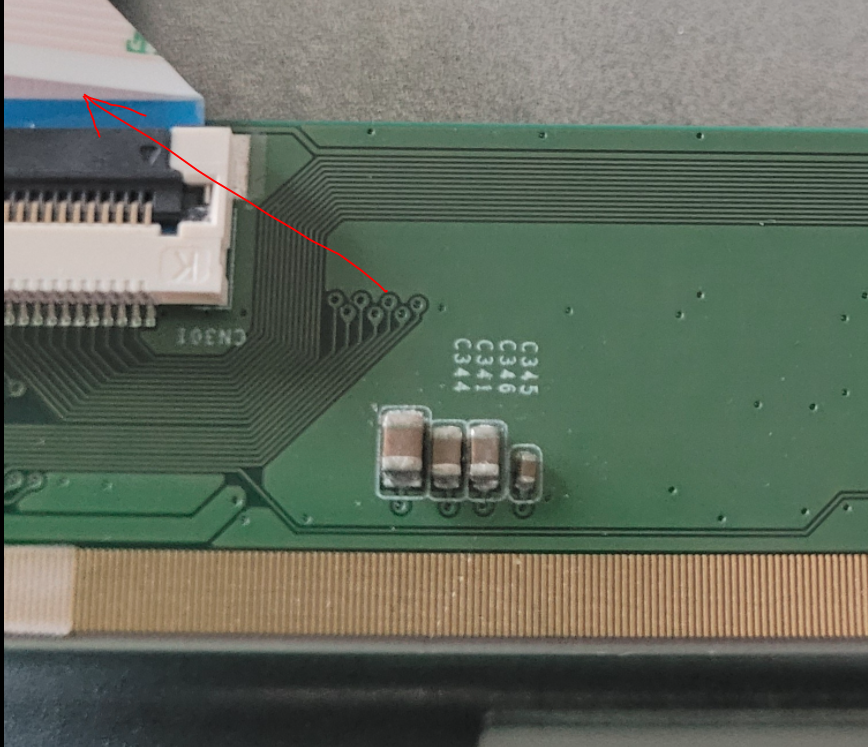

    Have a Hitachi 58HK6100U
    TV turns on, and sound is still heard, but no image, just blank white screen, with vertical lines.
    Im guessing either Tcon or Panel? Is there any known issues with these? Is there any tests I can perform to determine if its the Tcon? Or is it just a case of replace it and see?
    Any help grately appreciated.
  • Bloopeta
    • Jun 2018
    • 526
    • United Kingdom
    Re: Hitachi 58HK6100U LED TV - Sound but No Picture

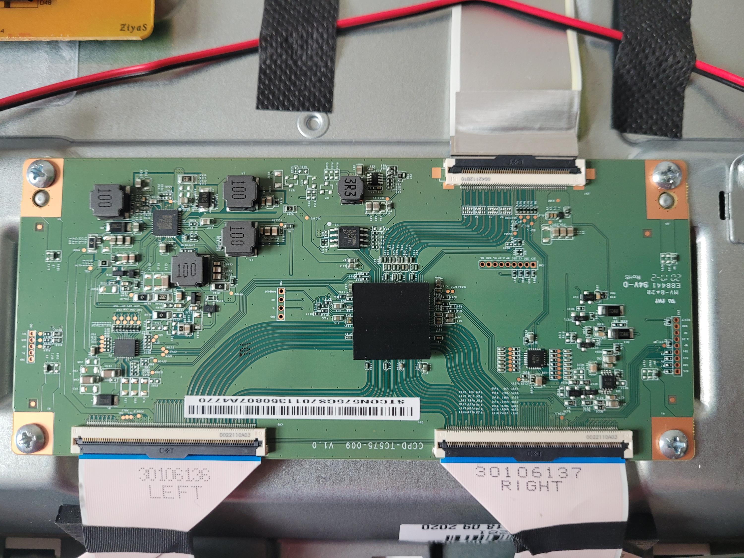

    Have also tried unplugging left cable on Tcon, half the screen went blank, and other half still displayed the white picture with vertical lines, same as before.
    Unplugged the right cable, and half screen goes blank, but the other half displays the image correctly as a working TV would
      No doubt a panel problem. Short on panel?
          Maybe just a bad cap on bad side of panel board.

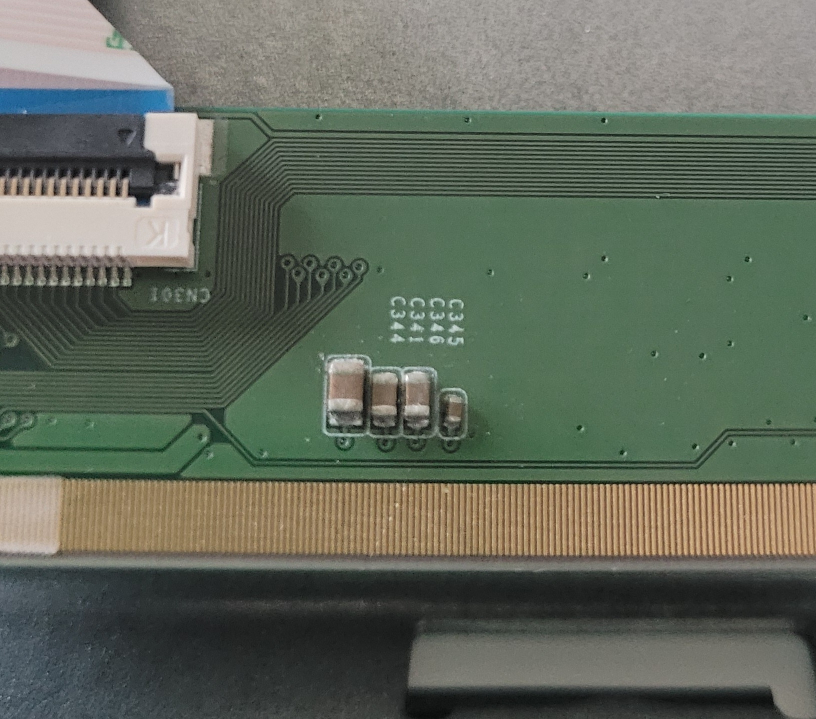

            Am I right in thinking, that if I check all the caps with DMM set to Ohms, and they all show readings consistent with others, and stabalise on a number they are fine?
            And if I get 1, where the reading just gets higher and higher, with no sign of stopping, that one is bad?
            C346 being the one in question
              And how do I know what capacitor I need to replace C346? I cant see anything written on it? I have never had to replace a capacitor like it before, i have only had experience with the larger cylindrical type, with the numbers are clearly written on the side.
                They usually fail short, occasionally open.

                  Im pretty sure its the one Ive mentioned, but Ive no idea what the numbers are for it to purchase a replacement 🤣
                    First remove it and see if that fixes the problem.
                      You can run without this capacitor, it does not play a big role.
                            So, I have removed it, and fault still exists.
                            Also If I use DMM on the board, with cap removed, but where it was positioned, I get the same outcome of reading just going up and up
                              Disconnect the cable first, then measure the resistance on the ceramic capacitors in the faulty panel bar.
                                With the cable unplugged, Im mainly getting no readings on most???
                                What should I be looking for? If I set DMM to 20k Ohms
                                • lotas
                                  • Jan 2016
                                  • 4874
                                  • Russia
                                  You must find a capacitor that has a very low resistance (a few ohms), if the multimeter has a continuity, then the multimeter will beep on a faulty capacitor.
                                    None beep if I touch both ends of caps on continuity setting.
                                    However, with one MM probe to earth, and checking caps, they all beep except this one in pic C449. I also cannot get a reading set at 2k ohms
                                      Basically, these are shunt capacitors for powering the matrix and one output will always be on ground.
                                        Ah I see, so that is fine then
                                        Any more suggestions as to what it would be and what I can try?
