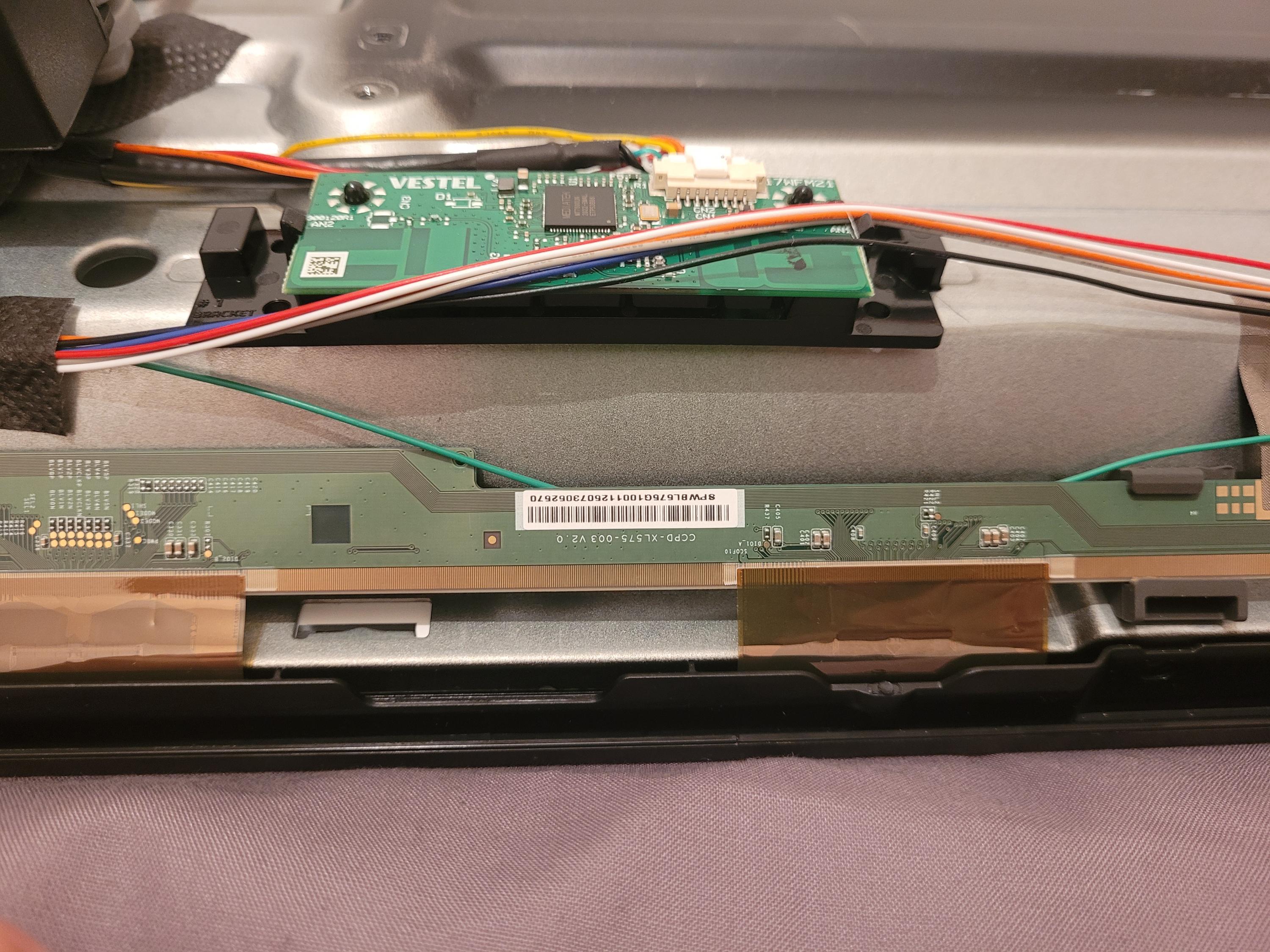

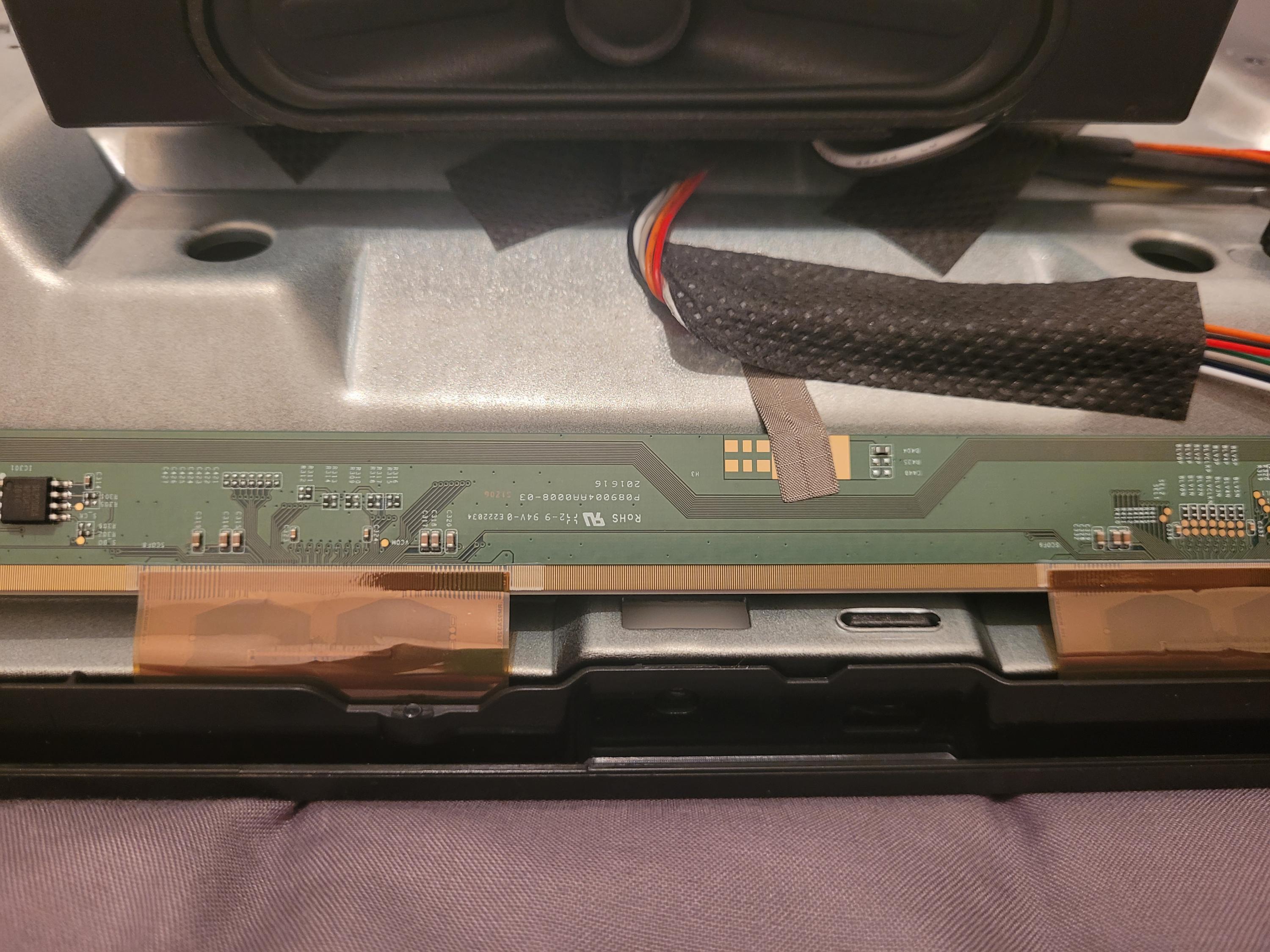

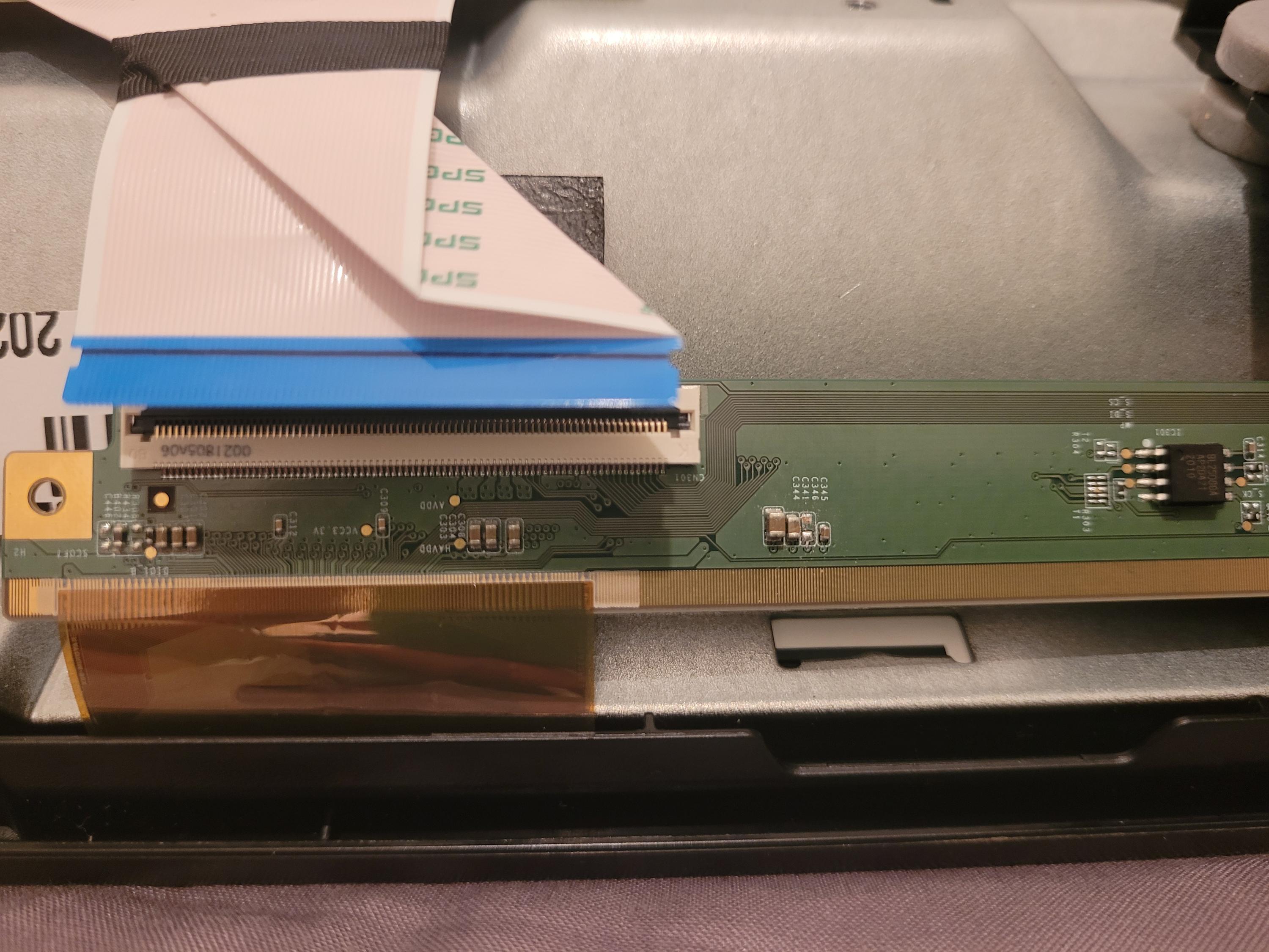

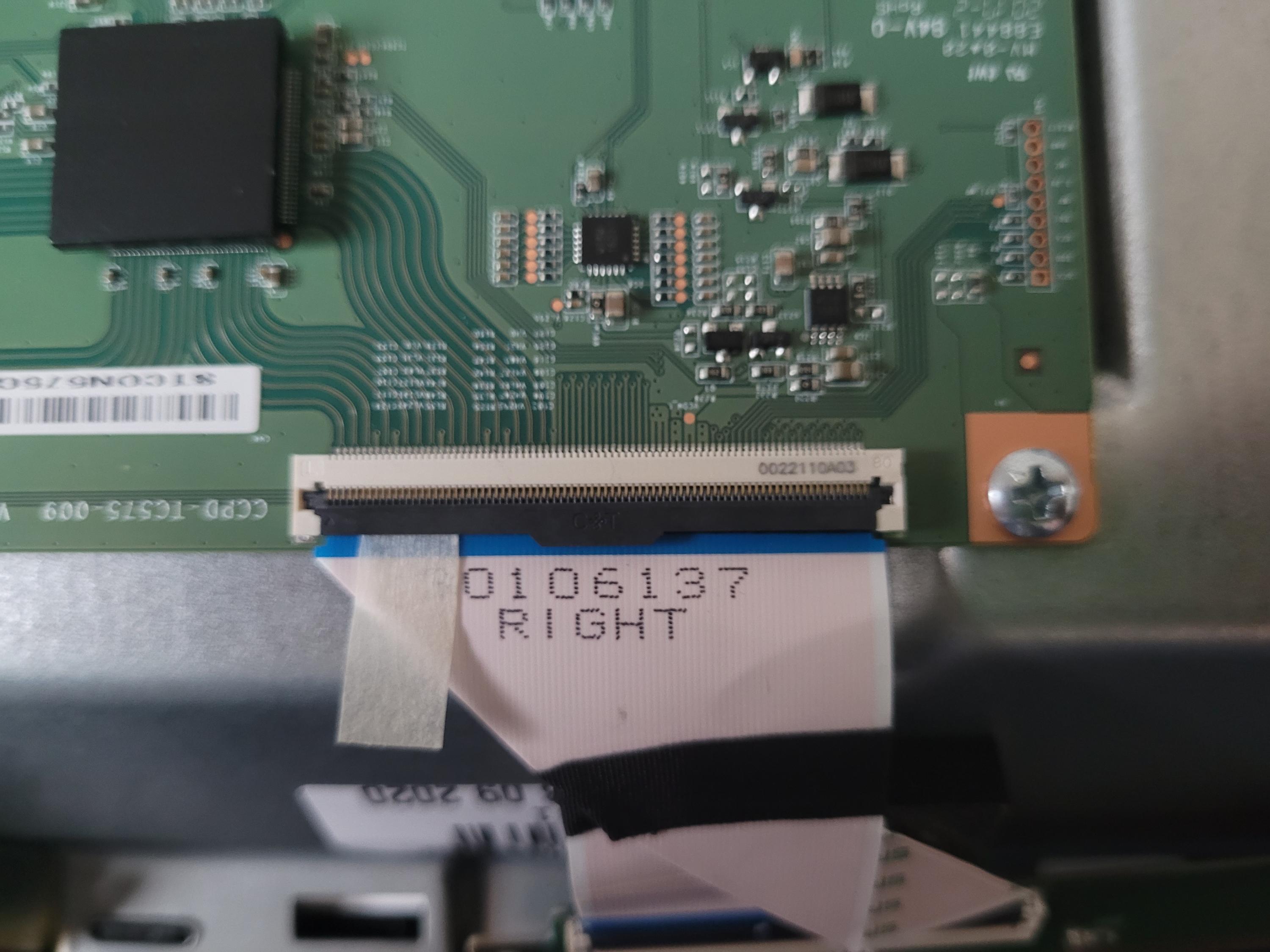

    Take good photos of this non-working plank so you can see what's on it.
    • Bloopeta
      • Jun 2018
      • 526
      • United Kingdom

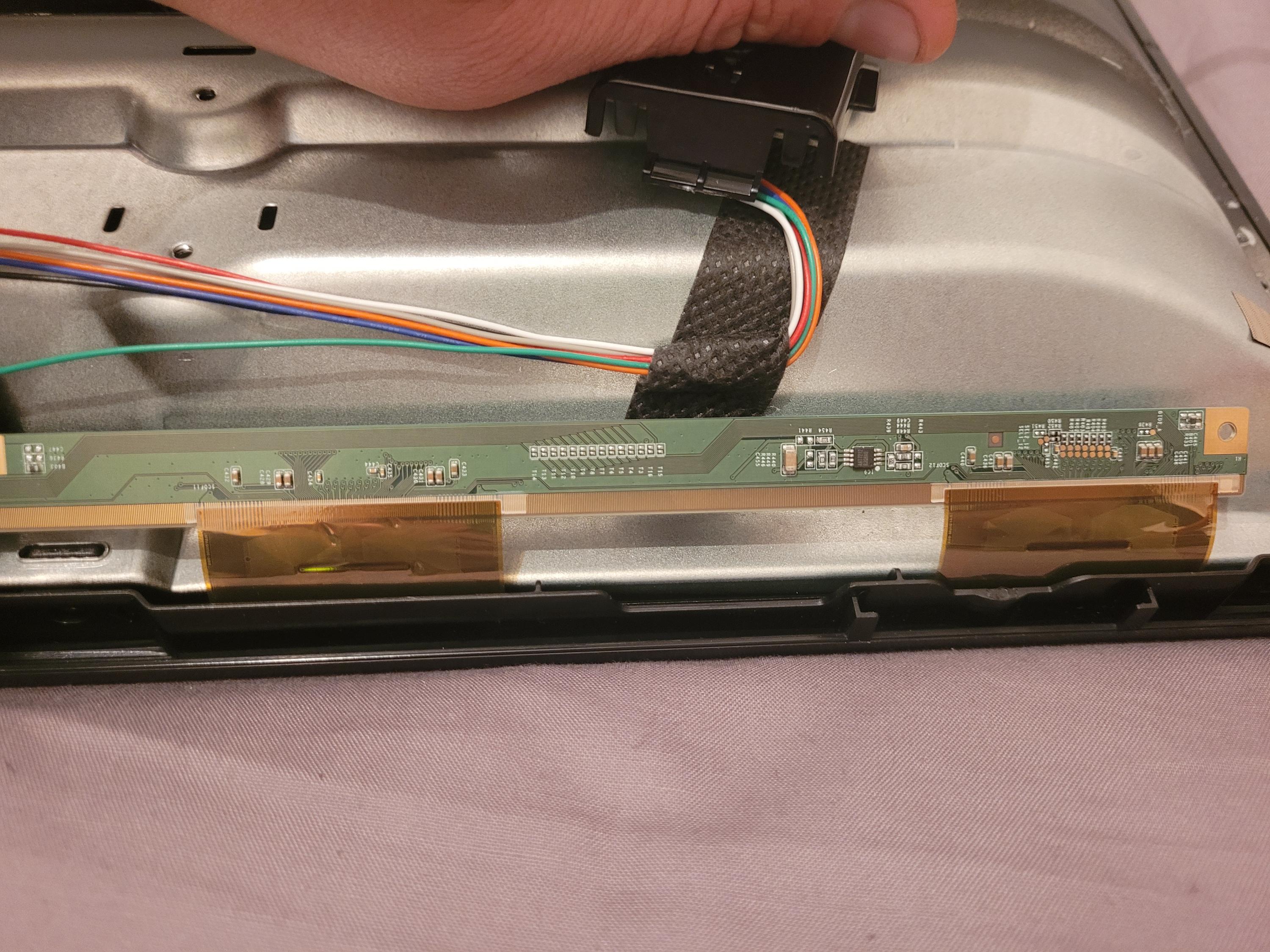

      Re: Hitachi 58HK6100U LED TV - Sound but No Picture
      Pics as requested

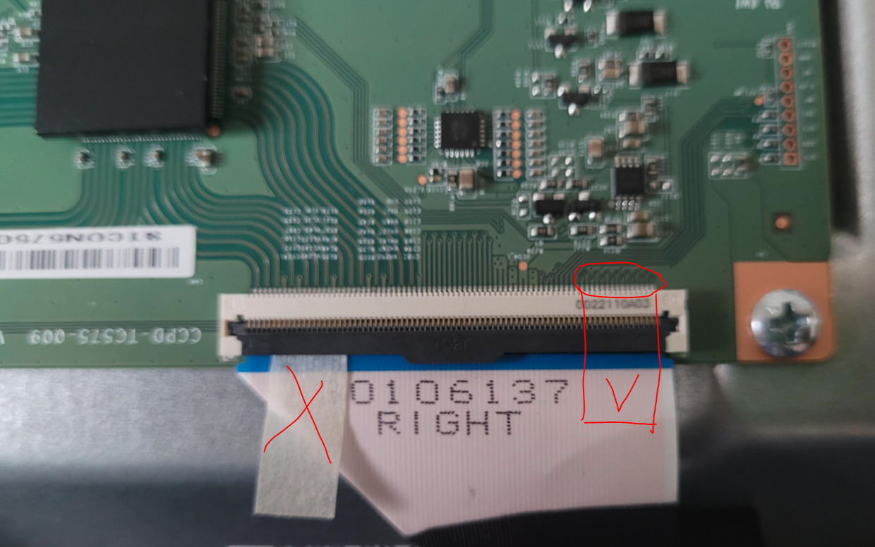

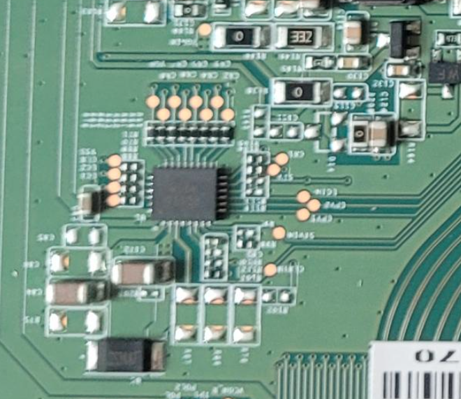

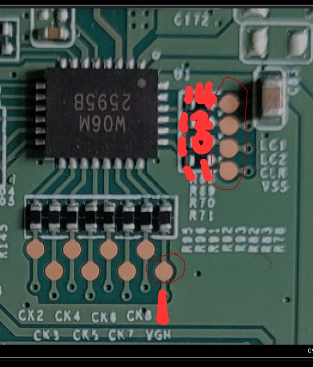

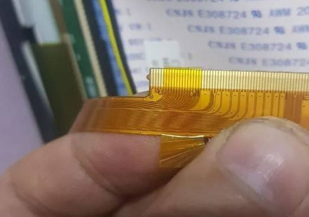

        Try to isolate these pins (CKV...) on the cable with tape.
        • lotas
          • Jan 2016
          • 4749
          • Russia

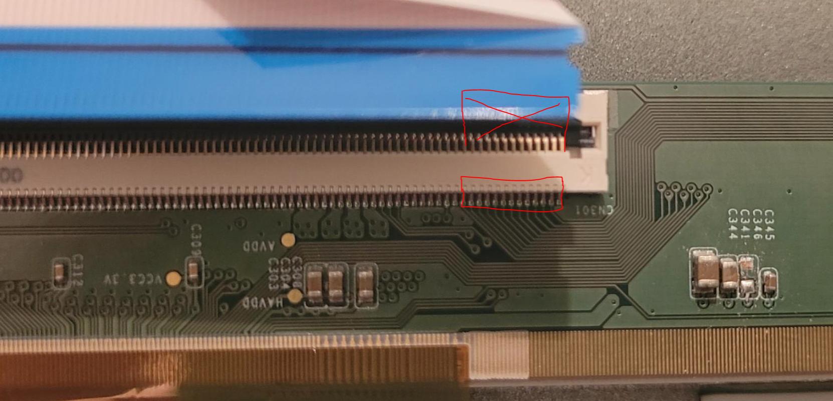

          For example, as in the photo.

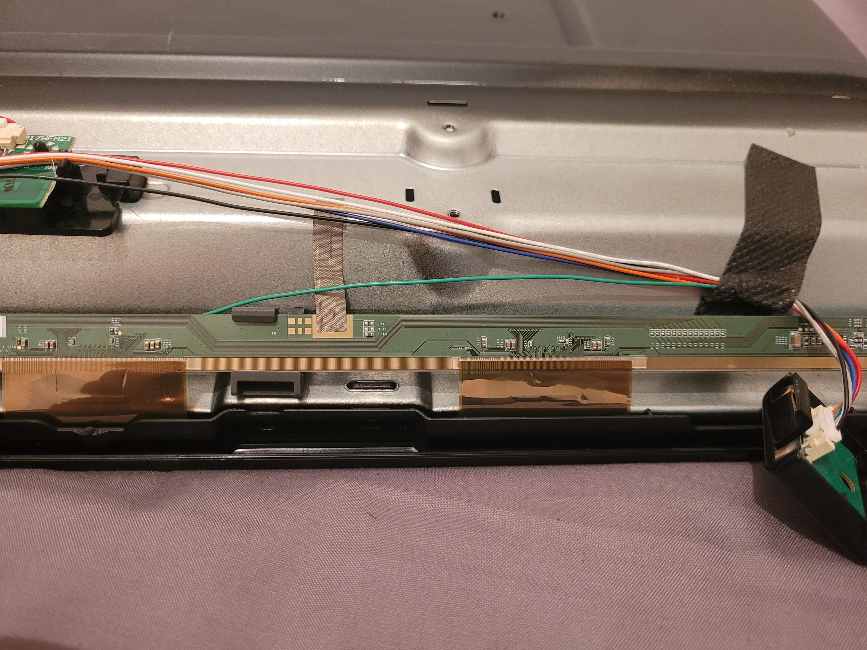

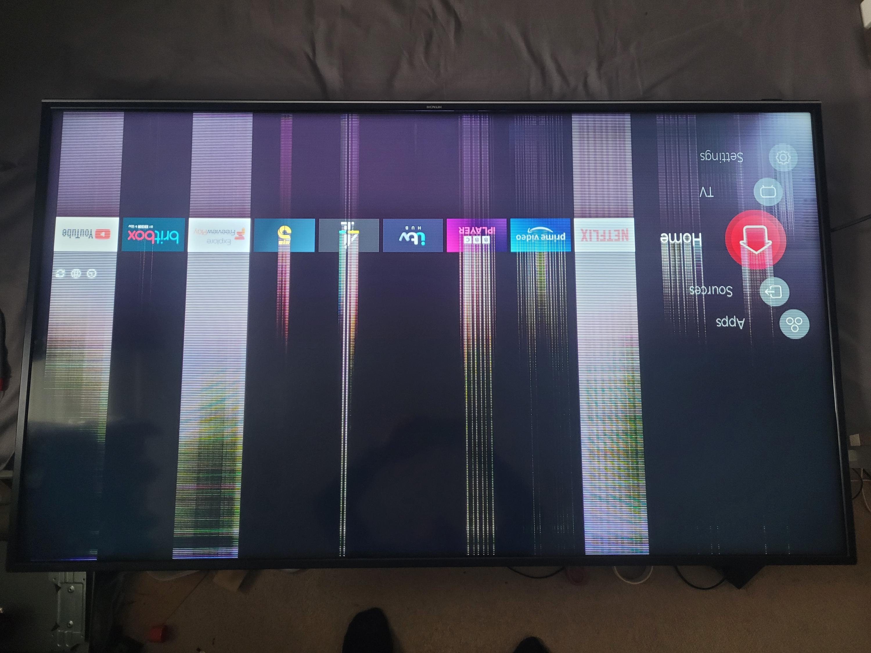

            Have tried that, pics attached.
            • lotas
              • Jan 2016
              • 4749
              • Russia
              They glued something wrong, the second photo is about how to glue it, but you need to glue (isolate) these contacts.
              • Bloopeta
                • Jun 2018
                • 526
                • United Kingdom
                Ah I see, I worked from the left, not the right lol
                Ill try again ��
                • lotas
                  • Jan 2016
                  • 4749
                  • Russia
                  13 pin.
                      Its better than it was, but still not quite there
                      • lotas
                        • Jan 2016
                        • 4749
                        • Russia
                        #31
                        Here it is necessary to experiment with these contacts, try both 14 and 15, 16, also try to isolate them in turn ...
                        This microcircuit is responsible for these signals, and you have damaged drivers on the one hand, which must be isolated.

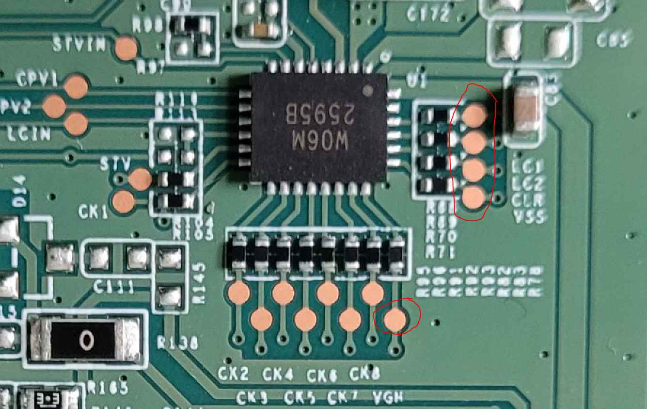

                            #33

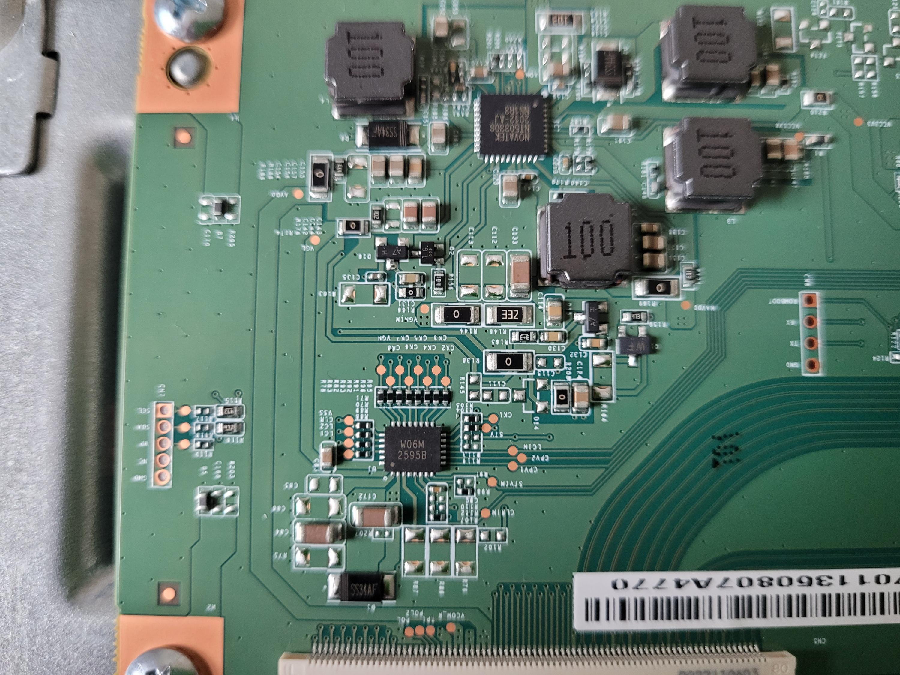

                            Take a good quality photo of this chip so that you can read the control points near it.

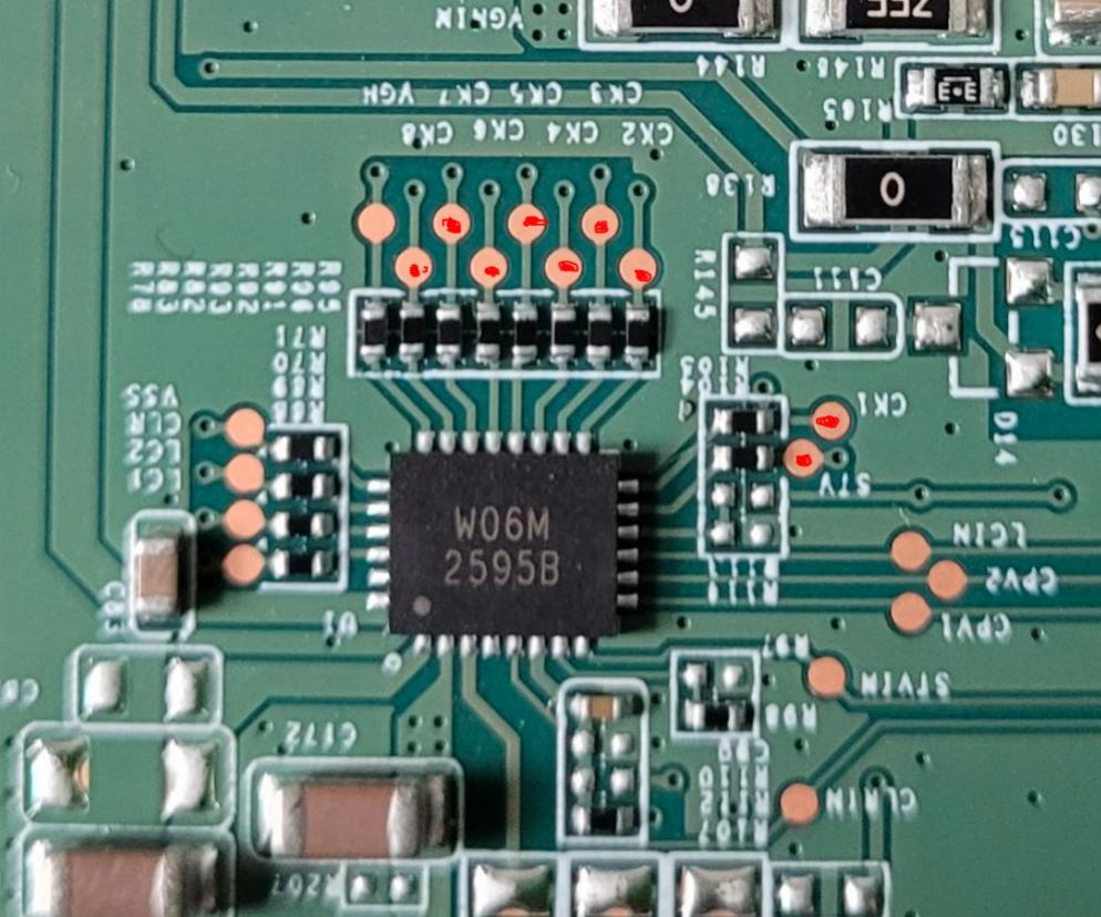

                            • Bloopeta
                              • Jun 2018
                              • 526
                              • United Kingdom
                              #34
                              Pic as requested
                              • lotas
                                • Jan 2016
                                • 4749
                                • Russia
                                #35

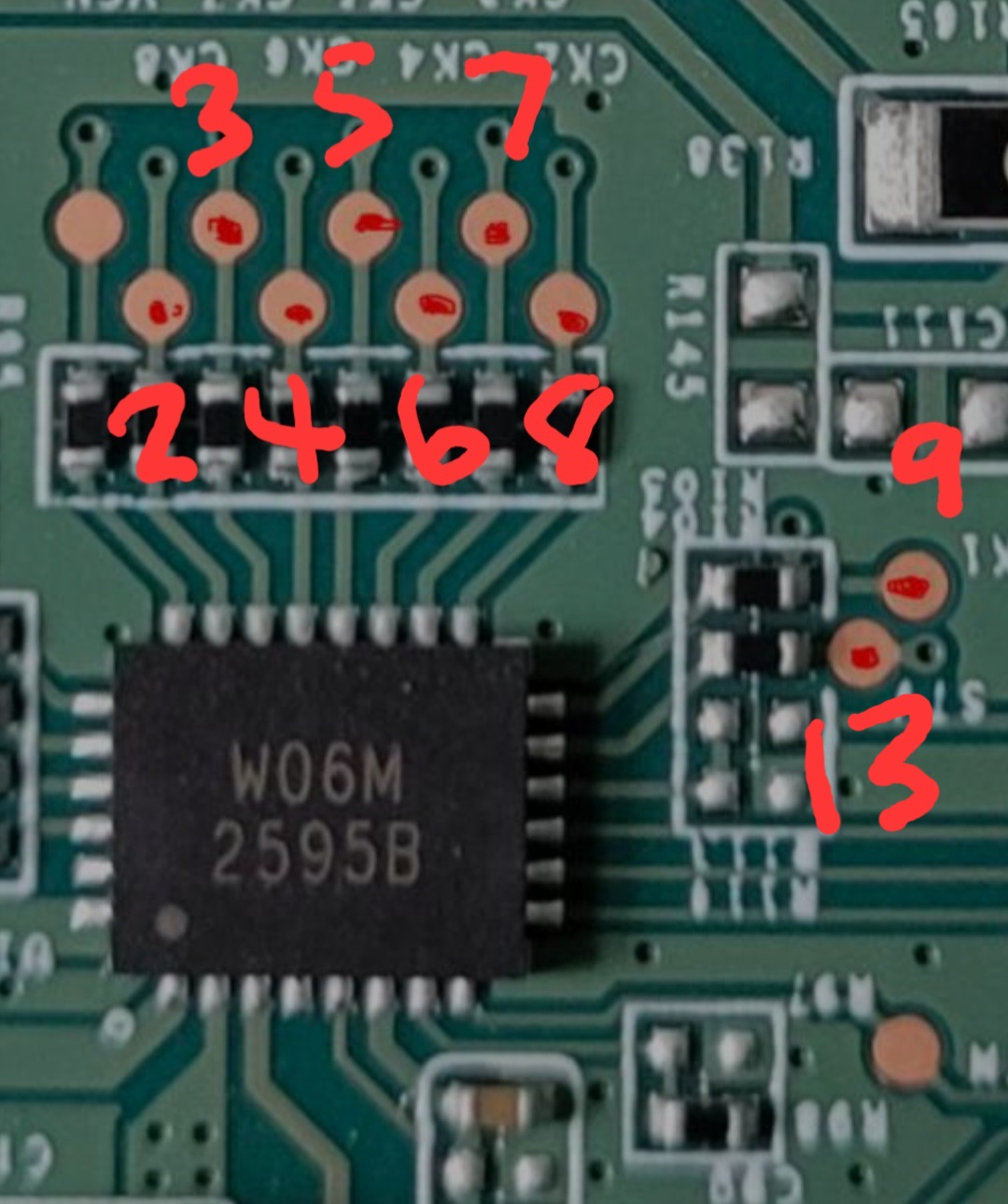

                                First you need to isolate these 9 contacts, these contacts go to the bar, you can check with a multimeter where they go (which pins of the connector.
                                • Bloopeta
                                  • Jun 2018
                                  • 526
                                  • United Kingdom
                                  #36
                                  I have tested with multimeter, and have wrote the pin numbers where you have marked on the picture
                                  So do I cover these numbers on cable with tape?
                                  • lotas
                                    • Jan 2016
                                    • 4749
                                    • Russia
                                    #37
                                    Yes, try.
                                    And what contacts do these points go to.
                                    • Bloopeta
                                      • Jun 2018
                                      • 526
                                      • United Kingdom

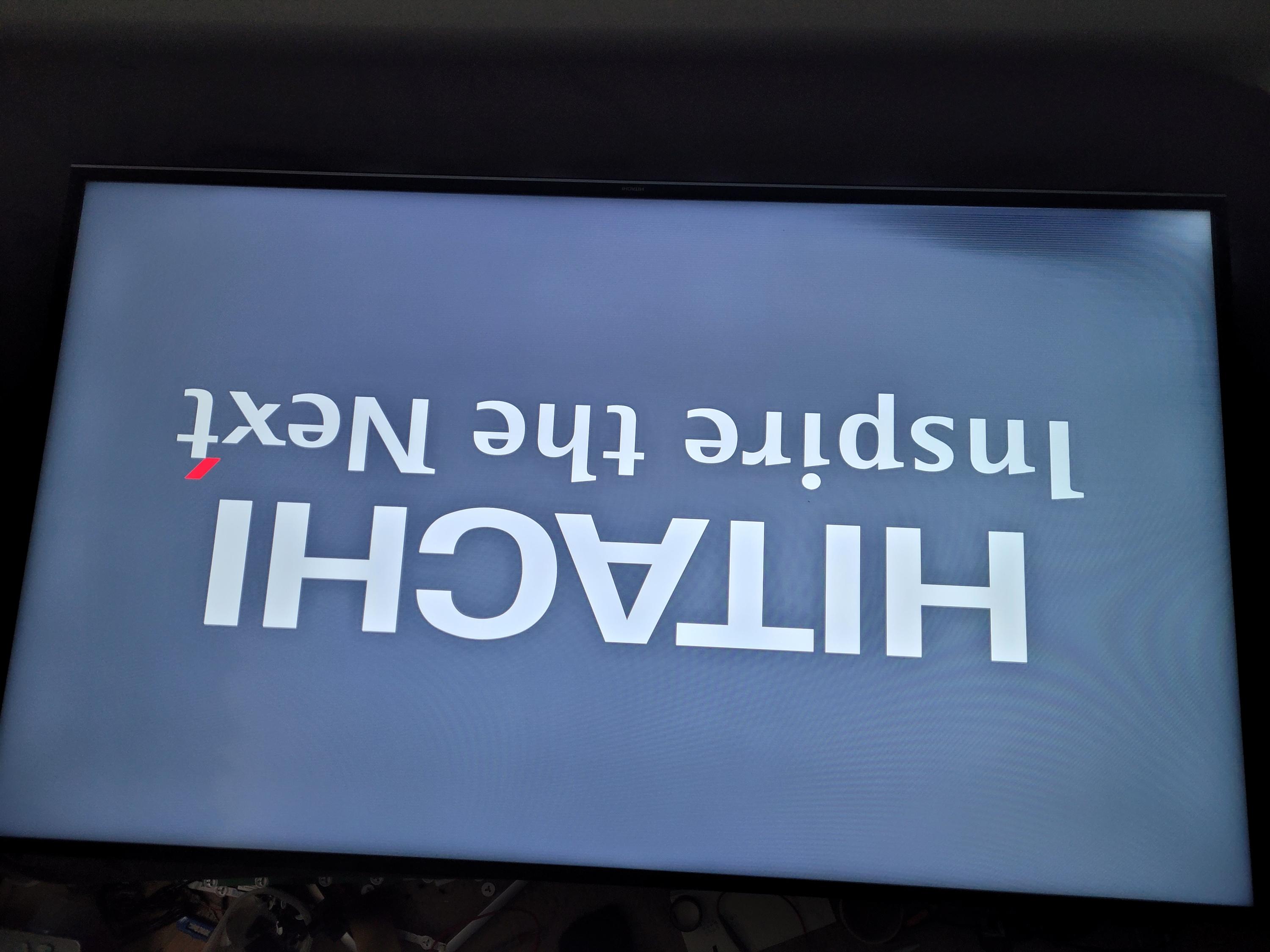

                                      #38
                                      Here are the numbers for the pic you sent
                                      I have covered from 2 to 19, and have picture, although a bit grainy, but no vertcal lines this time
                                      • lotas
                                        • Jan 2016
                                        • 4749
                                        • Russia
                                        #39
                                        Until 19, this is a lot you have glued, from 2 to 9 (inclusive) and up to 14 (inclusive) try
                                        1 does not need to be isolated, this is VGH, you need it.
                                        In general, you need to experiment with these contacts, you can achieve a normal picture if you're lucky.
                                        • Bloopeta
                                          • Jun 2018
                                          • 526
                                          • United Kingdom

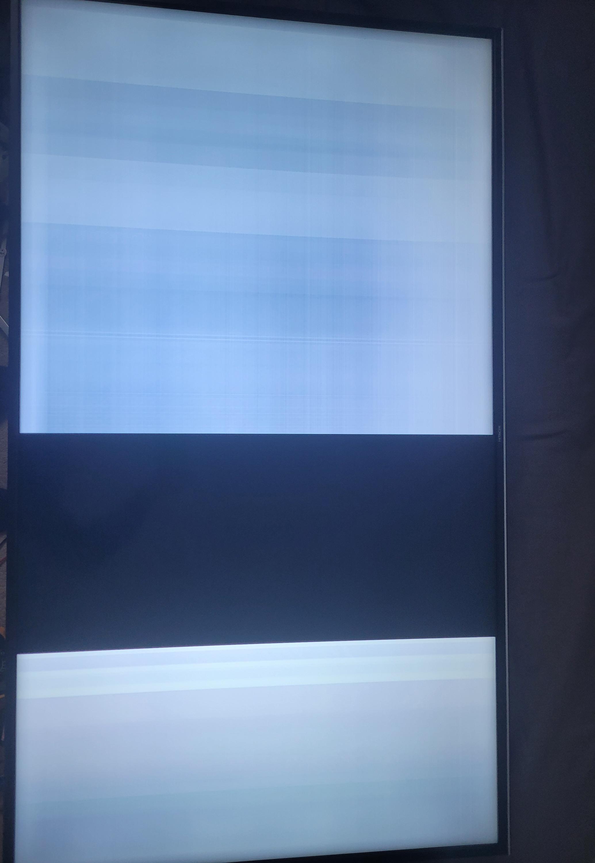

                                          #40
                                          From 2 to 9 inclusive, lost picture again, white screen with vertical lines
                                          From 2 to 14 inclusive, I get picture, but with aot of thin black horizontal lines, and a weird patch in bottom left corner
                                          • iglitare
