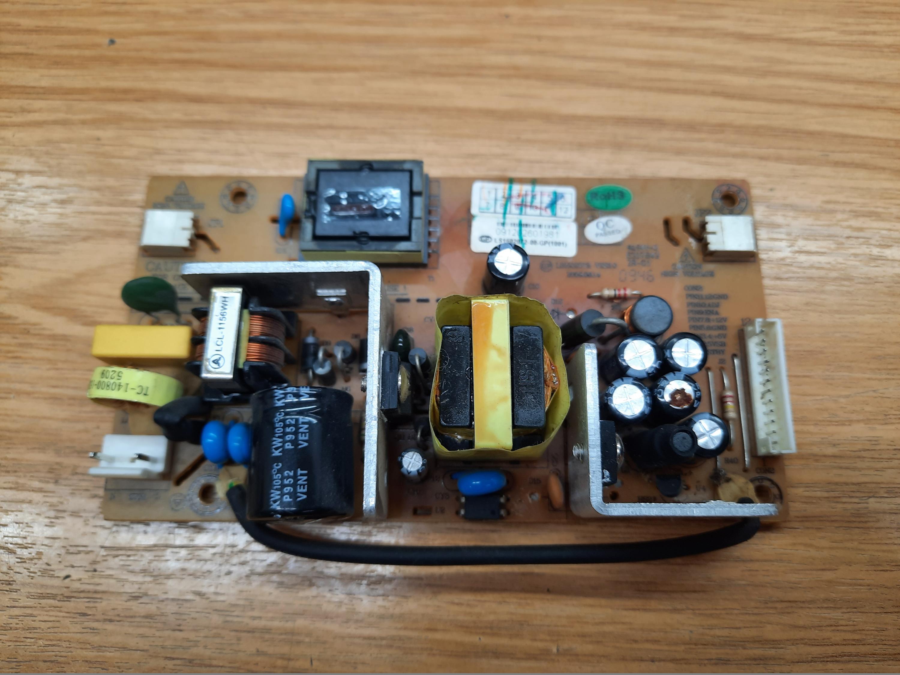

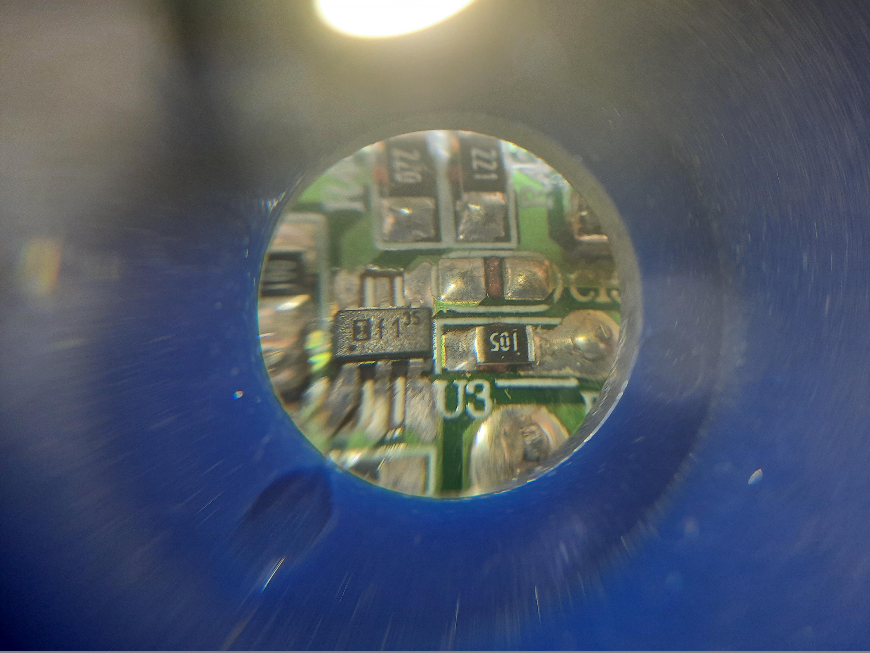

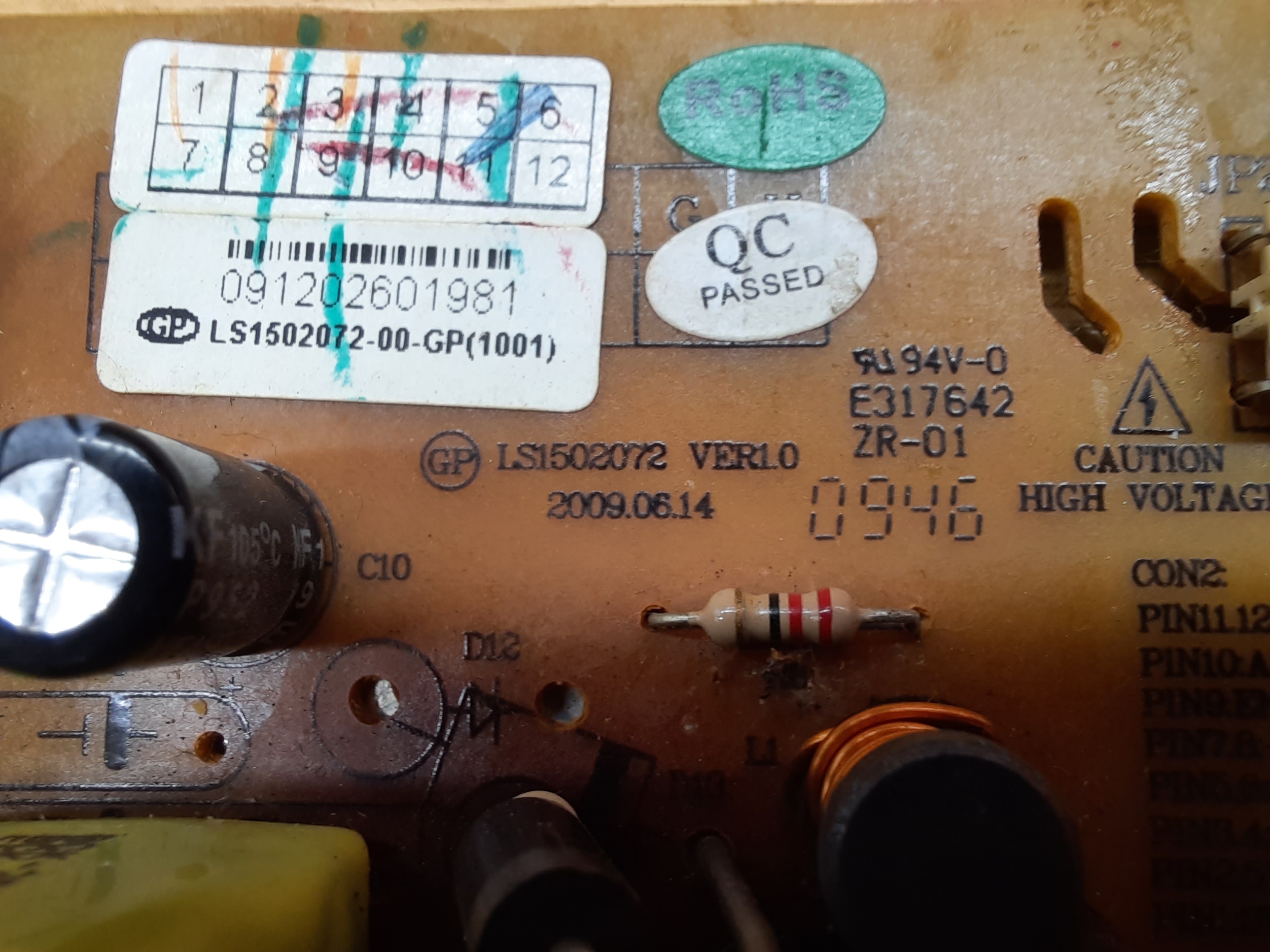

    Hi all
    Have been here before but ended up replacing PSU .
    This time doesn't seem to be one available .
    Require type for the 6 legged device U3
    Can anyone help ( see pictures )

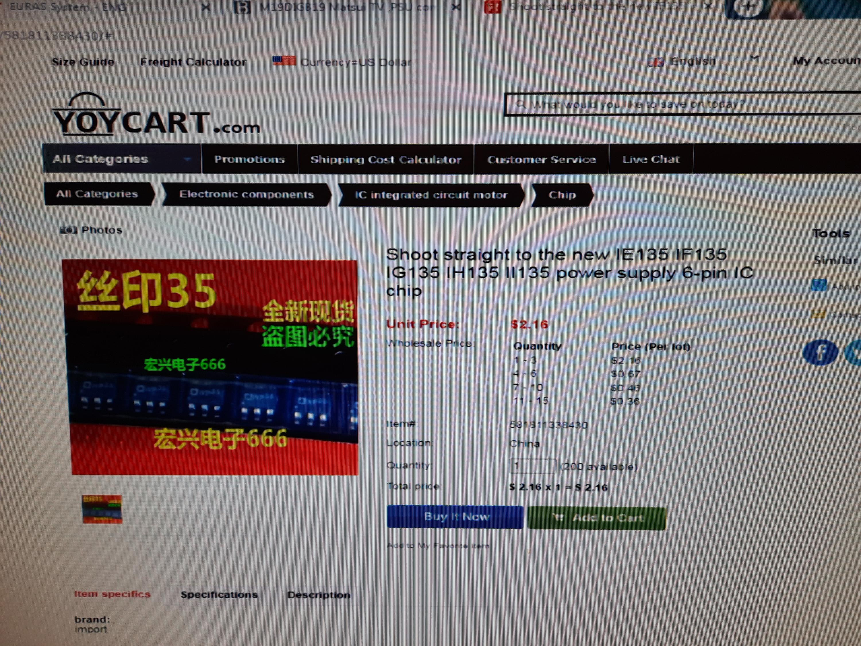

    Re: M19DIGB19 Matsui TV ,PSU component ID help please
    Gotcha , anyone ordered from yocart.com before ?
      Ld7535abl
        Take a look at the electrolytic capacitors, they are all defective and one has even leaked
          Thanks Lotas
          Hi Repdata , yes will check through them also
