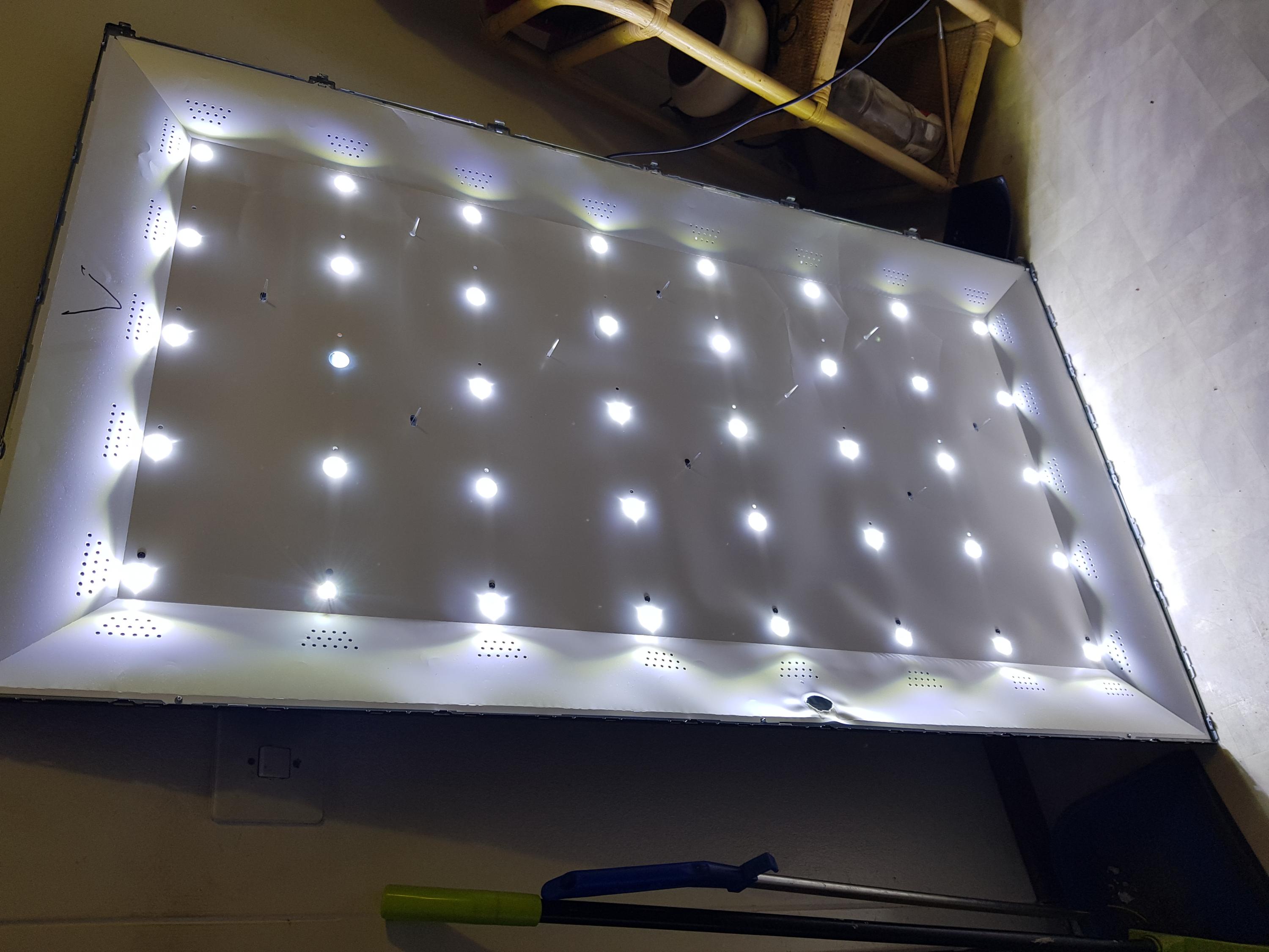

      Thank you very much for the answer, it is backlight but there is something else with the cold side of power supply or rather something with backlight driver for which I need help

          Now all the LEDs are lit.it is the first LED in the second row in the upper part from the V sign that was broken I changed it but I need to know what glue to use on the candle hat so that it does not fall with the heat
          if anyone who can give tips very grateful

            Well you don't want to use superglue[Cyanoacrylate] because of the potential for lens clouding. There's some examples of the glue they sell for the job, can probably find some like it closer to home than china tho, and you MUST make sure the lens is oriented correctly, if any of that has cyanoacrylate probably best to skip that product, you can find many choices on ebay also: https://www.aliexpress.com/w/wholesa...lens-glue.html

              thank you very much i have found something at home now this tv is basically ready have to get a remote control for it but it is an odd brand so it will not be easy maybe a universal

                Hi Everyone who helped me with this repair the TV is fixed it was backlight problem that got fixed: it was just one broken led in a strip and I have only replaced it instead of a new kit because this tv is very odd brand and it is not worth spending much money on it but I must say that it has a really nice picture.
