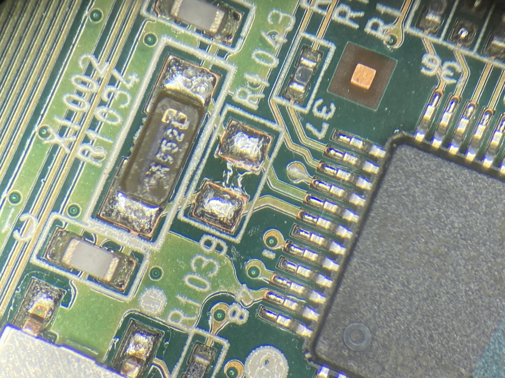

                    I check it and no voltage is goint to tcom board. So i guess the MB is dead. I check under microscope whole board and no shorts or visible damage. I found this component and i do not know what is it?
                    Label A952 (X1002 on board)

                      well it's not totally dead, it's sending some signals but not inv on-off to the powerboard but it could be partially dead, ever since I fixed my sony that was took out by lightning with a firmware update, I never rule out that a firmware update might do the trick but I don't know, the lightning may have just killed part of the board, but if all that is too hard to do, then a replacement mainboard should bring it back to life and may be the simplest solution.

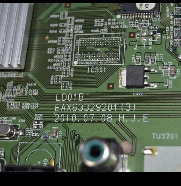

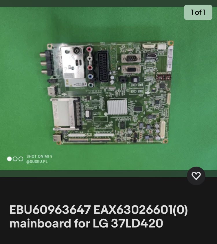

                              Hey i found a board on ebay but the seller say that the board is from model: 37LD420
                              The board have the same code on it (attachment). Only EBU number is different but EAX number is the same. Will this work on my 42LD420?

                                    #37
                                    Re: LG 42LD420 no power
                                    No, it was this one from ebay
