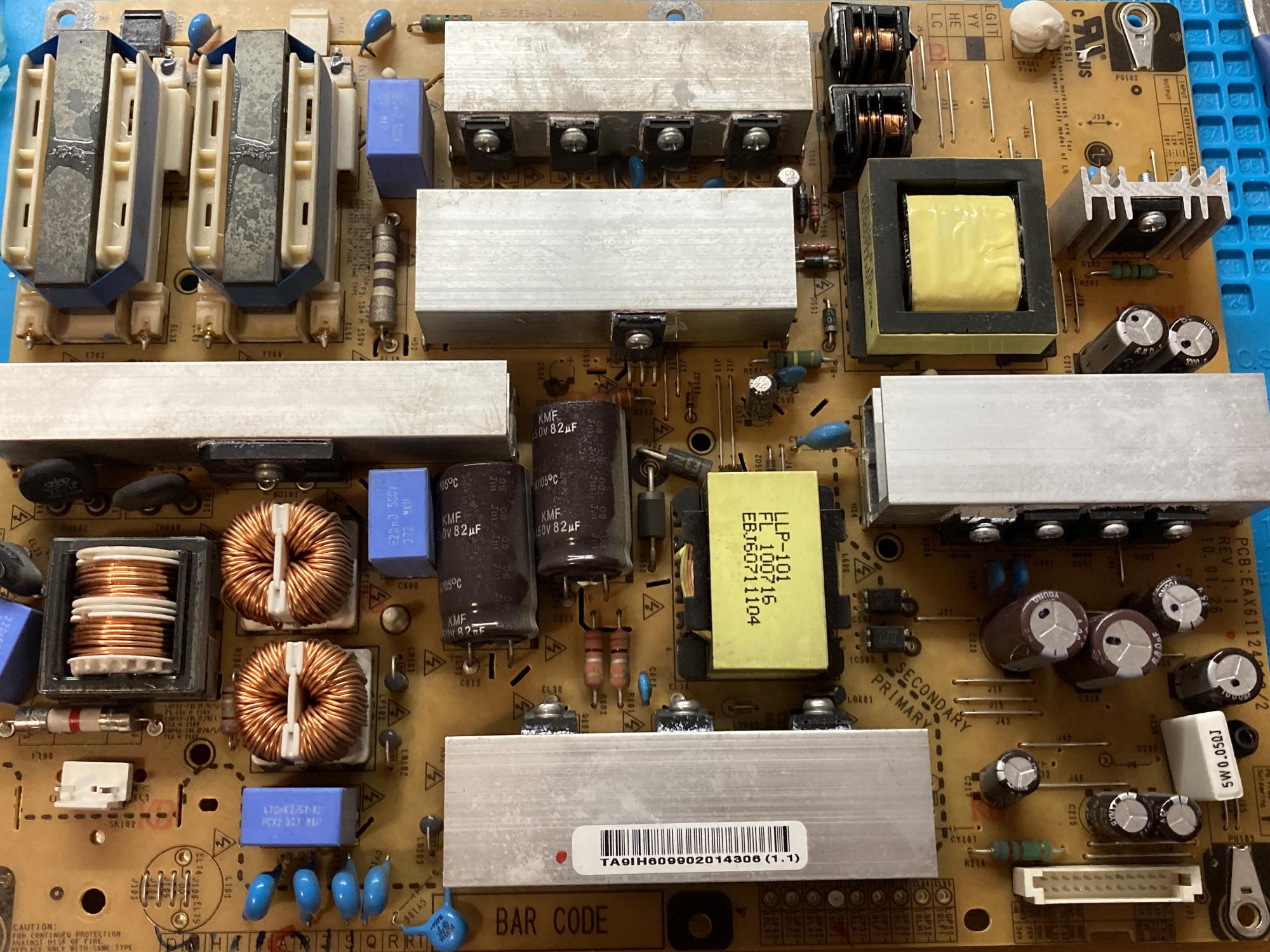

    Hello, a friend sends me this LG TV that has been thunderstrike. When plugged in TV show red light and on the power press button TV show a blue LED. I have 3.3V and 20V lines coming to the main board but no picture on the TV.

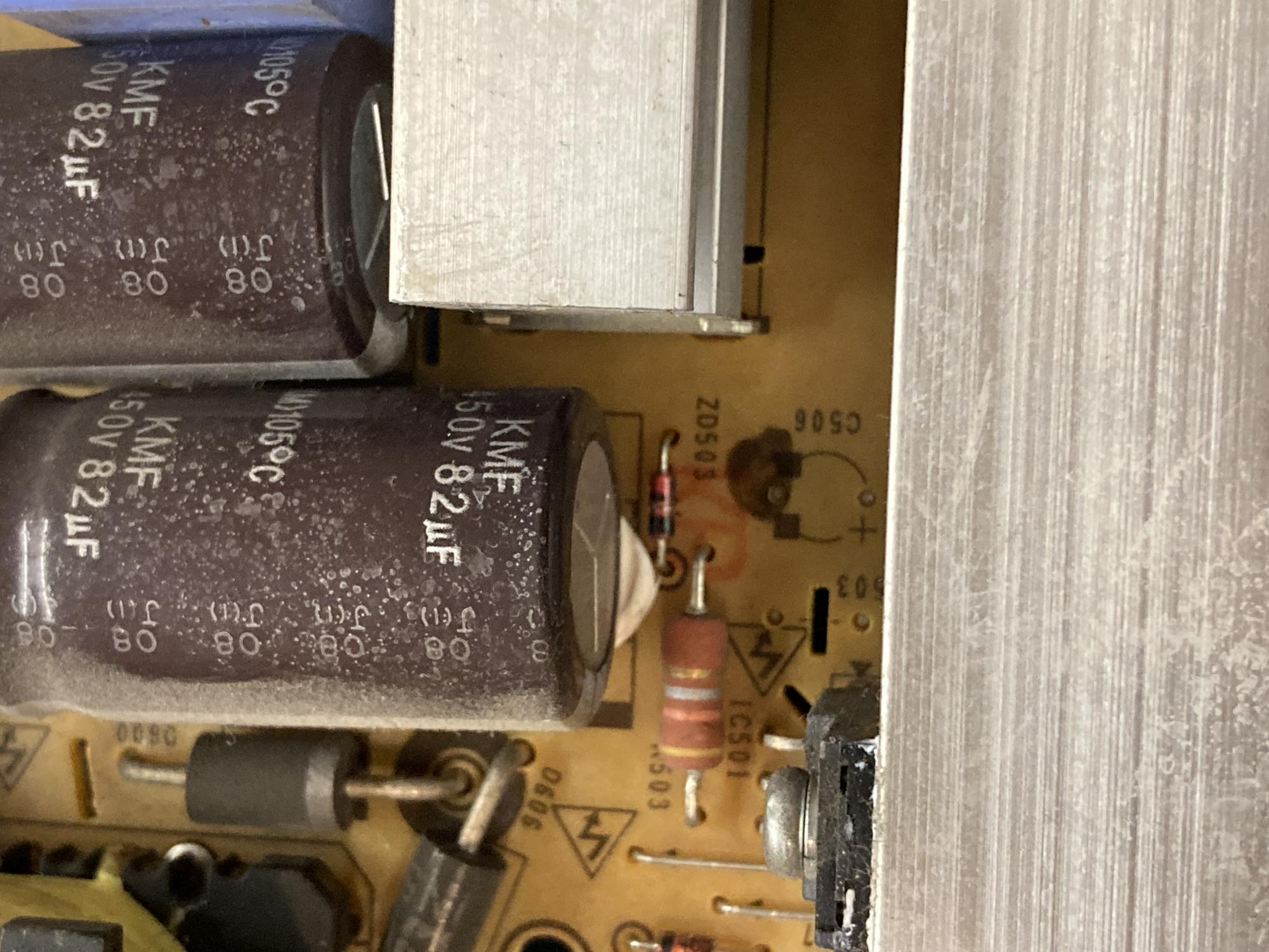

    I found that one Zenner diode was shorted (i tested all other diodes) but when pulled out from the board it turn out just fine (no short). Next to the diode is a resistor that shows 0 Ohm but i do not know what value should be that resistor.
    Can you please help me to determine the value of the resistor?
    Also, I notice that a few Schottky barrier rectifiers (W2206) have shorted pins 1 and 3. (TO220 package). When taken out the board they are ok, no short.
    Do you have any clue where should I start? besides that resistor :-)

        Re: LG 42LD420 no power
        Hmm now when i look it again it seams to be yellow, orange, silver, gold
        And that turn out to be 0.43 Ohm
        But id that is true why is zenner diode shorted
          ok, that makes sense, its ok, leave it in.
            zener reads short because of other components in the circuit, you know its good because you measured it out of circuit and it was ok right? like about .5xx to .7xx.
              Yea, outside the board it is 0.5xxx

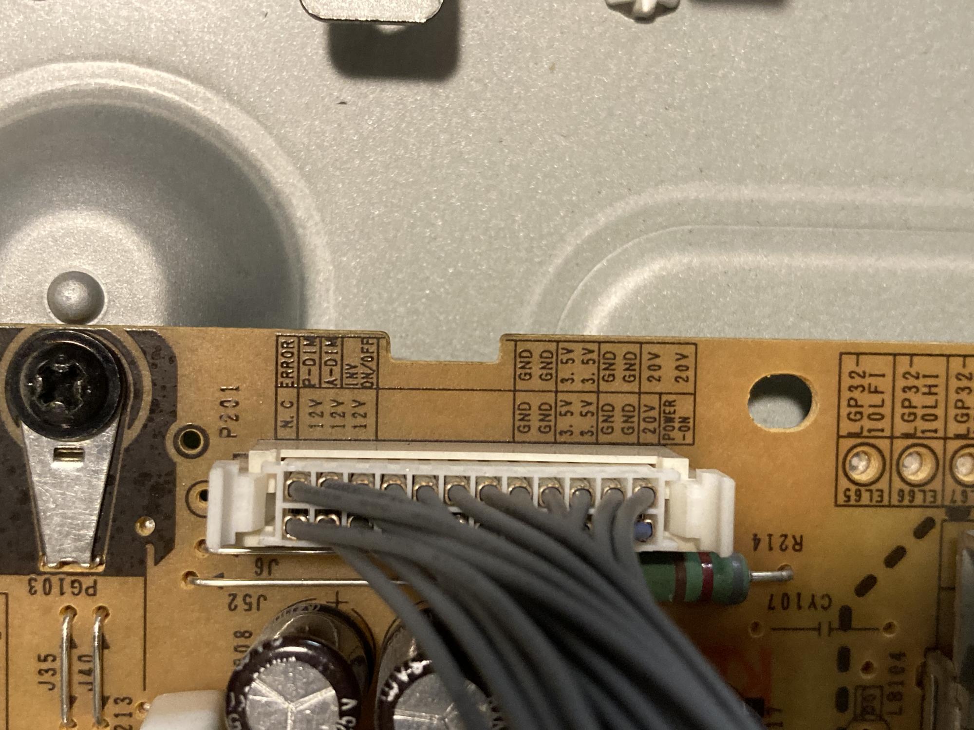

                          can you get a good clear picture of the map/legend of expected voltages of the connector on powerboard?
                                Here is the pictue, all 3.3V,12V and 20V are present. On the other labelas are like this
                                Error = 1V
                                P-DIMM = 1V
                                A-DIMM = 3.3V
                                INV ON/OFF = 0V
                                  ok, probe inverter on-off, leave probe in place, take note of voltage with tv in standby, then turn on power see if there is any change or if it just stays 0 volts.
                                    It is the same 0V in stand-by and when turn on. Always 0V
                                      ok, that's a problem it should probably be 3 volts or so, so looks like you are not getting the inverter on signal coming from the mainboard.
                                        ok, we can try this, unhook cable from powerboard to mainboard, then test the pins on powerboard connector, which pins have voltage and how many volts?
