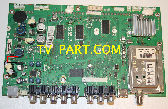

          I found out it was not the main Y buffer board as mentioned before. I found a board call the scaler board that had either a blown cap, resistor or transistor. I can't tell what is it, because its blown so bad. I'm try to inclued a piture of the blown part, I hope it works. The picture shows a good board, the part that is blown has a red square box around it. The number next to the blown part is 72U4, have no idea what this is. The model number is a magnavox 42MF231D/17. Does anyone know where I can find a schematics for this board. I believe I can go to radio shack and get this part. If you are having the same problem, please check your scaler board.
            What is your day job? Are you a tow truck driver, a mortgage broker, or a bill collector? What on earth possessed you to post a 900K .bmp file you found on the internet rather than an actual picture of your board?
            Search for 42MF231D/17 schematic (don't use Service Manual, that will give too many false hits). If by any chance you find a free service manual, download it and look it up. Due to crowded circuit boards, Philips uses component identifiers. Tables in the service manuals cross reference to the actual part number, the Philips part number, the schematic location, and the physical location on the circuit board. In Philips / Magnavox terminology, the board is called the Small Signal Board. That particular section appears to be in the DC / DC converter. The fact that it is burned would indicate there are other shorted components.
            HOWEVER, that is pretty pointless. The fact that you even contemplate buying parts from Radio Shack shows how inept you are.

              OK, I have a question, I had the Tv looked at for a second time. From what the repair shop told me, the Tv was getting the 5v at startup that it needed to power on. All the power supplies, Y board, X board, Buffer boards (upper and lower) Z board all checked out. Matter of fact we had 5v throughout the set. From what the repair guy told me, he see's no reason why the Tv is power cycling off. After a little more investigating, we saw a burnt IC on the Main Tuner board. My question is can this board cause the Tv to power cycle on and off.
                Yes. I have said this repeatedly, study the service manuals. I have been unable to find one for that set at any of the free sites, but they seem to be available from the pay sites.
                That board contains a DC-DC converter which powers the signal processors, the input selectors, the on screen display, the scalar, and every control function for the TV.
                When the TV is plugged in, the Standby processor starts up, performs a self test, then waits for someone to hit the power button. Once the power button is pressed, it closes the main power relay. At that point it start checking the various outputs of the main power supply and DC-DC converter. These include 5.1, 3.3, 2.5, 1.25, and 12 volts. If any of them are out of spec, it shuts down the main power supply. On a Philips TV it also flashes a red error LED in a pattern that allows you to identify the exact error.
                Again, that burnt component is in the DC-DC converter area. IF, for example, the 2.5 volt supply is missing or reads too low, you very well could get snow on the screen until the standby processor turns off the main power supply.

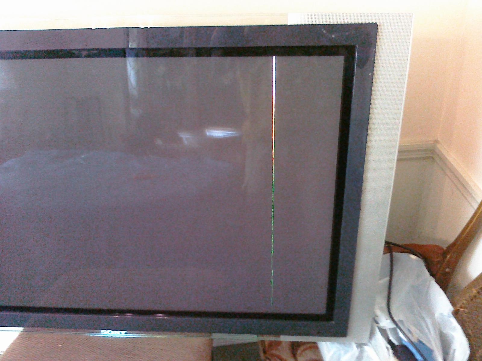

                                        This is a update to my last update...I got a another Tv its a Sony KDE-42XS955. It has great picture and sound. The only problem is, there is a vertical line on the right side of the screen. It take up a small portion of the screen about 6 to 7 inches.. I took some pictures of it with my camera phone and I posted it below. When I called Sony, they told me to reset the Tv back to the factory setting. But the only way to do that is with the remote which the Tv did not come with one. But I don't think setting this Tv back to the factory settings will fix this problem...Does anyone know what could cause this. I think Sony was trying to tell me that the screen was to large or something like that.
