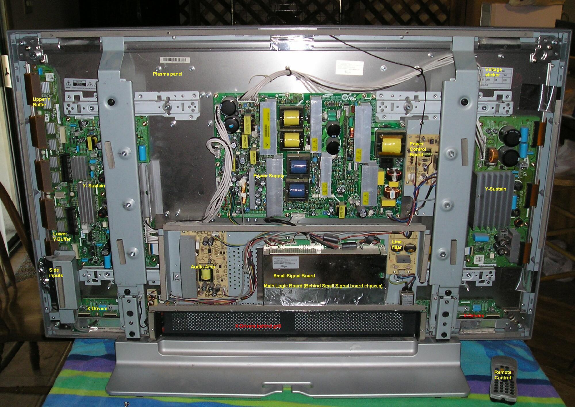

                                  I would have to admit I know nothing about a TV repair. But here is what i do know, I have a 42' Magnavox Plasma 42MF231D/17, that won't stay on. This has got to be a simple fix. The TV will come on, but after a few clicks it turns itself off. Now if I was to break that thought down, something is stopping the TV from staying on but it will allow the TV to turn on. Something is killing that power once the power button is pressed. hmmmm, I see nothing on any of the boards that seems burnt, or any caps are that puffed up. Now to my little knowledge, that only leaves a couple of things, a shout in one of the boards. I guess my question would be which board controls the power to all the rest of the board. I am really confused as tp the boards in a plasma TV. It seems like every board in this TV is a power board. (But that why, does this TV have to connect to a video source before it will stay on.)
                                  • PlainBill
                                    • Feb 2009
                                    • 7034
                                    Re: Magnavox
                                    Oh, good Grief!!! Here's a picture of the back of the TV, and most of the boards have been labeled. All you have to do is go to Wikipedia and see what each of them do.
