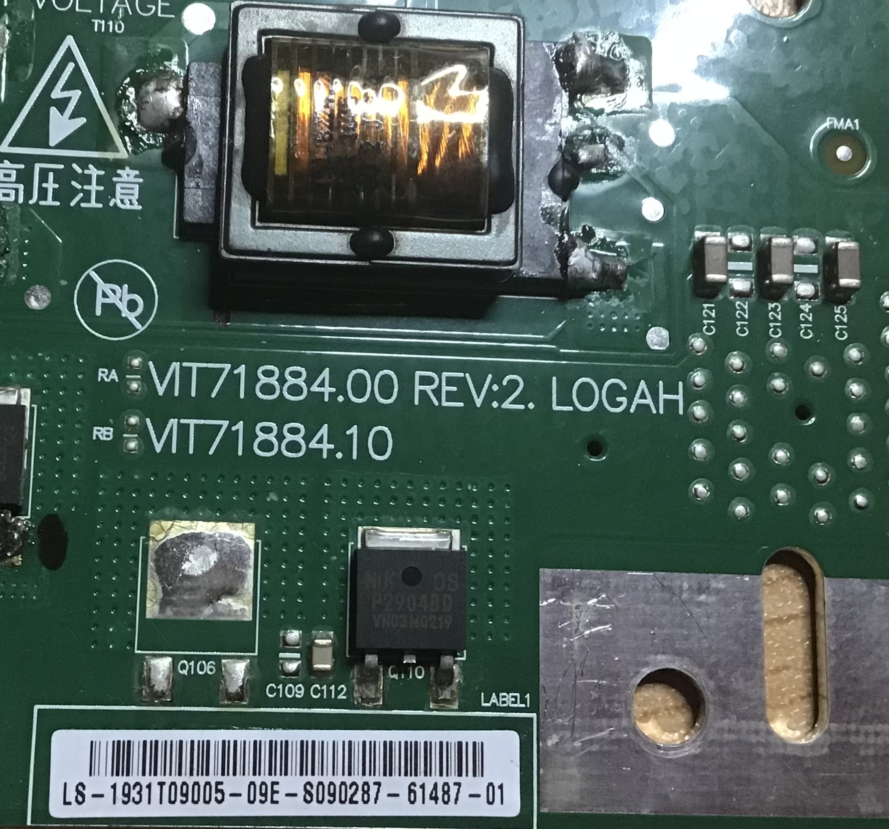

    Hi there
    What Model or Chassis is the Toshiba Regza 32RV753 please?
    I cant seem to find a Board View or Schematic for it?
    The inverter Board is Dead, and one has been ordered and did Fix the Problem
    I just want to repair this one, as a Spare if anybody might need one

    Re: Toshiba TV - Regza 32RV753
    The model would be 32RV753 The inverter will have a separate board number like VIT71884, Have you checked the fuse on the inverter board?
      Hey R_J - Bless you
      Yes, the Fuse seems Faulty, as it measures O/C
      The TV has gone, but I have a faulty board here that I want to understand and repair.
      Why is it so hard to find a Schematic?

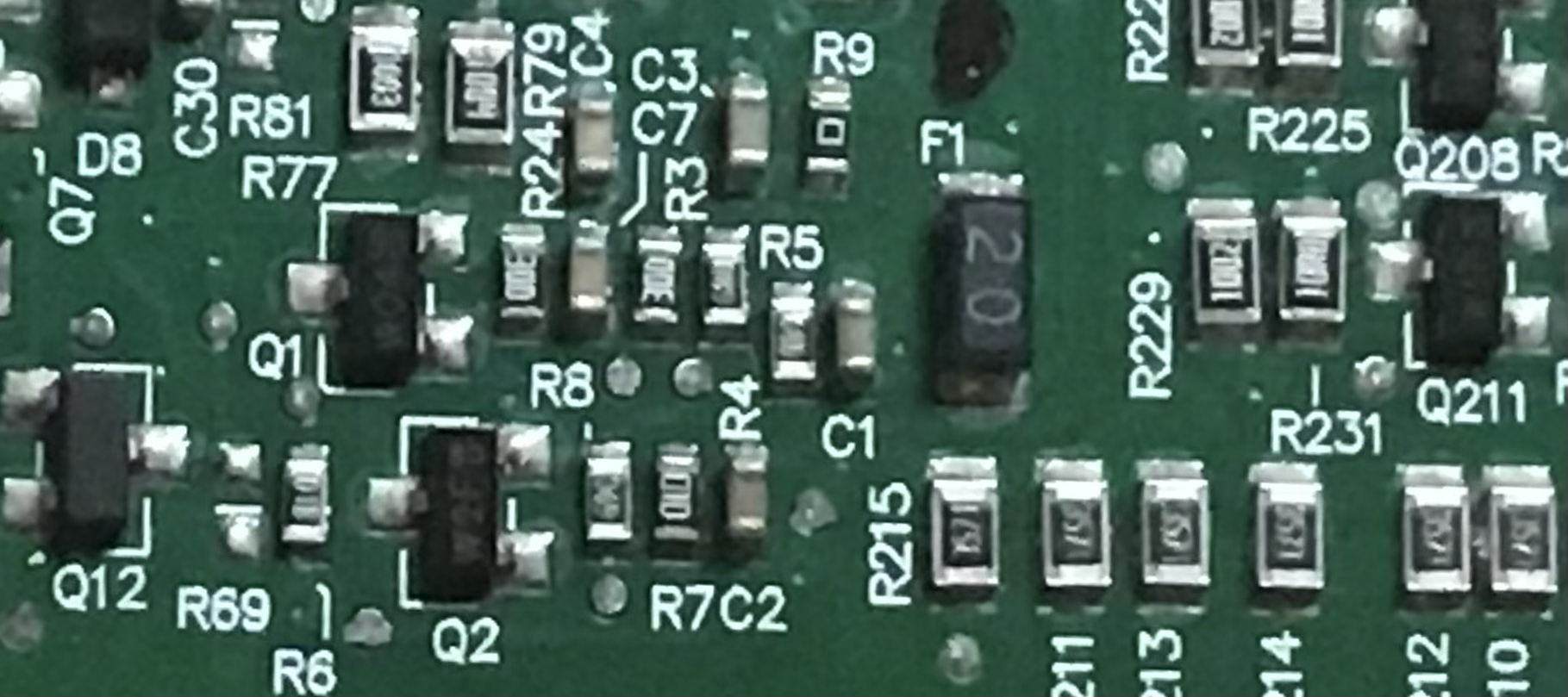

        Here
          I guess you could ask your government who are so concerned about the environment why they don't demand any electronics sold must have a complete service manual.
          Meanwhile you can check components for shorts.
            So F1 (black) is open? is F101 (white) ok? I see the board listed on shopjimmy for $32.00 CDN, I would not fix it for that price.
              So get some fuses, sometimes not always a fuse will just pop from an errant surge, if it pops you have another problem.
                with no tv to verify the board working, the challenge will be a big one indeed.
