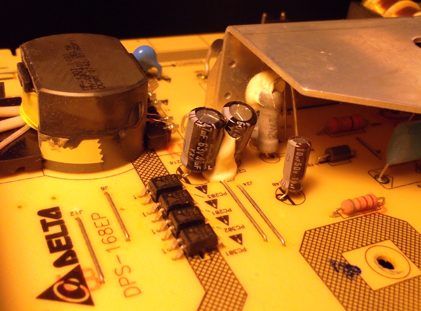

    Selldoor: The blue caps and the larger black one on the SSB board are all Lelon. I will reassemble it and try the manual warm up and report back with the results.
    retiredcaps: 1. I'll attached pics of the caps on the power supply.
    2a. The LED is Blue whenever it's powered up (blue is the only color I've ever seen on it). It comes on for a few seconds after plugging it in (standby warmup), then comes on and stays on when powered on either manually or by remote.
    b. There is sound.
    c. Backlights (ambilites) come on and respond as normal to video images (I think).
    d. When the video comes on after the long warmup, everything works as normal - menus, setup and settings
    f. Picture is good. (I normally run it off my laptop now, thru a USB to HDMI converter)
    3. Once warmed up it runs like a new TV and restarts quickly - haven't timed it, but will do that after reassembly.

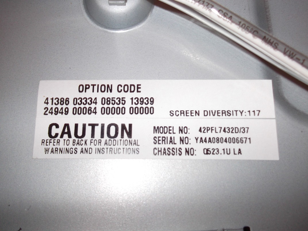

          Well I looked at the service manual for PANAMA chassis: Q523.1U.LA
          It does not match his chassis, it does not use the combo PS/INVERTER board.
          Panama: can you verify the chassis number or the post you had referred to? The thread is getting long and hard to keep track.

            #105
            Re: 42PFL7422D/37 Service Manual Needed
            Chassis Sticker pic
              #106

                #107
                Originally posted by Panama
                4. No inverter boards on this chassis (see chassis picture above)
                Ahh, I didn't notice that the overall pic and the power board pic is rotated 90 degrees. I see the inverter transformers on the power board now.
                The KY caps are normally a good United Chemi-con series.
                The symptoms are almost sound like classic high ESR caps. As the TV warms up, the cap's ESR drops and allows the circuit to work properly.
                Do you have an ESR tester?

                  #108
                  no ESR tester I'm afraid. I'm about to try selldoor's strategy of prewarming the caps with a hair dryer to see if that reduces the warmup period before picture lites up. Unfortunately, now I'm just getting a red flashing error code 6 - 3. Hmmm! Any thoughts on that?
                    Something which might explain why it has different boards the thread is for
                    42PFL7422D/37 and your label says 42PFL7432D/37
                    Didnt notice that when I first replied to the post - sorry
                      #110
                      The bad part is that he giveS the correct chassis P/N in post #105, but when I download a bunch of service manuals from ELK, none of them show the correct PS/Inv board combo.

                        #111
                        That's probably my fault for forgetting to point it out in the first place. A 'best fit' search result landed me here in the first place and I found alot of good info but forgot that it wasn't quite the same set.
