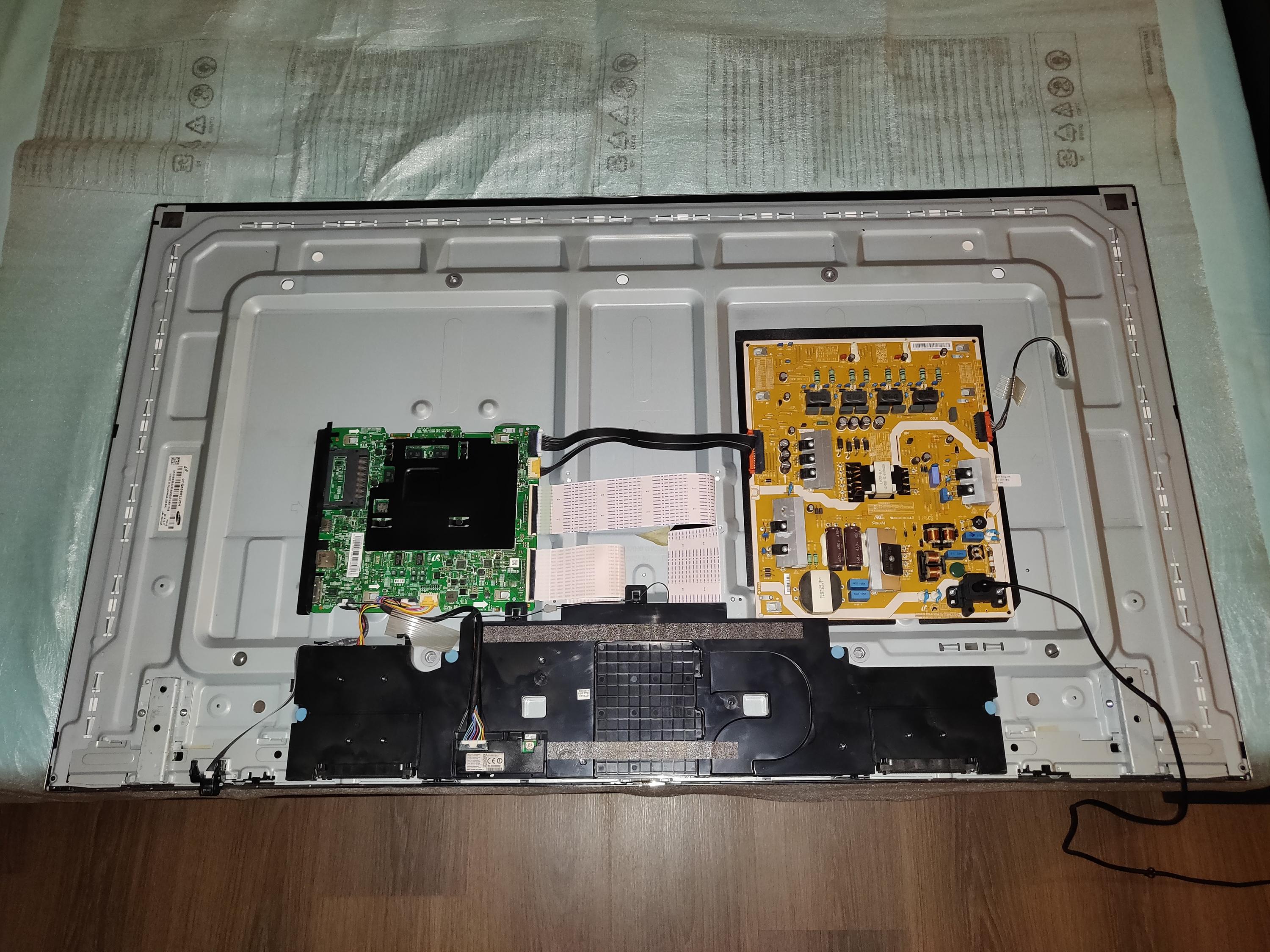

    Hi, my tv turned itself off and since than i can't turn it on. I have no standby light.
    I tried like i saw on few youtube videos to disconnect the cable that is coming from the main board and than to power on tv, to see if backlight will appear, it did appear but only for a second, and while power cable was attached I noticed small ticking sound from the middle of power board. Than i attached the main board cable again and ticking sound was still present. I guess sound is coming from transformer area, but not sure.
    Then i measured stby voltage on the board, and it is below normal value displayed on the board, and it is not stable (4v-5.7v), i got it on the video, when i detach main board cable values are a bit higher (5v-7.5v).
    I looked for swollen or leaked caps but didnt found any. What do you think? what should i look for next?

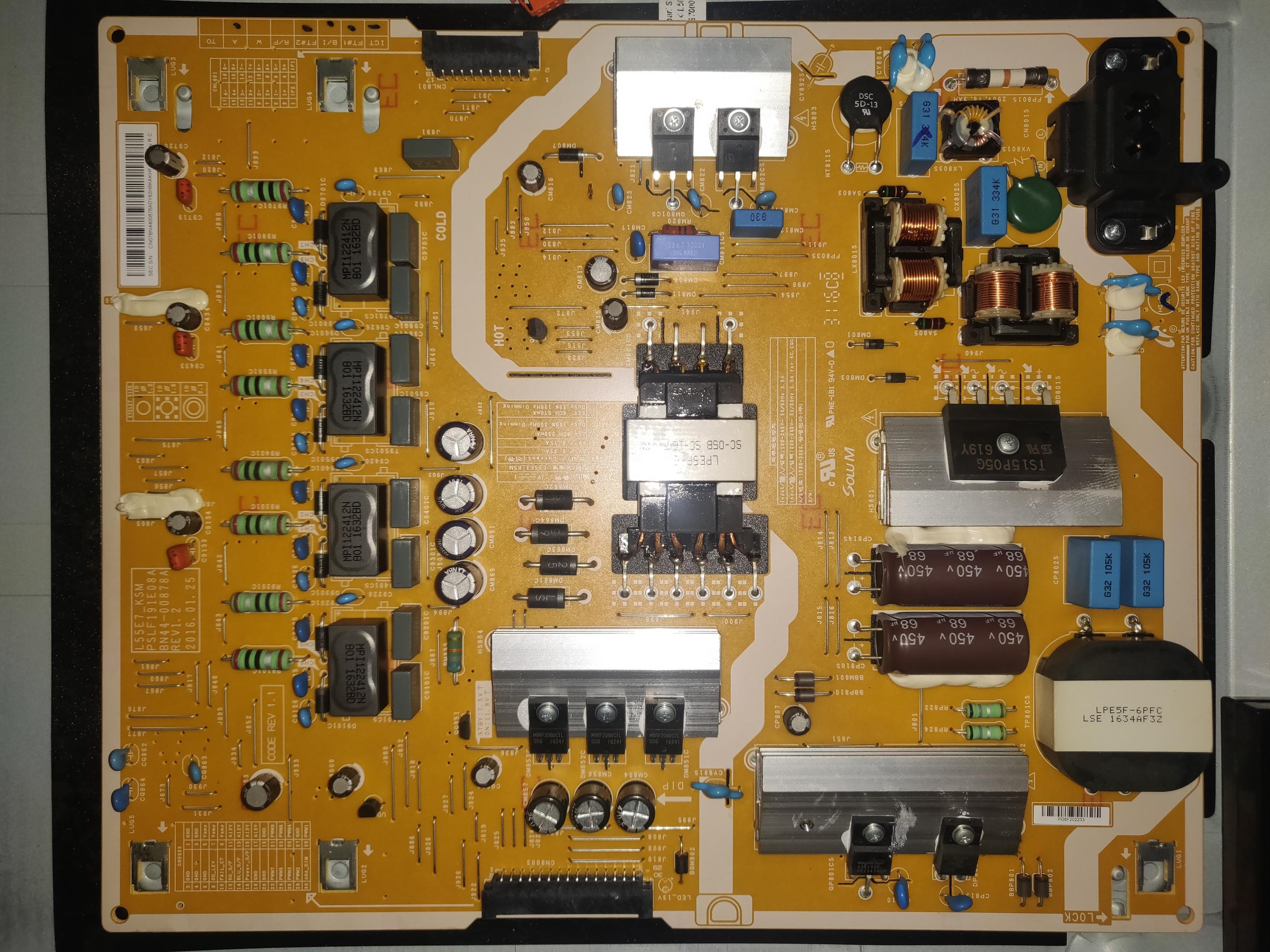

          go ahead and check all the diodes on top of board, do the round ones first.
          • nomoresonys
            • Jan 2013
            • 12331
            • U.S.
            Re: Samsung UE49KS7000SXXH - No standby light
            they will have the stripe at one end, the others that resemble diodes without the stripe are ferrite beads not diodes. Meter set to diode put probe on each end, then switch probes, one way should read ol, other should read .5 or so.
            • nomoresonys
              • Jan 2013
              • 12331
              • U.S.
              looks like you have 4 others on the heatsinks, probably will check like this video, when in doubt look up the datasheet: https://www.youtube.com/watch?v=1KVBZSTY7FE
              • nomoresonys
                • Jan 2013
                • 12331
                • U.S.

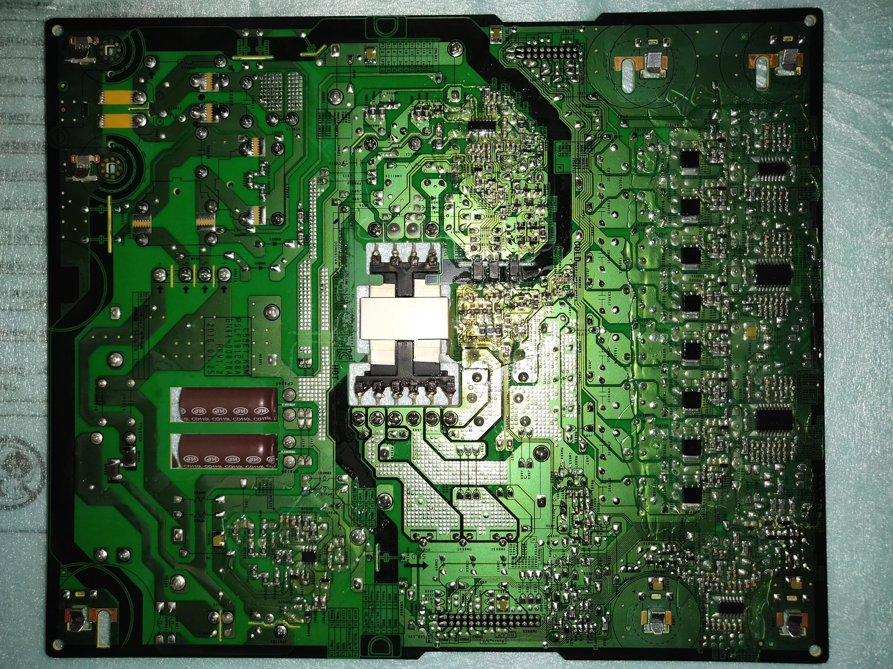

                so maybe check dm851c, dm852c, dm853c and those 3 caps cm854, cm856, cm857.
                • nomoresonys
                  • Jan 2013
                  • 12331
                  • U.S.
                  a good clear picture like the one above but of the underside of board might help.

                    I checked following diodes with 20K ohm settings.
                    4 big round ones:
                    DM862C - .004 and .004 both directions.
                    DM864C - .004 and .004 both directions.
                    DM863C - 1.679 in correct direction and 1 in opposite.
                    DM861C - 1.679 in correct direction and 1 in opposite.
                    DM851C, DM852C, DM853C:
                    negative lead on middle leg, positive on other legs: .484
                    positive lead on middle leg, negative on other legs: 1
                    Positive lead on first leg and negative on third leg and vice versa: .004
                    I measured this while board was detached from tv frame.
                    Diode problem? But which one?

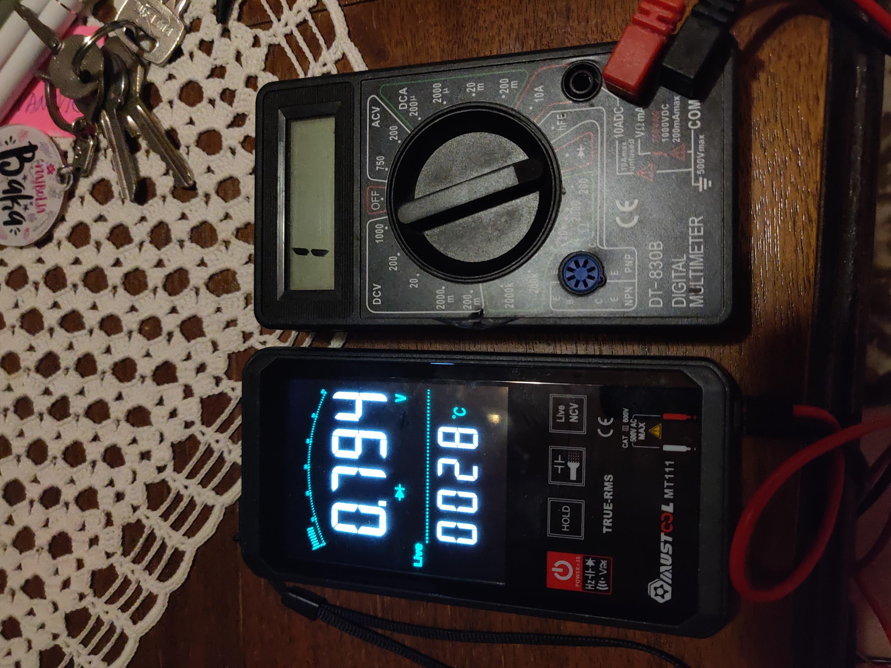

                                  Ok i rechecked these diodes with diode mode. I have these two multimeters at the moment, and measurements are different on each one. I don't know which one to trust.
                                  Multimeter MT111:
                                  DM862C - on each measurement multimeter is changing settings from diode mode to ohm resistance and i get values - 0 ohms.
                                  DM864C - same like with DM862C
                                  DM863C - red lead on anode, black on cathode - 0.284 / when i switch leads - 0.794
                                  DM861C - same like with DM863C
                                  negative lead on middle leg, positive on other legs: 0.125
                                  positive lead on middle leg, negative on other legs: values are dancing between 0.630-0.700
                                  Positive lead on first leg and negative on third leg and vice versa: it's switching to ohm resistance - 0 ohms
                                  Multimeter DT-830B:
                                  DM862C - 003 both directions
                                  DM864C - 003 both directions
                                  DM863C - 288 in correct direction and 1 in opposite
                                  DM861C - 288 in correct direction and 1 in opposite
                                  negative lead on middle leg, positive on other legs: 129
                                  Positive lead on first leg and negative on third leg and vice versa: 002
                                  Also i measured voltage while board was detached from tv, with only power socket connected, same unstable voltage.
                                    DM864C - 003 both directions: it looks like one or both of these is/are shorted, take one out of circuit and recheck it, if ok or bad recheck the other one in circuit to see if it's ok or not, maybe only one is bad.
                                    • B0r1s
                                      • Jun 2022
                                      • 21
                                      • Serbia
                                      Sorry for delay. I ordered quicko t12-942 from china, and I'm waiting for it to arrive. In the meantime i bought electric desoldering pump and took out two diodes, and yes one is shorted.
                                      On the diodes it is printed:
                                      LT6 | 23
                                      SB5 | 50
                                      Searching trough google i figured out that this is sb 550 schottky diode. I only found sb 560 diodes to buy.
                                      While testing sb 550 and sb 560 diodes out of circuit i get different readings in diode mode:
                                      SB550: 0.350
                                      SB560: 0.195
                                      So can i replace diodes with the new ones?
                                      • nomoresonys
                                        • Jan 2013
                                        • 12331
                                        • U.S.
                                        I think you're good to go, maybe replace all 4 so they are the same, hope you got more than 2.
