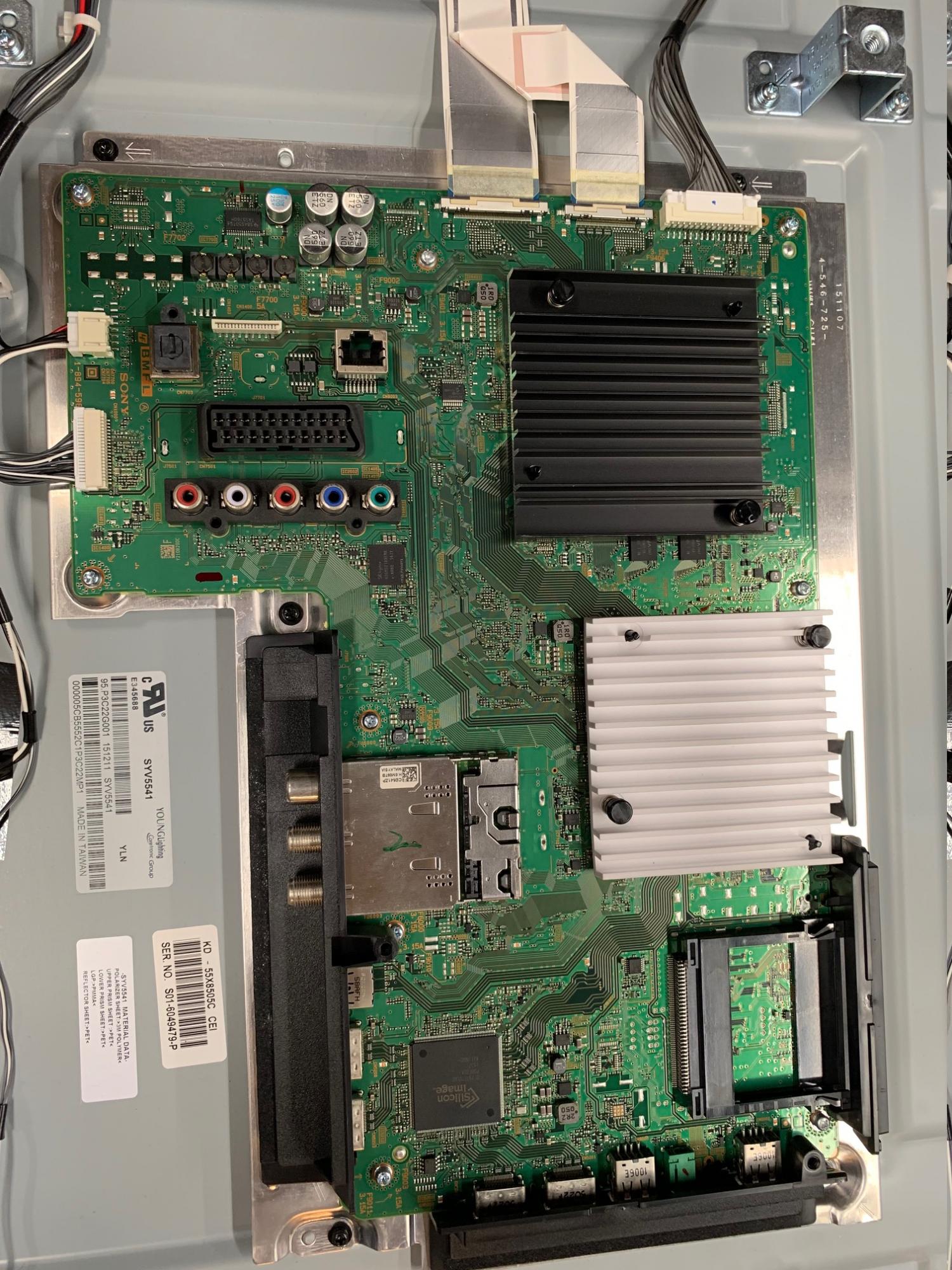

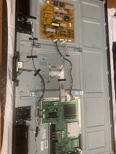

    Sony KD-55X8505 not able to start
    Sony KD-55X8505 plug it in, PFC starts up at 390VDC, DC/DC kicks on seem to supply mainboard with +12.7VDC.
    No led backlight, no supply to T-con...
    Any clue?

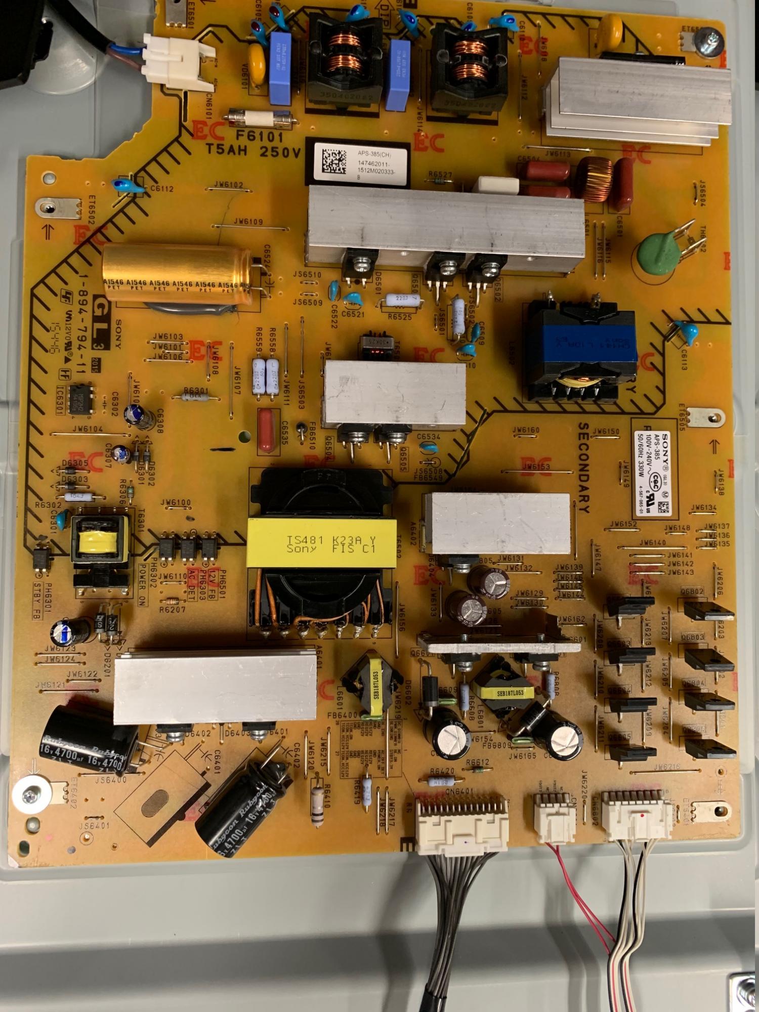

                            Re: Sony KD-55X8505 not able to start
                            Attach pictures.
                            12V T-Con is coming directly from PSU.
                            PSU generates +63V to dual boost converters to generate led backlight voltage. But boost converters are off.
                            No led is flashing.
                            PSU generates PFC voltage of 393V and 12V output is 12.7V.
                            STBY supply is 3.5V

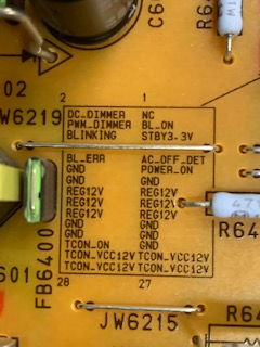

                                yours photo
                                so now its clear you have 3.3V STB.
                                STB- with Power On you will have REG12V this must be inplace to do further
                                STB with T_CON ON you will have T-CON VCC12V
                                STB with BL_ON will post BL
                                PM Dimmer need R as its low or high

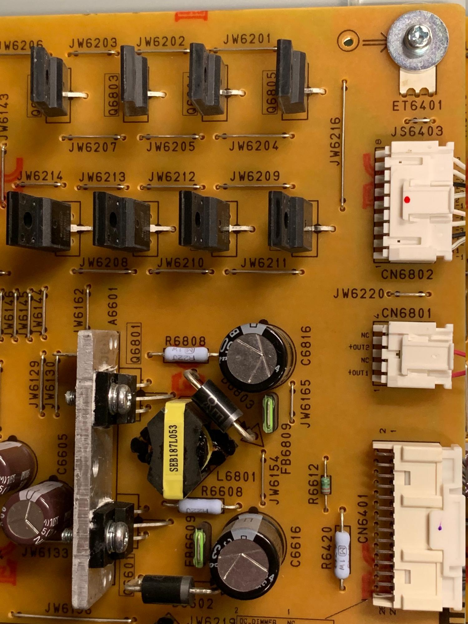

                                  Todays test:
                                  3V3 STB connect to PS_ON will make REG12V @ 12.7VDC
                                  3V3 STB connect to TCON_ON will make T-CON @ 12.7VDC
                                  3V3 STB connect to BL_ON does not change anything.
                                  3V3 STB connect also to DC_DIMMER does not change anything.
                                  I would suspect the boost converters to go active? At this point I have not applied anything to PWM DIMMER points.

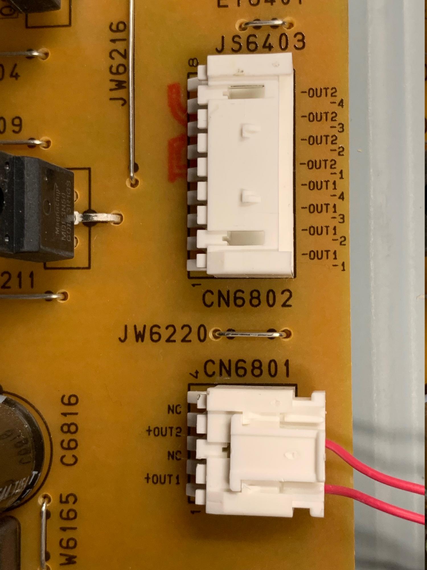

                                      yours PSU look fine.. put all sockets as it should and capture the V on BL sockt between each group of LED+ & LED- at start up ( boot ) check the high and low messurments to compare the groups reading after you finish the test.
                                      During boot, the maximum voltage applied from led driver is 63V (two outputs). I think I could power up each led group by a separate powersupply capable of 120V current limited ?
                                      • Diah
                                        • Feb 2013
                                        • 6357
                                        you have BL_error on the sockt. if its goes high at boot then you need to be ready for the hard work BL LED
