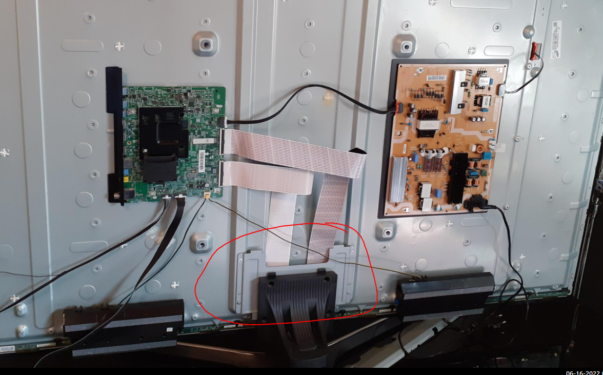

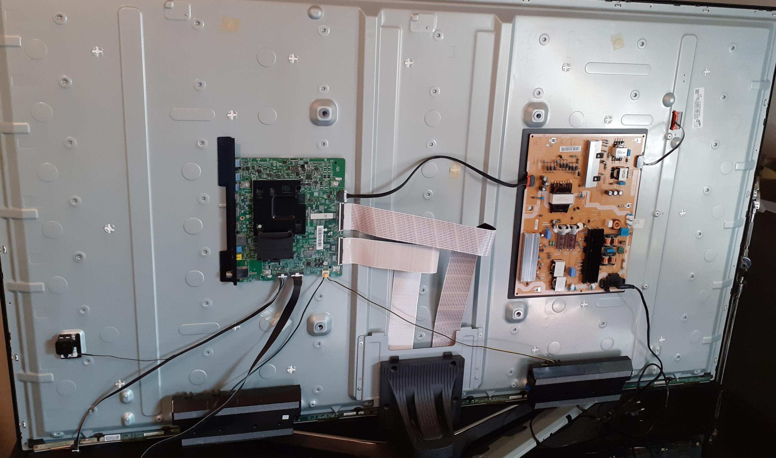

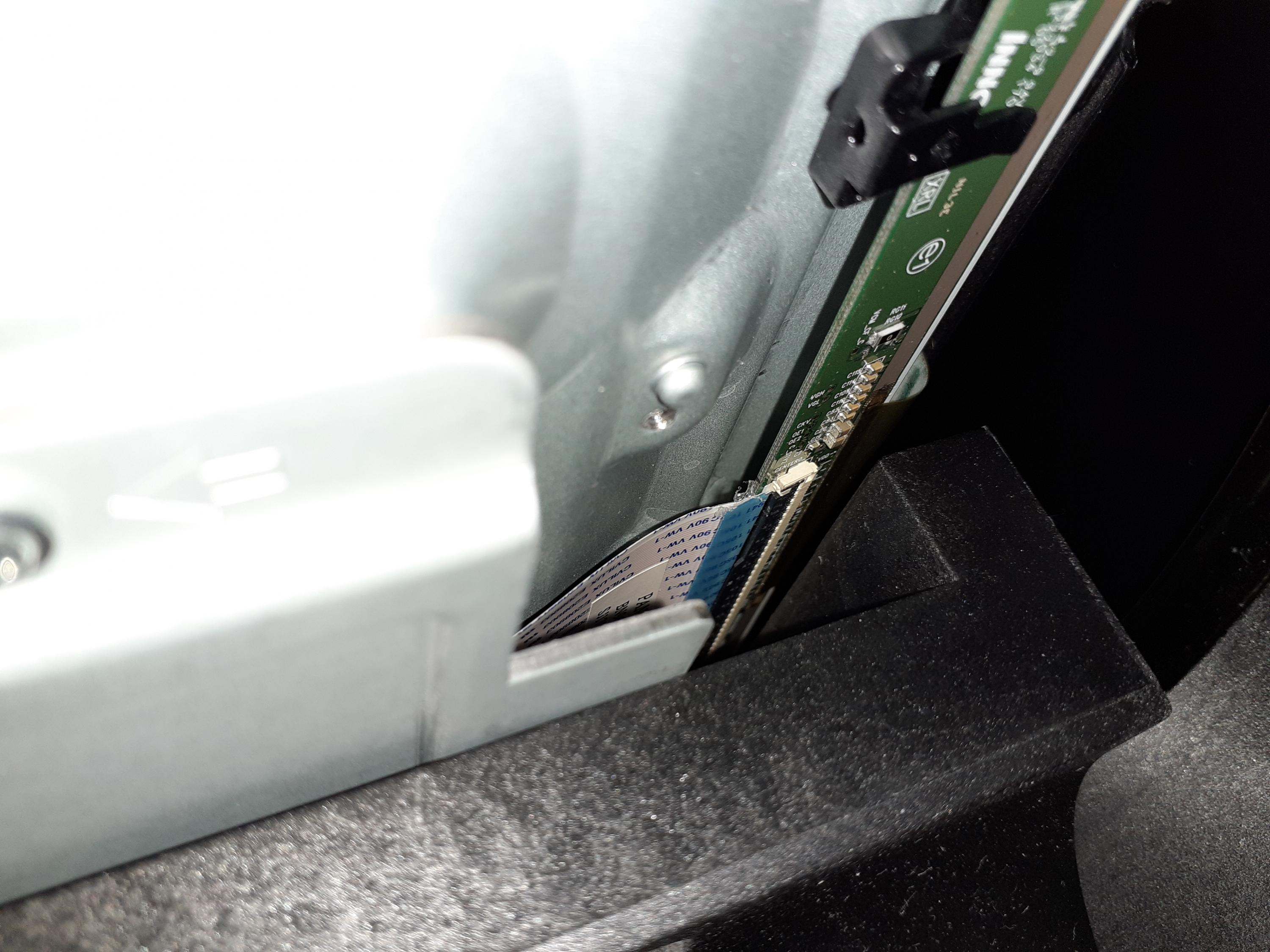

    Hello friends,

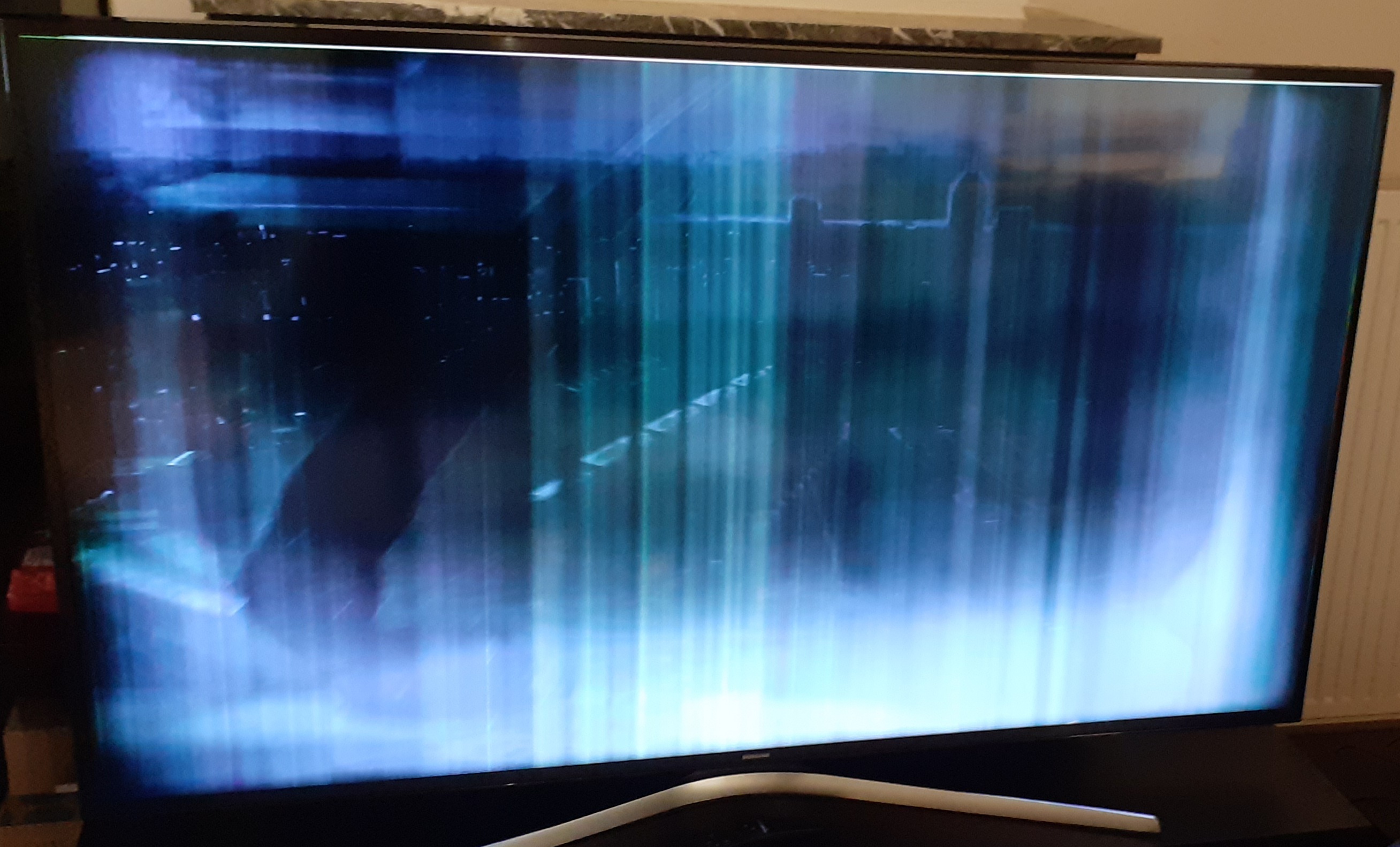

    I have a 65 inch Samsung TV here with a problem. The screen no longer has a "normal" image, but random color everywhere. Sound can be heard from the television from a program that is playing.
    The TV backlights are all fine and working great so I don't know where else the problem could be.
    Would anyone happen to know what the problem would be and what part would need to be replaced?
    Thank you in advance for your effort and cooperation!

    Looks to be a T-CON board issue, There is another board hidden behind a piece of metal where I circled in red in the image I attached, you can see two ribbon cables going to it in the picture you sent. That board handles all video signals and if it goes bad those symptoms can appear.

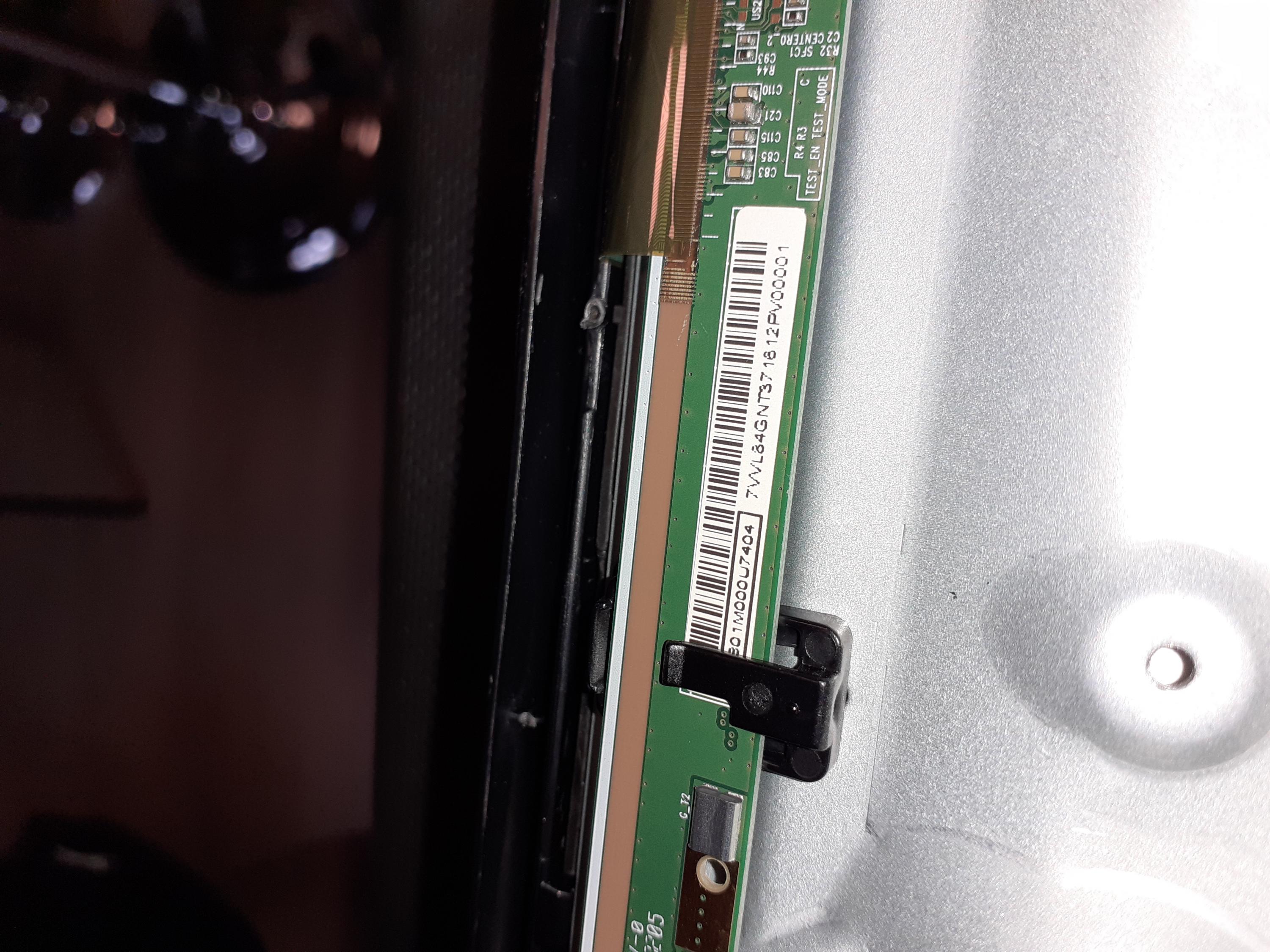

      Re: Samsung TV 65 inch No picture, but sound
      Thank you for your response!

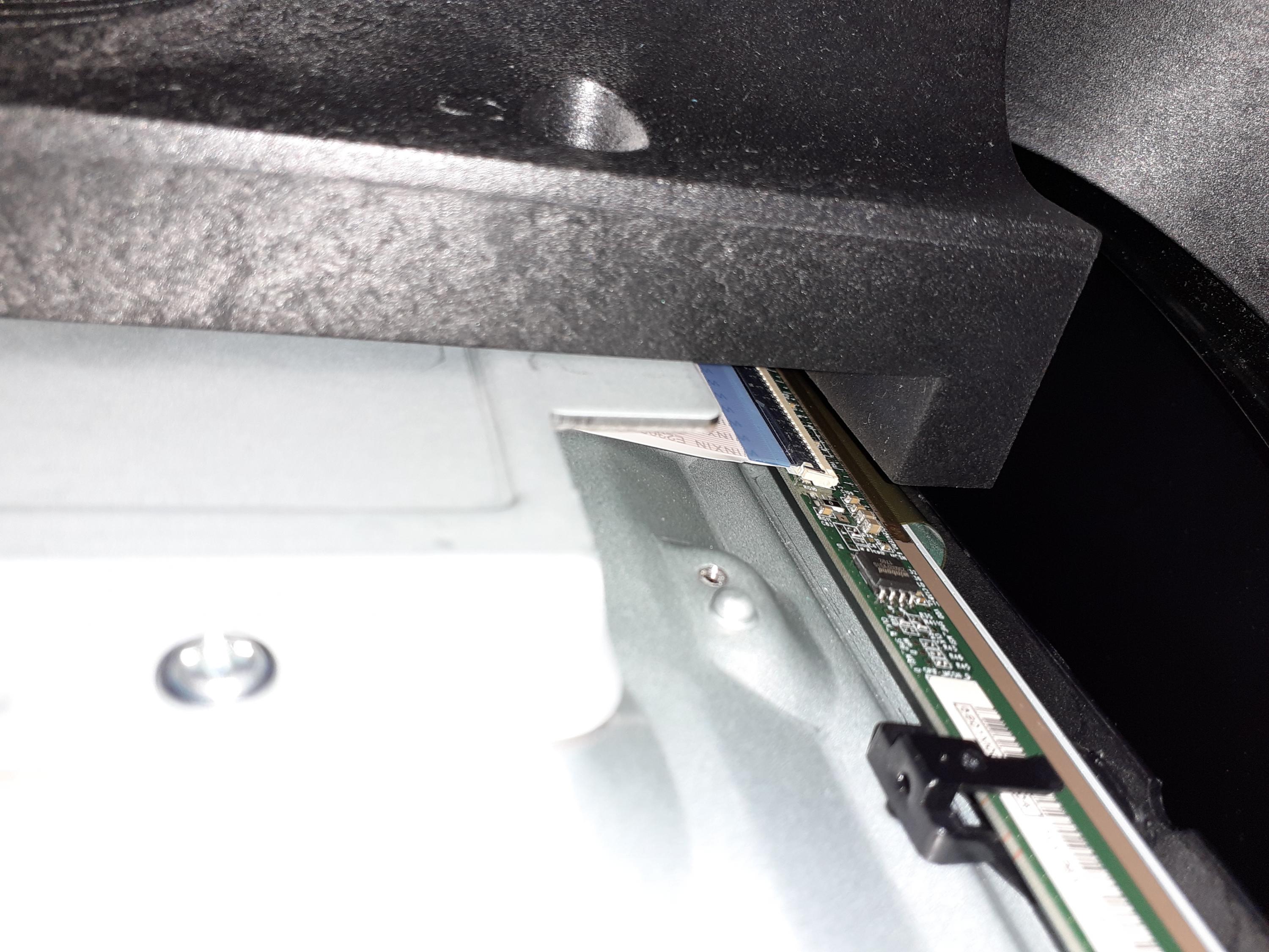

      These cables lead to this (see photo). What would be the name for these parts?
      Could they be the cause of the problem?

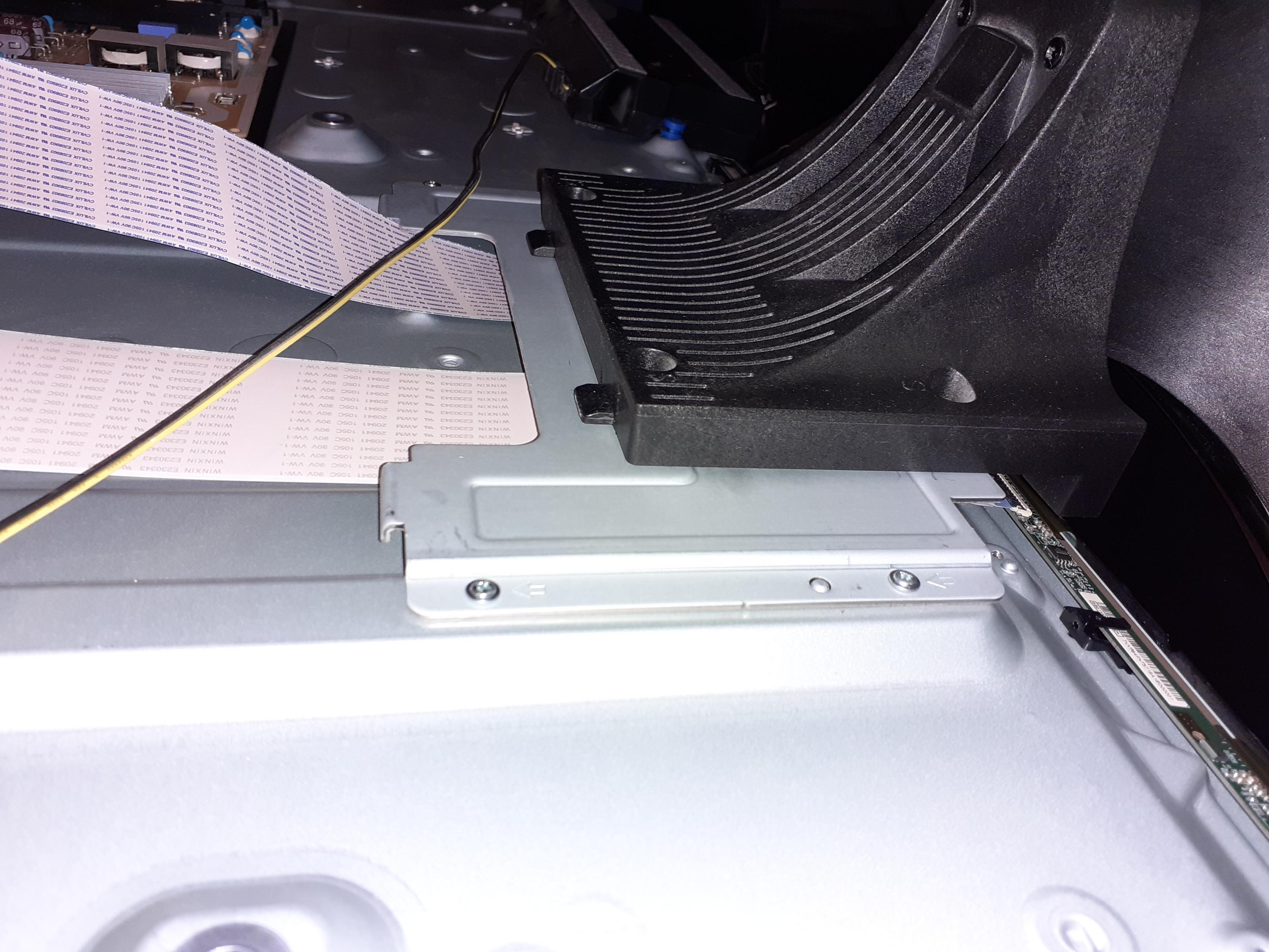

        Remove the stand and the metal plate.

          it's one of those that looks like there might be a seperate tcon under that plate but there isn't.

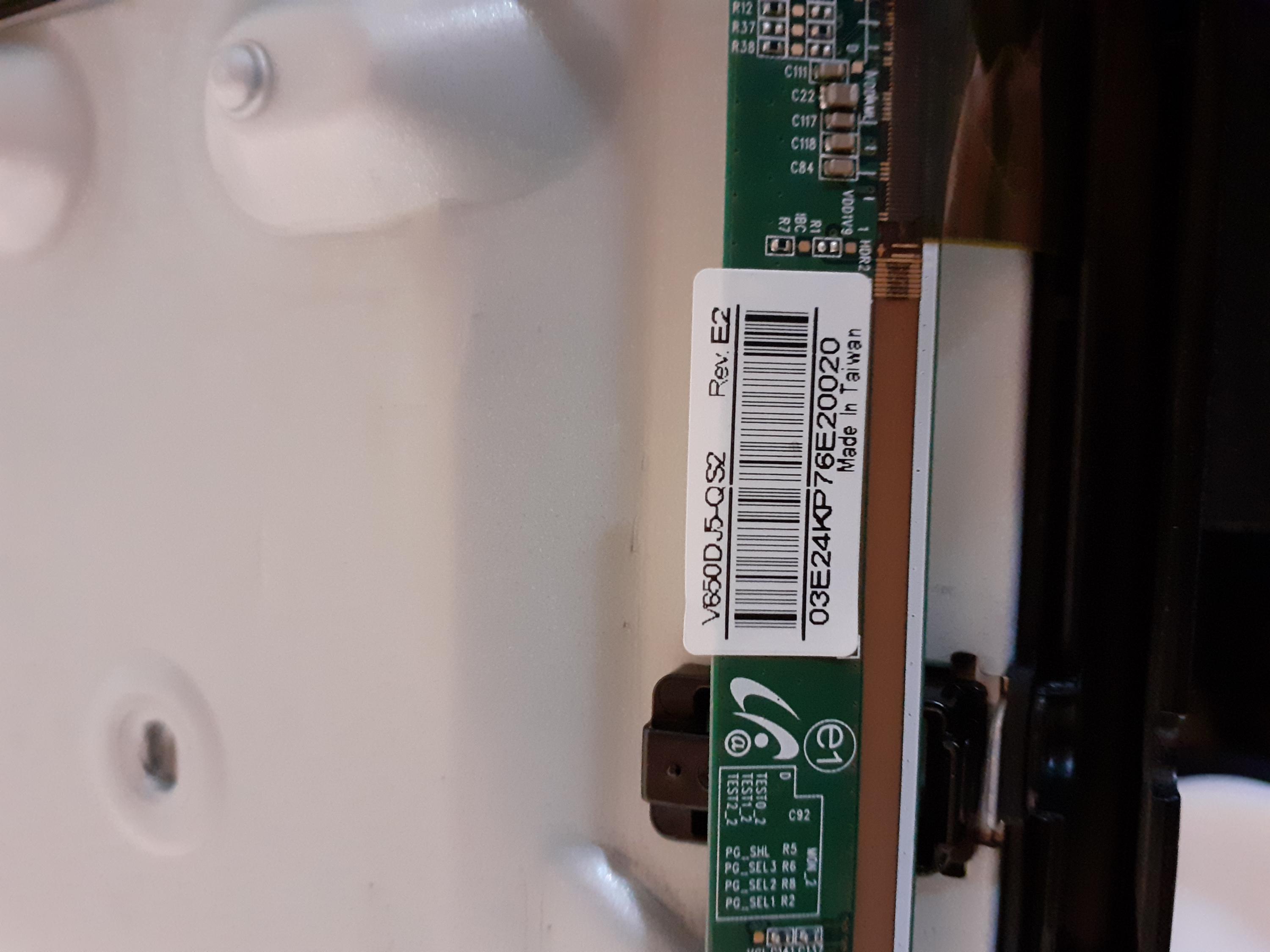

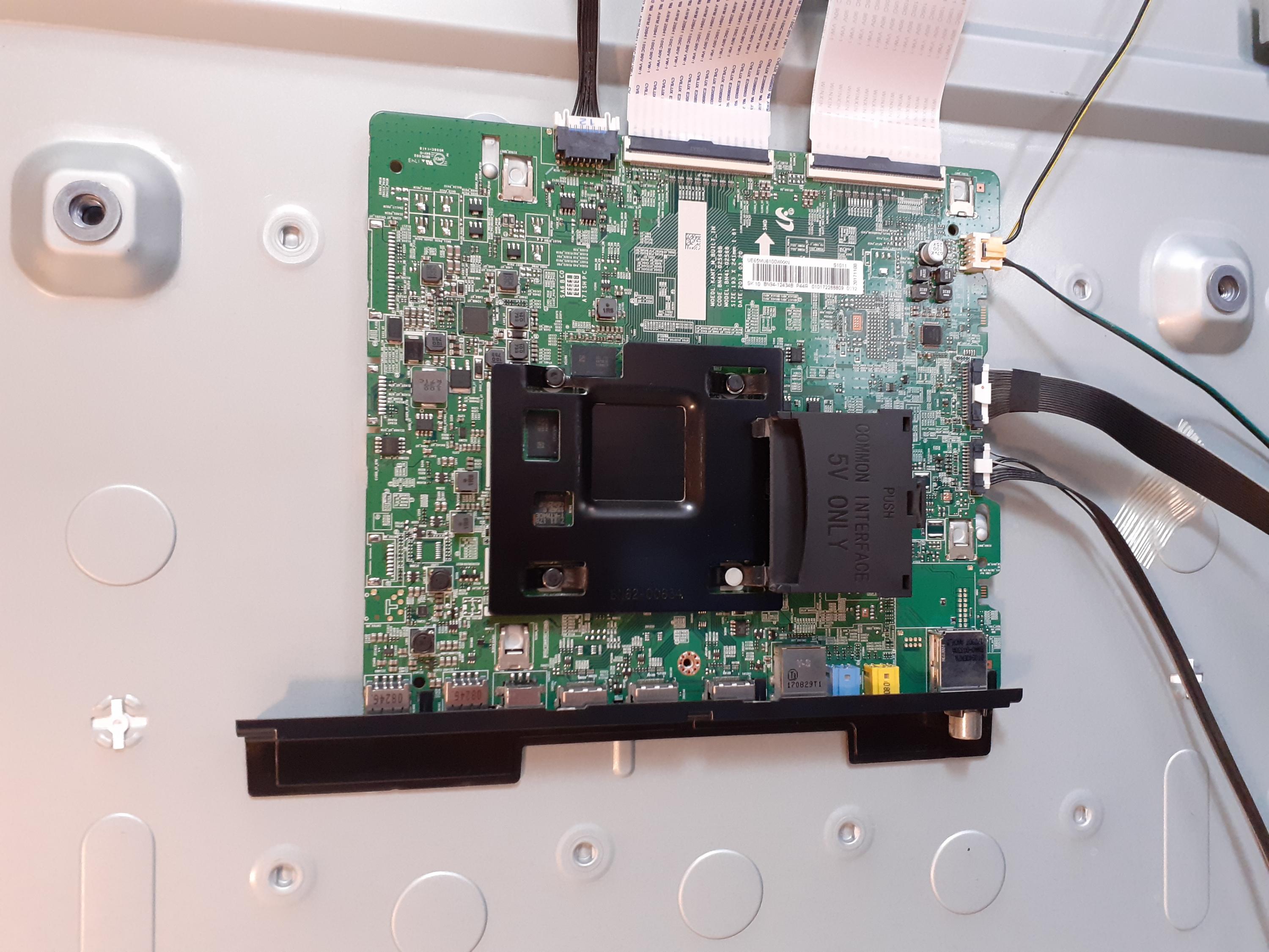

                First, thank you for your responses.
                I've looked behind the metal plate before, but there's no T-Con Board there. There are two cables, which come from the motherboard, which continue behind the metal plate.
                These two cables lead to these parts V650DJ5-QS2.
                Kind Regards

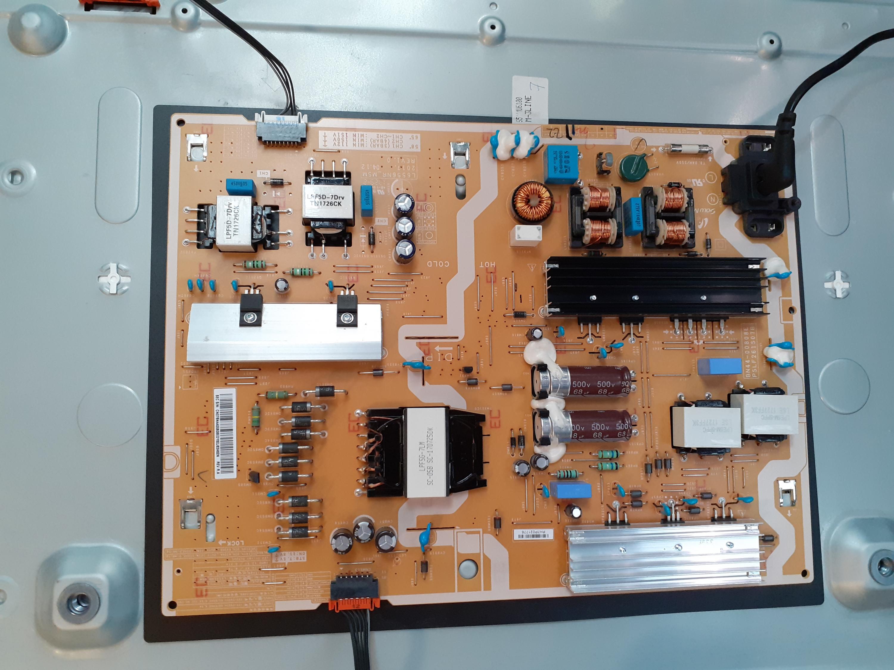

                  I would heat up main processor and see if there's a change.
                    Kind Regards
                    this buffer boards of the panel you showed us the lable of it ... take out the speaker so you can take look on the whole boards.. check each side left and the right if they are one piece boards or 2 pieces connected with U ribbon cable..
                    in case u have the U ribbon cable. disconnect one by one each side and check if there any different at the display
