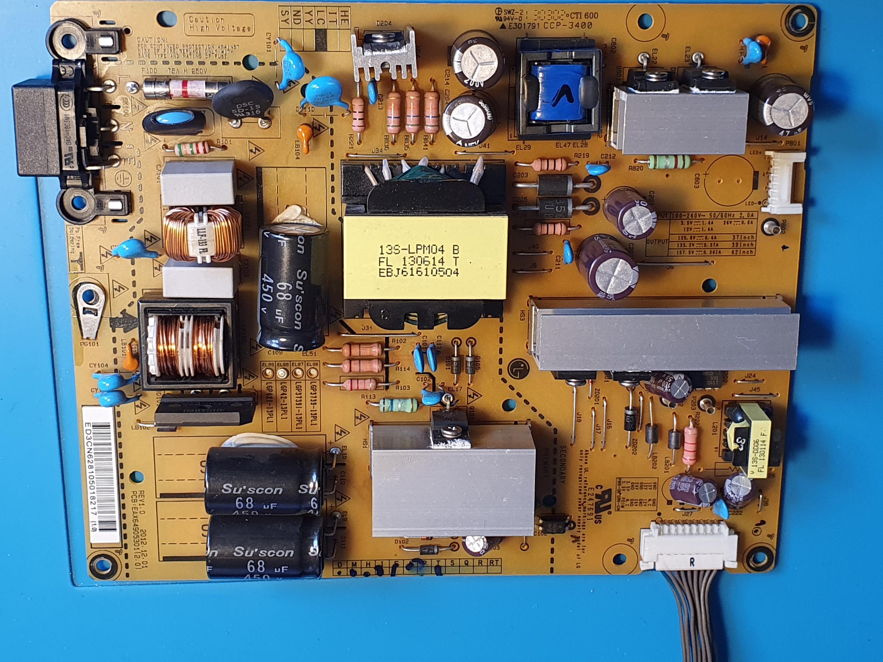

    In the photo below, I tried to emphasize what the voltage situation on the power supply board looks like.
    The voltage on the fuse is sometimes 180V and sometimes 24V
    Tomorrow I will check if I entered the tensions correctly.
    Power supply: LGP42-13PL1

        Re: LG 42LA6130 did not turn on
        Need a good picture of your power supply. Use the "go advanced" option.
          I hope that was it.

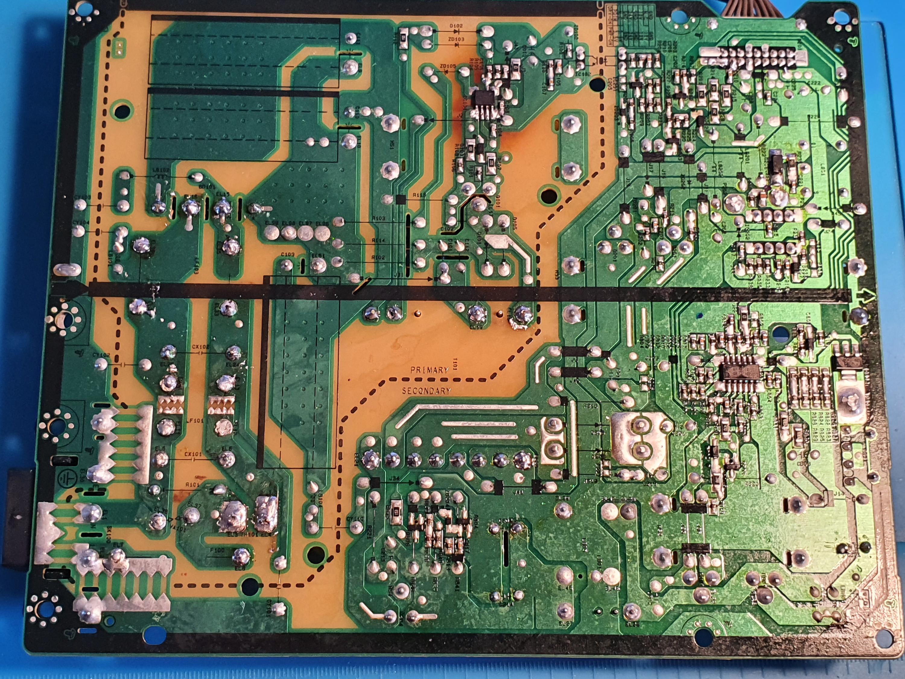

            start with touching up the solder joints, looks like at least a couple bad ones, examples of bad joints there: https://www.google.com/search?q=bad+...h=578&dpr=1.25
              if that don't do it, it's probably just the usual backlight issues as mentioned.

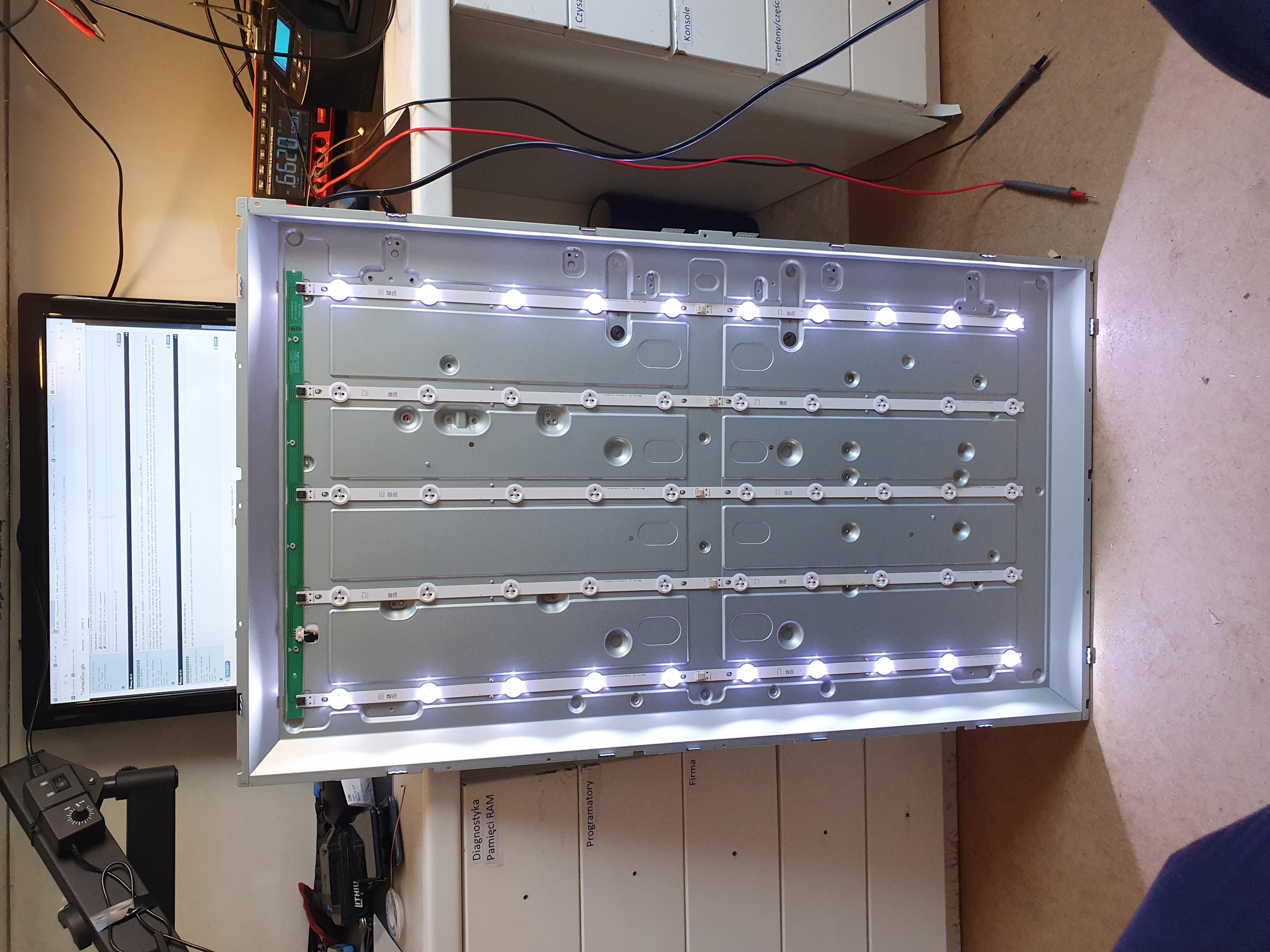

                I will improve the connections on the old power supply. On a different power supply and motherboard, the situation looks like the picture below.

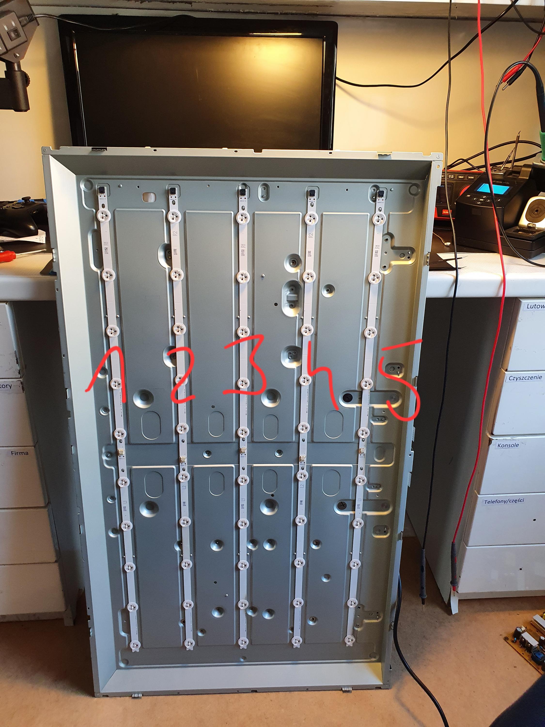

                  ok, you have it stripped down to backlights, you can test them, just look up diy backlight tester on youube if you don't have one, don't test them with tv plugged in or powered if your testing with tester, can also test them individually with multimeter probably.
                    1 it works
                    2 the bottom half works
                    3 it works
                    4 it works
                    5 it works
                      Glad to hear it.
                        Replace them all with new. They all have wear and will eventually fail. Lots of sellers on ebay and Aliexpress.
