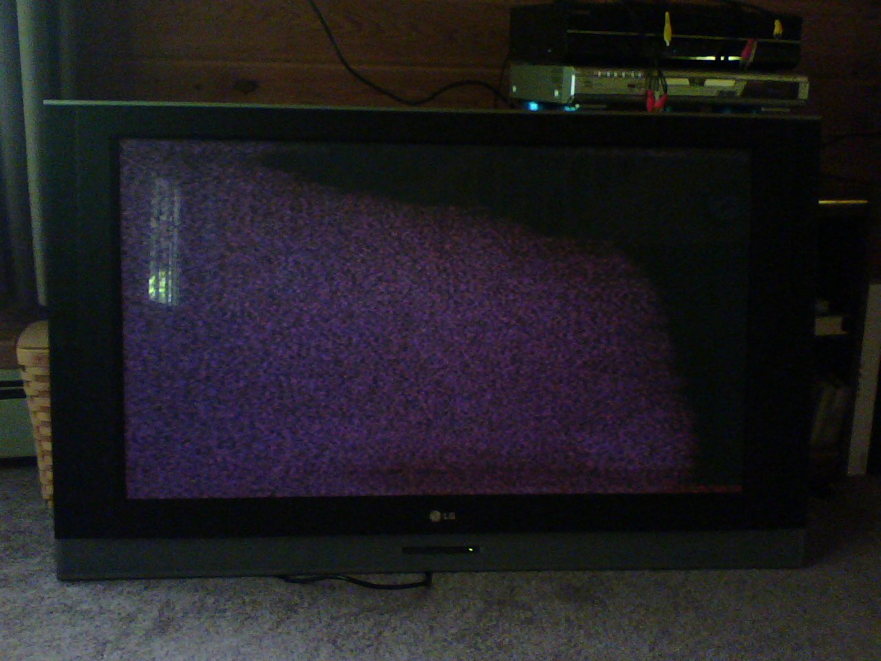

    hi all,'
    check out pic of what i have
    this happened suddenly while tv was on
    the screen you see has no signal to it,
    so its only normal static, altho even that is darkened
    and it fades into total black at upper right
    the question is..
    is anyone certain of the fix?
    i saw another guy on here with same tv and his screen was still visible all the way across.
    the suggestion for him was a y sus board prob
    i talked to a guy about mine and he says maybe a z sus board or power sup prob...
    any way to know for sure????
    thanks,,,,
    1 more thing
    the tv doesnt seem to get warm when turned on and it will turn off by itself after maybe 10 minutes or so
    always seemed to be pretty warm when it was on before,, i think normal for plasme tvs
    but not sure how long it would take to get that warm
    i have back of tv removed and powered up without feeling any warming anywhere

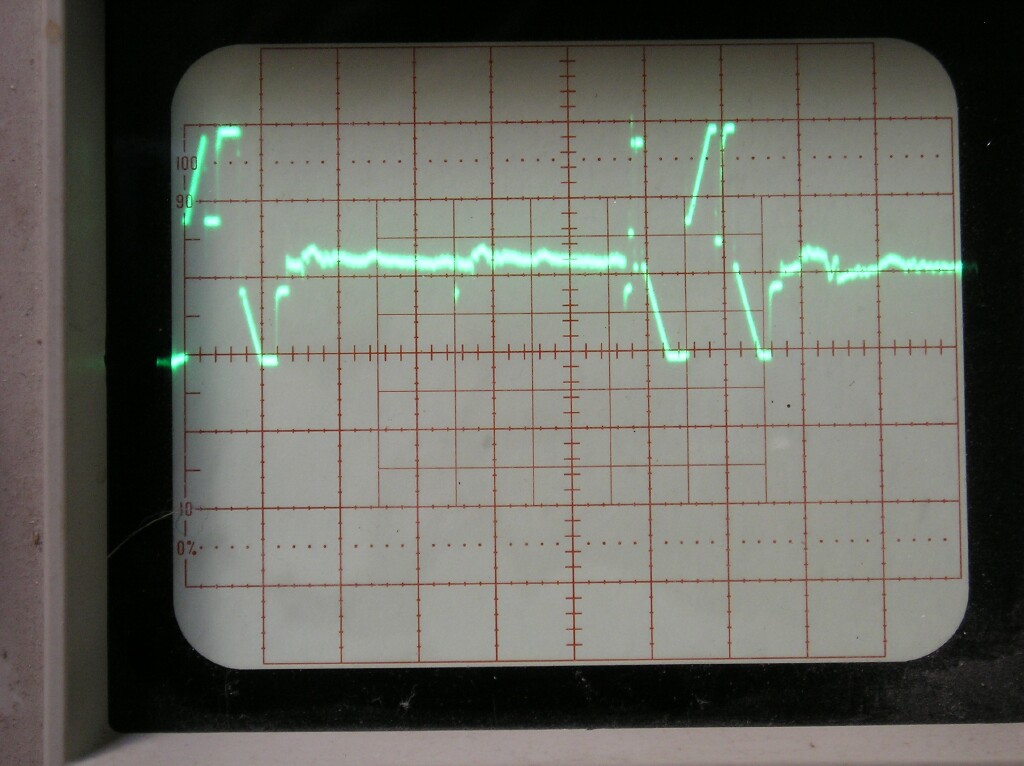

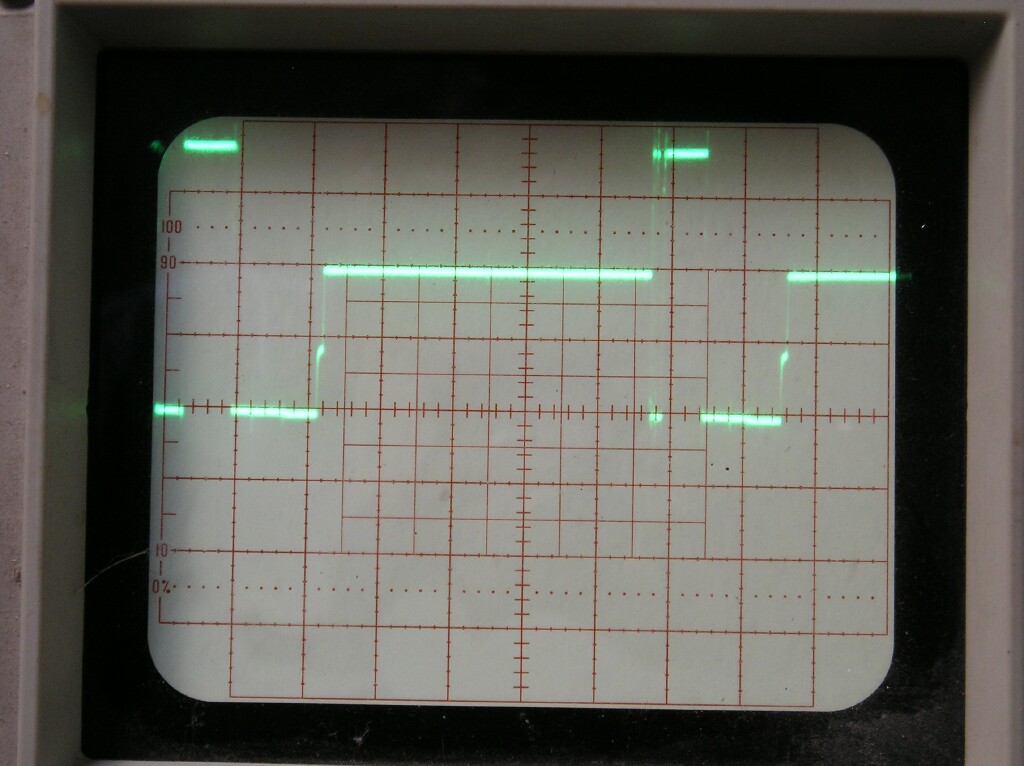

        If the lighted corner was in the lower right I would say it absolutely is the Z-sus. I had two sets with the same panel, the same symptom, and bad Z-sus boards. The first step is to open the set up and check for blown fuses on both Y-sus and Z-sus boards. If the clip-in fuse is blown, there is a short on the board, and either repair or replace it.
        If you have a scope, look at the output of the Z-sus and compare it to the pictures below. Note that the bad Z-sus has slow transitions and garbage imposed on the trace.
        Note there is someone on eBay who will repair these, and if you send him both he will give you a discount. There is also someone else who is selling the hybrids.

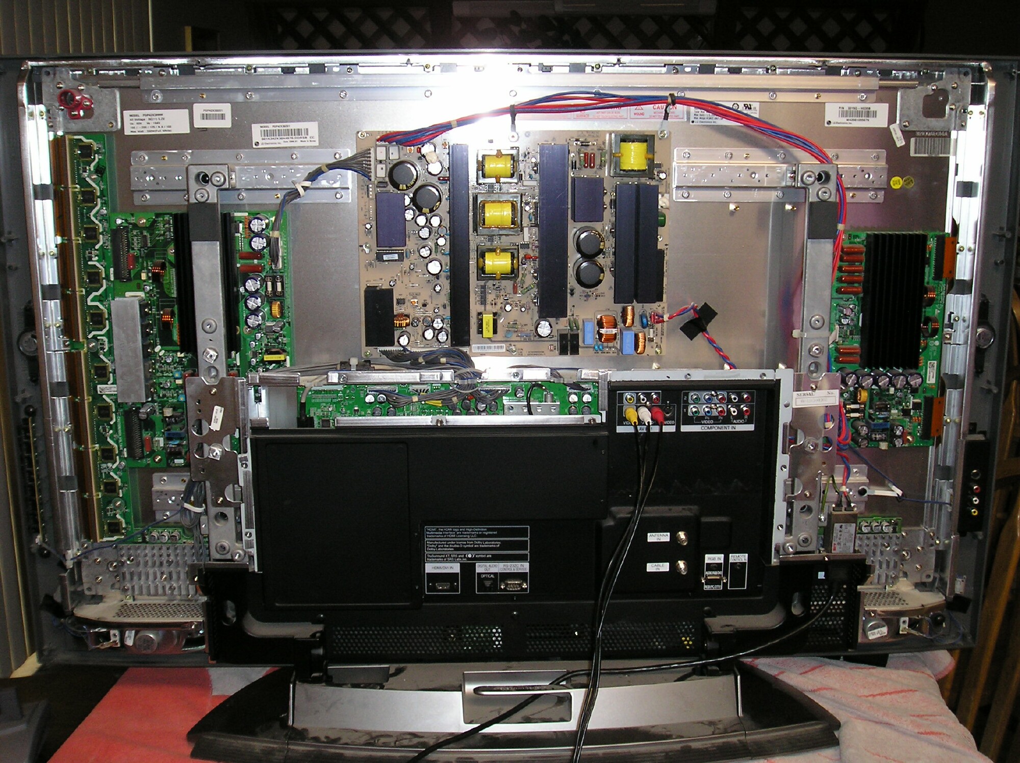

          Re: Lg 42pc3d-ue Bad Picture
          heres a pic of plainbills, mine is almost exactly the same
          until i get my cardreader to work it will have to do

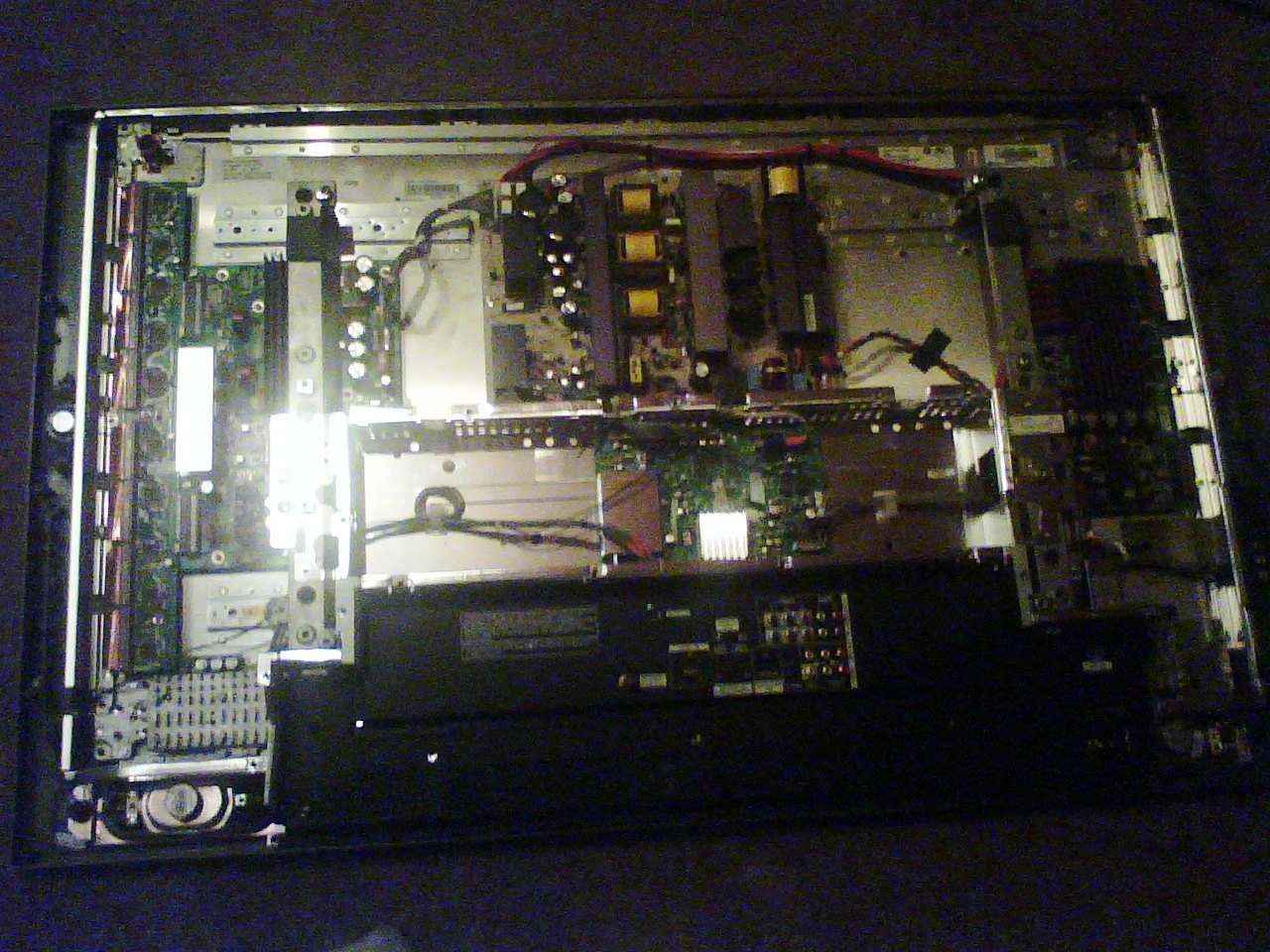

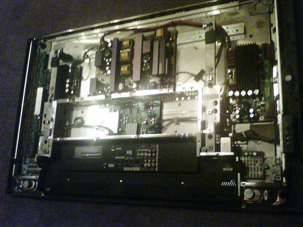

                Re: Lg 42pc3d-ue Bad Picture //withnew pics//
                havent checked fuses yet but heres all the new pics
                can anyone tell me whats what?
                oh, sorry about the bad pic quality, glare on these badlarrys are a bich
                plainbill, youre my hero so far, thanks
                  It could be the quality and darkness of the pic, but 3 caps look bloated on the power board just left the 2nd transformer (yellow block)?
                  To get better quality pics, take your tv closer to a window on a sunny day (or open your curtains) to let more light in.
                    1. Check the fuses. It's quick and easy. If any are blown, repair the board (probably the hybrid), or have the board repaired.
                    The board on the left is the Y-sus, the one on the right is the Z-sus. Z-sus is easy to pull and replace, Y-sus is more difficult.
                    Agreed, those caps look suspicious.
