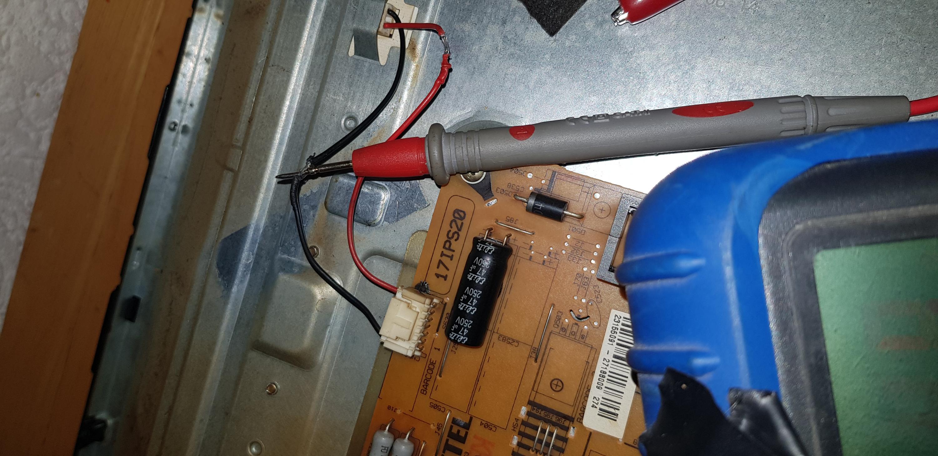

    hi trying fix cousins tv with no backlight tv is hitachi 50hyt62u i beleve the power suply is vistel 17ips20. i checked power coming out the boared to leds and was getting meter jumping from around 2v to 9v so i disconected leds from bored and was still getting the same. i tryed testing the leds wen unpluged from bored but wasnt able to get any reading. im wondering if the power detects that the led's have failed it wont put the rite power out or if it is a fault with power bored is it posable to test the leds with multimeter the way i tryed by disconecting from power supply and testing from the conector rather than strip screen. thanx for any help

    so is this mean you have approved you can see picture with tourchlight and can hear sound?? if yes .. ready yours metter on LED+ and LED- then plug the TV in wall see the reading going high and then down?

      yes iv checked seen i have picture, i tested power been sent to leds its low gose from 2v to 9v jumping back nd forth it dont get high as id xpect to power the leds. but i wasnt sure if sent low power 1st then if leds were ok give the rite voltage. i tryed test the leds with multimeeter but got no reading i would of though when unpluged from power suply and tested i would of had some reading and was thincking it may be leds. thanx fr reply

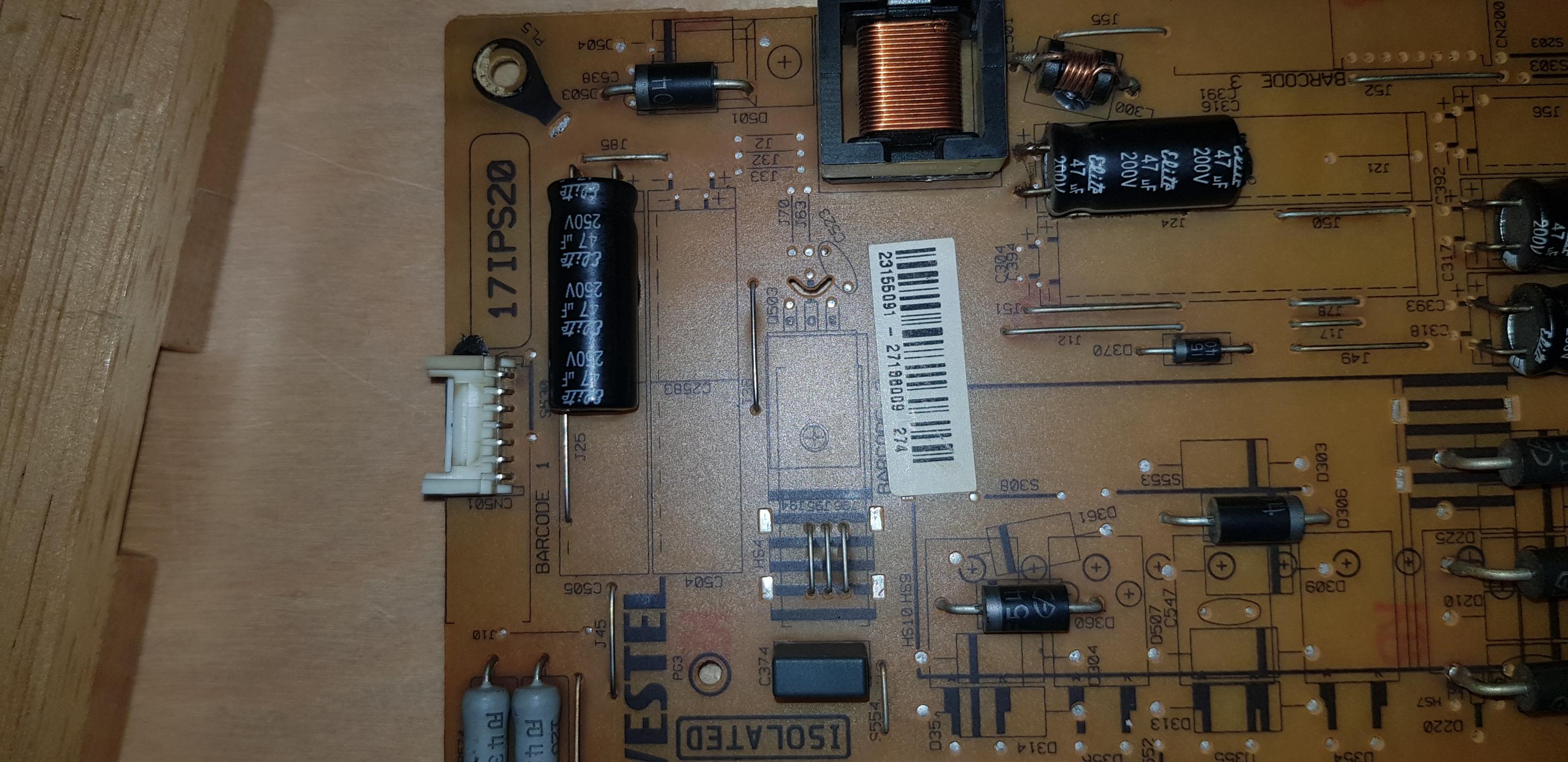

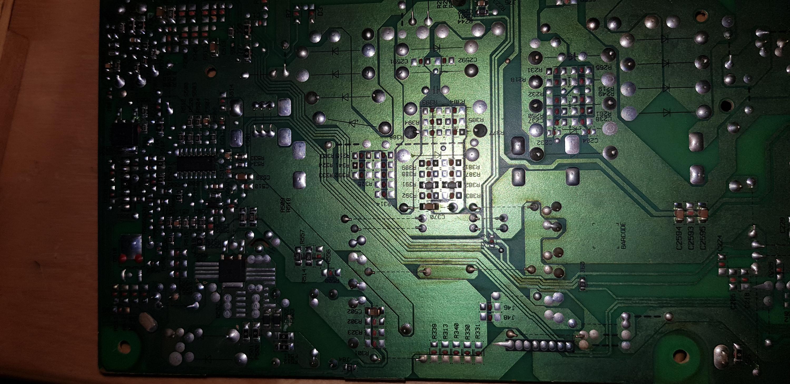

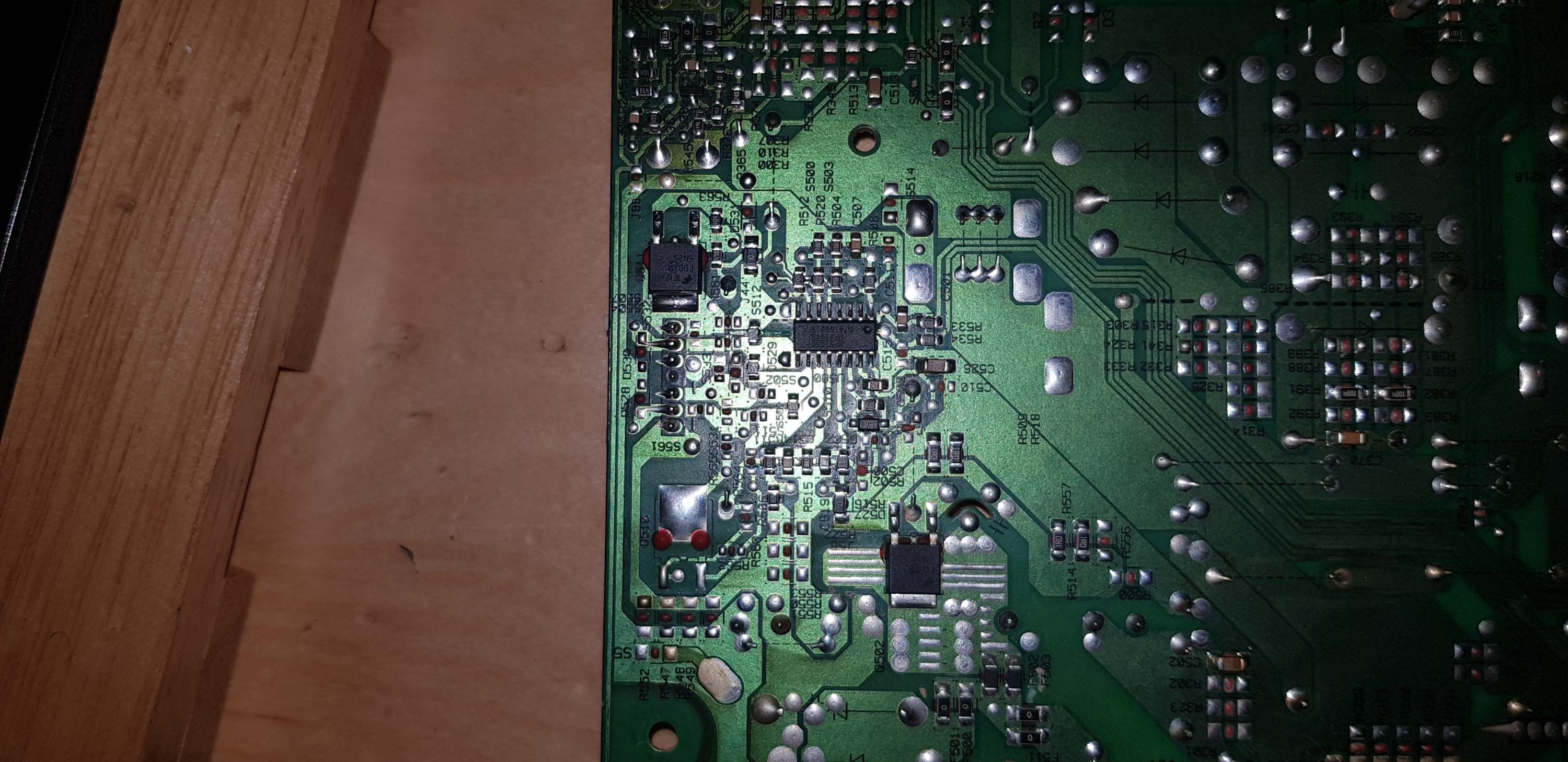

        show us high resolution focused photos of the area of the LED socket on PSU from top and down side.. by go Advanced and upload over here.

          Re: Backlight 50HYT62U
          will get pics done now be 5 or so mins
            think ive got pics done was stuck how to upload them

              messure black probe on tv chassis and the red on pin 1 of socket cn501. then plug in wall.
                i done that erlyer i got reding jumping between 2v - 9v i wil try get vid nd post it. sory took awhile to get back hata nip shops. dont think i can upload video of reading but it jumps from 2 to 9v back and forth

                  the red wire of LED it look touching the Tv chassis..??
                  this is the schematic of the PCB see page 3 and follow voltage of LED VCC.. tell where you can find V.
                    the wires are just short of a inch away from the bored its just the way looks on pic. thanx will have look at that now and see what can work out
                              Connect your meter between ground and pin1 of cn501 (The RED wire) then plug in and turn on the tv. This voltage should jump to 80v or higher and if there is a fault it will drop to 24v
                              The picture in post #8 shows you checking pin7 (black wire) which is the led return.
                                good point... i asked him this early at post#7 ... he messure led- to chassis... lol
                                also on the photo i can see black burn close to the red wire socket
                                    A small point but the output lead from the power supply feeding the leds you will find that the red wire on Vestel TV's are -ve and the black wire is +ve!
                                    I don't know why Vestel did this but that's probably why you are also getting low voltage. Bizzare but true!
                                    So connect the black meter wire to chassis and the red wire of the meter to the black wire coming out from the PSU. Making sure you have set meter to dc voltage!
                                    If you don't get a voltage of around 120V plus then connect red and black leads to the output connector from the psu.
