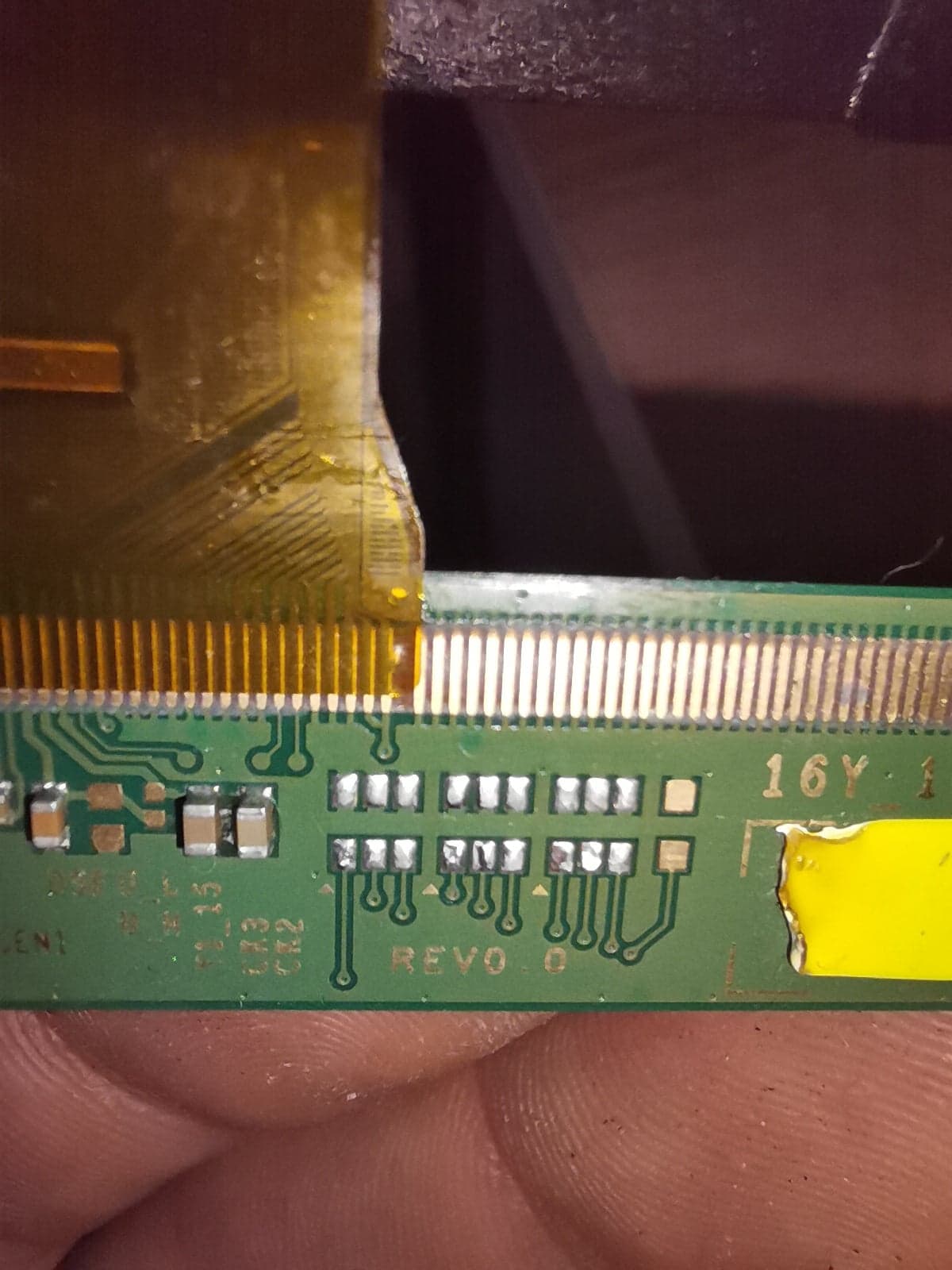

      Re: Samsung UE65KS9000 lines and reboot loop
      Originally posted by mrsith
      It doesn't look like a cap, see last photo in my previous post.
      Took all 3 ESD diodes out and measured the pads, still all 9 of them shorted to ground.
      COF short

          #44
          follow the short point u got before and go where the line on screen.. you can trce it on the panel glass as the cof ribbon will not cover all pins on glass

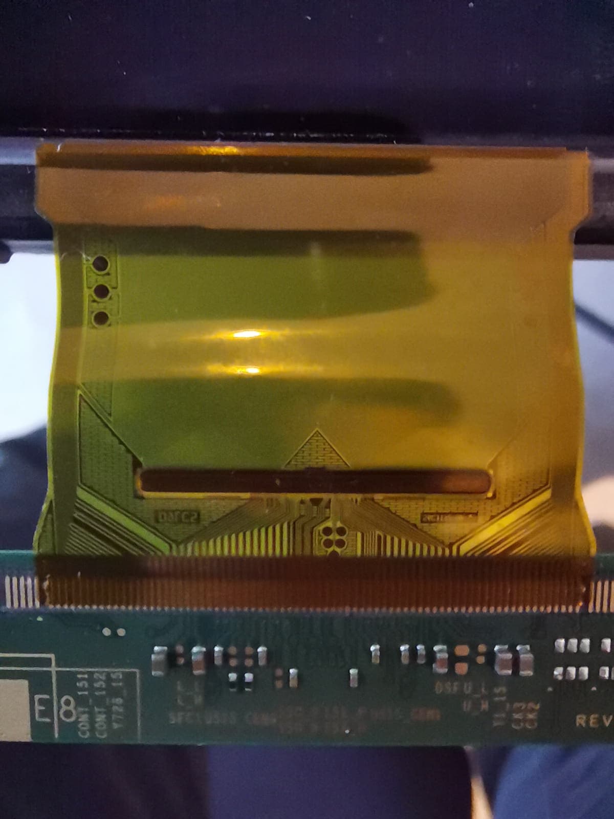

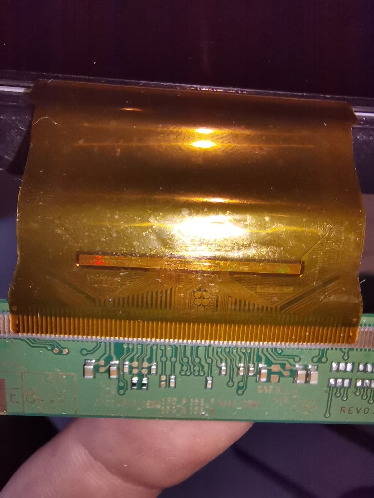

                #47
                yours photo... can you upload one for complete cof ribbon include the buffer boards
                • mrsith
                  • Mar 2021
                  • 146
                  • Wielka Brytania
                  #48
                  Pics attached with this particular ribbon next to the shorted spot.

                    #49
                    i don't like the look of the end left & right cof ribbon specialty the right end.. its look like it had suffered from short of the COF. if you have microscope you can exam it because the first line are GND of the boards where the ESD GND side go same for left side first line GND of boards... yours ESD out side the boards if there no short to them put them back... and if this cof where the line.. take it out and wait to yours friend machine arrived to do it... but i have doubt it will worth.. as i mentioned before post #9 this panel are scrap and cheat from SAMI
                    BY the way... you have short messurment even the LVDS disconnect right !

                      #50
                      Right side of that ribbon looks tiny bit different because of hot air used to take ESD diode out. Surprised you've noticed that, good eye. I examined it closely and it seems totally okay. It surely was before desoldering at least.
                      This resistor/diode thing I've been asking about in #36 - if it indeed is a resistor, shouldn't it have constant resistance? And shouldn't the resistance be the same regardless of probe switching? I know this may sound silly, but the fault is getting worse with the set warming up, and this resistance getting higher with time seems a bit related. At least I hope it is, everything would be better than fighting with COFs....

                        #51
                        take it out.. as its one pin go to GND where short point of ESD share with
                        but dont lost it LOL
