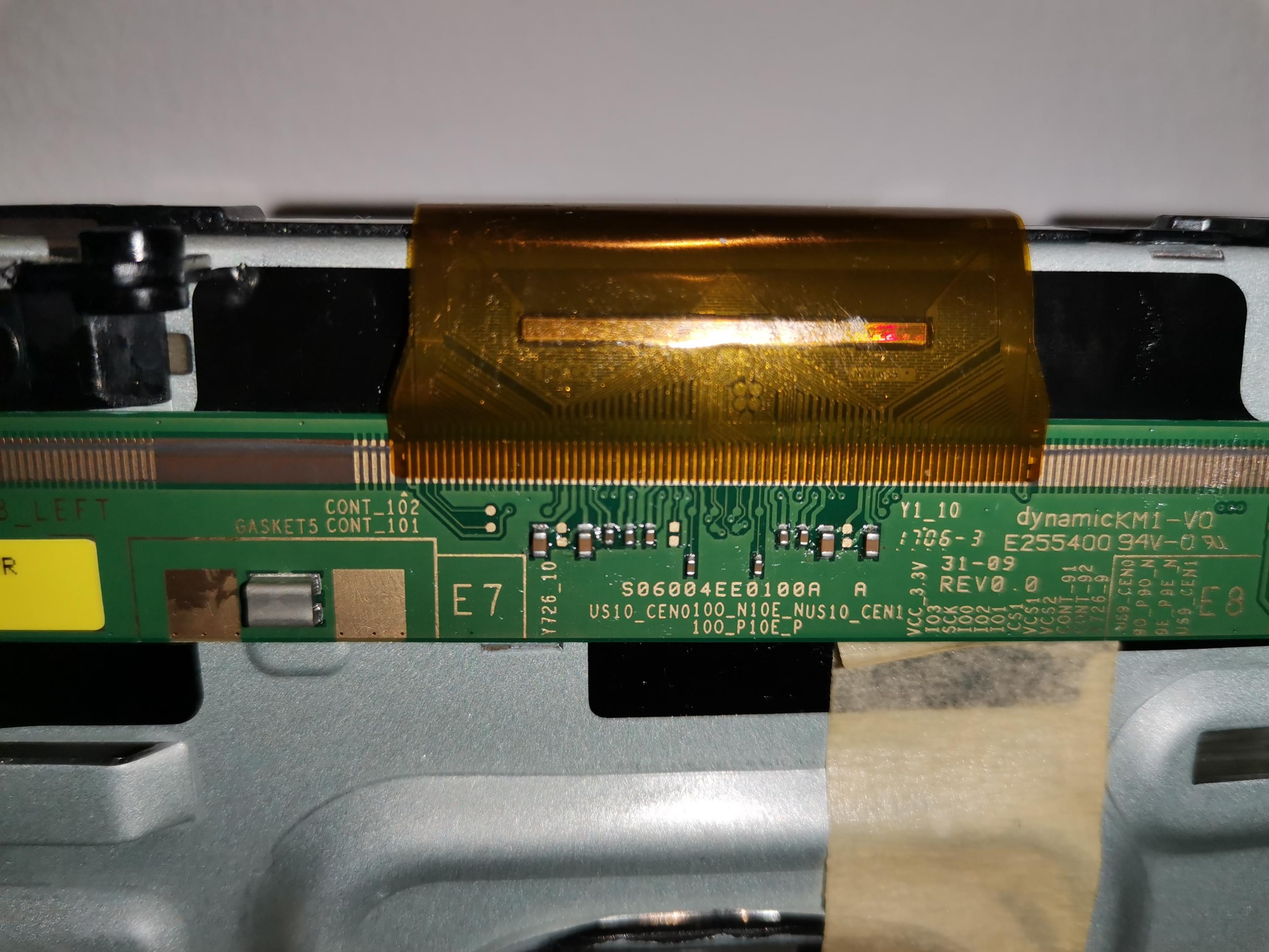

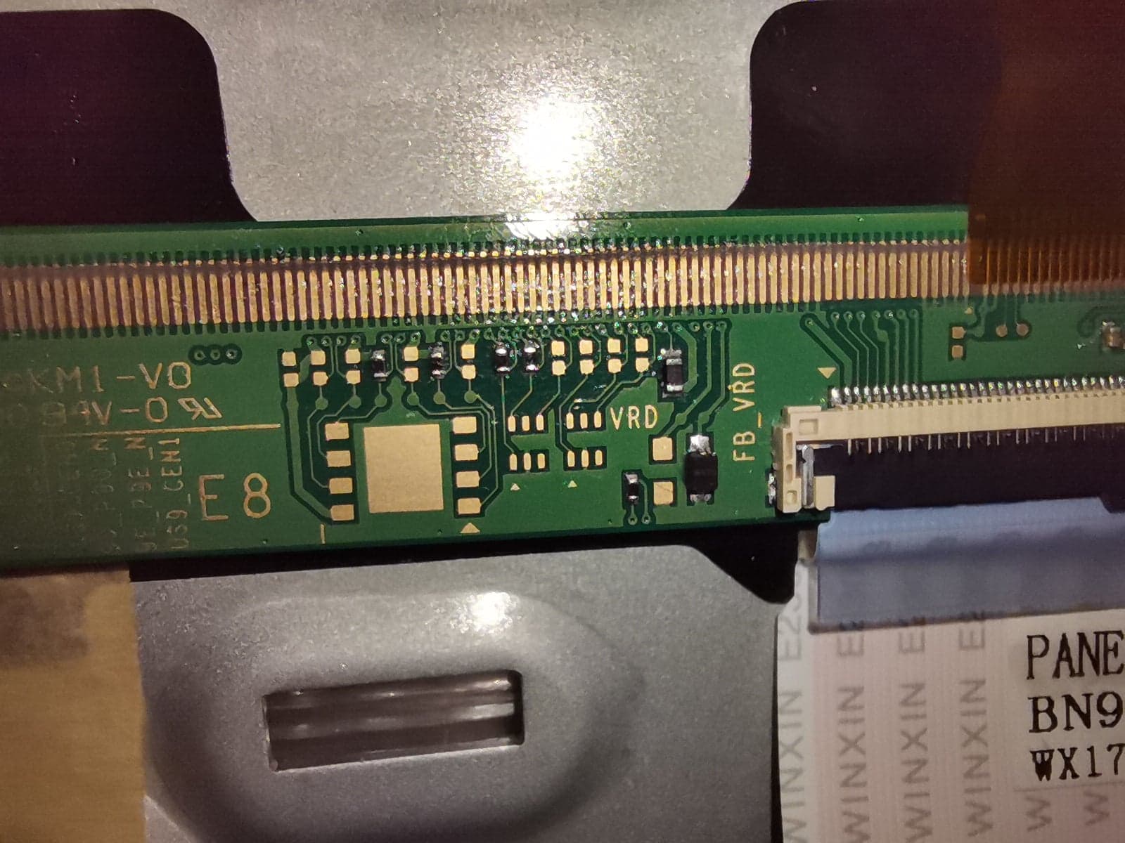

    Looking closer at your pics in the first post. The 7th pic shows the cof tab burned up if I not mistaken. I had this happen on a 75” ks9000 model before.
    I got it from a customer. I plugged it in to test and flames shot out the bottom. Opened it up and the cof tab caught on fire and burned a whole through it.
    Unfortunately it’s trash at this point. But just to confirm you can pull the tab off completely and power on. Should stay on but will have a black strip on the screen when the cof tab was pulled.

      The COF tab isn't burnt, it was just reflection on that photo.
      I'm suspecting mainboard at this point, a resistor or possibly a diode fail. Not sure how to identify VGH-responsible components though. Do you know if any boardview or schematic is available for this board? BN41-02504a / BN94-10989A
      Also I have noticed one of the diodes (Ajs7, see photo) measurements seem odd, gives me 126 one way and 210 the other way. Shouldn't it conduct just one way?

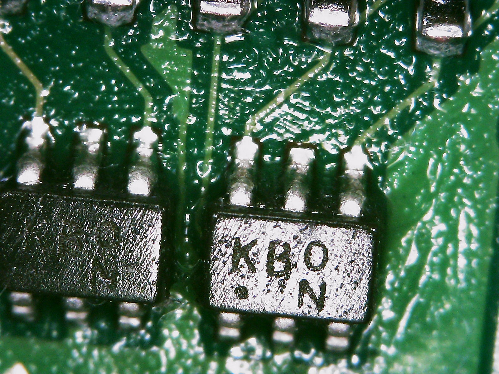

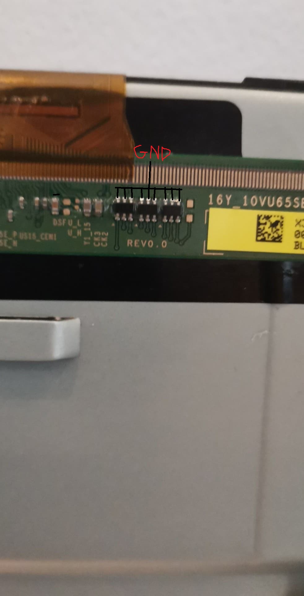

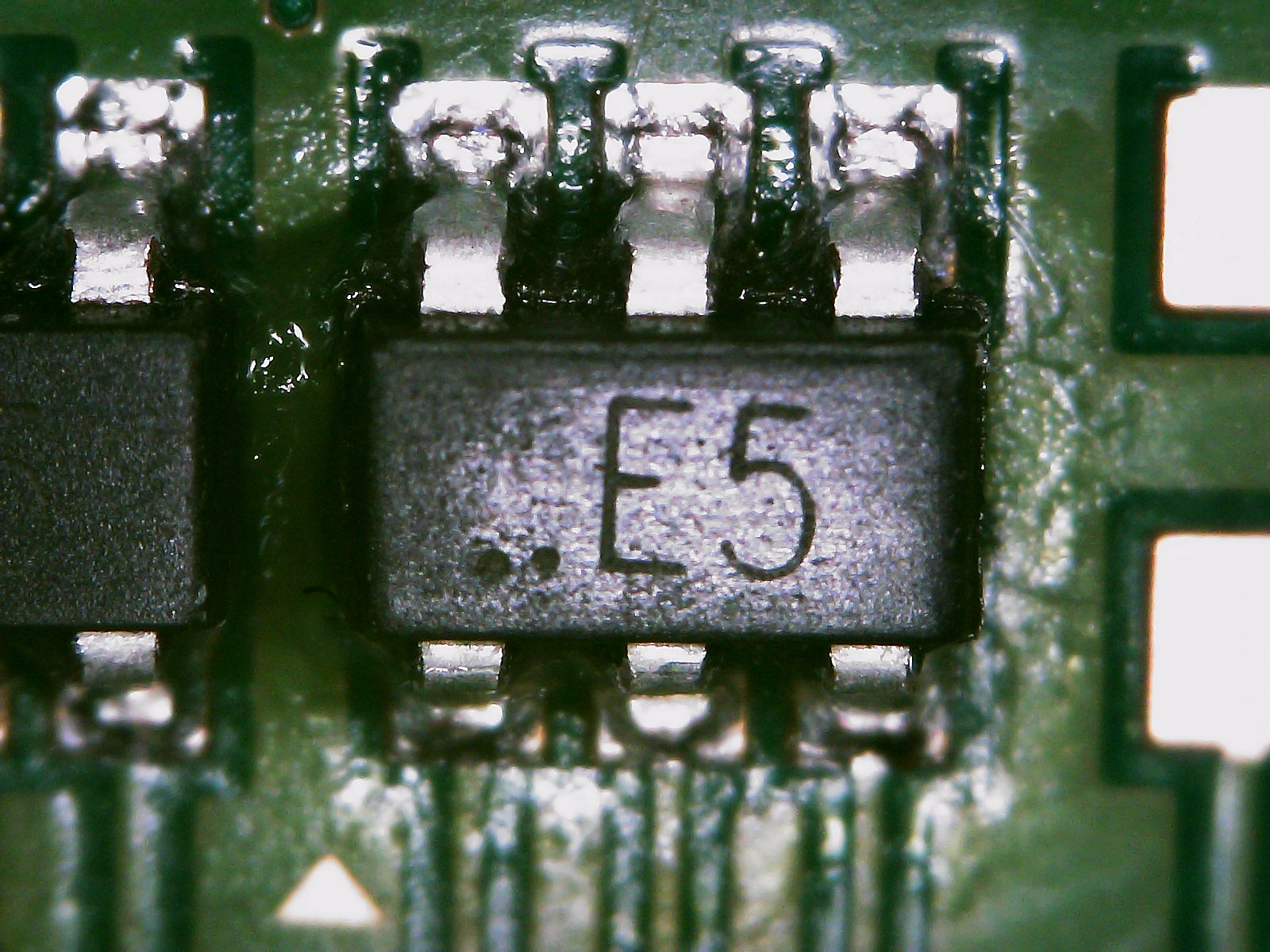

                          Please see pic attached: all of the top pins of all 3 diodepacks marked .e5 are shorted together and to the ground. I have checked bottom pins vs other bottom pins, no continuity. Top pins vs bottom pins, no continuity. I have tried every single combination possible, switched black and red probes etc. I think I'd expect middle pins to be ground, left side continuity top-to-bottom (or opposite) with the same on the right side?
                          I've measured kb0n diodes in different place and they seem to measure as expected - both middle pins are ground, there is one-way continuity between top and bottom left pins, same with right side.
                          Does it mean the .e5 diodes are bad, or that there's actually a short on that line?

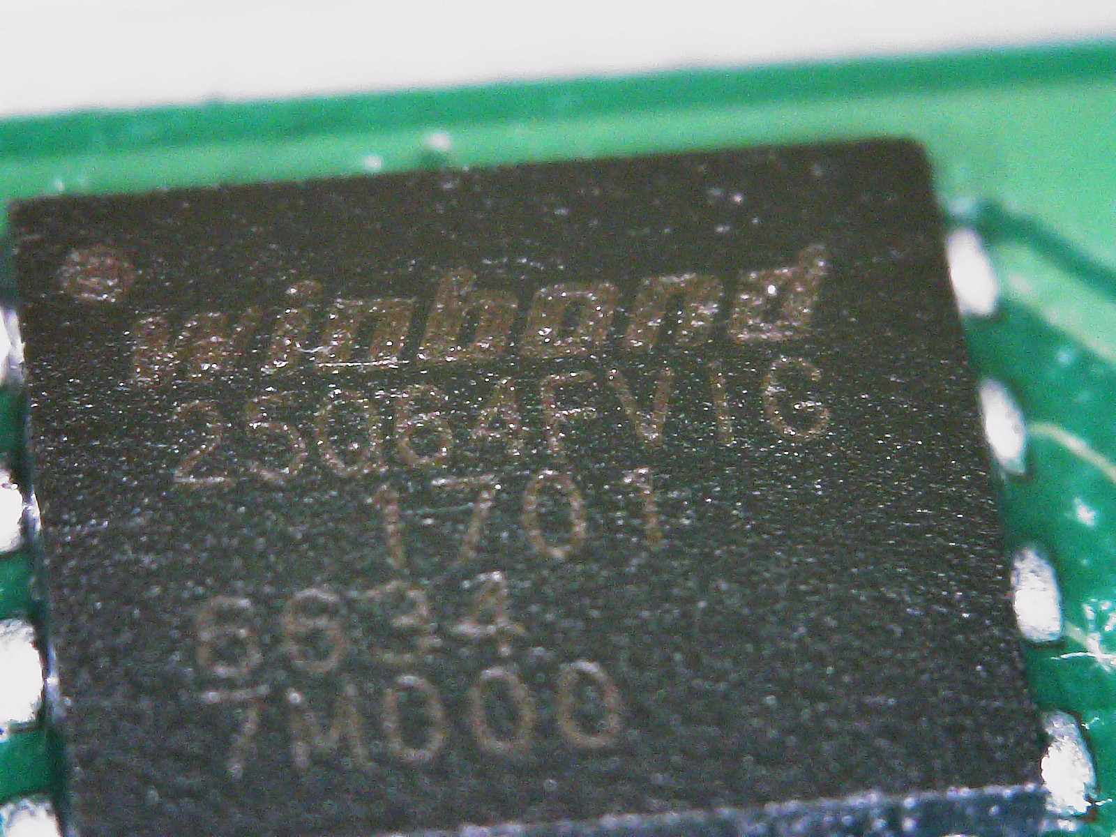

                          Also there's an IC (photo included), what is it responsible for and is it any way to test it as well? Just want to completely rule out panel boards while I can still cancel the mainboard order today

                              This big IC seems to be a flash memory so I can probably rule it out. It's just the weird diodes' behaviour that concerns me. And given that this sets have common problems with diodes...
                              If anyone could help me identifying them, I'd just try and replace all 3 to see if anything changes. I'll wait with trying new mainboard until I'm 100% sure the panel boards are okay.

                                Been trying to identify these components over weekend. I have attached a datasheet of the closest thing I could find (same or similar package type SOC363 and marking E5), but I am far from being sure this is it. Any ideas how to proceed?

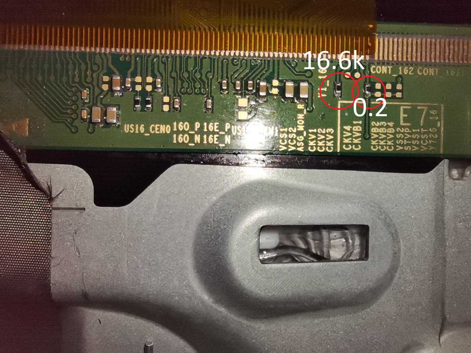

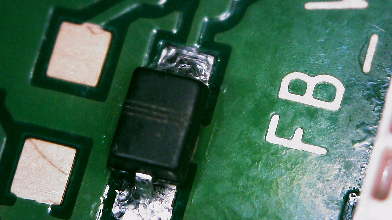

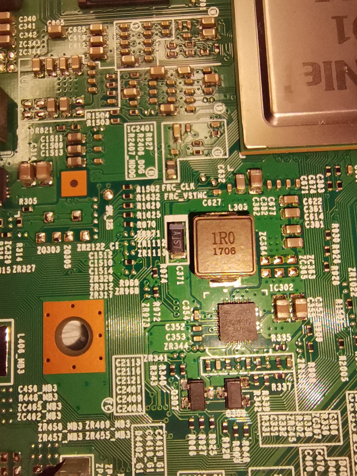

                                  So I decided to give it a go and check once again everything on the panel boards. Again didn't find any shorted caps, so started taking measures of all resistors to try and find something out of order.
                                  Firstly I was a bit surprised that one of the resistors had only 0.2ohms while most of them ranged in Kohms. But going further there was something that looks like schottky diode - didn not get continuity either way on it. Checked with ohms - resistance was rising, from about 0 to 60k ohms. Switched probes and again - from negative values until around 28k ohms. The higher the value, the slower it went up. Took about 20-30 seconds until it stopped.
                                  I have also noticed that if I took a probe away and put it back on a pin within short time (5 seconds?), it didn't raise from 0, started mid-way.
                                  Not sure if this is wrong because I'm not entirely sure what smd I have been measuring (suspecting schottky but is it really it?), but the behaviour seems similar to the lines appearing on the screen - almost nothing on cold start, the longer the set is on, the more lines appear, up to the point they are over whole screen.
                                  If it is indeed a diode, how can I identify it's values so I can search for replacement?

                                    Re: Samsung UE65KS9000 lines and reboot loop
                                    take out all esd diode from the buffer boards and see if the short remain... tv will work with out them
                                      hopefully that's a cap you have been measuring, don't think diodes should read like that.
                                        It doesn't look like a cap, see last photo in my previous post.
                                        Took all 3 ESD diodes out and measured the pads, still all 9 of them shorted to ground.
                                          i think that's a resistor.
